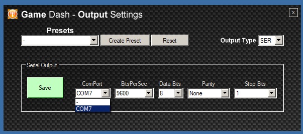

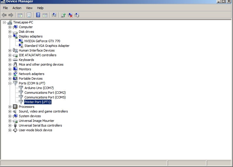

    Hi there, I wonder if anyone knows whats going wrong with Game Dash on my systems. Here is the Arduino on Com7 running on Windows 7 x64
    and here is the Com port showing in the output settings

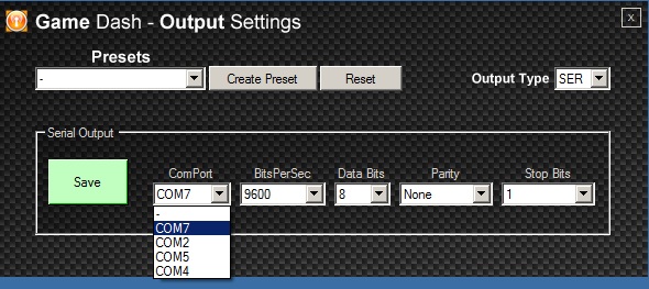

    After saving and closing it, going back into the settings gives
    and now all Com ports are missing except the one I chose
    At this point I can go into the Arduino SDK and gain direct access to the serial command and set speeds manually (S010, S254, etc) and the Uno responds as required with no issues. but trying anything direct from Game Dash doesn't change anything.
    I have multiple Arduinos including a Mega2560 as well as an XP x86 machine but they both produce the same error.
    I have googled the error regarding the interface error and only found one other post that never had a reply.
    Thanks in advance!

    After spending a good few hours on this it seems to be sorted - my testing using the Dash Output Tester didn't work, only by connecting to LFS managed to get it going!
