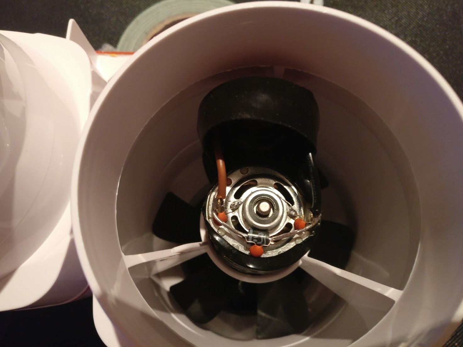

    I've done some work and think I had a breakthrough yesterday night.
    - MM not overheating anymore due to shottky diode + capacitors on back of the blowers. Think I don't even need heatsinks with two seaflo and 16kHz PWM, operating at 5% speed. Had it running like that for half an hour last night. No noticeable rise in temperature.
    - I attached a pwm library to the existing arduino code, so it is possible to dial in any frequency you want
    I hope some guys get to test and confirm.
    Until that you can follow in iracing forum -> hardware -> "iRacingFanboi (yet more DIY wind code)" to which I can't link directly because I lack the minimum number of posts.

    Well actually I took the iracingfanboicode arduino sketch as blueprint. But none of the control sketches differ much and aren't complicated to adapt to different environments. I'd just be more happy to engineer in one place and verify first, before spreading stuff out into public. But as wind sim guys who want to develop seem a bit rare...
    Heres the short story:
    I have two seaflo blowers which did stutter at 980 Hz PWM.
    First thought of faulty MM, faulty Arduino, then faulty blowers. Raising PWM frequency however eliminated the stutter. I thought of electrical noise/sparks and soldered capacitors to the back of the blowers, without much success. The MM drives have body diodes which should deal with the backfeed from the inductive fan load. So the shottky diode was the last thing I considered. But it also couldn't harm, since we run the blowers only in one direction anyway.
    And this was the outcome at 980 Hz PWM with capacitors and diode. You can clearly see it still sparking and tripping protection.
    However I noticed a huge difference in temperature of the MM and also the power supply (btw, ! watch power supply when MM is running hot !). Seems all blowers are backfeeding, causing trouble in the motor driver. Diode prevents that. It may not always be as vigorous like my blowers tripping MM protection. But it causes heat in the MM and additional switching losses.
    Beforehand, I thought I had to live with heat, so I planned a 140 mm x 140 mm case with a fan of that size on top. Just big enough to run two MM in single bridge mode. Since 31 kHz seemed a bit too high I aimed more for like 16 kHz to 20 kHz to eliminate coil whine. And that is possible if you include the pwm library from runnerup.
    It comes with a downside however. To mess with PWM on pin 5 and 6, timer 0 has to be messed with. This sacrifices pin 6 PWM. If you want your MM stacked ontop the arduino, you have to bridge pin 5->6 on the MM. Else only one fan gets PWM. What I noticed: The PWM on pin 5 is a bit off (10 Hz @ 1234 Hz output), but I don't worry about that. Think it's caused by disabling timer0 and therefore relying on the physical timekeeping properties of the arduino.
    I have code to run MM single bridge mode, using pins 9/10 as PWM output. No problems and PWM frequency spot on. So in case we sometime get to stereo blowers by telemetry, we can deliver different PWM, but dropping the ability to just stack the MM ontop of the arduino.

    Now for the wiring:
    Didn't do any calculations. I used non-polarised (!) ceramic capacitors (50V, 100 nF) and a shottky diode (SB1240, 40V, 12A).
    The purpose of the caps is just to smooth and filter the voltage. The shottky diode acts as a freewheeling diode. When the fan is switched off, it keeps running cause of it's rotating inertia and acts as a generator. The power, since it has to go somewhere, is fed back to the motor driver, which has builtin diodes for that matter. But they seem not suited for our intended purpose. So the shottky diode protects the motor driver, creating an easy pass for that generated power.
