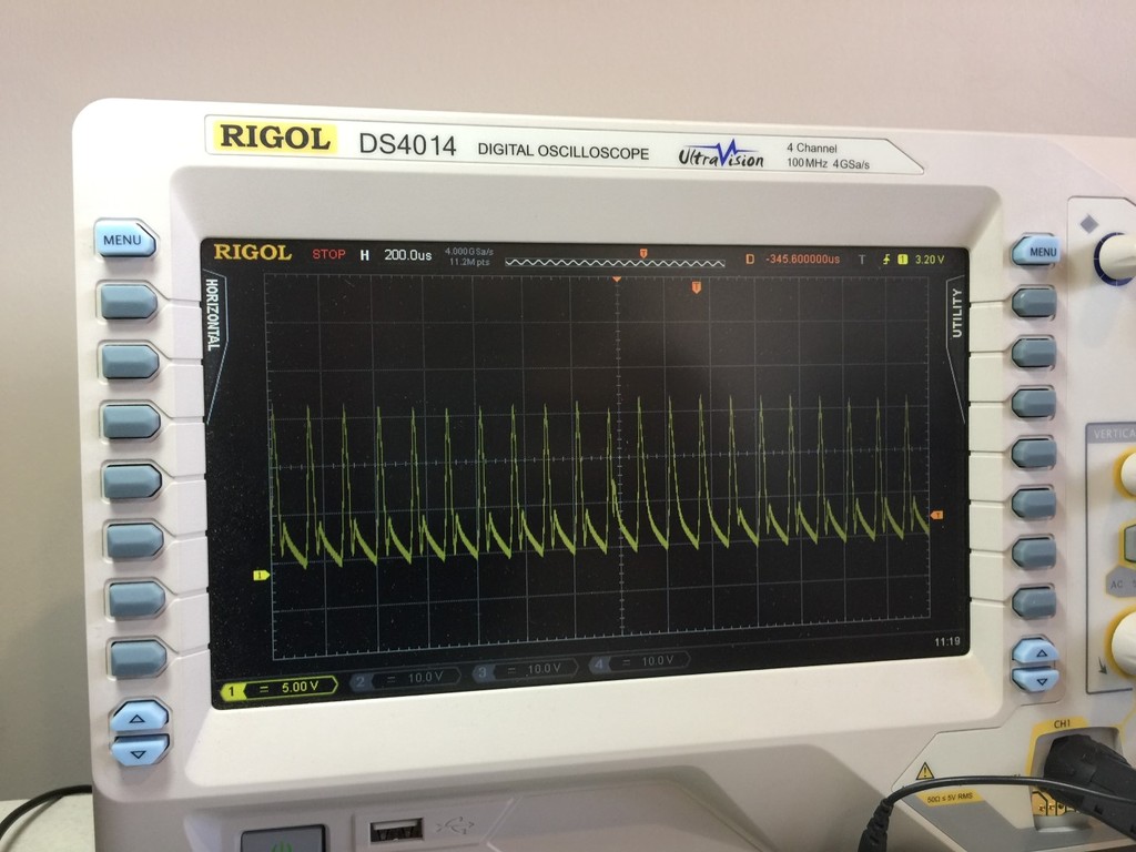

    My first test was just to get a baseline of what is happening.
    I set the blower up like this. Just connected directly to the MM
    This is what I saw on the scope.
    It should be a nice square wave with as the PWM was set to 40%, instead you see this weird jump up to around 6V when the fan motor must be inducting, and you are also seeing spikes.

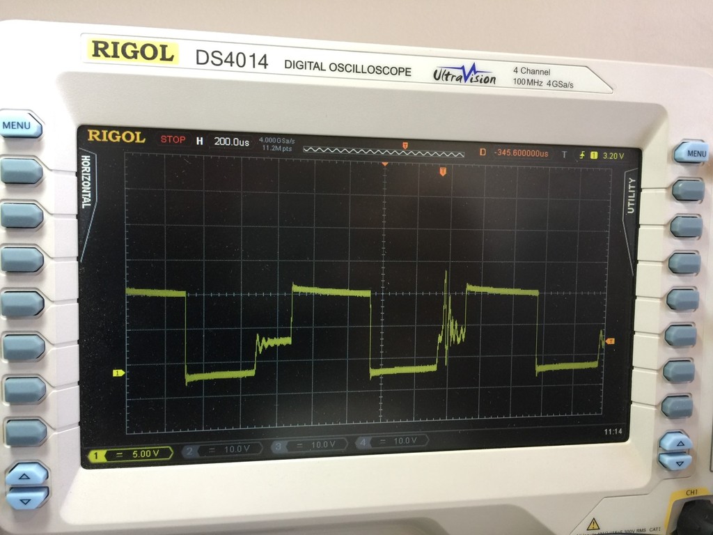

    Next I installed the diode like this
    At first I thought it had fixed the initial high spike I was getting but I still had that 6V back feed type thing going on and the stutter was still there.
    I did some more captures and then I captured the first stutter so I could see what was really happening.
    I could see that it was clearly an over voltage protection problem, sometimes that initial spike jumps up over 17V and the over voltage protection kicks in.
    The MM goes in to protected mode but when it switches on again it gets hit by another 17V jolt and goes in to protected mode again.

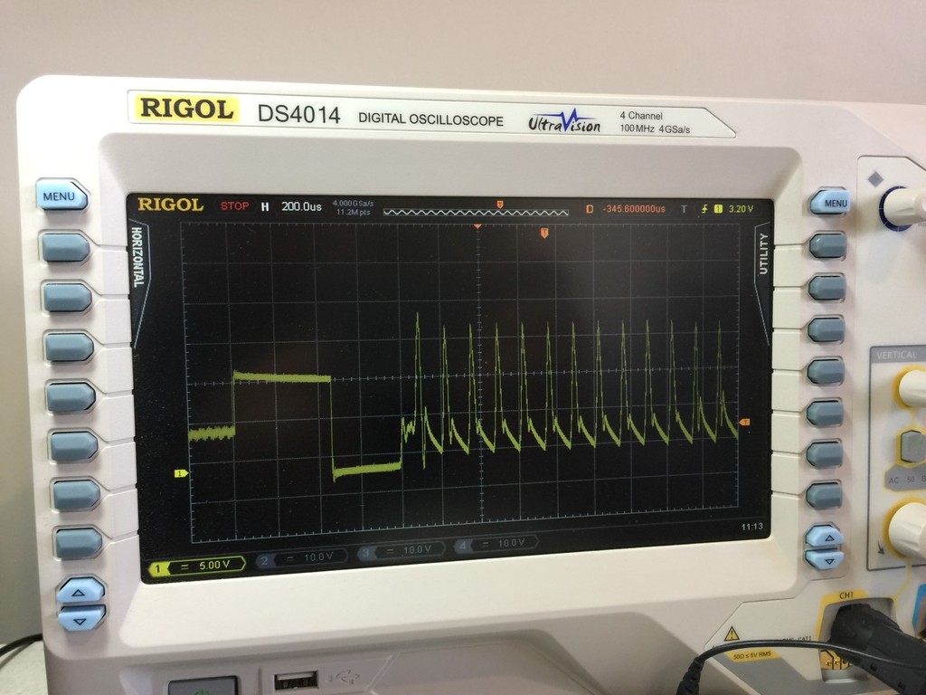

    I next tried installing a cap to see if that would make any difference to protect against these voltage spikes.
    With that cap and diode in place I was still getting the stutters, I managed to capture a spike that was almost at the voltage protection limit so you can see what the spikes look like.
    But still it would go in to a repeating cycle of 17V spikes even with the diode and cap installed.
    At this point I was sure it was these voltage spikes causing the stutter so I did some more testing with and without the diode and caps and it had no impact on the stutters. Here is a video of it happening in real time.

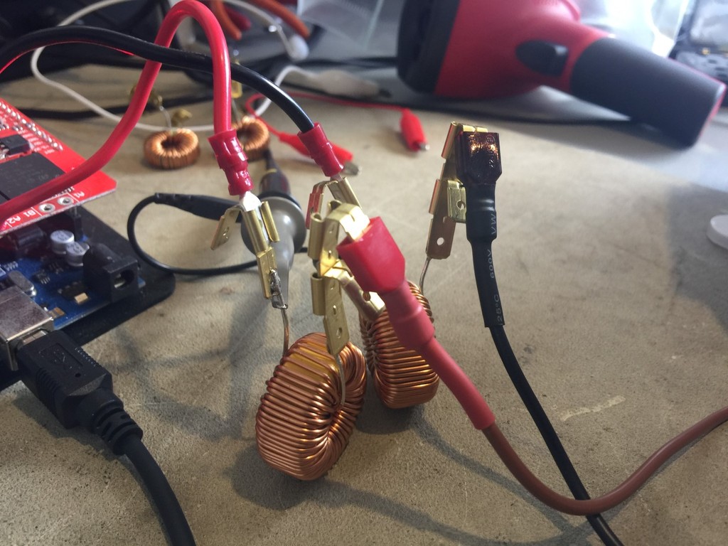

    My next plan of action was to try some inductors to see if I could block the backfeed. I started off with 100 microhenry and that helped but I was still getting some back feed so I went up to a 475 microhenry 5A inductor like this
    Then the wave looked perfect and there was no stutter at all, even on "Old Sparky" (That faulty Seaflo that I showed in my videos)
    I connected my scope up to the other side of the inductors to get a gauge of what it was blocking and this is what I saw, up to 30V spikes
    So here is a before and after installing the inductors

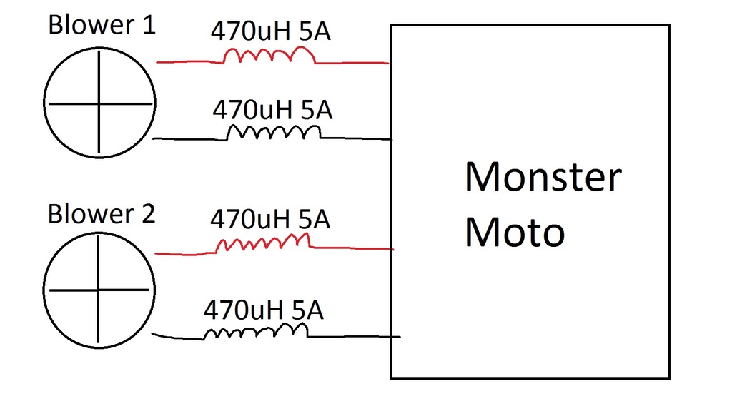

    You can start using it now. Even at the standard 980Hz it makes a huge difference, if you want I can have a talk to Matthew Lees who wrote the iRacing Fanboi code and ask if we can borrow his code for allowing different PWM settings (980Hz, 4KHz, 8KHz etc)
    Not much of a schematic needed. Just put a 470uH 5A+ inductor on each of the wires going between the MM and the blowers
    Like this

    Now on to the construction of the suppressor controller. The 2 inductors are mounted on to a blank prototyping board
    The ends of the inductors are soldered directly to the wires.
    They are then heatshrunk and bent flush with the board, these wires will exit out the side of the box like on my controller box. The 2 drilled holes will be for mounting in to the enclosure.
    I also use a little hot glue to make sure there is no wiggle room.
