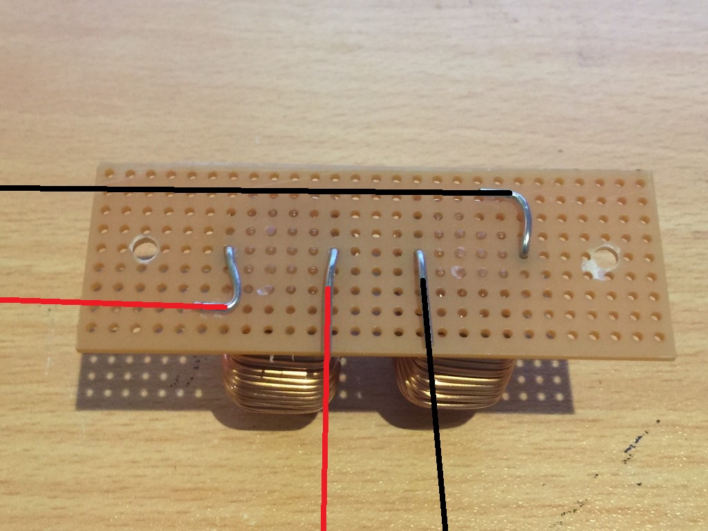

    Made good progress on the suppressor box.
    Still need to finish the base and the mounting supports for the inductors.

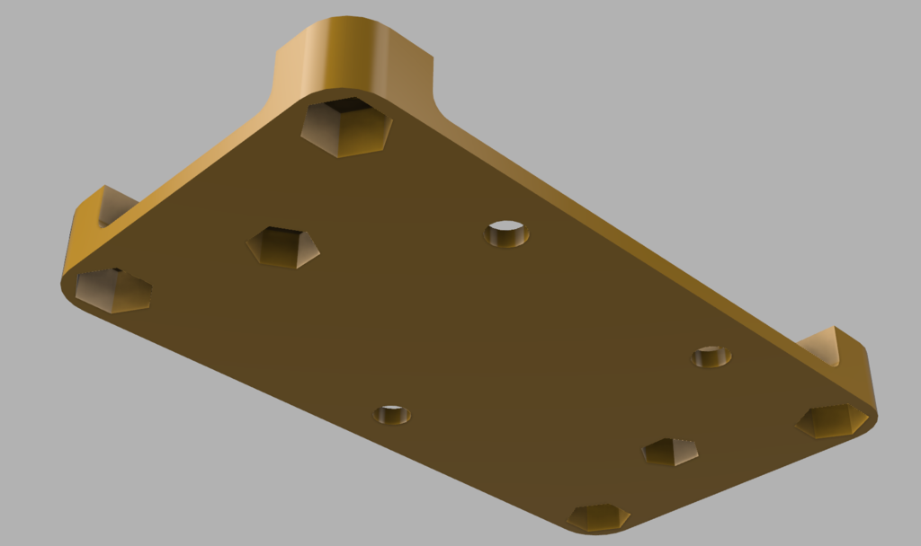

    Finished the design of my suppressor box design.
    Just printing out the first one now.
    I put a little center divider inside the box
  6. Avenga76
    Avenga76 Well-Known Member
    Jun 29, 2014
    518
    Network Engineer
    Auckland, New Zealand
    3,262Coins
    +859 / 6 / -0
    Printed my first suppressor box.
    I made it a little bit bigger than the inductors that I am using in case anyone wants to put different inductors and or caps/diodes inside the box.
    This is the base plate of the suppressor box
    The board and lid is secured using captive hex nuts and has 3 mounting holes so you can mount the box to your rig.
    Here is it next to a blower

    Some more little tweaks on my suppressor box.
    Added in cable entry port on the other sides now so I can route the cables out any of the sides.
    Also added some channels for the cables to sit inside, they are the exact width of the cable so they fit in really snug.
    This would be the cable pathing for a coming in the back going out the side, like I will be doing on my retail version. I designed it so none of the cables come close to each other and they are all held in by the cable channels and cutouts, plus everything will be heat shrinked.
    Changed out to black bolts and printed 6 of them for the wind simulators that I am building at the moment.
    These are them mounted on one of my retail wind simulators.
    They tuck in between the PSU and the blowers, for the next batch I build I will space the blowers out a bit more so you can still have rotation with the suppressors in place.
    Here are the 3 bolts for was suppressor box holding them on.
    They are all M4 Nylock, with the exception of the power plug which is M5 Nylock.
