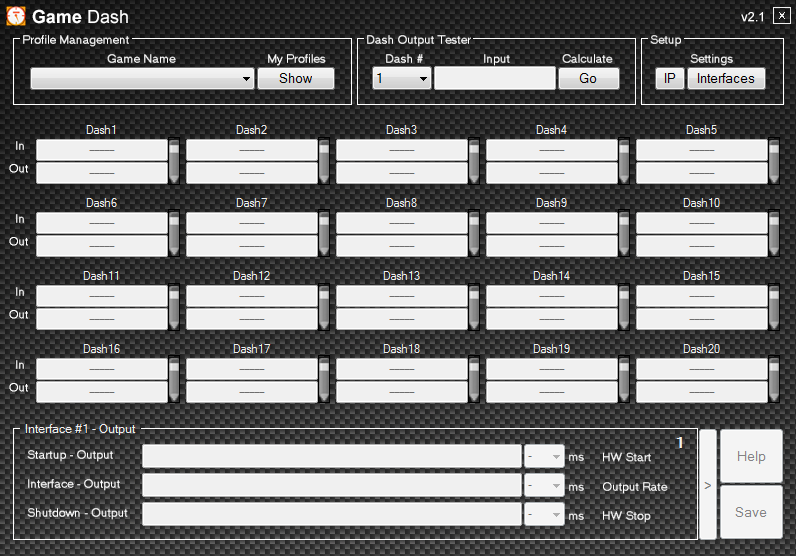

    Hey mates, my arduino for the wind sim, arrived me today and i began the project. But only two steps and i stuck in the mud.... It's embarrassing, but i can't find an tutorial for game dash. I'm to stupid, to use the tool. The only working button, is the Interface settings button. But i can't fill the "interface output" field ( S<Dash 1> ) and all other buttons (except for "Profile Management" & "Dash Output Tester"). What i do wrong? Since 45min. i clicking like a cow on all buttons.

    SilentChill's first post in the thread shows how. Those vertical bars next to the Dash In/Out boxes are pencils that you click on to add the math statements. And no spaces in the S<Dash1> output statement. You also need to make sure you are addressing the proper port for the Arduino. Just use the same setup as in the Arduino programming software you used to program the Arduino.

    The problem i have, you can see on my screenshot. All buttons (pensils too) are grey and i can't click on that. I'm pretty sure, it's is a small mistake i do, but i can't find.

    Ah - I see the gray. I don't know why that's happening. Maybe @yobuddy or someone else may know?

    @Bastiuscha you have to enable dash in game manager and then you will see the game list. choose a game and then the pencils will be editable

    It's unbelievable, how blind i was. Thank you! But i can't use it anyway. I have only the DIY licence. The pro is needed. Shit ;D Now i don't know, do i have to buy the software for a second time, or i can upgrade my DIY licence. I wrote a mail to the support....i will see.
