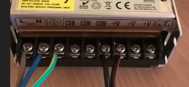

  5. Michal Burisin
    Michal Burisin New Member Gold Contributor
    Dec 25, 2017
    26
    Prague
    138Coins
    +17 / 0 / -0

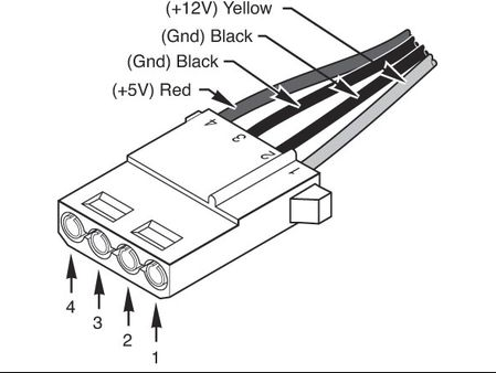

    I have problem with connection, possibly with power supply.
    At the beginning, I got original Arduino and MotoMonster and SeaFlo blowers.
    I didn't have any special power supply, so I used one from PC and connected it to main MotoMonster via Molex. On MotoMonster + went to +12V branch of the Molex and - to the ground on the molex.
    It worked perfectly without problem.
    I decided I will get proper power supply and do coils mod as well.

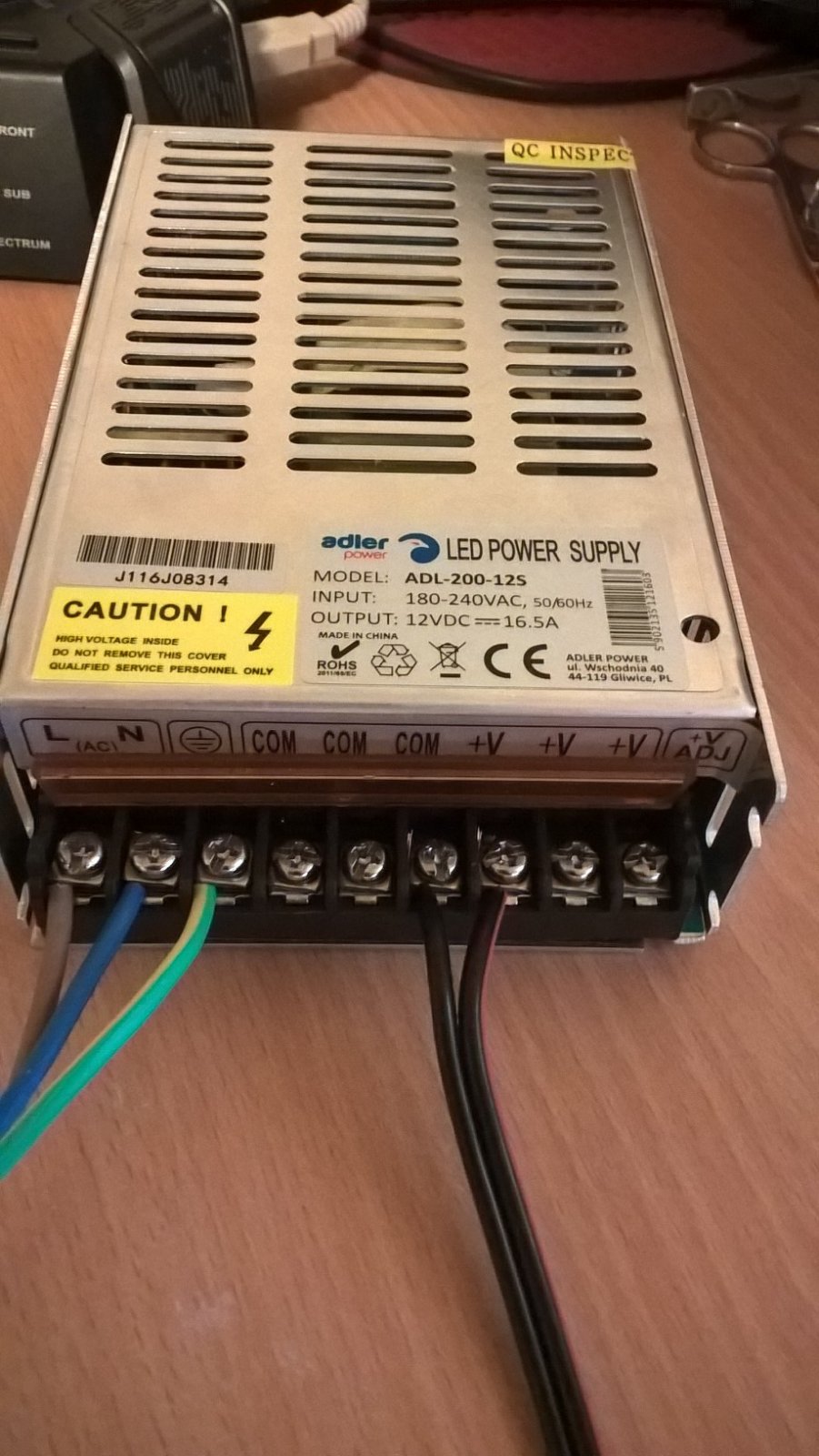

    I hooked everything same as before, just added new power supply + coils, connection to power supply was like this:
    It's 12VDC power supply giving 16,5 A max.

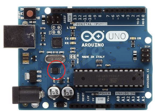

    I turned it on, the blower started to spin, but there was burning smell so I turned it off immediatly, but it seems Arduino is burned. It's not possible to upload code anymore and power led isn't on when powered. It just gets on when I press restart on Arduino, that's all I can do with it.
    Now this chip circled below and it's near area gets VERY hot once powered via USB:
    I thought it was due to coils or something else (I got these - they look little bit different, they are made from multiple tiny strands and not from one thick one as shown on images form @Avenga76, but the specifications should be almost the same).
    So I got another Arduino, and hooked it up without coils and even without blower to be safe, Arduino had uploaded program which has default speed set to zero, so it shouldn't do anything, but it burned Arduino same as before :(. PWM mode was set to 0.

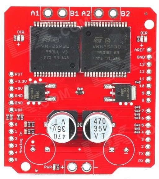

    If I plug in power supply with just the MotoMonster, both big chips on MotoMonster are cool.
    Once I attach it as shield to Arduino (without blower connected) one chip gets very hot immediately (I can hold finger on it, but it's uncomfortable), the other chip stays cool.
    Anyone has some idea what's going on? As it worked ok with PC power supply before. Do I have the connection to the power supply correct? It has +12 V and the other ports are named COM, which I found should stand for common and should be very similiar to ground.
    Or this is the problem and I should connect the black cable to GROUND next to green/yellow cable?
    I thought power from MM shouldn't go to Arduino at all. Also I have it connected to Arduino as shield and all pins are there, also those with +5 V and + 3,3 V, but it worked before with PC power supply, so it shouldn't be problem.
    The MotoMonster is looking to work fine - the red led shines when connected to power supply. I don't know it it's ok or it could cause the trouble.
    I'm now afraid to do more experiments and I ran out of Arduinos anyway, I will probably getting cheaper clones now to figure it out.
    Anyone has idea what I did wrong?
    Many thanks.
    Michal

    16,5 v its a overpower voltage. Maintain between 12 and 14 its a limit. WARNING, very important thing, just put a multimeter and take voltages from this power supply. Generally made in china, voltages and amper are instable and poor.
  7. paulopsx2
    paulopsx2 Active Member
    Apr 2, 2016
    616
    brasil
    649Coins
    +165 / 2 / -0
    Dont conect "ground" cable, only positive and negative. Dont invert this position too.
  8. Michal Burisin
    Dec 25, 2017
    26
    Prague
    138Coins
    +17 / 0 / -0
    @paulopsx2 Ahhh, I see now where I made mistake.
    Before I was connecting servos, which has only +12 V and ground cables, and I got association from there, that black cable = ground.
    But I see now that MotoMonster is + and - which should be connected to power supply.
    It seems I bought wrong power supply, as it doesn't have minus at all, it has just +V and COMs, which are probably same as ground. This power supply is designed for powering LED stripes.
    So I guess I need to buy power supply, that has plus and minus.
    I have found this one from Meanwell, which is just 12,5 A and passive cooled, should it be enough or I need stronger one? Two blowers should take 12 A which is pretty close to the limit of 12,5 A this power supply is capable of delivering.
    Stronger power supplys are actively cooled and like two times more expensive. For example this one.
    Anyway one thing I still don't understand is, that when I connected it to PC power supply directly to molex connector to +12 V strand and ground, why it didn't burned the same way as with this power supply. Any idea?
    Many thanks for help!

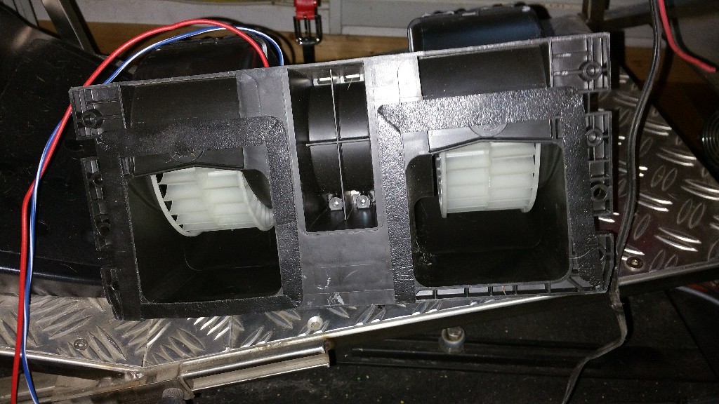

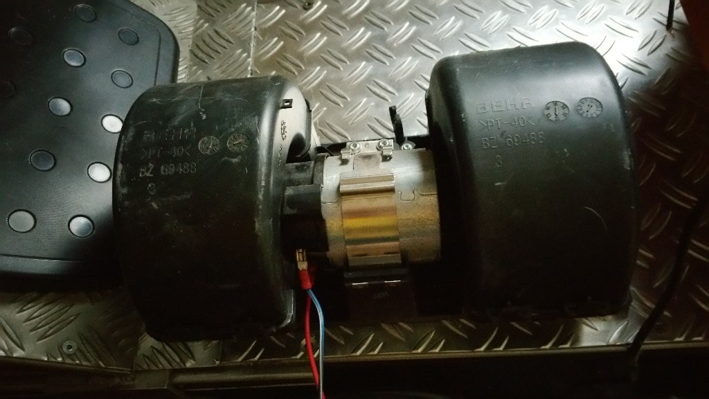

    Je suis tombé accidentellement (par hasard) sur une ventilation de cabine de tracteur 12V dc
    I stumbled accidentally (by chance) on a 12V DC tractor cab ventilation
    c'est très puissant
    it's very powerful

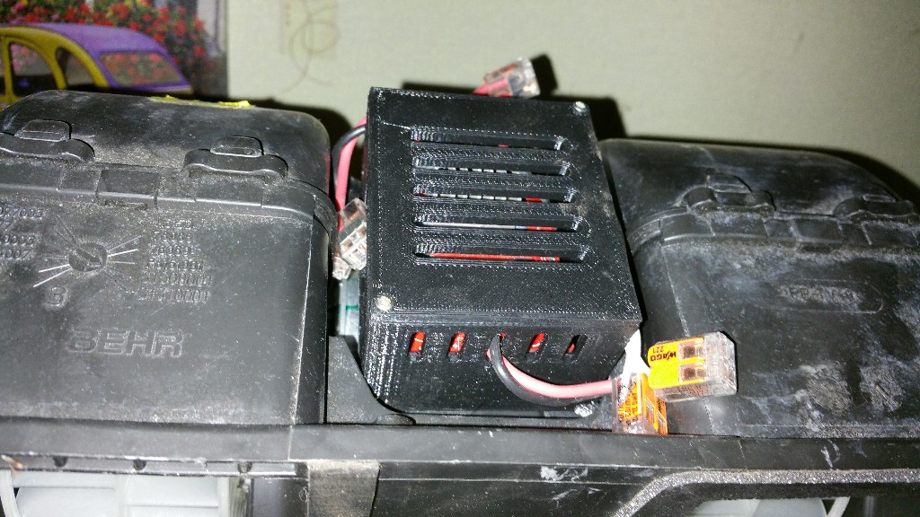

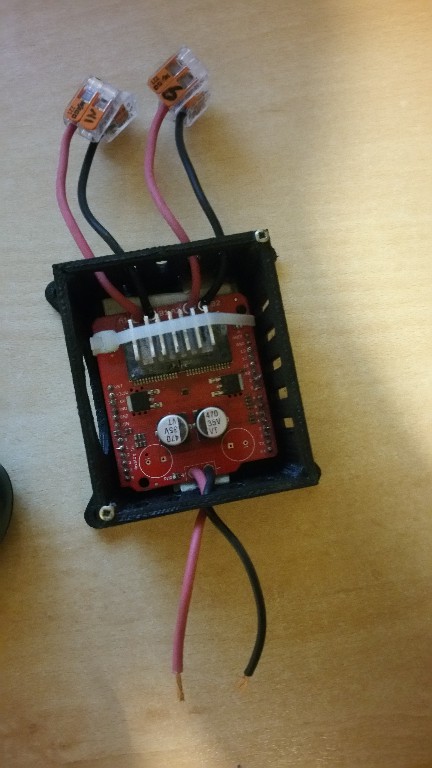

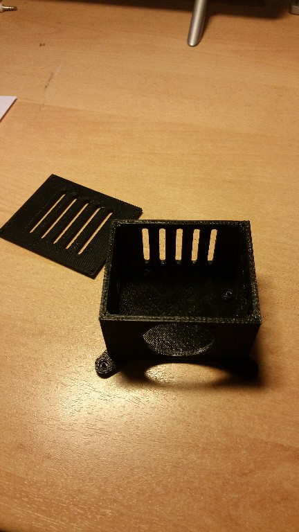

    I printed a case for the arduino and moto monstershield that I had removed from my first version simu 2dof 12v
  14. lemaitre
    lemaitre Member
    Jan 10, 2015
    62
    - 111Coins
    +41 / 0 / -0
    The case is just stuck

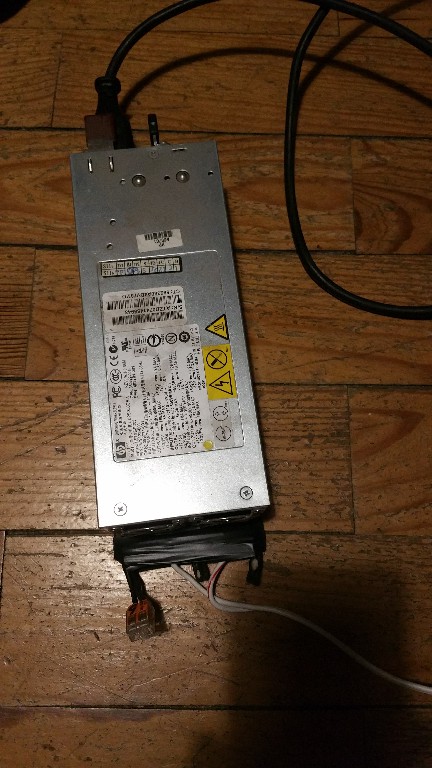

    Server supply

    interesting.... dont need a induction for blowers?
