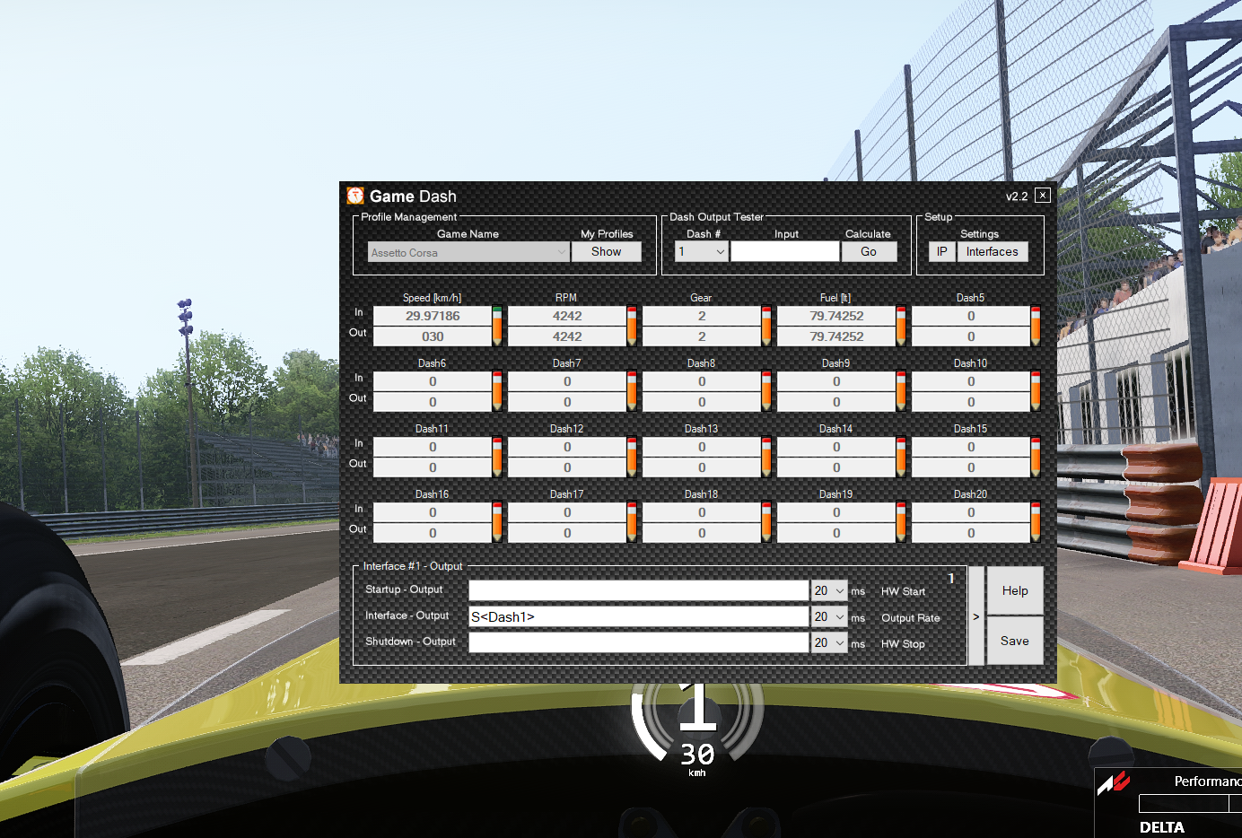

    Well ok i gave it a go, it´s doing something, but for sure not what it should..
    I used the arduino code and settings from the first post (Many thanks @SilentChill !), i got output from Simdash but the fan acts like it is off until i reach 255kmh then it starts to blow:)
    I test it using Assetto corsa so i deleted the Math value..
    Any ideas?
    Edit: i tested NL2 with same resoluts. I connected fan to motherboard and it runs ok. MM is probably fine also (the light at motor output goes more bright with bigger speed and vice versa..).
    Maybe i connected it wrong somehow - the fan cable has 3 pins, but i connected just + and - to MM - is that correct,,?

    Yes, the third pole is only for the rpm logging. I don't believe, that the fans are strong enough, but that is no problem, to change them later. Did you do a virtual test (interface output type), in the game dash tool?

    The virtual test, can be activated in this tool under "Settings/Interfaces" as a output type. But your screenshoot looks quit ok. For me, the fan you want to use is bad too, but because they blow not strong enough. To simply check yor electric setup, check your 12V output with a multimeter. The voltage should be simpley increase with the speed. My Assetto Corsa settings are:
    MATH * 9
    ROUND 0
    PAD 4 0
    For me that works perfect. On near 300km/h i have 12V Output. As fan i can strongly recommend the seaflow fans, that many people use here, including me.

    Thank you for info! Will try to measure the voltage at output and probably order the seaflo fan..:)
