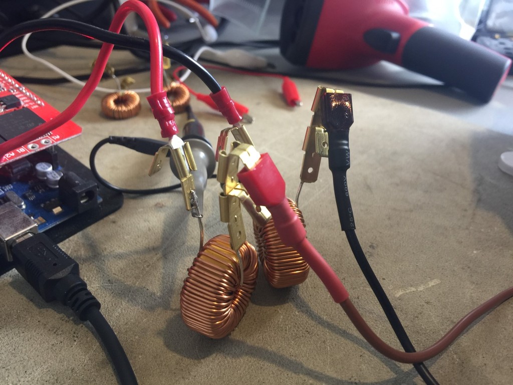

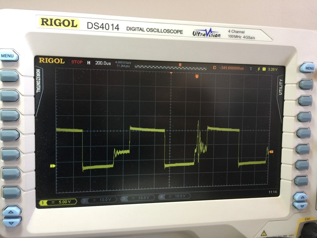

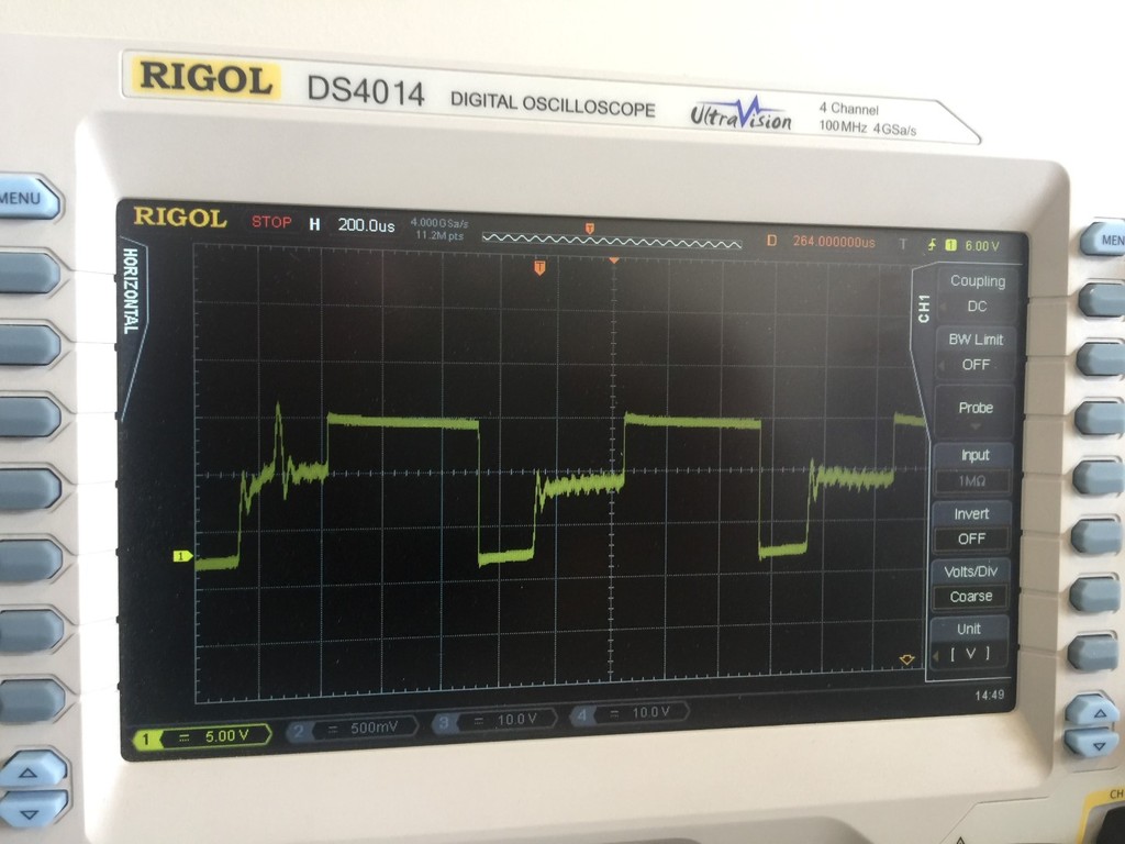

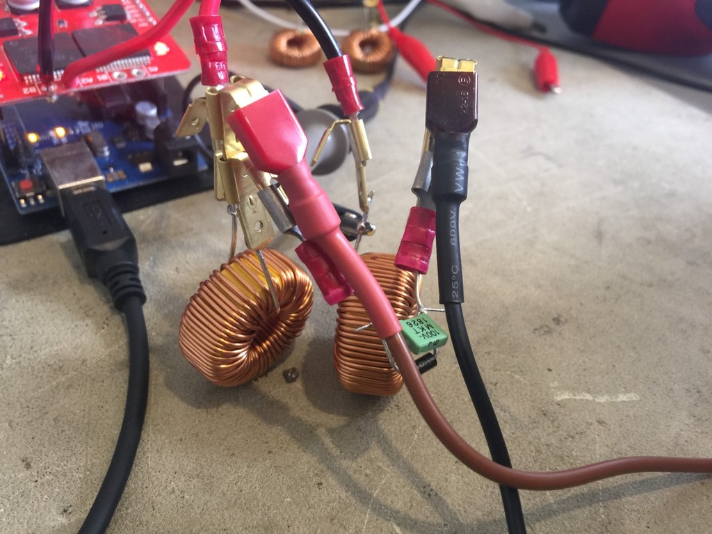

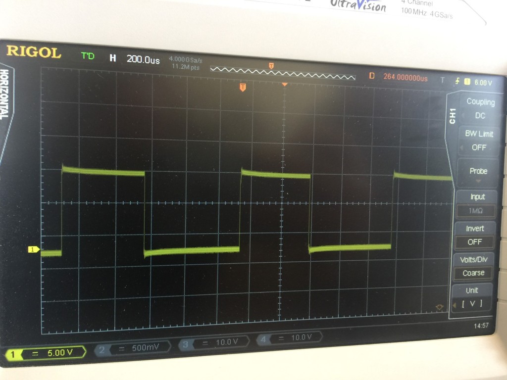

    Hey @Claudemir, I put chokes on my motor mains to help cut the back EMF when the SSRs turn off and so far all is good. The motor controllers generally do have snubbing but if you are running them out of spec (like I am), the snubbing may not be adequate. Chokes that can handle motor currents are pretty big and fairly expensive. I got mine from Coil Winding Specialists (http://www.coilws.com, these are the ones I used: http://www.coilws.com/images/HF5712-700M-60AH Rev.A.pdf) for around $30 each.
    As to killing sound, it might. You get lots of ringing on the edges of square waves. No guarantees, though. But my motors are as quiet as sleeping babies. You can see how big they are in my build thread: https://www.xsimulator.net/communit...-20-strut-jrks-wind-flying-driving-rig.11281/
    Like I said I overdrive my Pololu JRK 12v12 controllers but I’m at a year and a half of love without a single failure and I use it 3-4 times a week for a fair amount of time. Saving wear and tear on the controllers could be the biggest benefit at least for me.
