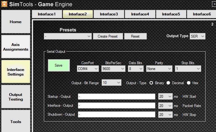

    @SilentChill thanks for the code. Can you Show me your interface details ? I saved like that but when I click to NL2 the fan start to turn at full speed and it doesnt stop even I close the simulator. I can read data from Dash1

    what is the settings below screenshot ? ( Below Comport )
    Do I need to write,
    Output - Bit Range
    Startup-Output
    Interface-Output
    Shutdown - Output
    and Pocket Rates ?
    Thank you

    Seriously everything is there in the first post . Nothing else to add just copy what I have put in the screen grabs

    it doesnt save the settings without writing,
    Output - Bit Range
    Startup-Output
    Interface-Output
    Shutdown - Output

    @lcturkey you are configuring the wrong interface(game engine).you need to configure the right one inside the game dash app. dont have this so i may be wrong but i think i am not @SilentChill will tell if i am wrong

    yeah i presumed he is using gamedash and not simtools game engine.
    You need to create a preset in the settings have you tride that @icturkey
