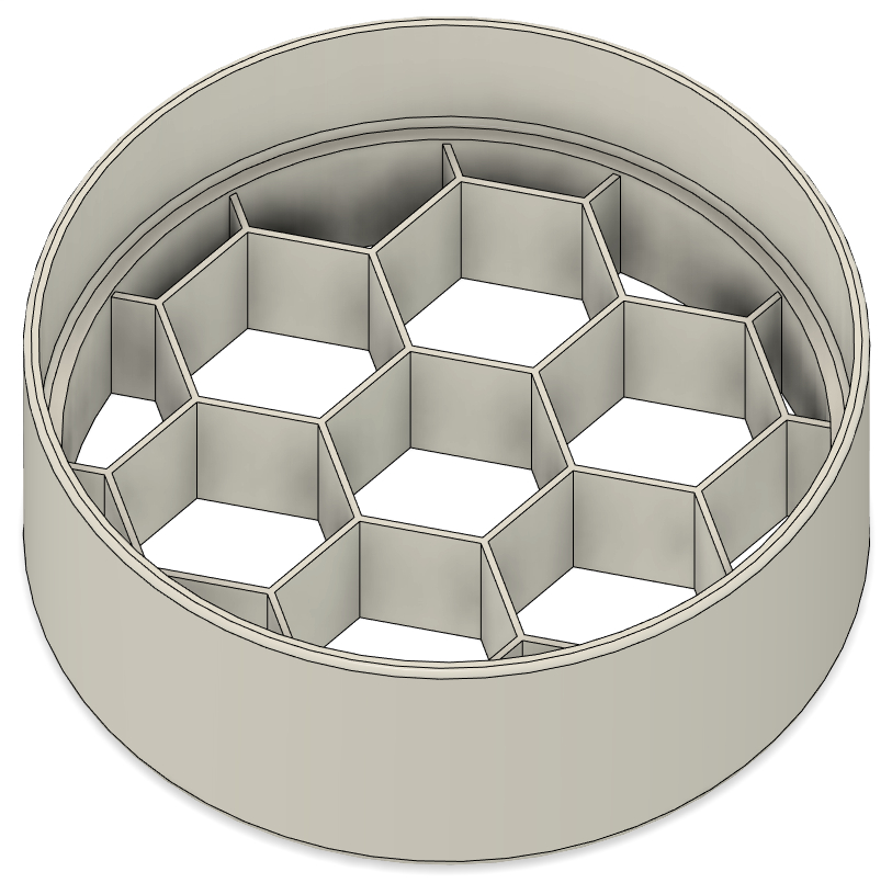

  18. Zed
    Apr 4, 2017
    1,040
    USA
    5,847Coins
    +1,043 / 4 / -0
    Here's that straightener for the SeaFlo fans... Wmacky used a bit of tape to tighten up the connection. Slips over the outside of the SeaFlo exit opening.
    @Wmacky - Hopefully the ID of the honeycomb exit area is correct now and matches the ID of the SeaFlow.

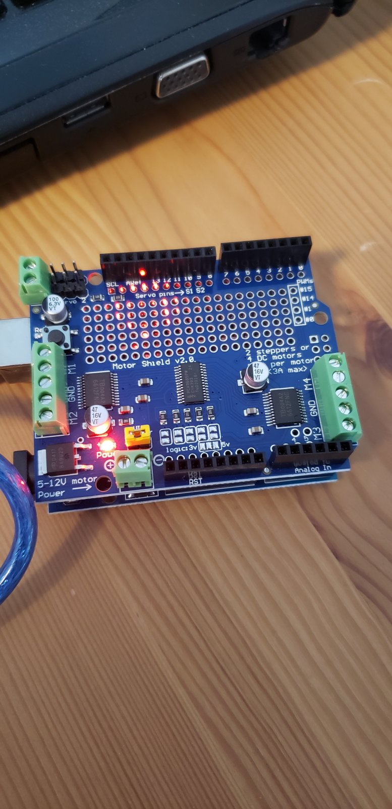

  19. Keith
    Keith Active Member
    Jan 21, 2020
    179
    Electrician
    Canada, Saskatchewan
    144Coins
    +83 / 0 / -0
    Hey guys. Will this software work with this motor shield?
  20. noorbeast
    22,202
    154,675Coins
    +11,209 / 57 / -2
    It would be easier to use SimHub, as that directly supports the Adafruit shield and will even write the code to the Arduino for you.
