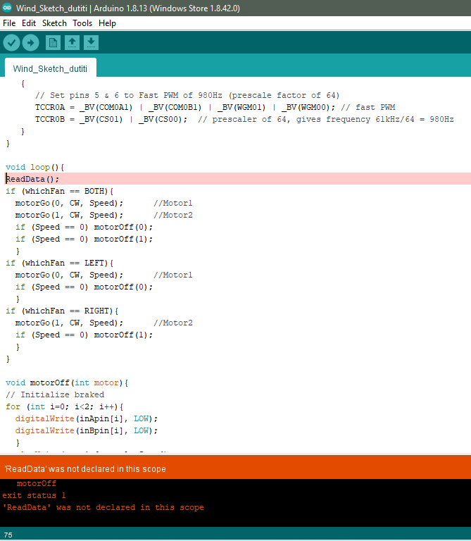

    Thanx and hi my dear @Zed,
    so cool you try to get my vents going, when I try the "dutiti"-sketch Icontinously get the error message as can be seen on the picture. what do you consider?
    I am happy with any feedback - and sorry I do not yet have any idea of coding :(

    @ART FLY - this might just be the compiler has gotten more picky about proper syntax. I’m not certain though. Today is a busy day for me so I won’t have time to look at it until tomorrow but I will. We’ll get you going. Looks like the array indices are fine so it’s not that. It looks like I just need to declare the functions properly but won’t know until I dig in and do some testing. Regards!

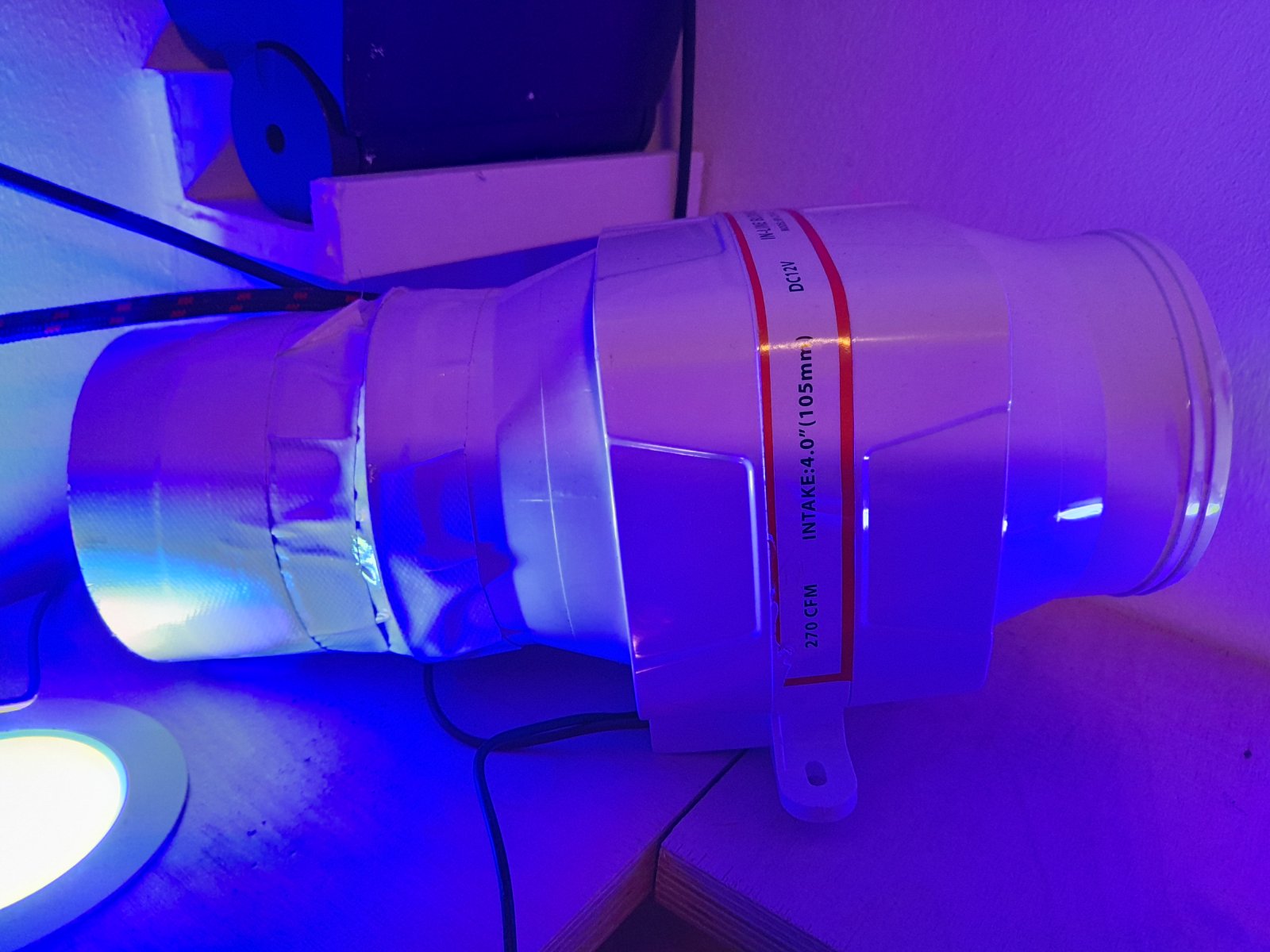

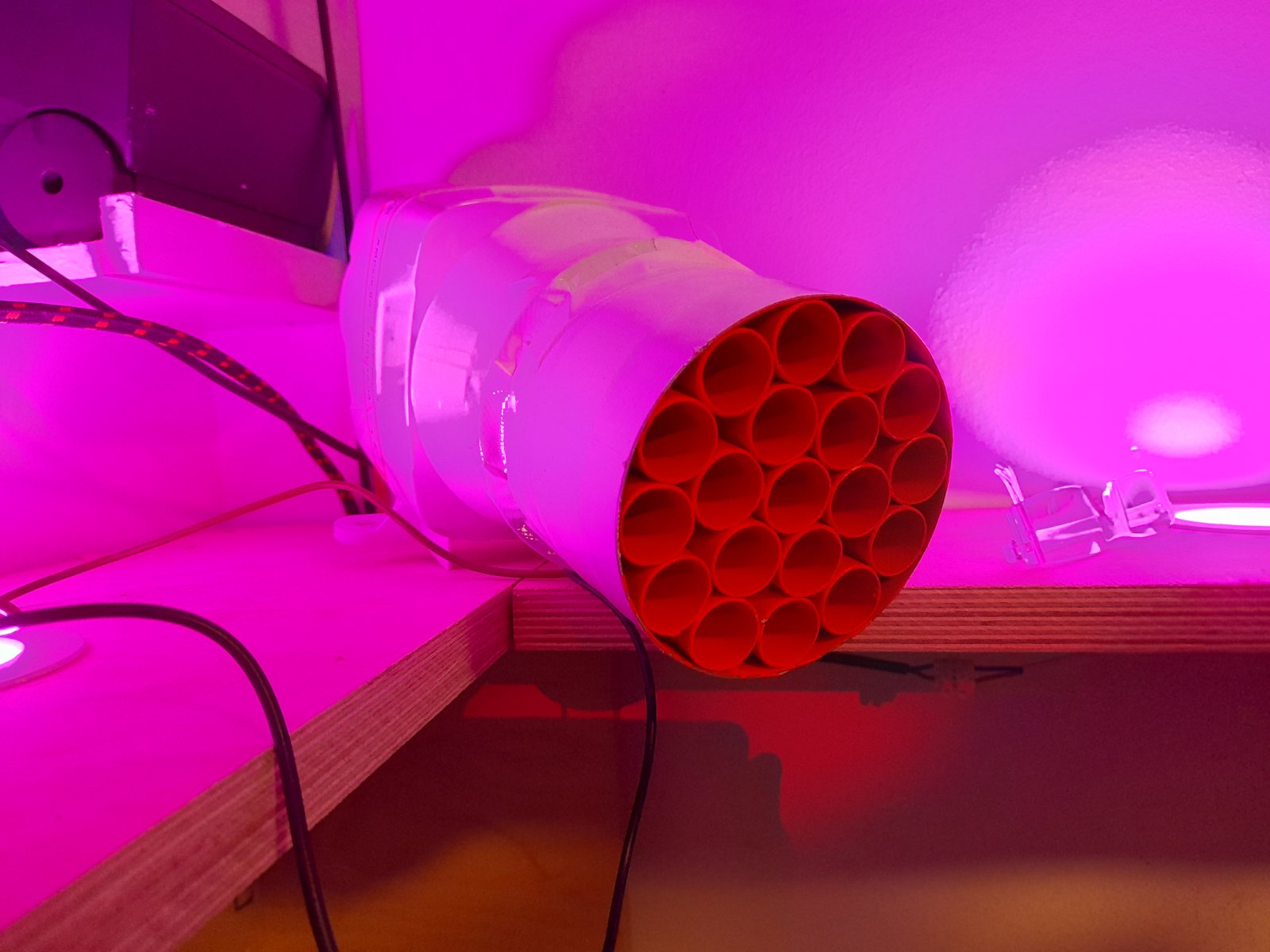

    Man that sounds great. Have a good working day. I wanted to test if it is my Arduino Uno that does not function right. So I wanted to swap it for another but I could only find anaruino Uno Leonardo. That made me mad and I turned around intensely and with my elbo I hit my last Uno that felt to the ground an popped of th whole USB connector . Aaaaarrrrghhh!!!!
    Iordered 3 new arduinos now. Might we be able to succeed with the Leonardo board too? If not you have at least a week befor you post gentle help for me again Thank you !!!!!

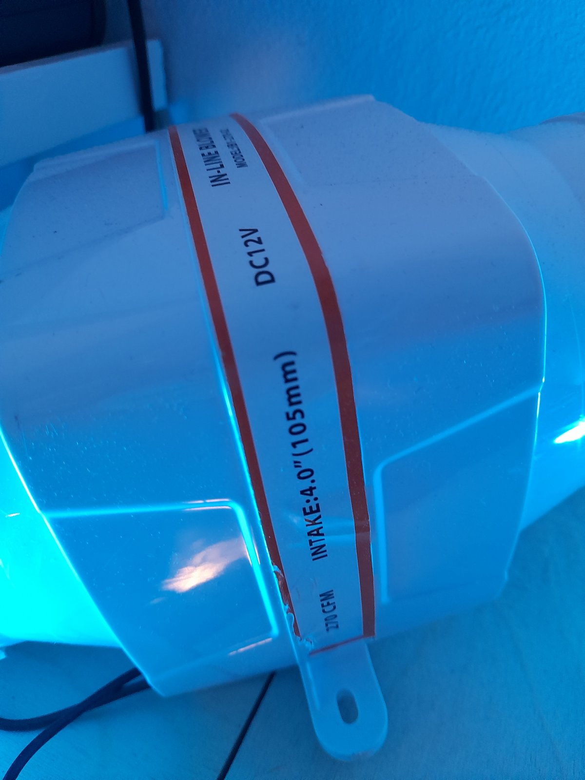

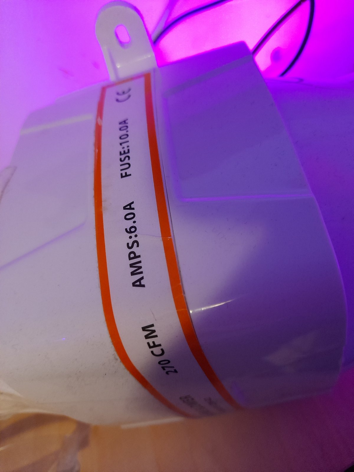

    P.S.: on the pictures you can see what I use as hardware. It is two of those blowers.

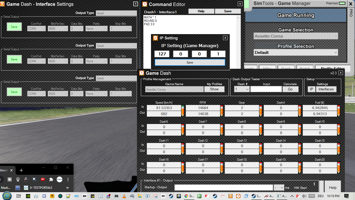

    We step forward ... a little :rolleyes:

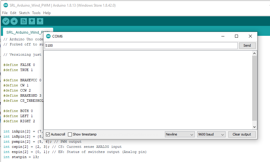

    I could upload the new code. I had to do the upload process two times but than it said Upload done. So I tried that serial monitor utility in the IDE Tools Tab without success. I started Assetto Corsa (ASC) and I tried it with Game Dash. ASC was selected in Game Engine, Game Manager and Game Dash. 'Tried Math without Math. I tried with 1. - tried with Math * 3 and with 5 no wind ... Game Dash was always showing speed, rpm and so on.
    So I tried with IP. I had it on my PCs IP but no wind. Than I changed IP to 127.0.0.1 also no wind.
    What else can I do to make the fans move :(

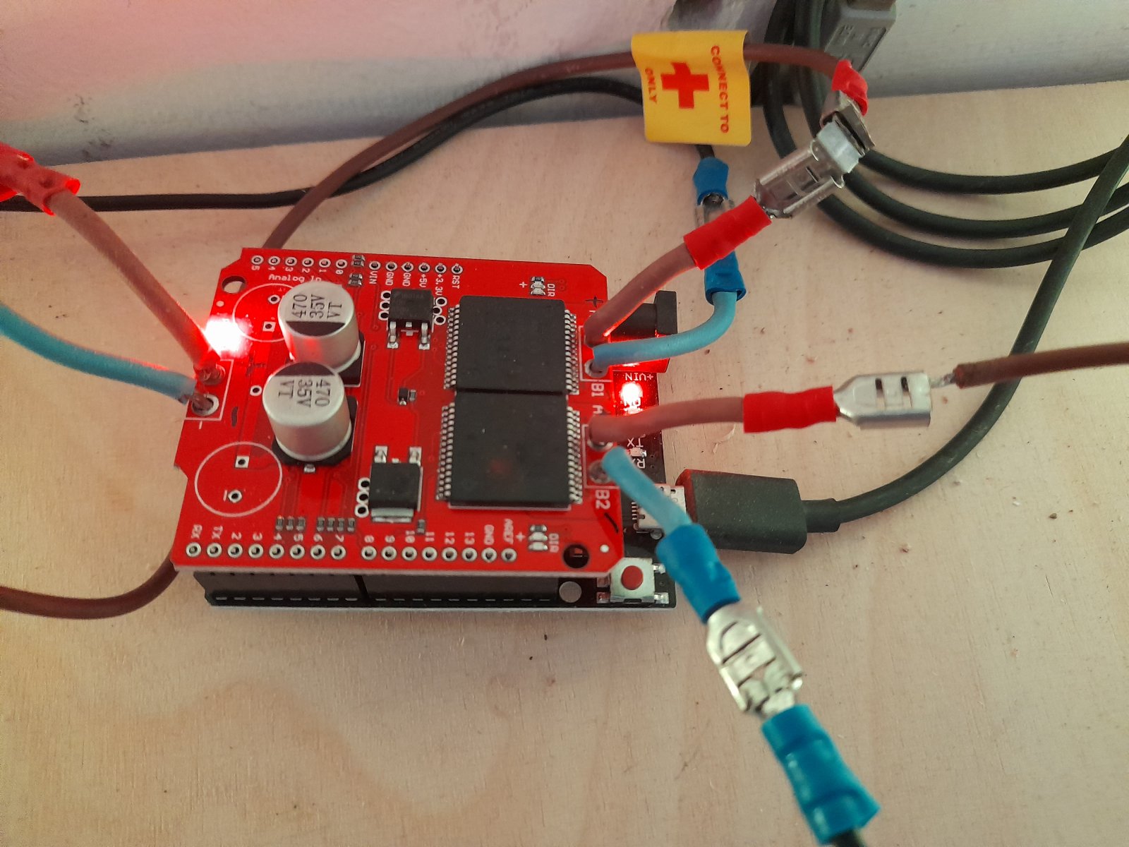

    @Zed and @noorbeast I send you some setup picts.
    Maybe I have a mistake there which you detect but I do not see.
    Again Thank you very much for the code that succeeds uploading :thumbs

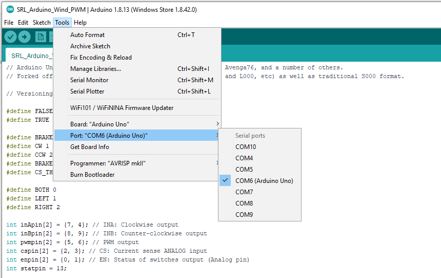

    Well, that’s progress. But I’d like to get the serial monitor working since that will let us know if the Arduino is working properly.
    Here are a couple of images from the Arduino IDE with that program loaded and making sure I'm talking to the board. Your com port may be different. I just want to make sure your displays are just like this because the serial monitor should shoot commands to the board reliably - if it's a good board. If your same menus both look like this (aside from comm number), it's probably the board. The S100 is what I typed.

    @Zed .
    Did you always solder the pins from the arduino to the monster moto shield ? I never did.
    And which pins do you really need. I always put on as many as possible to stick to the monster moto shield!?? Incorrect?
    Pretty desperate at the moment because I received my new uno-arduinos just half an hour ago ... it does not freaky work.
    So again check what the monsters do?
    I have a volt-meter but how do I check.
    I watched @SilentChill s video. But I could not understand/really hear ... as often what that master importantly says in his videos.
    HELP please !!!!

    The pins get soldered into the MM and press into the Arduino sockets. You shouldn’t need to solder them into both the MM and Arduino. If you got an Arduino version with no sockets already soldered in, you may want to get sockets and solder them in yourself. You want secure electrical connections but still able to separate the boards in case a part gets blown.
    I just looked back at that one photo above and none of the pins are soldered into the MM board. If you are still running like that, you need to fix that. That will never be reliable because those holes in the MM are bigger than the pins. Odds are many or even most pins are not making good contact. I missed that just glancing at it. You should never run circuits like that. It could even lead to dead boards since you can have circuits with power but no ground, signal but no ground or power, or any odd combinations. These things can work well and be reliable when built properly but you can kill boards if not properly connected. Sorry I missed that, and no guarantees that anything died. It could all be fine. But it’s risky to connect boards like that --or not connect them as the case may be. Solder the pins in the MM. You also don’t want to make or break connections when power is applied unless you know what you are doing and accepting the risk. That MM is powered up with possibly flaky connections so any movement could change things under load.
    As to how many pins to use, I usually put pins in all the connector holes in these applications. It’s overkill but makes for a secure press fit of the two boards and doesn’t accidentally omit critical connections. But I don’t use an MM board with the TerraBloom fans on my rig. I started with one and it had all pins filled, though. Now I just use individual pin connections between the Arduino and a level shifter board but I only need power, ground, and PWM outputs. No direction signals are needed for me but they are with the MM since that is frequently used in robotics applications. The MM has some extra connections that are required besides PWM - like direction for each bridge chip - but there may be more. You would need to check a MM schematic to see what pins are at least wired in from the pin headers and make sure those are connected if you don’t want to populate them all.
    Can you be more descriptive of what doesn’t work? Could you compile and load the firmware? Could you send commands using serial monitor even though the fans may not have run? Just saying things don’t work forces me to have to ask questions shotgun because I don’t know what step is failing for you so I have to cover all bases and all possible problems since there is nothing to localize what is wrong. Photos of your setup, screen grabs of error messages, etc, can also really be helpful.
