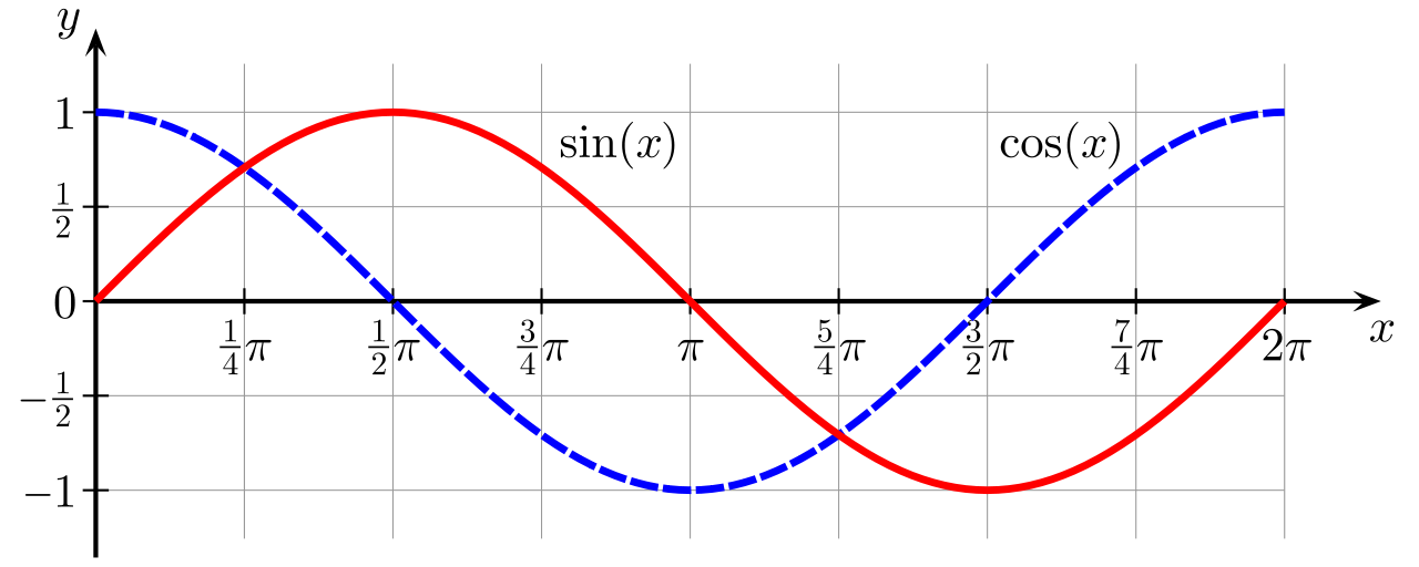

    Here it is. This is a TEST/DEMO firmware strictly to let twin fan wind users try out differential wind. The wind is purely fictional/demo and doesn't use any communications with GameDash or SimTools. You have to use the Arduino Monitor utility to send it one valid command (doesn't matter which one but "S000" (cap ess-zero-zero-zero) is an example for those unfamiliar).
    To beat this horse thoroughly, this is only a demo of differential wind. Once you program this, to get back in action you will need to program your wind Arduino back with whatever code you loaded originally/last. This firmware is not a replacement for your present firmware for actual sim use and won't work for sim use.
    All this code does is wait for a valid command, and once it gets that it starts cycling the right and left fans according to a sine and cosine function - forever. It takes a reset, power off, or downloading new firmware to stop it. One fan will lead the other by 90 degrees in trigonometry speak as they both cycle from 0 to 254 wind speed. That lead/lag bit will let you feel the differential wind but not full on 180 degrees out of phase where one is full speed and the other is off at various times in the cycle. In this routine, when one fan is at max (254), or min (0), the other will be at mid value (127). So the most you will experience with this code is one fan at max and the other fan at half, or half and zero, etc. It will look like this in terms of wind speeds from the two fans:
    For anyone interested in the code, it really is just a sine and cosine, corrected for offset and scaled proper for the fan speed PWM signal and it just steps through angle values at an arbitrary rate. I meant to put a 50ms delay in the loop so it would approximately match the GameDash 50ms command spacing but in rechecking the code, I see I left that out. That explains why I had to play with the angle step size. There's also a Serial.println(SpeedL) still in the code but that might be handy to watch the numbers for fan speed scroll by. Those were both mistakes I see now but it runs fine on an Arduino Uno. Anyone running on a different clock might see slightly different behaviors. Sorry about that but only noticed it when writing this stuff. I knew what I wanted to do. It just wasn't what I did entirely. :oops:
    Curious what you guys think. Close your eyes and see if you can tell what's going on. :popcorn

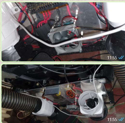

    @noorbeast and all of You
    dears
    ivo from italy
    i am a complete noob on these wonderful things
    i have bought a used kit for simulated wind that was built following this topic
    the previous owner used it with simtools
    i want to use it with simhub since there i manage already shakers, buttkickers and vibrating pedals
    i usually use iracing mainly
    BUT..... i am completely ignorant of what to do.....
    my pc sees the wind sim as COM7 but i think i must manage the "stetch area"...
    but i do not know in which way
    Do someone has already done and is able to drive me ???
