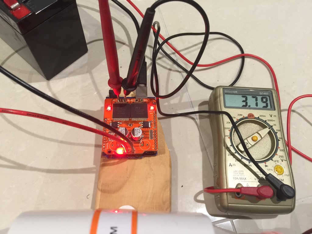

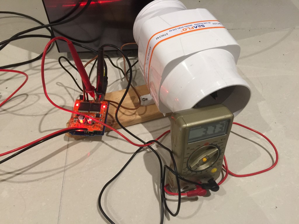

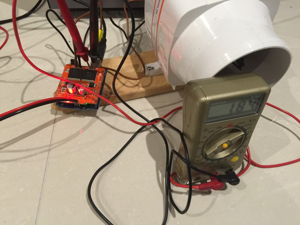

    I tried a new MM and new Arduino and still the same problem.
    I didn't bother hooking up the blower, just connected my multimeter up directly.
    When I plug in the Arduino both motor show 1.8v and then when I launch the game both motors go up to 3.8v and just sits there until I unplug the Arduino.
    I just want to make sure I am loading the code correctly. I am using the Arduino IDE and I use that to load the .ino file then I select the right comm port then click the upload button, is that all I need to do? No other steps? It says "Compiling sketch" then "Done uploading" so it looks like it is uploading okay.

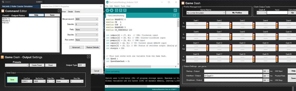

    I am running 9600,8,N,1 like in the first post in both the Dash app and the windows device manager.
    Here is a screenshot of my settings in case you can spot anything that I have done wrong.

    Doh, I found what I was doing wrong. I put "PAD 3.0" instead of "PAD 3 0" which was causing the GameDash and Arduino to crash. (You can see the mistake in the screenshot I posted above, dang 1440p monitors making it hard to read small screenshots :mad:)
    There is still something funny with the first MM I used, When it is in the Motor Off mode which is 1.8v then only one of the motor lights is on, on the second MM they are both on when idle, In game and as soon as you start moving then it works perfectly.
    I will post a video of it shortly working with 1 blower, then I will add another blower

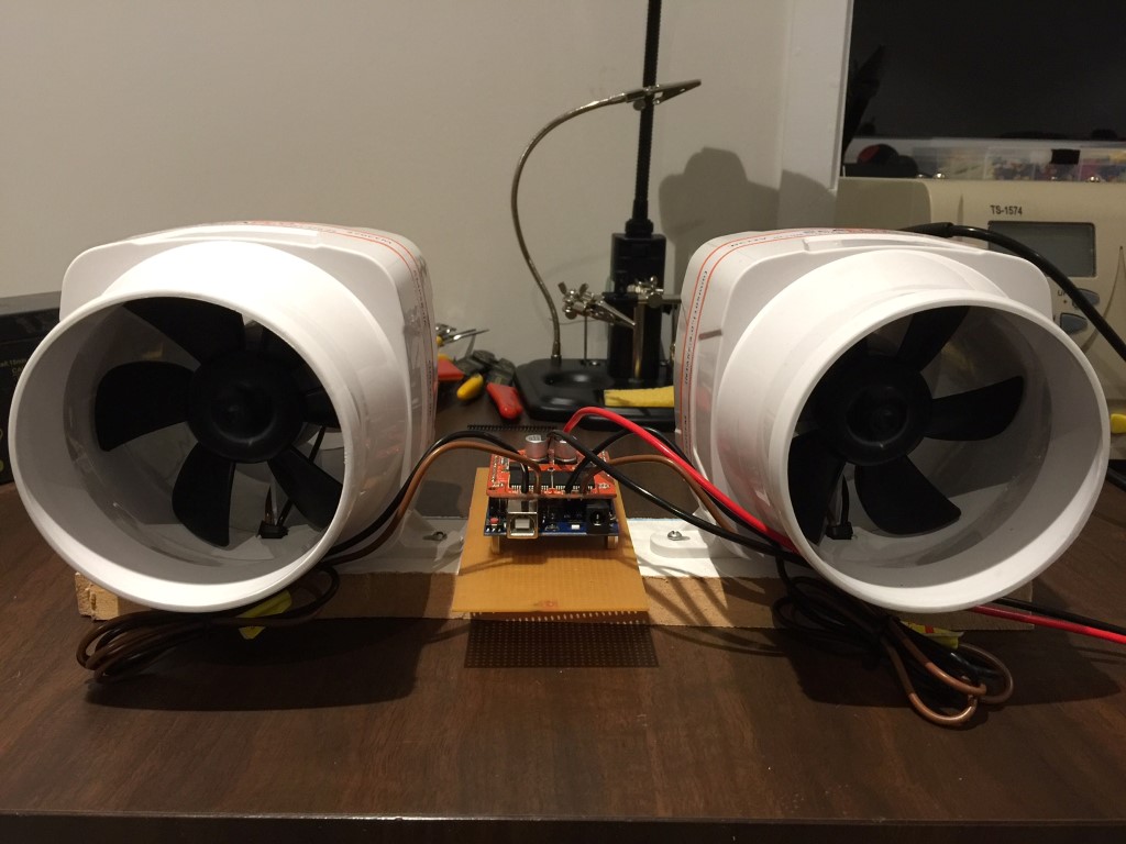

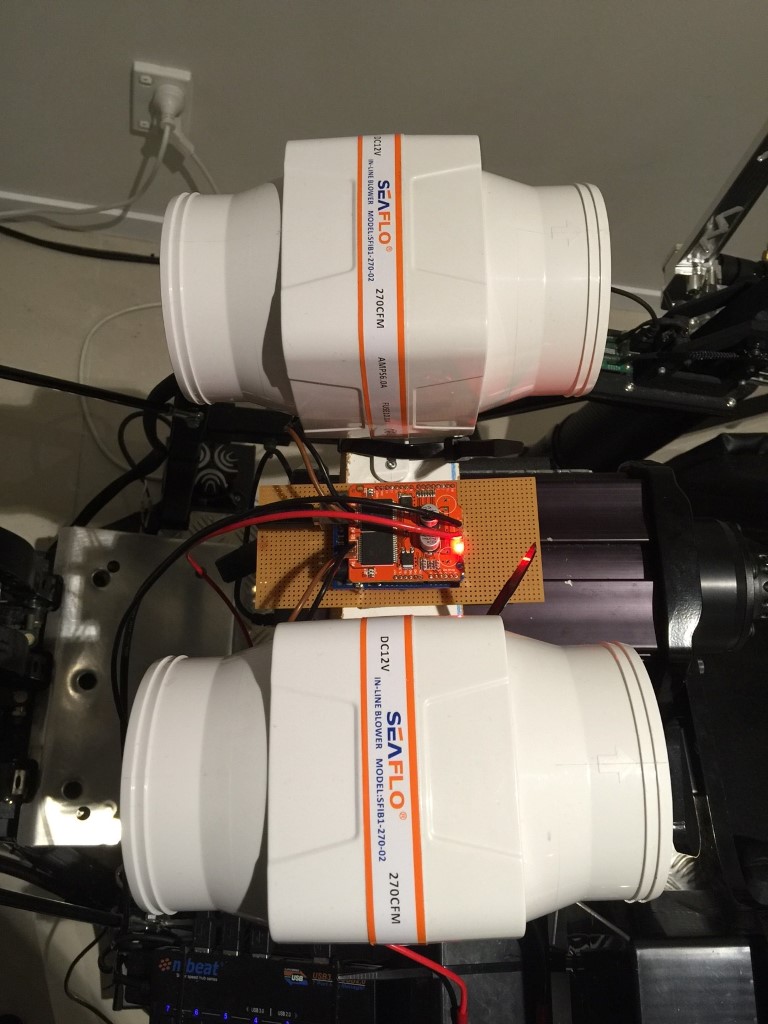

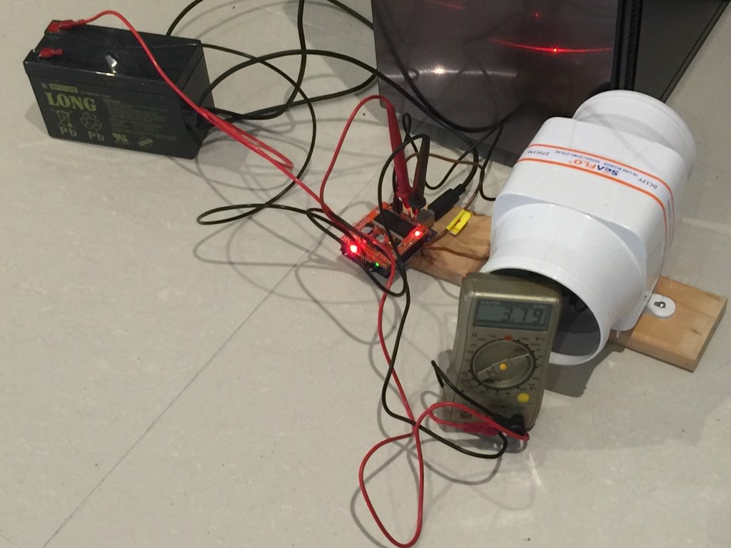

    Awesome!! There isn't anything wrong with the first MM, that motor light must be an error light because once I connected both fans up then both motor lights are off until I start moving then they both come on. It must have just been saying I didn't have a motor/fan attached because when I was testing the other MM both the lights were on when the game wasn't running.
    Here is a test video with one blower and the multimeter hooked up to the second motor port.
    And here is a fun little video of both blowers vs a toy car, it reminded me of that Mythbusters episode when they drove a car behind a jet place.

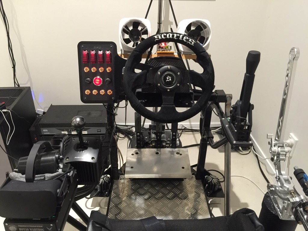

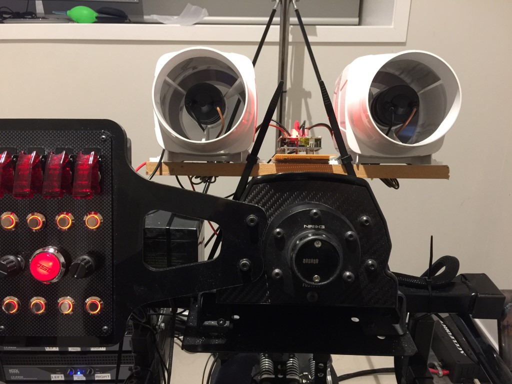

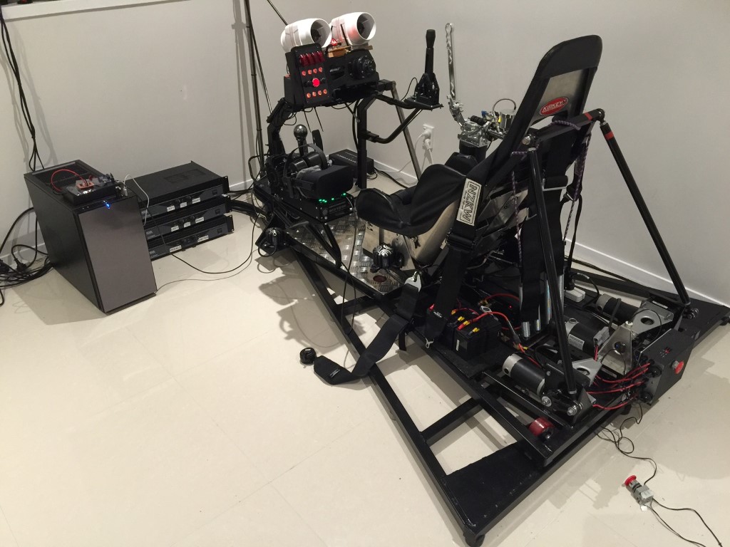

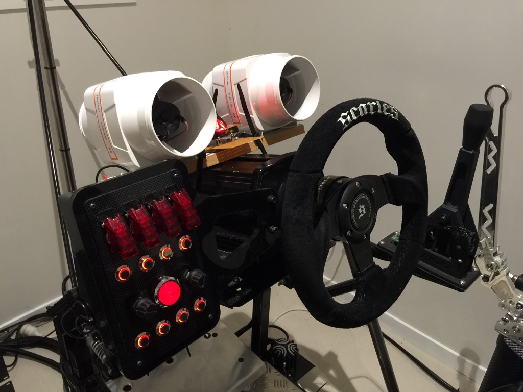

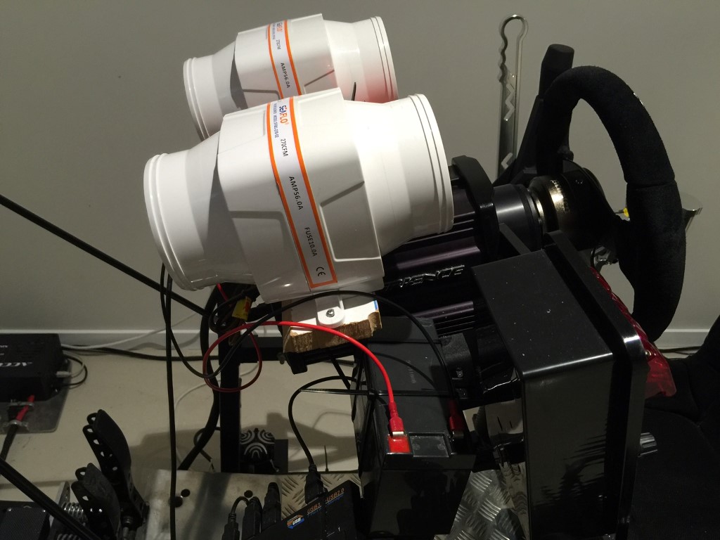

    Some photos of my prototype.
    I am really happy with how it is all working now. I am going to mount them my rig and run some ducting and make a defuser.
    One other question. Would it be possible to change what happens when the output goes over 255? Currently if it goes over 255 then the fans will just stop, it would be good if it just stayed as full power if it goes over 255. It just means I will need to change the maths for REALLY fast cars or coasters, like in that video above I can get away with Math * 10 but on faster steel coasters I need to drop it down to around 8. I guess I just need to find the fastest coaster and set up my maths based it's top speed.

    Now I just need to mount them to the rig, buy some ducting and make a defuser.

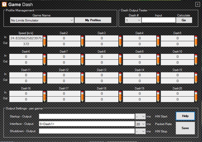

    Here is an example of when I have the maths too high.
    You can see that the output for Dash 1 is 372 so that is being clipped down to 255 which is full speed, I wouldn't be able to tell the difference between 272 and 372 because I started clipping at 255.
    For this coaster I use a math of 10 times so normally in this fastest section of the track I would be at 248, very close to max, that is how you want to tune in and then this new code just means that if you creep over that 255 limit then it will clip instead of turning off the motors. In this demonstration I increased the maths to 15 times just to show the clipping.

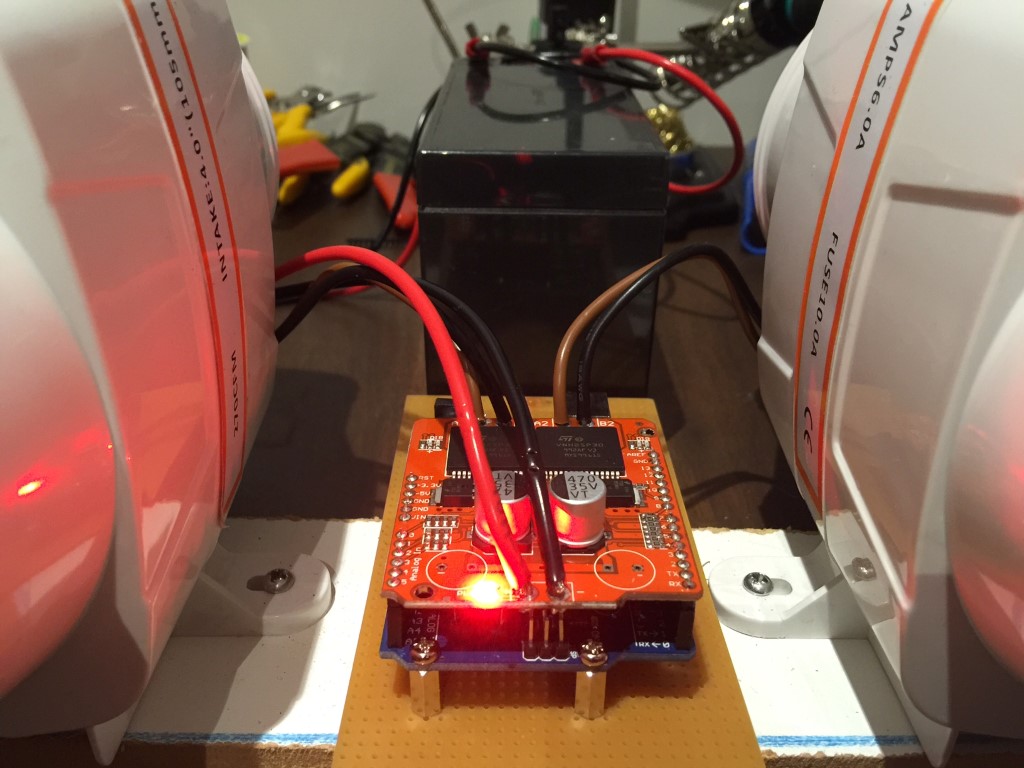

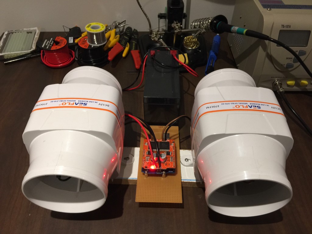

    I wrote a more detailed guide on how I did the hardware side of the project so will post it here in case anyone wants to see how I did all the wiring and mounting.
    This is a wind simulator that will vary the amount of wind based on the speed of the car.
    It is built using an Arduino Uno with a Monster Moto shield. It runs off Sim Tools which also runs my DIY motion and it works with any game that outputs the speed telemetry, so it works with iRacing, Dirt Rally, PCars, Assetto Corsa, No limits roller coaster, AMS and tons of other sims.
    The Arduino code was written by SilentChill over at the Xsimulator forums and you can find it here https://www.xsimulator.net/community/threads/simulated-wind-using-monstermoto-and-arduinouno.6876/

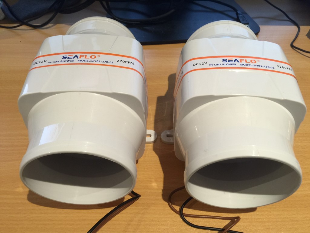

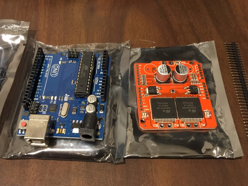

    I started off with the base components. I am using a pair of Seaflo 4" In-Line blowers. They are 270CFM each, they run on 12V and pull 6A each, they were around $29 USD each.

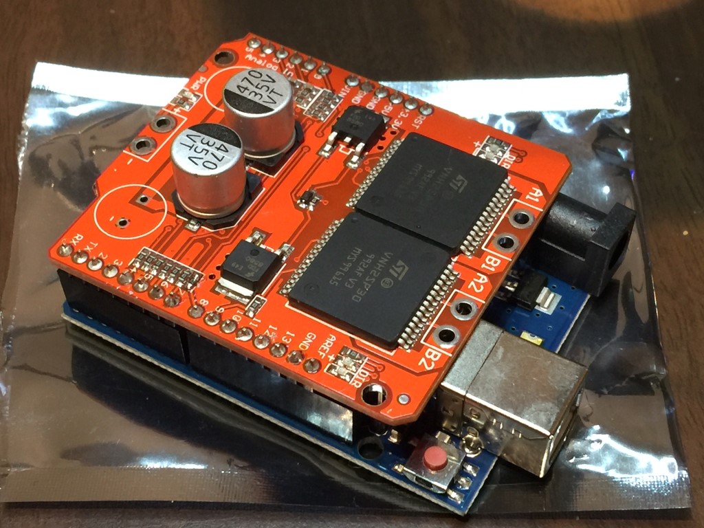

    For the controllers I am using an Arduino Uno and with a Monster Moto shield. I got them without the header pins attached because I will be used some more of them for an upgrade I have planed for my DIY motion simulator
    They are really cheap off ebay, $5 for an Arduino Uno and $8 for a Monster Moto so I brought a ton of them so I can also replace the JRK 12V12's in my motion sim with dual Monster Moto's

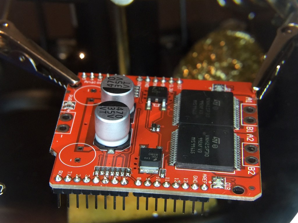

    It is really easy to prep the board, just solder the header pins on then wire in the power and fans. If you look on the left side you will see the + and - for the power supply, and on the right side you with see A1 and B1 for the first fan and A2 and B2 for the second fan. The A is positive and the B is negative.
    The Monster Moto then just plugs in on top of the Arduino
    After wiring up the first fan I did a quick test to see if it was all working, I have just connected it up to a battery for now. Once I have finished my design I will wire it back to the batteries that power my DIY Simulator.
    Here is a video of it running with just the one fan in No Limits roller coaster. I have my multi-meter hooked up to the second fan controller so you can see the voltage vary. It uses PWM so it is actually the duty cycle that is changing but my Multi-meter shows it as the voltage changing.
    Next I made a prototype mount for it, just using some wood and a blank PCB I had laying around
    The controllers all wired up, you can see the power from the battery at the front of the controller then the power to the fans going out the back of the board.
    This is the back side of the set up. The fans blow towards the motor on the other side.

    I then temporarily mounted the fans on top of my Accuforce.
    For now while I am testing I have just cable tied a battery up the front of my rig, it is a 9Ah battery so it should be able to run the fans for a couple hours between chargers.
    It is just secured on with cable ties at the moment. eventually I will make up a mounting plate for them and just run some ducting up.
    I will also make an enclosure for the controllers
    Here is a wide angle shot of my rig with the fans installed.
    The project cost about $70 USD in parts and one evening to do the electronics and another evening to do the mounting and testings.
    You could easily do this as a one day build project and at only $70 in parts it is a very cheap DIY project.
    It adds a lot to the immersion and it also helps keep you cool. I use the Oculus Rift CV1 so it helps a lot with keeping me cool. It is great for open wheelers and roller coasters.
    At the moment I have the fans mapped so 255KPH is max fan speed so it will ramp up from 0-255KPH and then anything faster than that will have the fans on max, you can adjust this in the software easily.
    You can really feel it as you slow down for corners then you can feel the big rush of wind as you accellerate out of the corners, I was trying it at Nords in the HPD last night and it feels like you are really flying down the straights and you can feel how quickly the car accelerates out of corners.[/quote]

    I still cant get it to work, I have PMed you if you have the time to answer. I have mapped the game right, hocked up the plugins, your full arduino code is Copy/Pasted and uploded = Done , and Everything says Game Running..
    Were do i Go wrong ? Wonder about the MM and Arduino if the parts working when the sims running ? Any Led that should indicate that it's sending signals ? When I connect the fan the green led on the side turns off and no led is lighting on that side after not even when sim is running ! Sound right or wrong ?
  20. Avenga76
    Avenga76 Well-Known Member
    Jun 29, 2014
    518
    Network Engineer
    Auckland, New Zealand
    3,262Coins
    +859 / 6 / -0
    I replied to your PM but I will answer it here in case anyone else has the same problems.
    I am colour blind so I can't tell the colour of the LEDs but if you have the fan disconnected then you will get an LED warning light, if you have the fans connected, while idle there should be no LEDs next to the motor drivers, then when you start moving there should be a more different LED come on beside the motor driver chips.
    Do you have a multi-meter?
    If you connect the multi-meter up to an empty motor driver port then you should see around 1.8V like this
    If you don't then check the Arduino code is uploaded okay.
    Next you need to make sure that the Game Dash is seeing the data. If you open Game Dash you can see the data, Dash 1 is what we care about. You need to make sure you do the maths right in the command options, you want that output number to be UNDER 255, 255 is max fan speed so if you go over that then the fan will stop if you are using the code on the first page, I wrote some code on the last page which puts a limit instead of turning the fans off but for now just try with the maths low enough so the out is UNDER 255
    Next check you comm port settings and dash setting are right based on the first post in the thread.
    Then do a test in the game, run the game in a window and have the dash open so you can see the value of the Dash 1. Watch your multimeter and you should see the voltage going up and down like this test. I find No Limits is good for testing because you can just run it on autopilot and you don't need to drive a car or anything so you can watch the dash and multimeter
