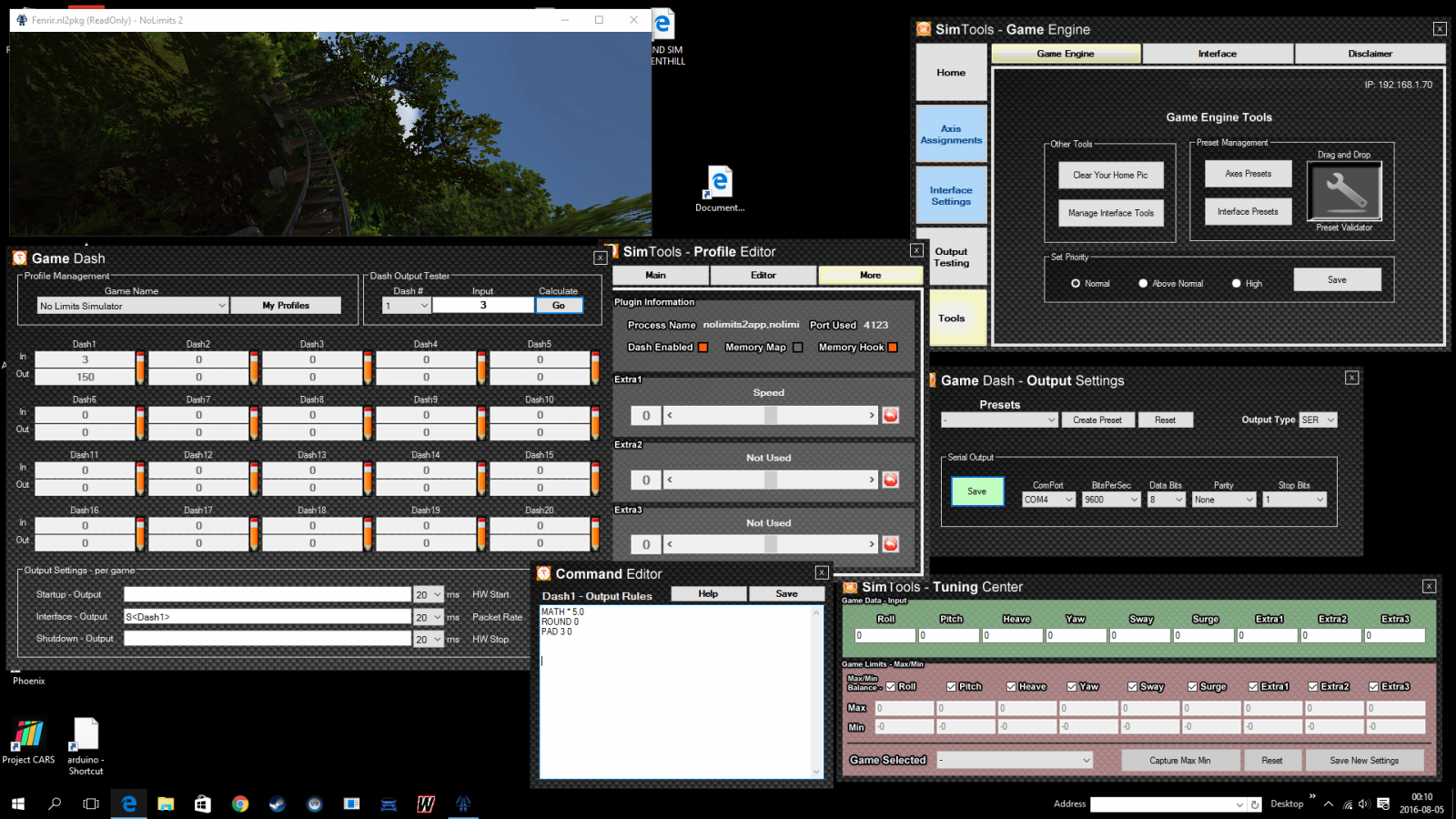

    Check that you have the dash enabled in the game manager
    Instructions to do that here https://www.xsimulator.net/community/marketplace/game-dash.76/
    Next, run the game in a window and see if you see values in the dash like this, the value in the out of dash 1 must be UNDER 255. It should be a 3 digit number like 057 or 126, 0 being fans stopped and 255 being top fan speed. If the number is wrong then check the maths, rounding and padding

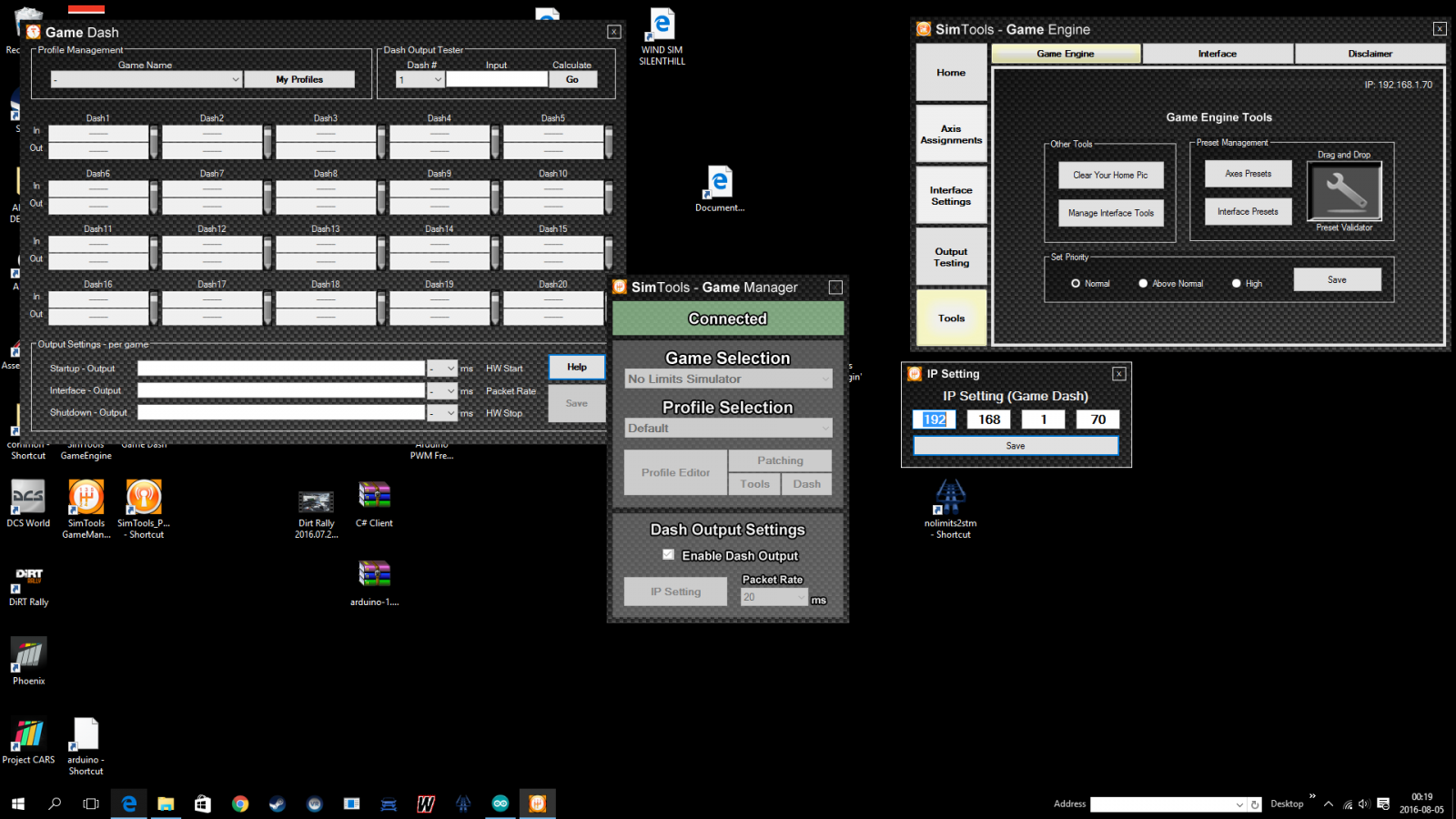

    Take a screenshot of your comm settings and you maths settings and I will check them

  6. andpal
    andpal New Member
    Oct 8, 2013
    21
    300Coins
    The fan is getting stuck when i take to high values in test.. it frezzes and wont stop or speed up.. and I have to unplug the usb Cable to the arduino UNO card to make it stop..
    Maby a Clus.. And I'm sorry I hope I have chosen the correct IP ?.. Taking a screen ump on that aswell

    For the IP, can you just try the local host IP address 127.0.0.1
    Also try it with just "math * 5" instead of "math *5.0"
    Looking at your first screenshot the maths does look wrong. if you put in a 3 in the tester then it should output 15, but it is outputting 150 so I think it doesn't like decimals

    It will be your maths. based on the first screenshot, "Math * 5.0" actually times it by 50 because it is ignoring the decimal point, that is why when you put in 3 in to the output tester you get 150 out (3*50=150) So you will be instantly going over the 255 limit. It should just be "Math * 5 so you should get 15 in the output (3*5=15)
    For iRacing the in is in KPH so you probably don't need to do any maths unless you are going over 255KPH.

    THANKS ! IT FINALY WORKS AND IT'S AMAZING :D
    Time to try around diffrent setings to tune it in and some sims, again thankt for your time and Quick answers !!

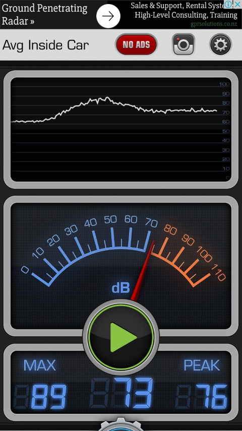

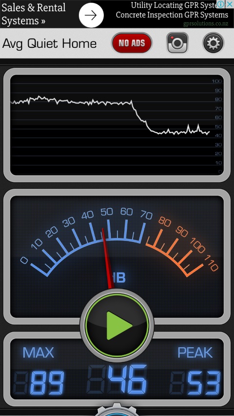

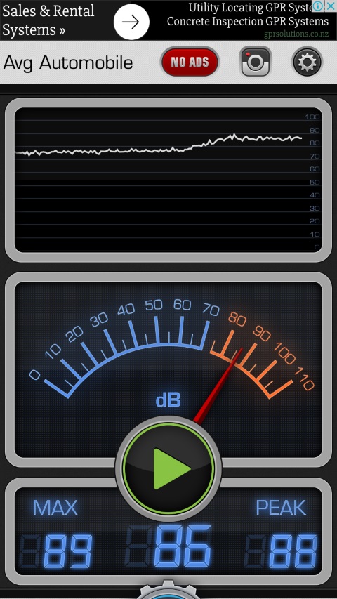

    Someone asked the same question about noise over on the iRacing forums so I will post it here
    I did some testing with a little app on my phone, not the most scientific but it might give you some idea.
    This is standing beside my rig, probably about 2 feet away from the fans.
    This is as you come over that first big dip at the start of my video so the fans ramp up from a slow speed to full speed then back down to about 75%
    This is one of the faster sections in the middle of the coaster
    And this is when I switch off the fans. Note: this is with all the rest of my gear off, I have a bucket load of cooling fans on my amps, DIY motion and Accuforce so my normal ambient sound levels with the wind simulator off is around 68dB so the wind simulator isn't that much louder then the rest of my rig.
