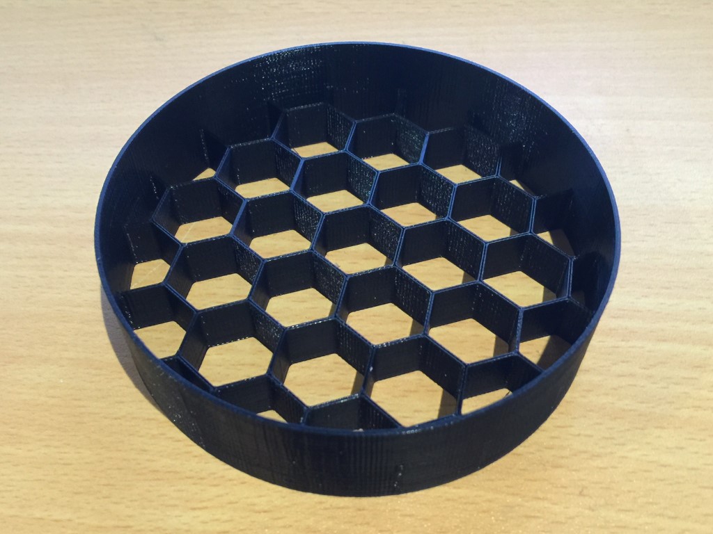

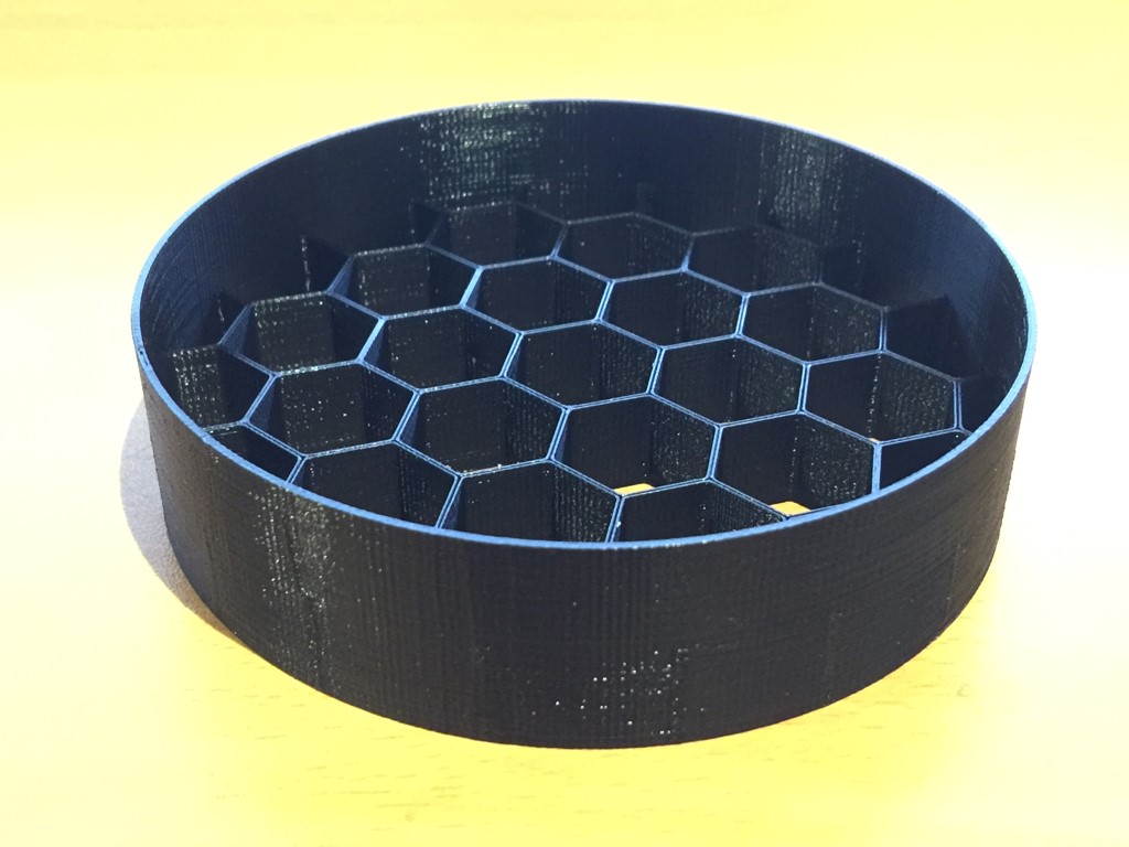

    I brought myself a 3D printer so I can design and print parts for my rig.
    I created my first prototype for my airflow straightener/vent for the end of my ducting.
    I printed this at one quarter height just to test the wall thickness and strength. The final version will be 100mm tall and 100mm diameter.

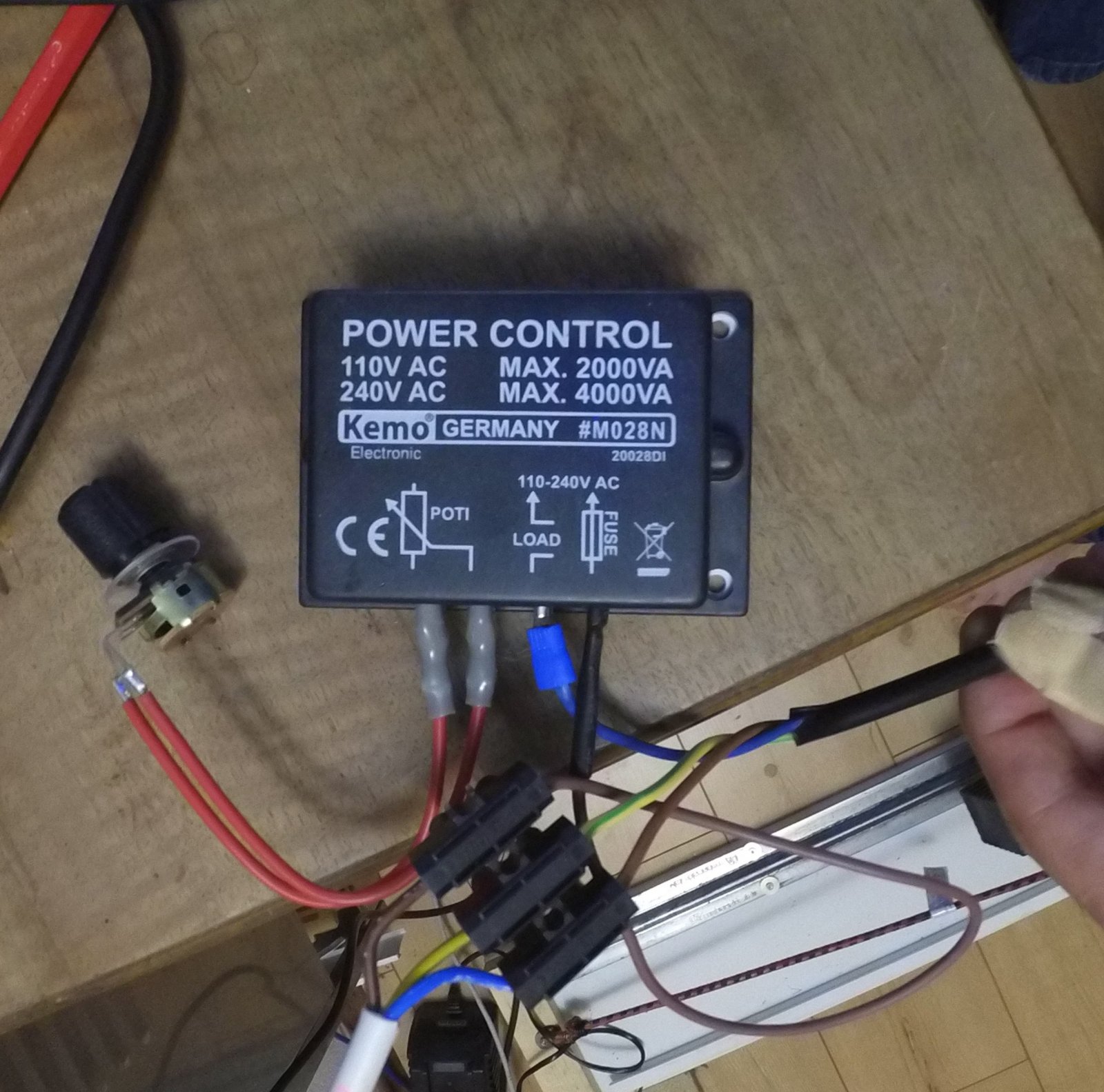

    Hi guys, my wind ventilator is ready to go, the power control works. Now I have to add the arduino, but I have only one "5V" (AFAIK) line without GND (potentiometer), so I dunno how to connect the power control with the arduino - @Alexey? @speedy? :) Thx
  13. Pit
    3,007
    30,517Coins
    +3,098 / 31 / -0
    I did some research, obviously an Arduino cannot measure a rheostat as we can do with a potentiometer. A rheostat is a two terminal adjustable resistor. A 3 terminal potentiometer, wired correctly, is a variable voltage divider. An arduino analog input measures voltage and not resistance.
    Ergo a Rheostat is a single resistor, pot is acting like two resistors. :( I have to look for some other wind sources...
