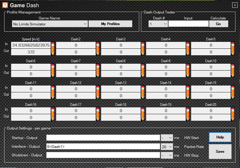

    @SilentChill all is working fine, successfully tested using a VNH5019 motor driver. Only the MATH is still out of function for me, tried different settings like
    MATH * 2
    or
    math * 2
    or
    MATH * 0.8
    etc...
    but the fans does not respond to the speed of the car. Any suggestions?
    When driving AC without the MATH all is fine, but the max. value 255 stands for km/h so if faster than 255 the fans are stopping. Honestly I would suggest to integrate a variable which holds the motor at max speed without shutting them down if the max speed is approaching. What do you mean?

    I have posted a modified version of Silentchills code that fixes this. I just added "if (SpeedGameDash > 255){ SpeedGameDash = 255;} " so if the game dash output goes over 255 then it will just keep the value at 255

    @SilentChill I dunno what happened but now the math is working...lol

    I will update the original upload when I am home with the 255 limit make it easier for everyone.

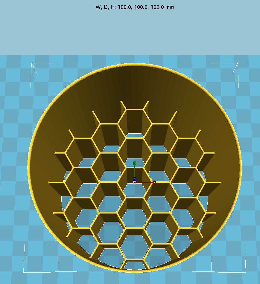

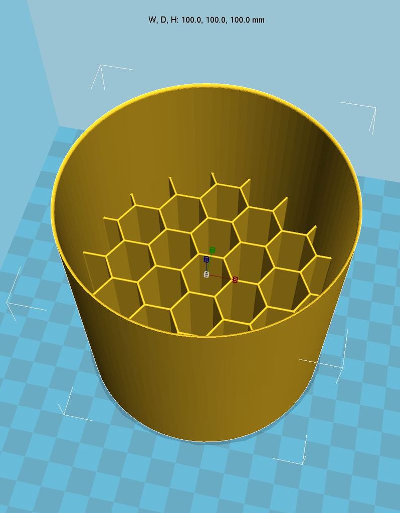

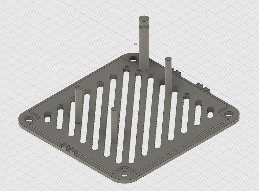

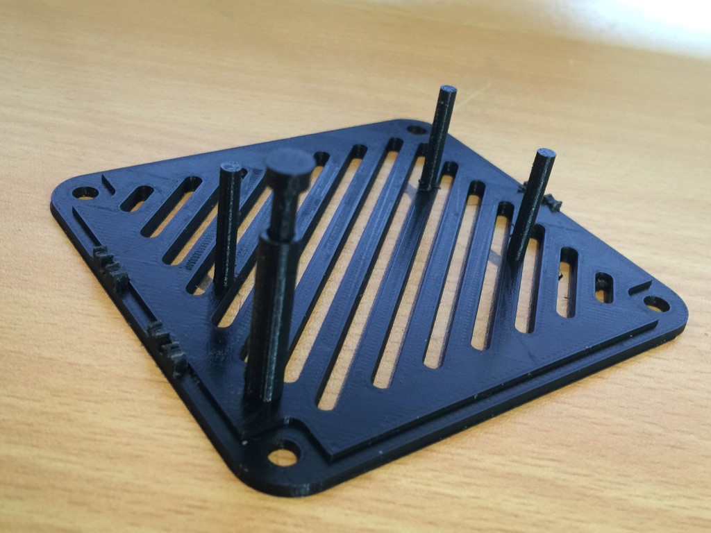

    I have been really slack at updating my project here so here is some more on my progress

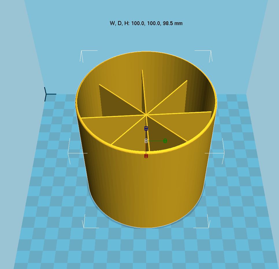

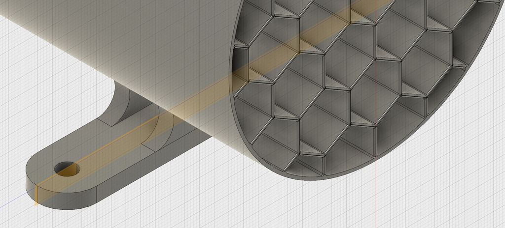

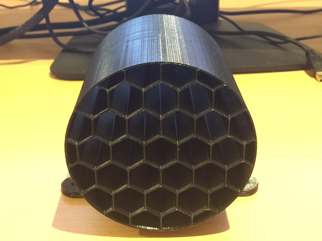

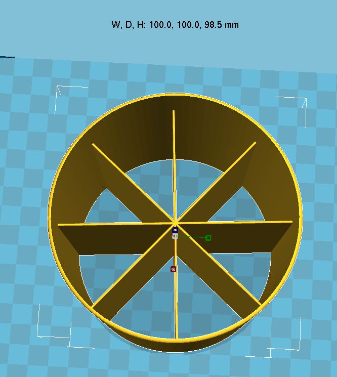

    I designed my fan vent/nozzle. They will go on the end of my ducting and work as an airflow straightener.
    I did two designs, a hex based one and a blade type one. I was reading that they both have their benefits but I like the hex one better.
    This is the hex style
    and this is the blade style
    I am still playing around with printer settings, I need to figure out what I can sacrifice to get better print times.
    The Hex style is saying 11 hours and 81 grams of plastic and the blade style one is 8 hours and 98 grams of plastic.
    So far I am loving the 3D printer. I have printed a hole bunch of upgrades for my 3D printer and I have so much stuff that I want to make for my rig. I am finding the 3D design is really fun, I love the idea of just going from an idea in my head to a real physical object. Next up is a box for my Arduino and MM.

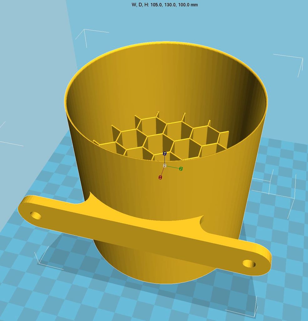

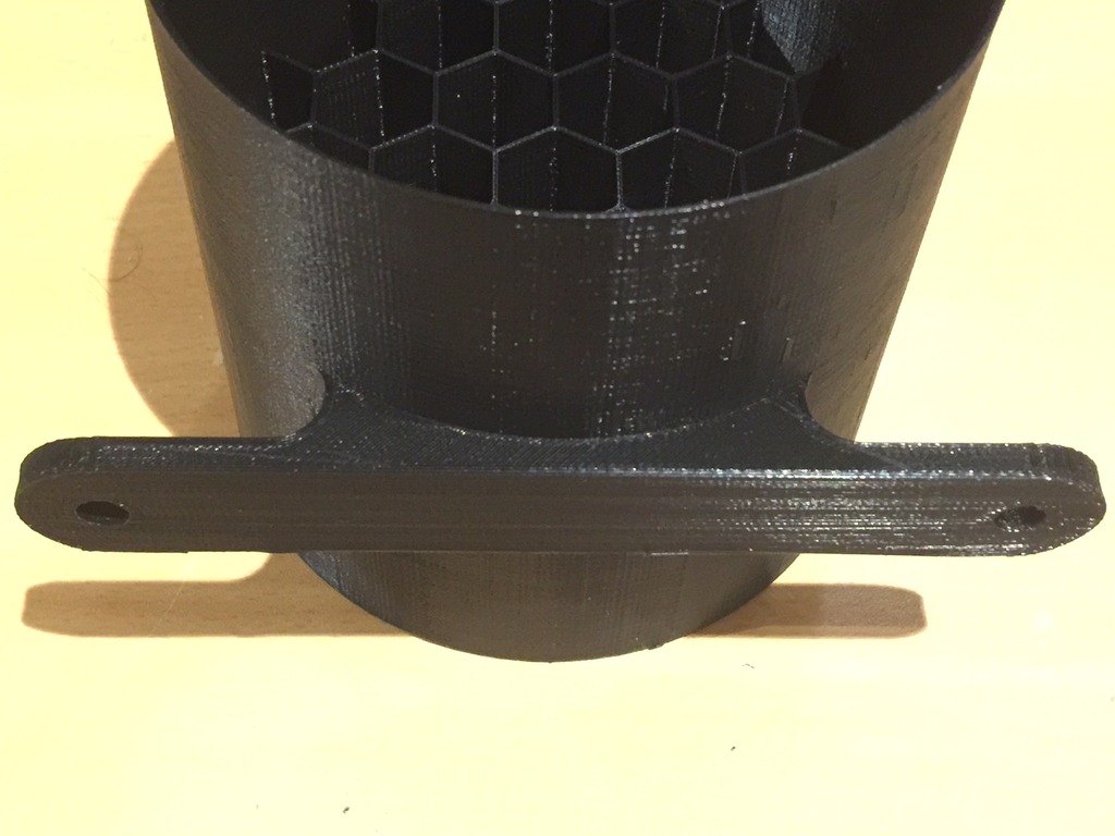

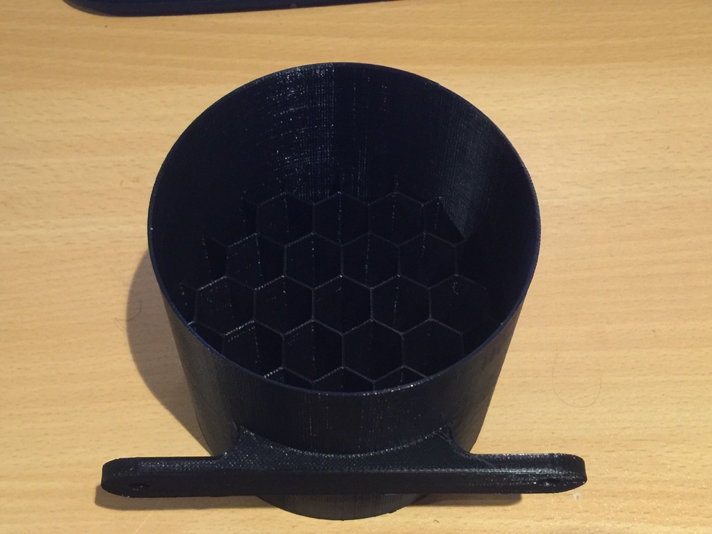

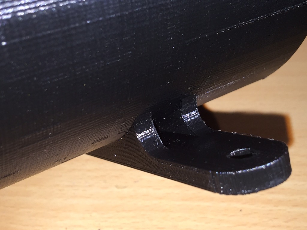

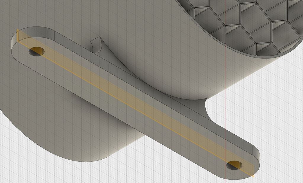

    I did some more work on my air straightener.
    I added a mounting bracket for it.
    Printed out the first of my final full scale version. the photos don't do it justice because it is really hard to take photos of it because it is back.

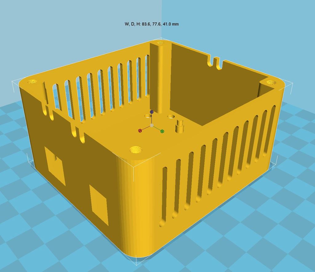

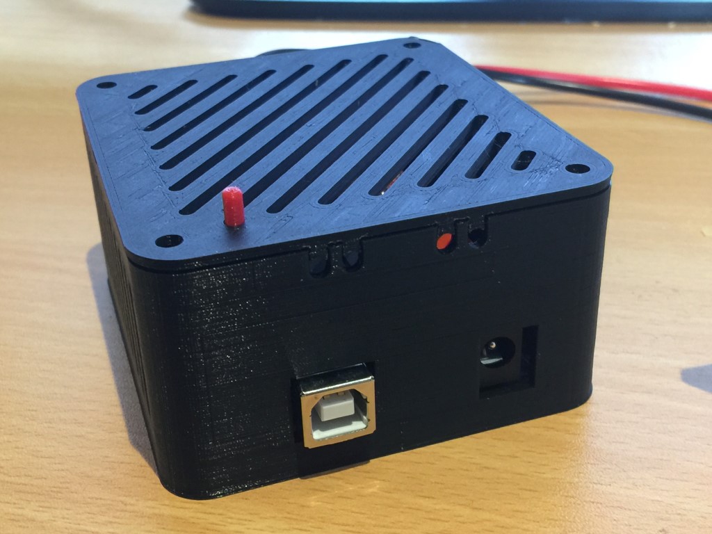

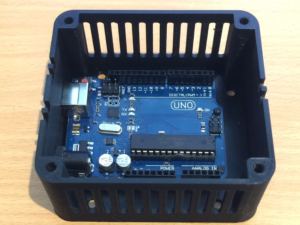

    I have finished the first design of my controller box.
    My controller box finished printing and I am very happy with the results.

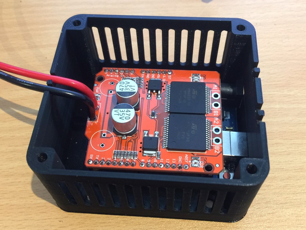

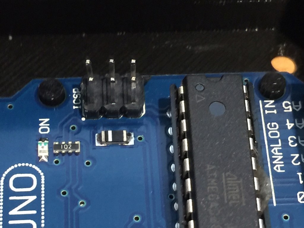

    This is it with just the Arduino installed

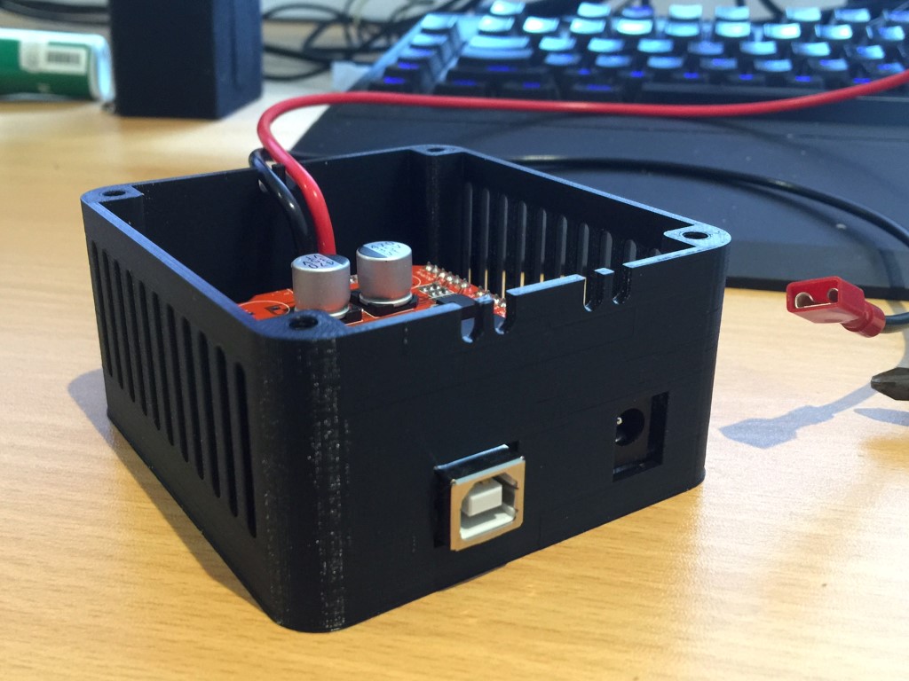

    And with the MM. I have made little cutouts for the wires. The top will screw on with M4 bolts, I printed the thread in to the model and they came out really nice.
    Here is the USB and power ports
    I didn't use screws to hold down the Arduino because M3 is pretty fiddly so instead they are just press fit on to some little studs. The tolerances are so tight that it doesn't budge but I will also be making some little fingers that will come off the lid and press on top of the MM to keep it held down

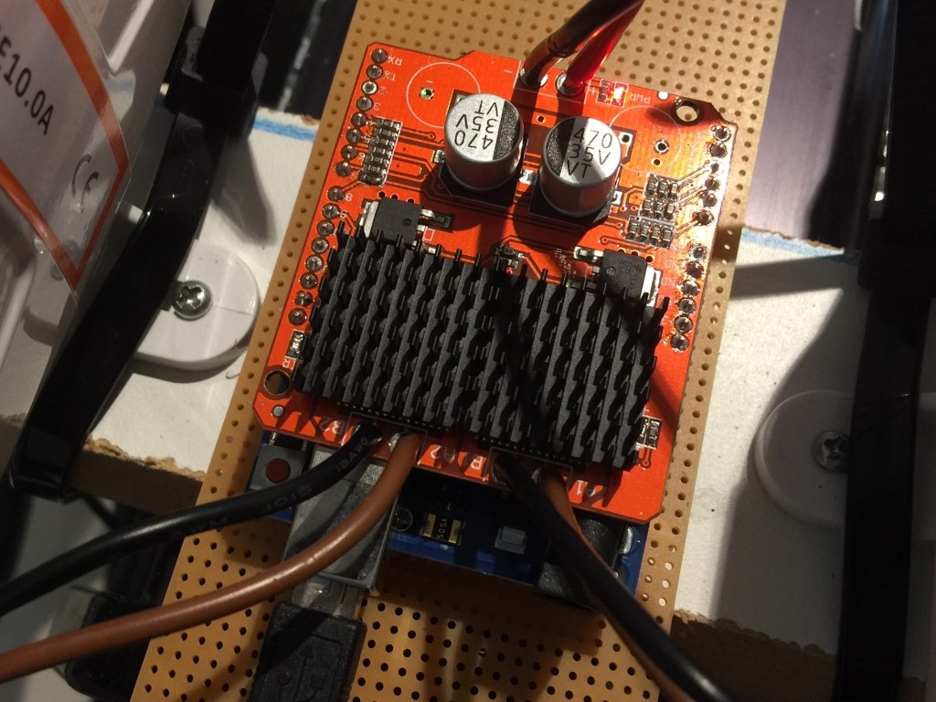

    Also back on my controller than is in use, I have attached my heatsinks. I tested them with my infrared temperature gun and they get up to 40c with the heatsinks on them

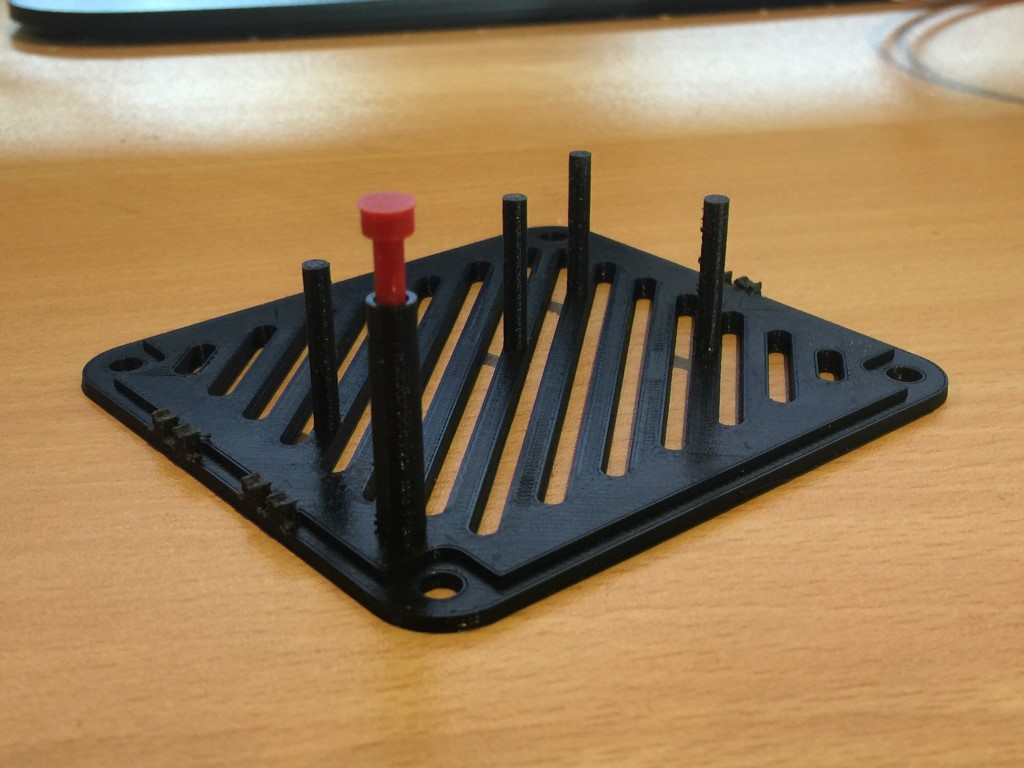

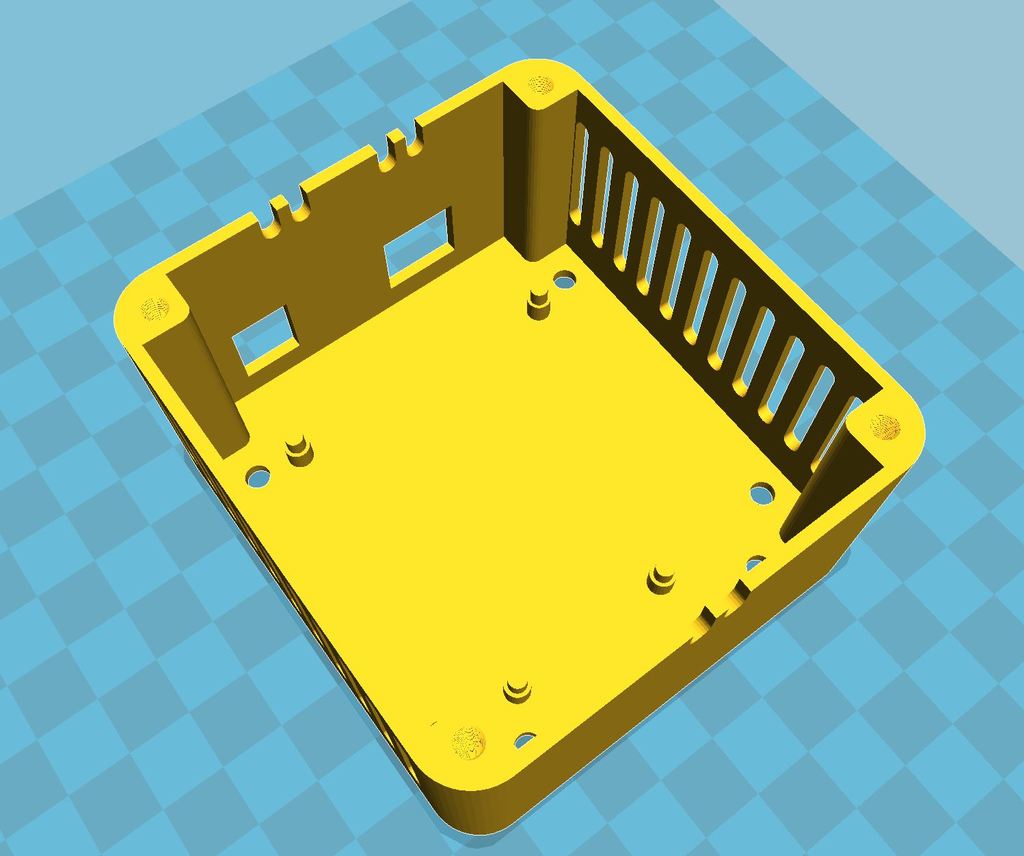

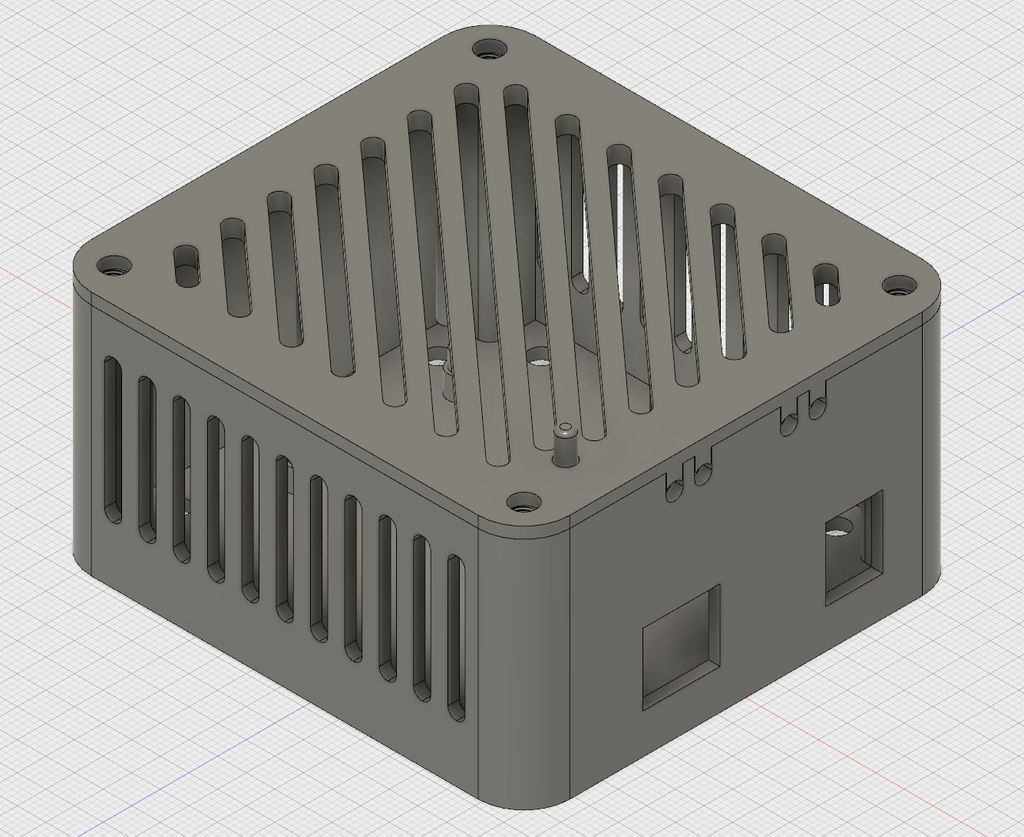

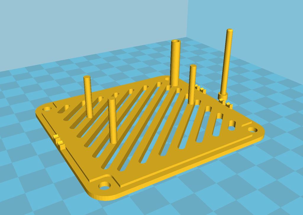

    I have finished designing the the lid now.
    Here is a shot of the box and lid together
    And here is a shot of the underside with the reset button and the standoffs to hold the boards down.
    On the print bed all ready to print
    I hope everything fits together okay. I am not sure how much tolerance I need to give all the parts on my printer. I have left everything with really tight tolerances so I may need to tweak it a bit if my printer isn't that accurate.

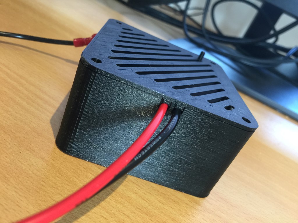

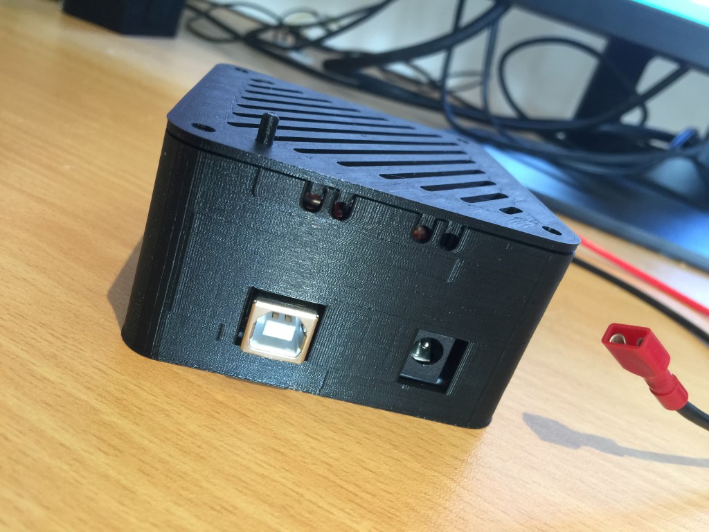

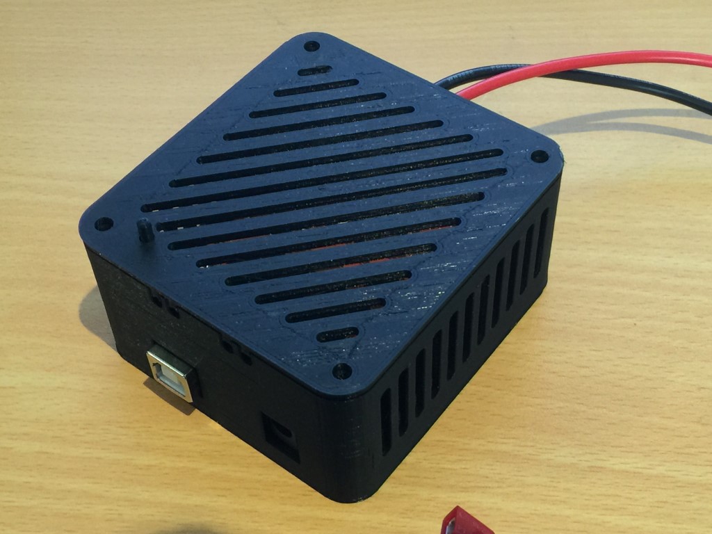

    I finished printing the lid and reset button and it fits perfectly!!! I went for a tolerance of 0.1-0.2mm in most places except the reset switch which I went for 0.4mm tolerance so it would be easy to push.
    The tolerance is so tight that it actually just snaps together with the little tabs for the wires coming out of the box. I tested all the screws and the thread is perfect and all the holes line up perfectly.
    I went for a diagonal vent on the top which I think looks pretty awesome. You can see the reset button over to the left hand corner, I want to get some red plastic so I can do that in red, I think that would look cool.
    Here you can see how tight the cable holes are
    And the cables on the other side
    Here is the under side of the lid and the reset button. All of the standoffs are perfect height so they hold the board in nicely.
    I am over the moon with how well it turned out. Not bad when you consider that I have only been 3D modelling for about a week :)

    What software do you use to model the parts ? I was using Google sketchup

    Thanks. I am using Autodesk Fusion 360. It is free for students and hobbyists.

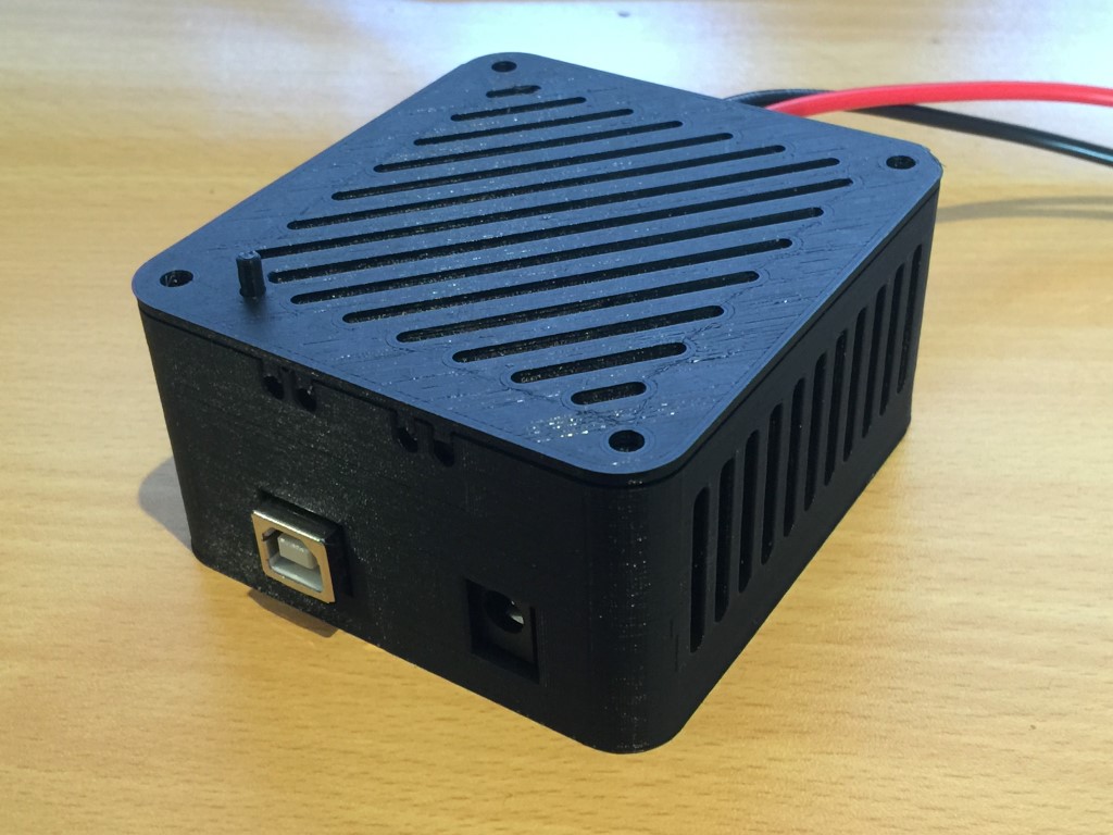

    I did some final tweaks to my controller box.
    I added an extra support in the middle of the lid and I got some red PLA so I can do the button in red.
    If anyone wants me to print them one of these controller boxes then flick me a PM
