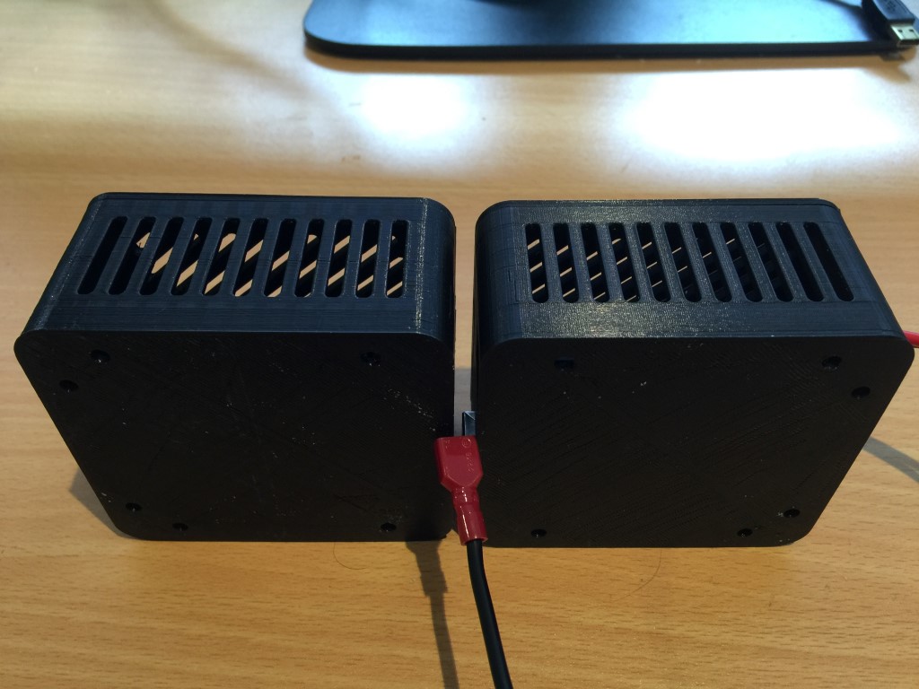

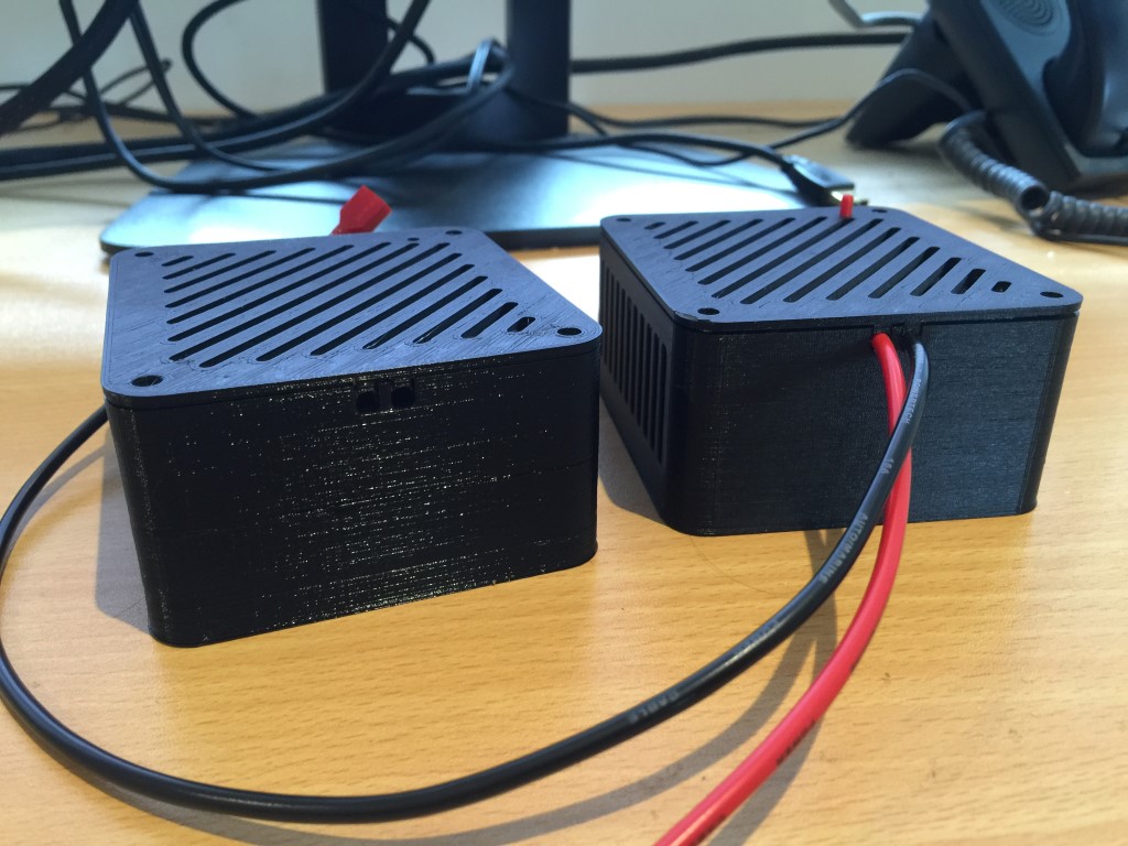

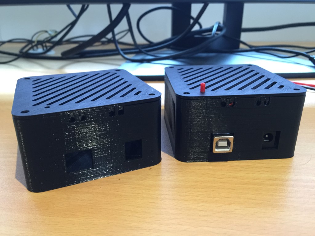

    Yeah, it would be perfect for any Arduino based project, you might just need to tweak the length of the supports based on the height of the shield you are using. I will be making some more different designs when I change from JRK's to MM's

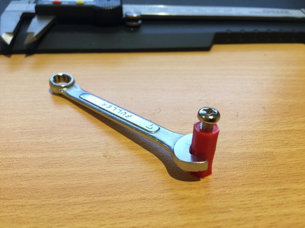

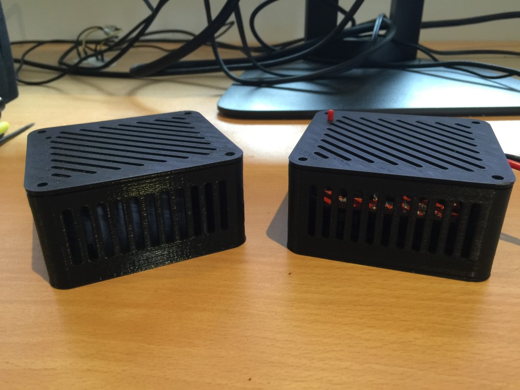

    Just did a little test of the threads and they work fine at 0.2mm and the threads printed great. This test was with an M4x15mm bolt with a .05 pitch.
    I was able to tighten it so hard that it started to crush the plastic, you can see the circular dent in the top where the bolt crushed the plastic so there is no change of the thread stripping out.
    This means I can get the print time down to 6 hours.
    I will print another test one to see how it compares with the slower settings.

    I did a print at 0.2mm layer height and it came out really well. Looks just as good as the 0.1mm.
    This has dropped the printing time from 17 hours down to only 8.
    Here are some photos. The one on the left is the 0.2mm and the one on the right is the 0.1mm

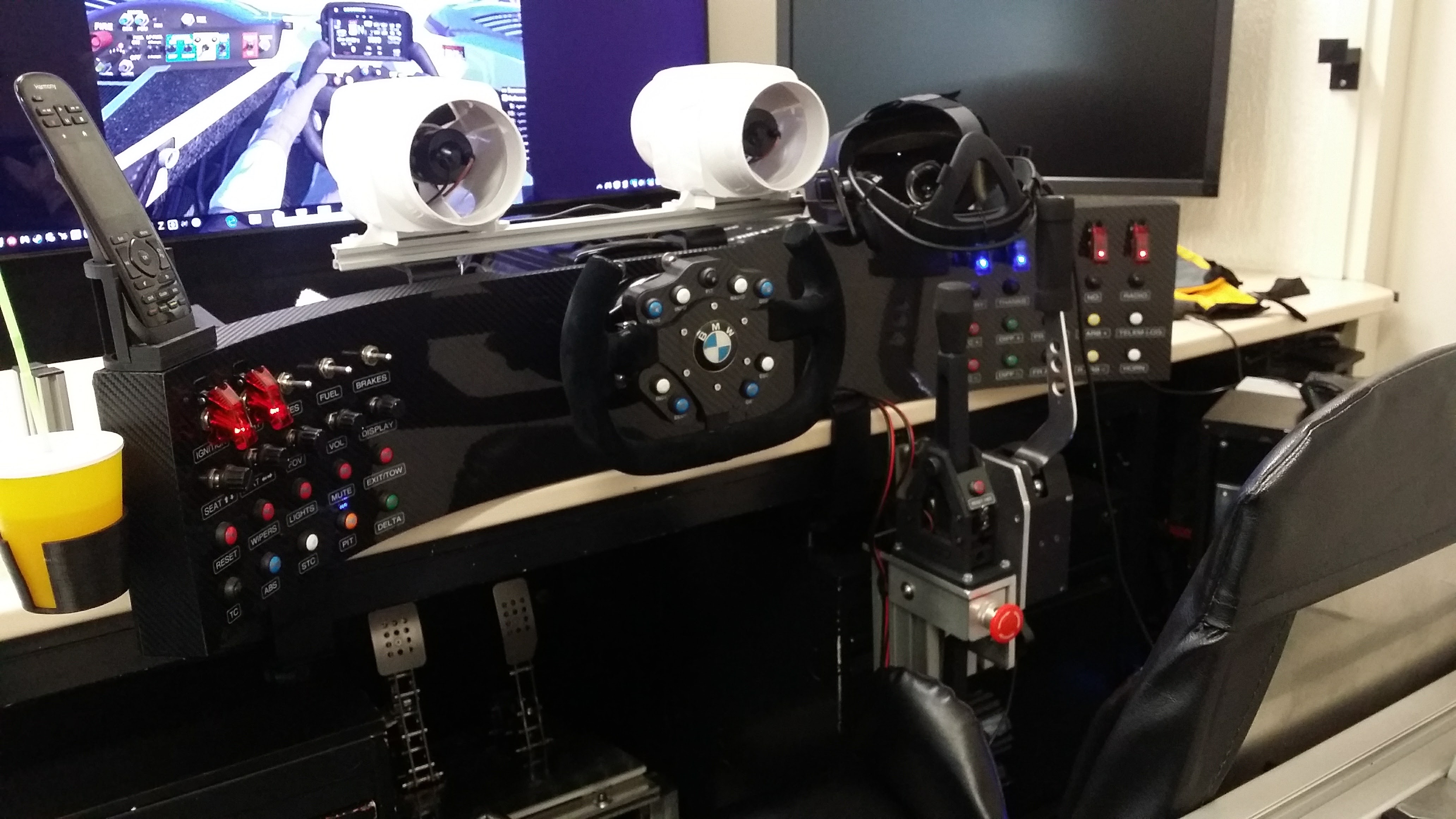

    I got the fans installed on my rig today. They really add to the immersion. I have only tried them in Iracing yet, but it feels pretty good and it makes the VR experience more intense. I will try to get AC/PCARS/Dirt Rally working tommorow.
    No Limits 2 is also pretty cool
    The biggest challenge was taking in account that my rig is not permanent. Still need to some rewiring en find the perfect distance between the 2 fans.
    I was thinking about spray painting the fans black, but without the stickers they also look really nice in white.
    I have some issues with my 3d printer, but as soon as i have worked that out, i will be printing fan ducs and Richards Adruino box.

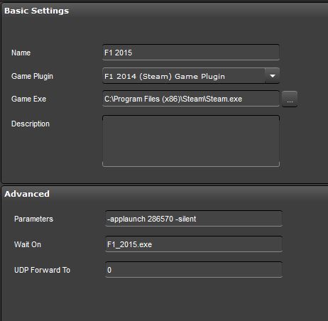

    I got AC & Iracing working, but Dirt Rally doesn't do anything. Could be that i read somewhere that DR is not supported in my region??
    I also have a question about Pcars. Simtools tells me to disable MMS in the game why i patch it. What setting is MMS and is the game with MMS still compatible with SC4 which i need for my accuforce.

    @HoiHman Dirt Rally has a Problem with the Outgauge Proxy Server so running multiple telemetry based devices is not easy,,,
    There is a work around that you can do to fix this issue though,,,
    http://www.eksimracing.com/cmps/

    With Project Cars, make sure you are using the standard plugin, no the UDP alternate plugin. The normal plugin uses the same shared memory setting that SimCommander uses.
    With Codemaster games, Sim Commander supports UDP forwarding so you can just use that to forward the UDP to SimTools (Port 4123)
    With Dirt Rally specifically they have allowed you to do multiple UDP outputs directly from the game.
    So you could just do
    <udp enabled="true" ip="127.0.0.1" port="10001" delay="0" extradata="3" />
    <udp enabled="true" ip="127.0.0.1" port="4123" delay="0" extradata="3" />
