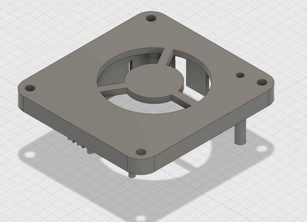

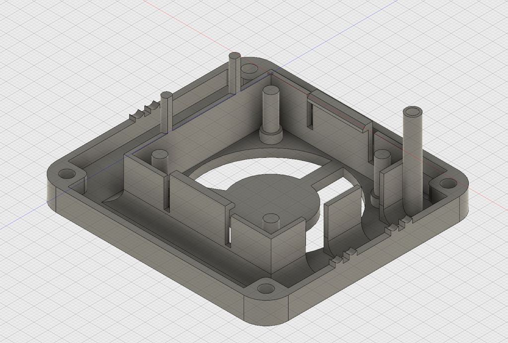

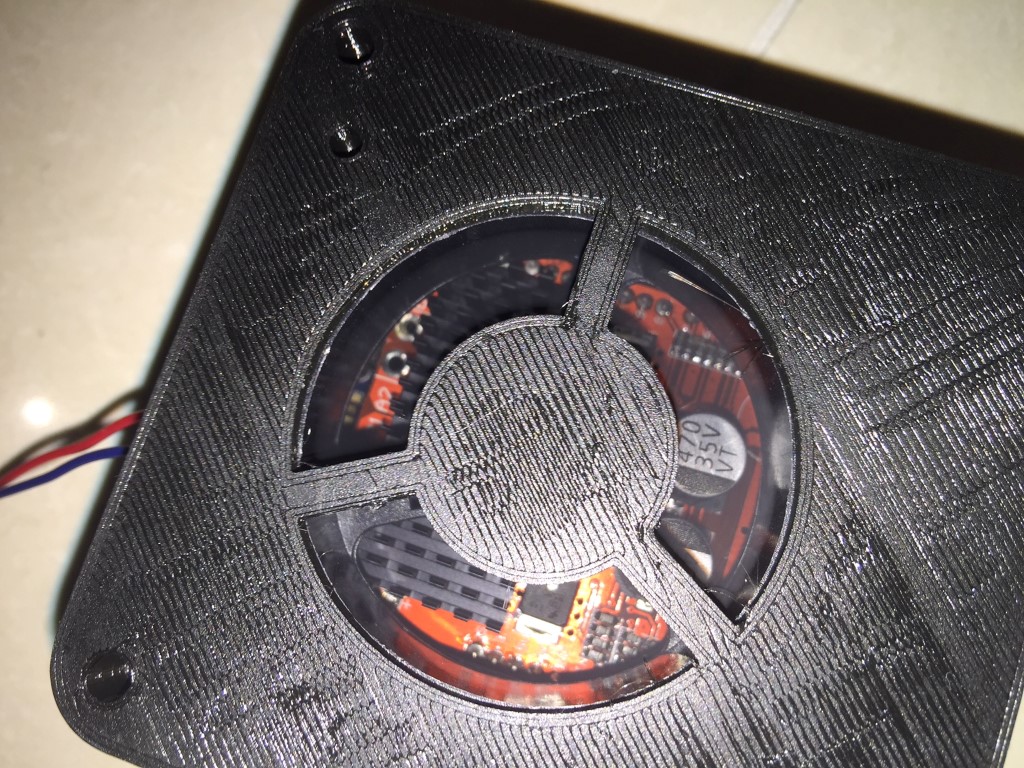

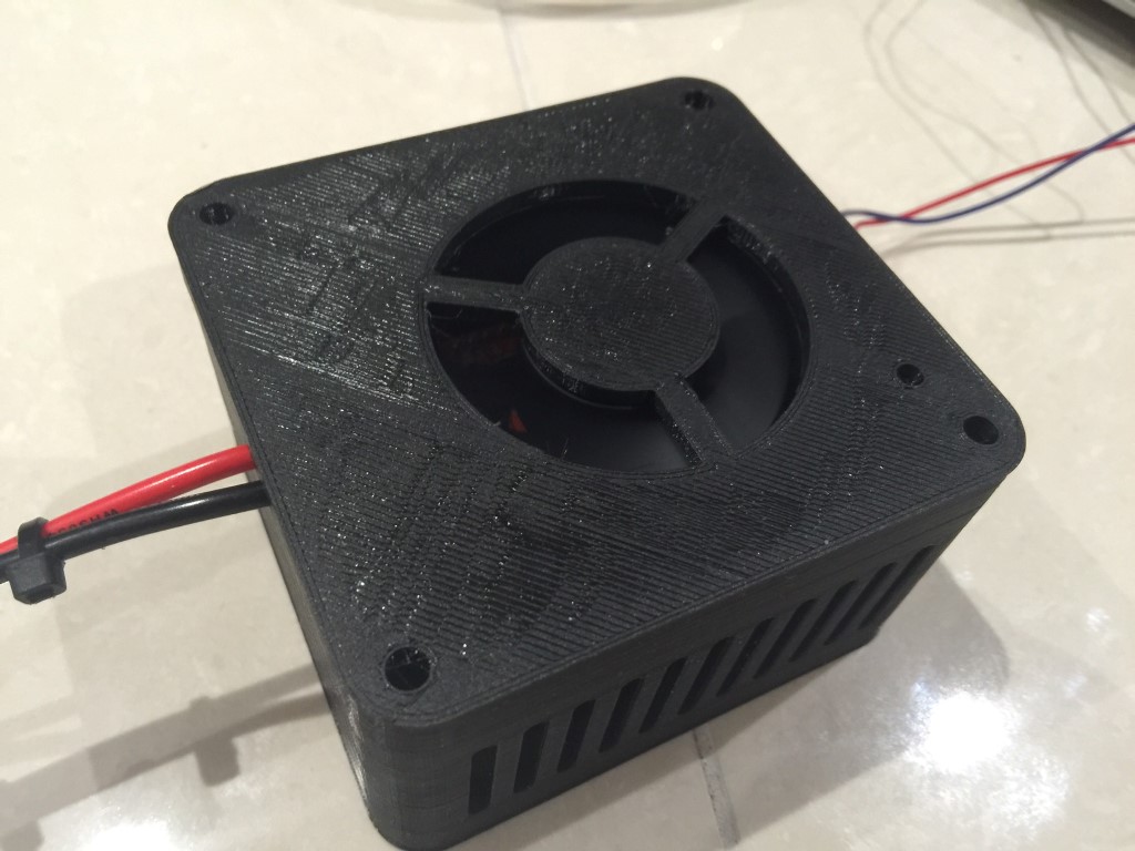

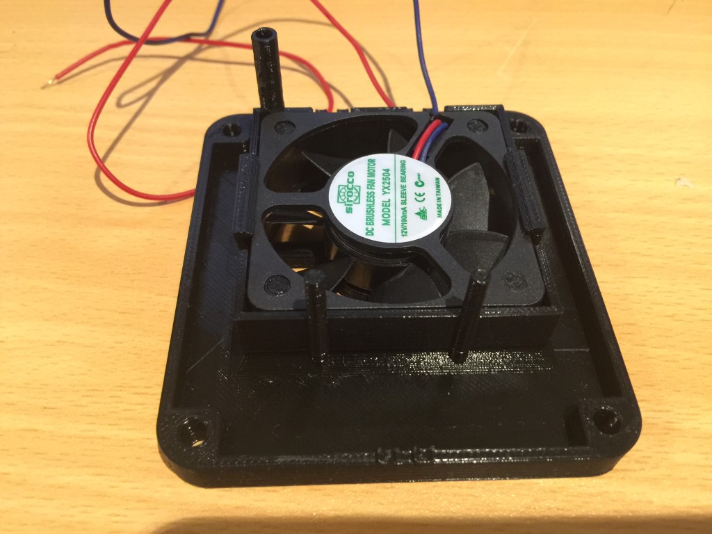

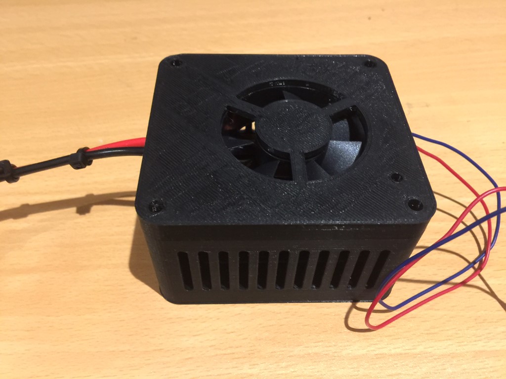

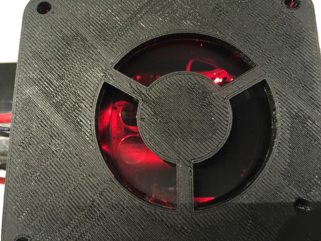

    Hey guys.
    I just thought I would share the latest addition to my controller box.
    A total redesign of the lid with a 50mmx50mmx15mm fan
    Here are some photos, ignore the wires hanging out because I haven't wired it up fully yet.
    Here is a shot of it running
    And here is a shot looking down through the spinning fans. Right over the heatsinks. I even lined up my supports with the ones in the fan so there is 0% obstruction.
    The side vents are working really well also. You can feel a blast of cold air coming out each side.
  15. noorbeast
    22,202
    154,675Coins
    +11,207 / 57 / -2
    Just brilliant!
    Can you add the 3D file for others? I think this one is going to be really popular!
  16. Avenga76
    Avenga76 Well-Known Member
    Jun 29, 2014
    518
    Network Engineer
    Auckland, New Zealand
    3,262Coins

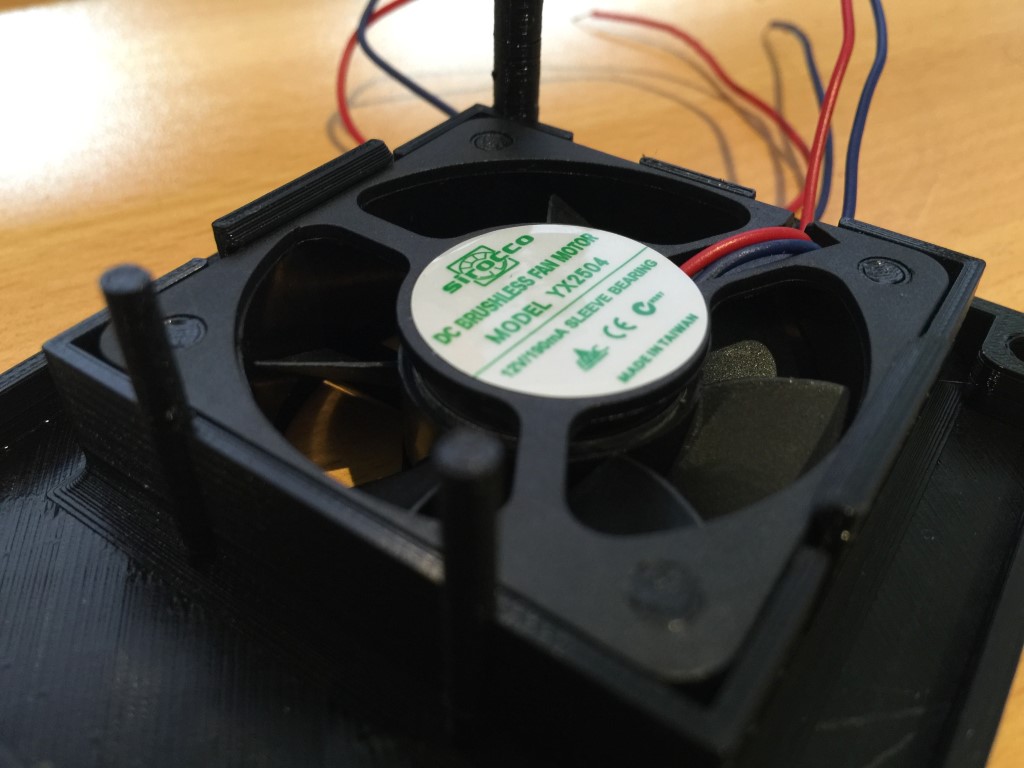

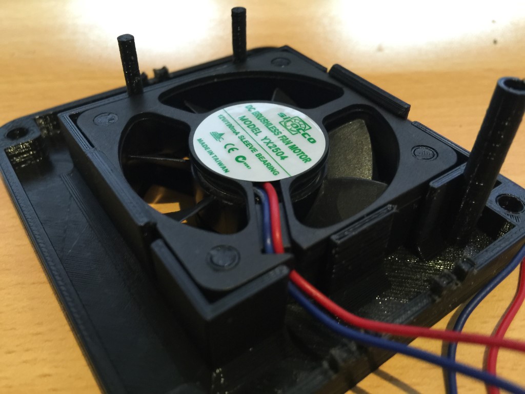

    +859 / 6 / -0
    Yeah, I will upload the files tomorrow hopefully. I just want to do some tweaking. The fan sits about 0.5mm above the caps and I am not sure if that is too close. I might pop in up another half a mill to allow for a bit of extra clearance.
    I also want to try it with the fan wires in place, just so I can make sure I have enough clearance for them.
    When I am all happy with it and finished tweaking then I will upload the file.

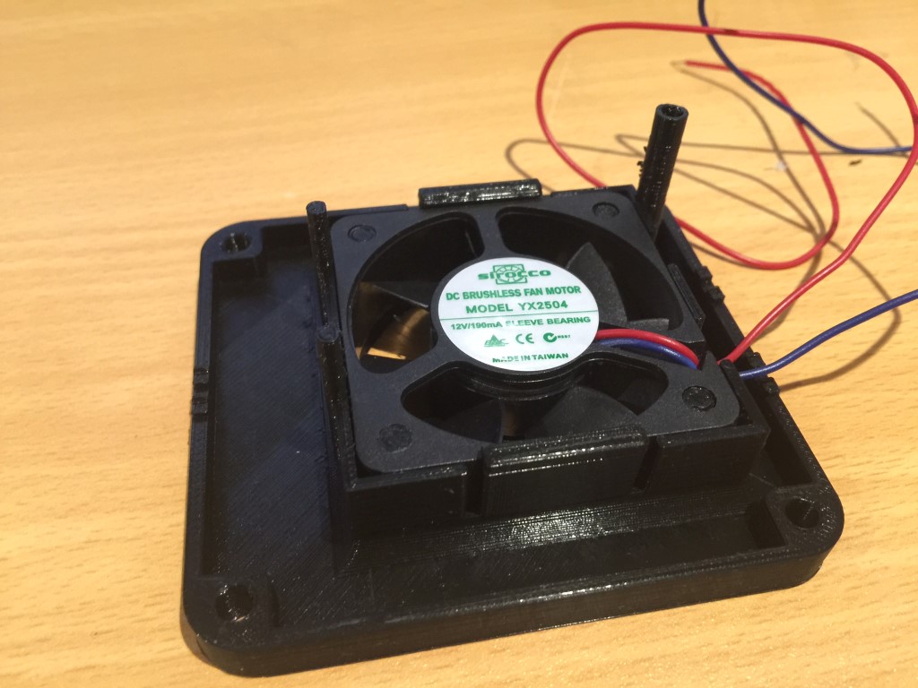

  17. Avenga76
    Jun 29, 2014
    518
    Network Engineer
    3,262Coins
    +859 / 6 / -0
    Made some VERY minor changes and printed out a new lid.
    I am a bit of a perfectionist so I probably didn't need to make these changes and they aren't even noticeable but they are.
    -Added 0.5mm height so there is now about 1mm clearance between the fan and the top of the capacitor (I was worried about other peoples boards with caps that were not quite flush with the board)
    -Made the little hooks on the fan 1mm smaller so it is easier to get the fan in. I thought the old hooks were a little too long.
    It 100% perfect now. The fan fits like a glove, it is so tight that you sort of need to wiggle the fan in there but once it is in then it ain't going nowhere. It is toight, toight like a toiger

  20. Avenga76
    Jun 29, 2014
    518
    Network Engineer
    3,262Coins
    +859 / 6 / -0
    Thanks. I have some other stuff that I have designed sort of along those lines that I will be announcing soon. I have been really busy designing stuff :) :)
    Tested the fan on my test box running the 10A TMC blowers.
    With no fans I stopped my tests at around 70-80 degrees.
    With the 50mm fan it hangs around the 30 degree range. This is even lower than the 42 degrees with the 6A Seaflo blowers without a fan.
    Plus it has this awesome red glow from the LEDs on the MM. Looks really awesome
