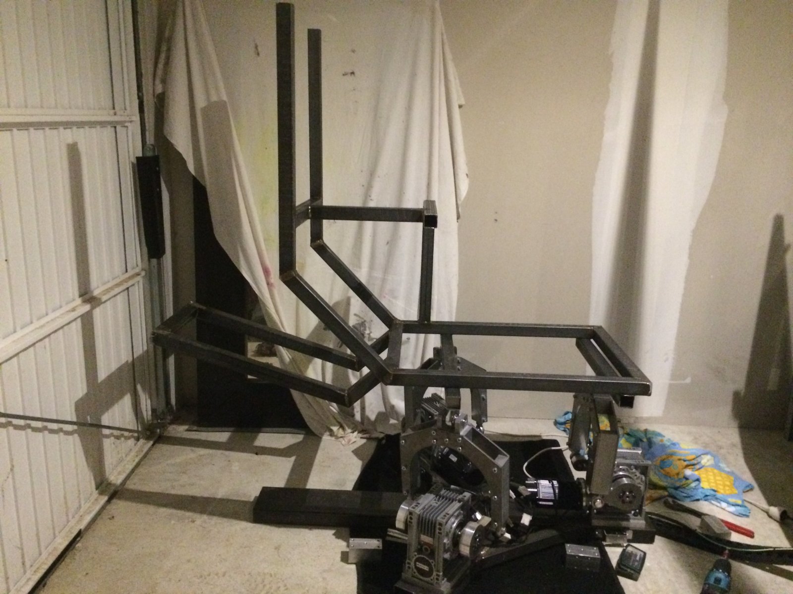

    I would like to share with you the advancement of my project of 3DOF.
    I begin to see the end of the manufacturing and I hope that first results will be good.
    • Like Like x 6
    • Winner Winner x 4

  12. noorbeast
    22,096
    154,196Coins
    +11,175 / 57 / -2
    Looking good, well done, and excellent craftsmanship.
    I am really looking forward to your next video once the top frame is complete.

    I love this job.
    In practice you do not exactly like the design. Why? It's a nice design :thumbs

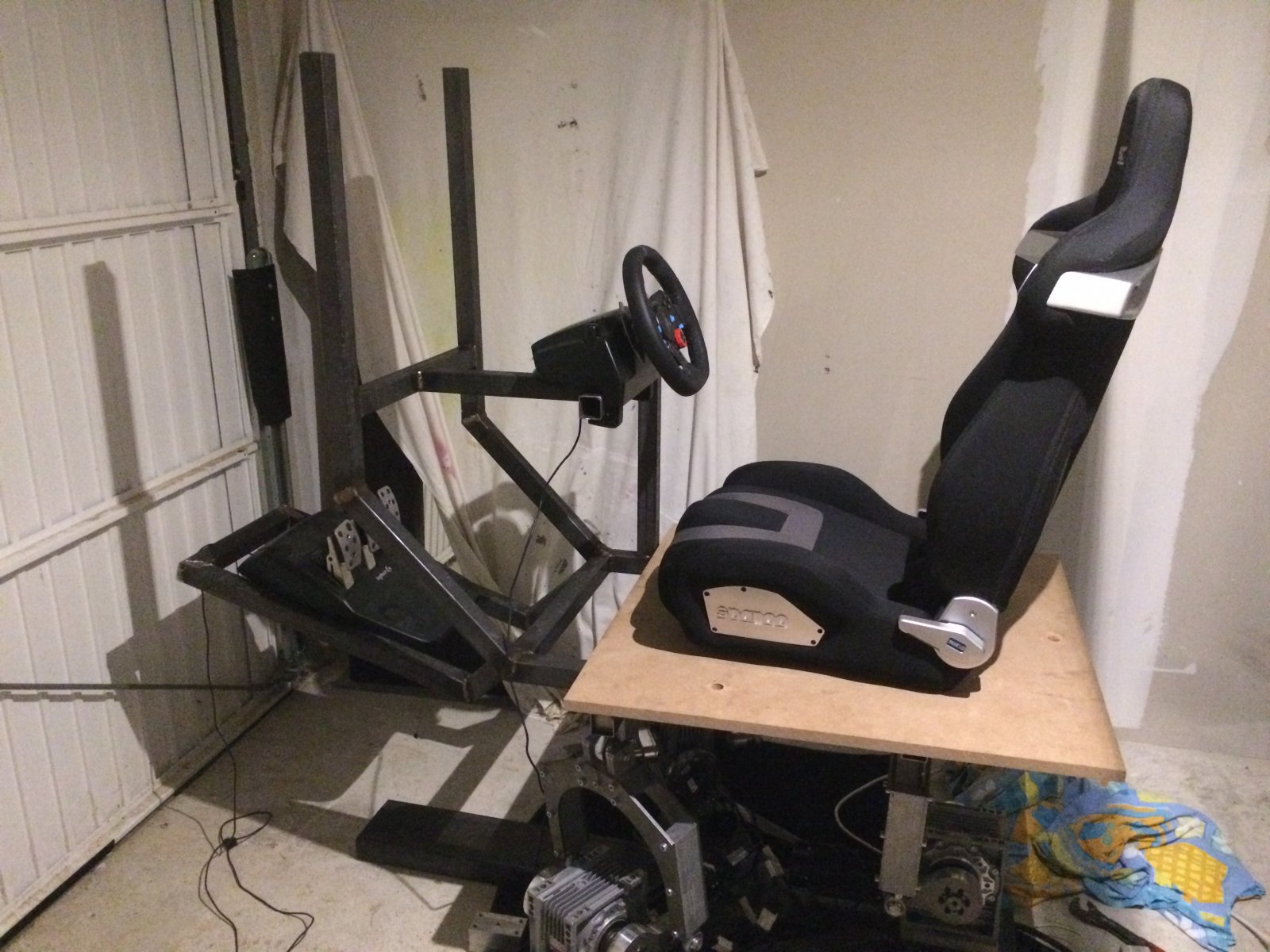

  20. Playsimulator
    Playsimulator Member Gold Contributor
    Oct 1, 2015
    24
    france la voulte sur rhone
    178Coins
    +36 / 0 / -0
    3DOF, Arduino
    First test of the 3 DOF
    • Like Like x 5
