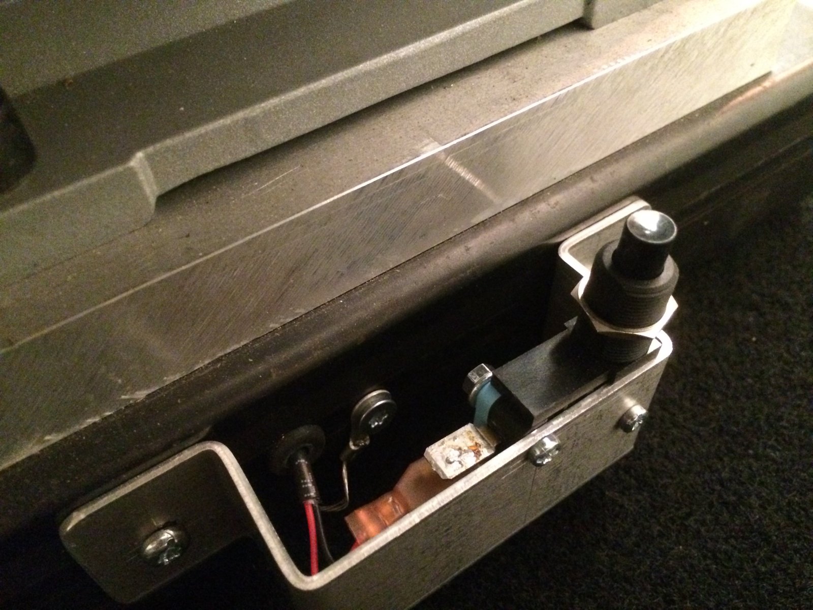

    Imagine 3 positions -90°(Down) 0° (Middle) +90°(Up)
    For initialization:
    There is a switch in the lower part of the cams (-90°).
    When I power on the simulator the cams turn (Anti-clockwise) to find the contactor.
    After finding the switch (Dry contact) the cams make an offset of 90 °. Like this the cams are at the postion 0°.
    I manage this with the Arduino UNO.
    I added a emergency button to manage the parking position. (-90°). Like this, at the end of the game, I put the button to be lower to go down of the simulator.
