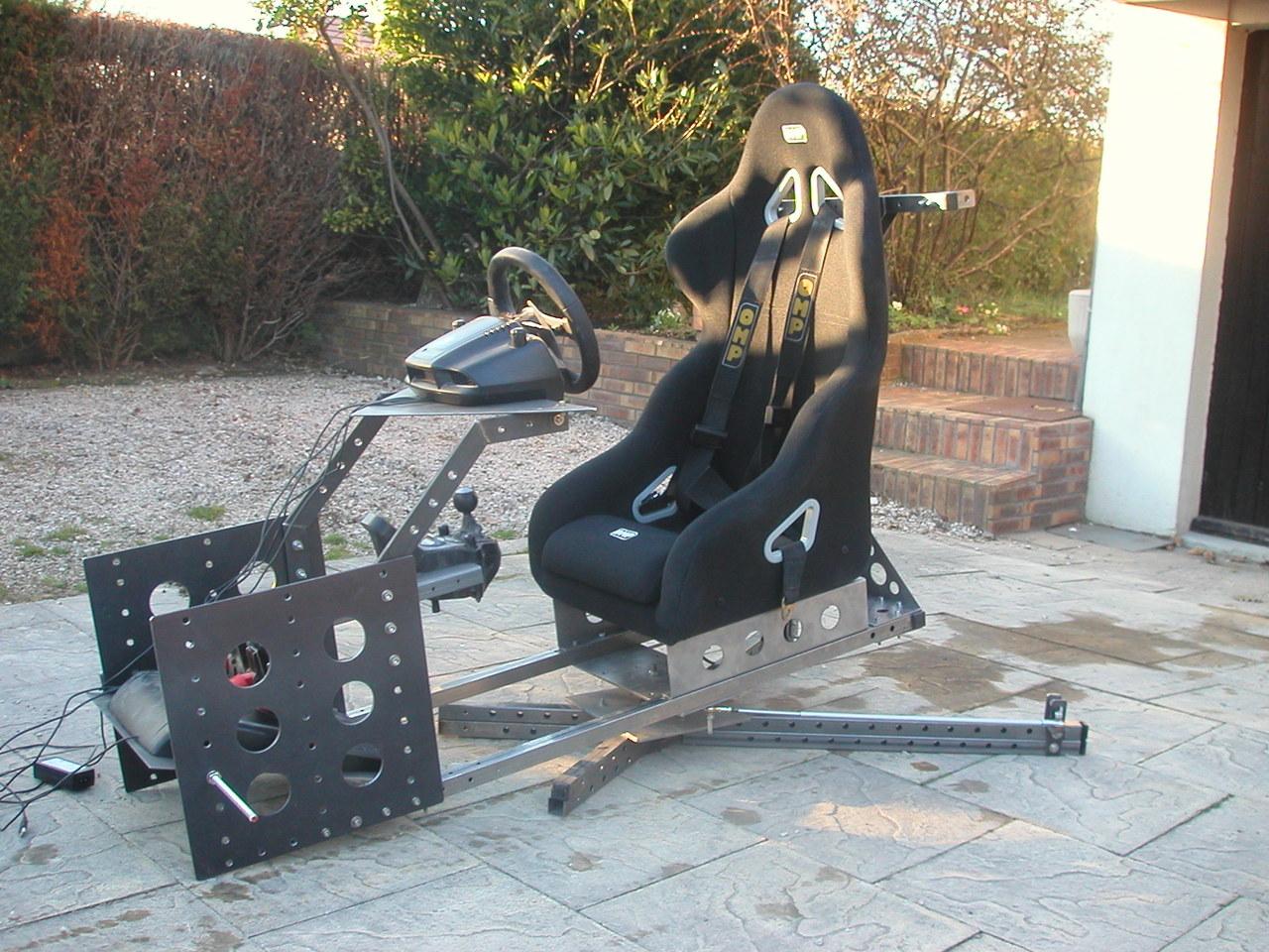

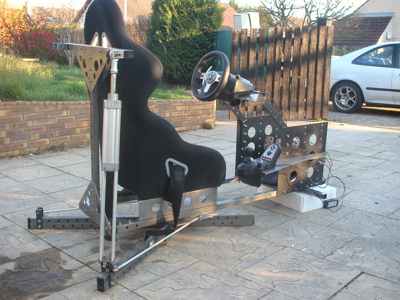

    Merci pour avoir mis l'anglais , j'ai finalement trouvé pour mettre les photos!
    j'ai fait quelque modif, j'ai fixé les barres antirotation, ça avance doucement, il me reste quelque trous!! et la fixation des vérins.
    j'ai acheté toute mes rotules sur ebay, le temps de tous trouver, je n'ai pas avancé bien vite!!
    à plus...
    Thank you for putting the English, I finally found to put the photos!
    I made some modification, I set the anti bars, we forge ahead slowly, I still have some holes! And the setting of the actuators.
    I bought all my kneecaps on ebay, the time to find all, I have not made soon!
    More ...

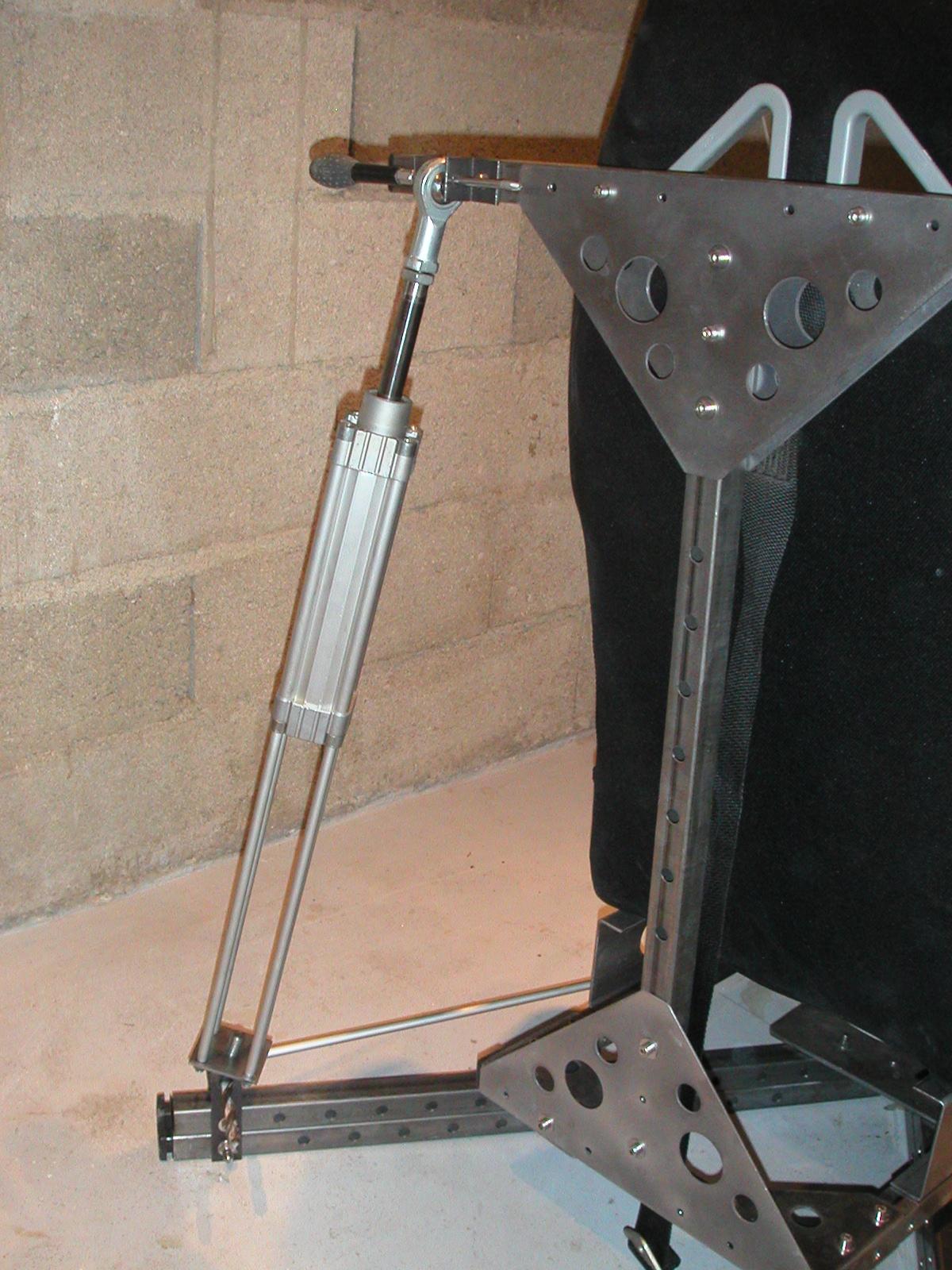

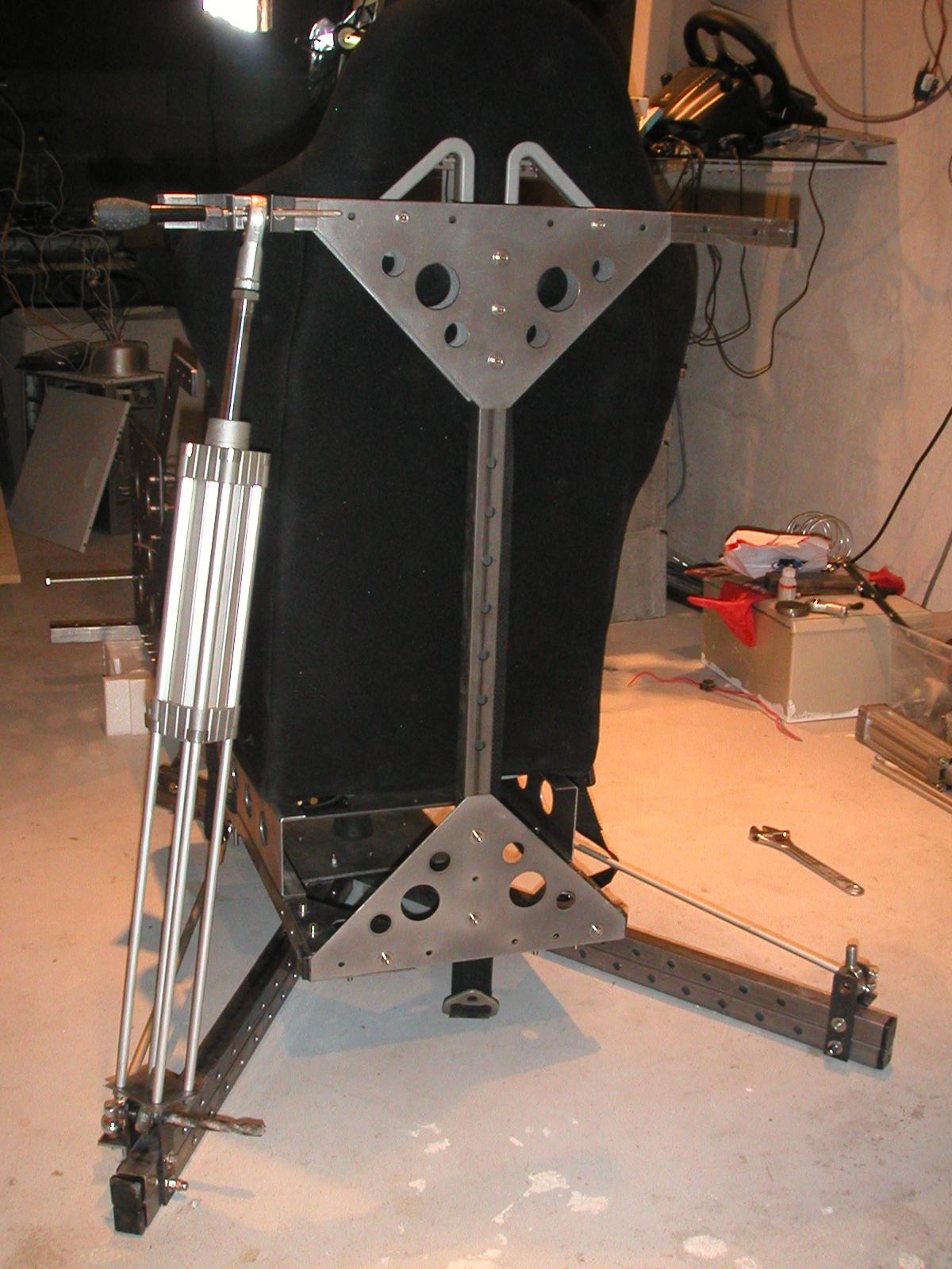

    New photos
    Fixing actuators:

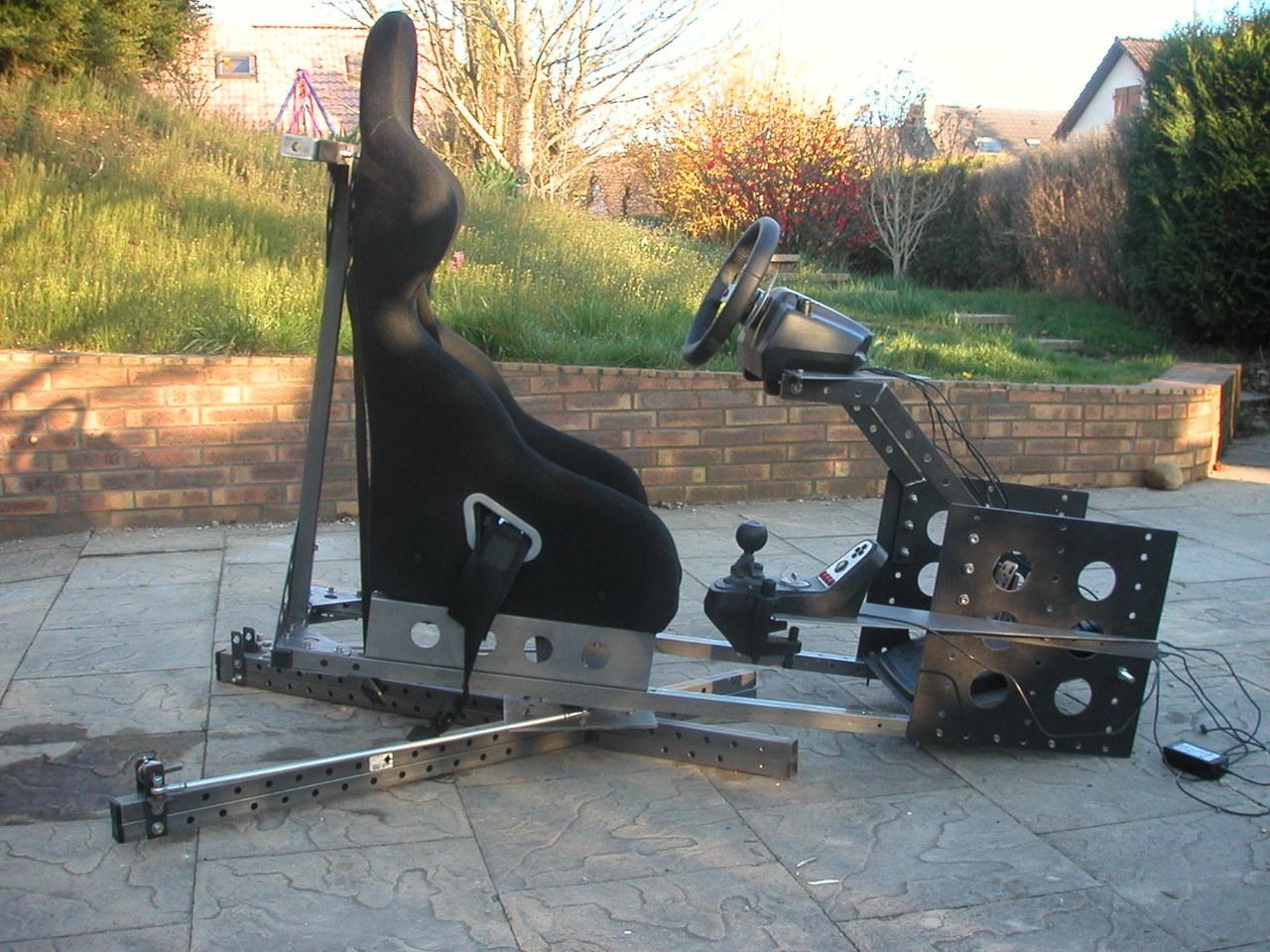

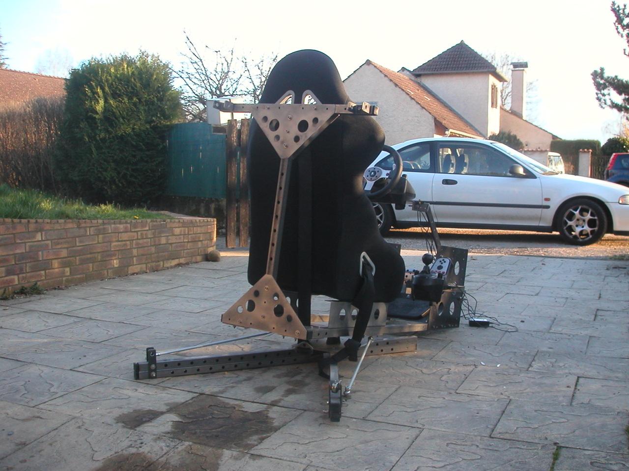

    Some photos with the sun!
    I soon finished.
    I bought a compressor 50l.
    I will soon be testing software with the X-sim

    Well done, Riton! :thbup:
    Your frame looks very cool.
    I hope you will get some satisfiing results. I think your construction will be quite heavy.
    Regards
    Christian

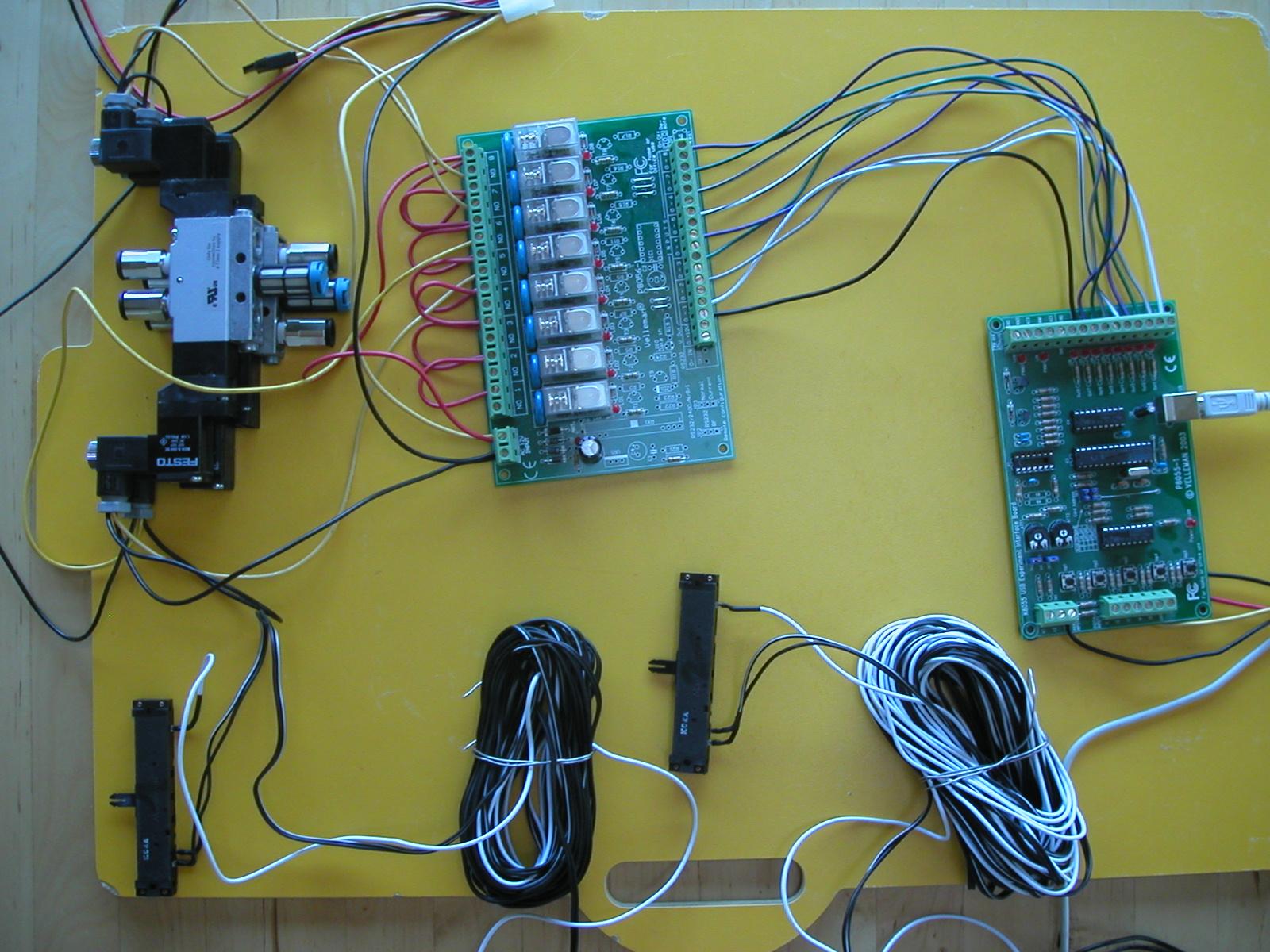

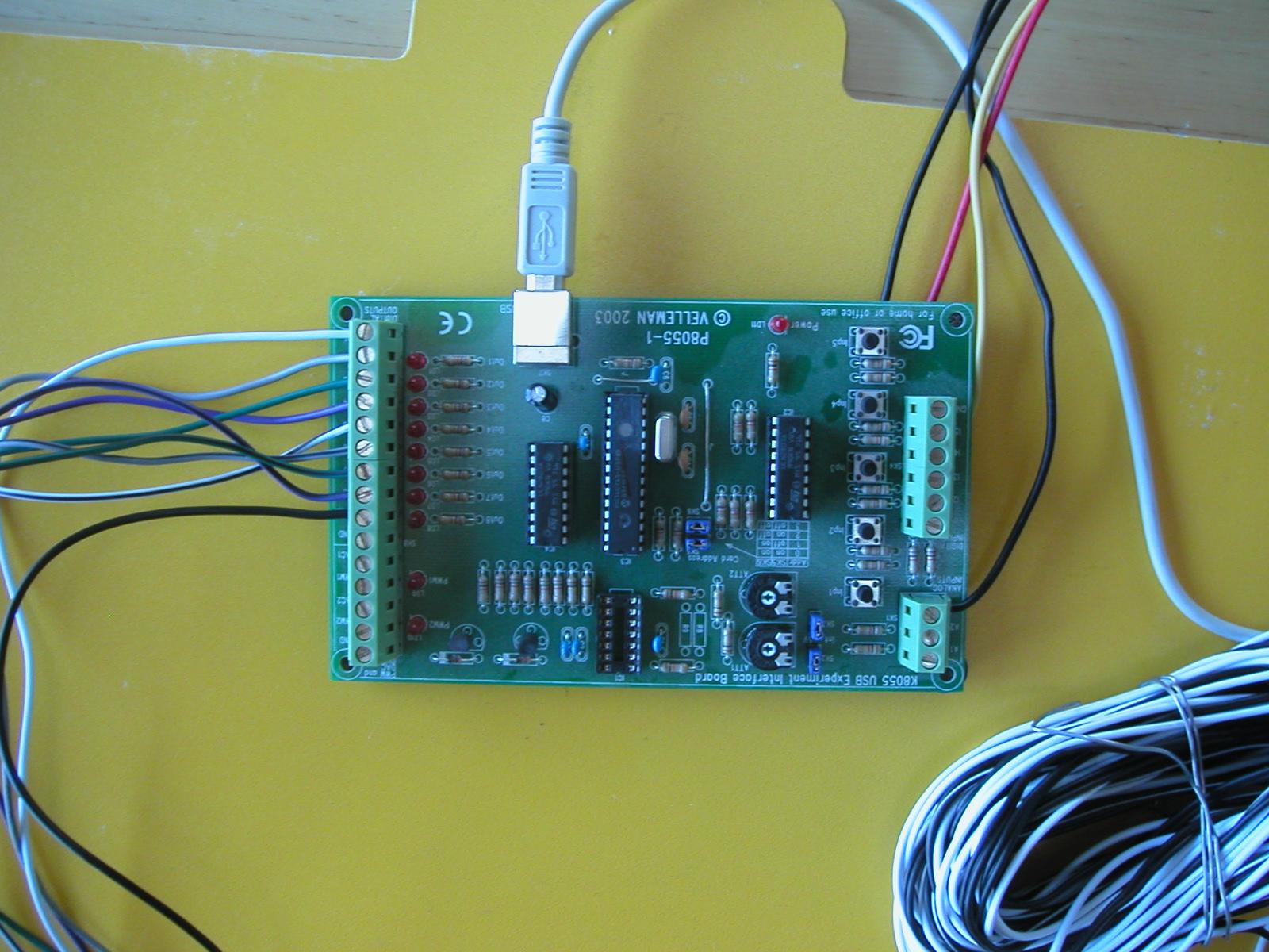

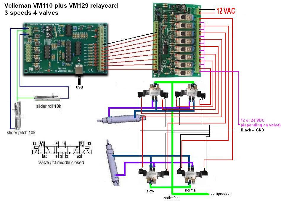

    is what I can test the functioning of the relay just plugging the card and the potentiometer without actuator and compressed air?
    I did the wiring, but there is a problem
    When I plug the cable Clamp map velleman on the 0 of the card relay, relays don't move ?
  12. egoexpress
    egoexpress Active Member
    Dec 13, 2006
    3,839
    Germany - Frankfurt/M
    422Coins
    +10 / 1 / -0
    you have to connect (+) to all valves and gnd to the velleman gnd. Then wire a cable from each valve to a seperate port of the velleman.
    Note: the velleman does not output current! It just opens the port, to let the valves current pass through. The current (Power(+)) is connected to the valves!
    Perhaps you could make a photo of your assembly.
    Regards
    Christian

    les photos du cablage:
  14. riton
    riton Active Member
    Jul 6, 2007
    600
    1,006Coins
    +103 / 3 / -0
    I must connect 24V on my valve
    for testing I connected the 12V (power PC) on the valves the same as for connect the card relay
    I have the same problem, when I connect the wire clamp / 0 (black), the relay does not move but led flash
    i don't understant

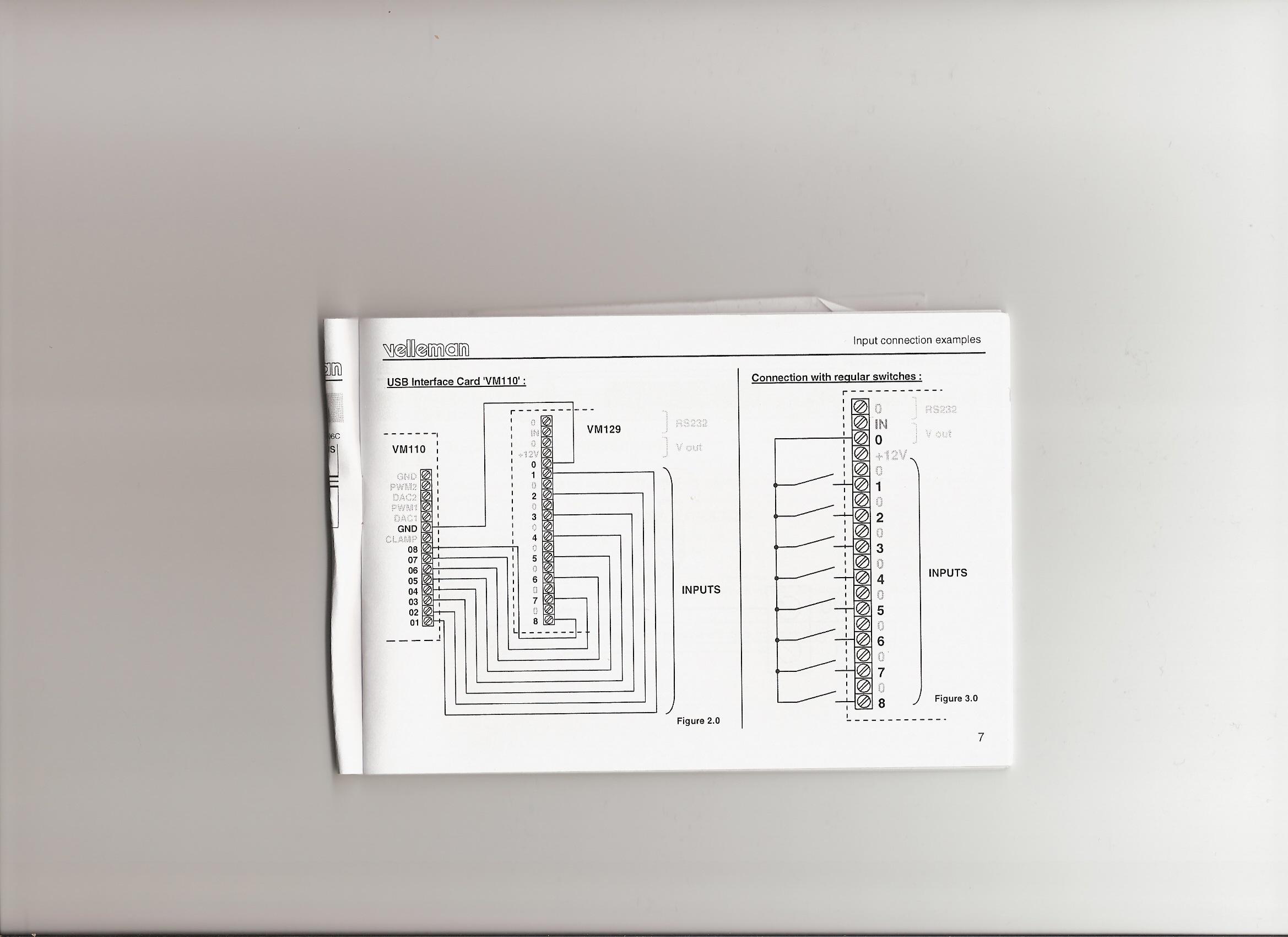

    I plugged the card with this model.
    I do not understand or connect the valve ground, I must have a problem with ground
  16. riton
    riton Active Member
    Jul 6, 2007
    600
    1,006Coins
    +103 / 3 / -0
    there is a difference between the wiring of the notice velleman and XSIM wiring, who connect this cable? clamp / 0 or GND / 0?
    I have seen on photos of other wiring that had connected on clamp?
    thanks for help
