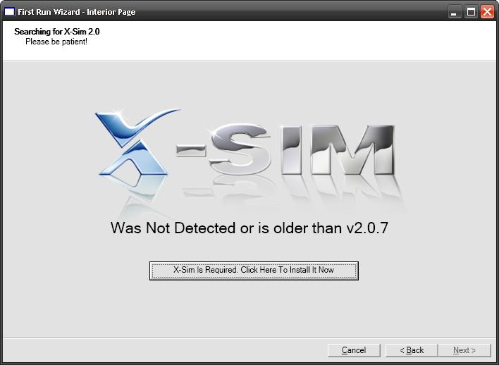

    With 5 test PC's including XP 32-bit, XP 64-bit, Vista 32-bit, Vista 64 bit and Windows 7, I will have to respectfully disagree with your stability assessment. However, it is my goal this week to do enough testing to be able to provide some useful feedback to SirNoName so that he may be able to resolve the issues that I am experiencing. The difficulty is that the issues seem random so far and no error message is provided. The profiler simply closes and I get a message that says the Force Profiler stopped working. This means that the issue is some type of unhandled general exception.
    I do not prefer that the Commander lag versions behind the current X-Sim release, so I will do what I can to move things forward.
    Also, I am not sure why you received the message about your version of X-Sim being unacceptable. The Commander First Run Wizard checks the file date of some X-Sim files and if they are greater than or equal to the date that 2.0.7.1 was produced then it will allow you to continue and choose the option Use My Current X-Sim Settings. Is it possible that your X-Sim 2.0.1.2 is not installed in its default location of C:\Program Files\X-Sim or C:\Program Files (x86)\X-Sim?
    I just did some quick testing here with a 2.0.1.2 install, and I was able to choose Use my current X-Sim settings. Of course by doing so, you will not gain many of the benefits that the Commander has to offer. It's the standardization of these X-Sim settings that makes for much improved profile sharing.
    EDIT: I think I narrowed the issue down to only 64-bit operating systems with AMD Quad-Core processors. I have not experienced any issues on any of my Intel machines. I will be working to produce a release of the Commander with 2.0.1.2 soon.

    Hi! Bernard,
    Thanks for the feedback.
    Unfortunately, it is still not working for me! :-(
    BTW, my x-sim is installed on D:\Program Files\x-Sim
    If I choose install x-Sim than cancel the installation, the commander will say my PC is too slow... than will not be able to handle the situation.

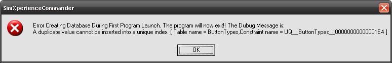

    After that, when I run it again, the wizard will give me the following error:
    Given you explanation, I believe I may not have had any stability issues due to my Intel proc. E8500.
    Thanks.
    Erick

    Hi Erick,
    looks as when there are some duplicate index entrys in the database, maybe resulting about a broken installation prior. I think you have to uninstall the MS SQL compact server, the commander and than try again. I am sure that will fix it.
    br

    Yes, this is the result of a failed first installation of version 1.0.0.0
    Version 1.0.0.1 is available on the SimXperience website. I will do some testing with non-standard X-Sim installation locations, as I suspect that this is the cause of the issue. Thanks for the feedback!

    I had uninstalled the 1.0.0.0 before installing the new version (I even use Revo Uninstaller to make sure no registry entries are left behind).
    I tried uninstalling the MS SQL as well, installed everything back again and it didn't help.
    The DB error is fixed with a computer reset.

    Yes, the issue is definitely the non-standard X-Sim installation location. I will put some thought into how to best handle this for the next version. X-Sim does not create a registry entry with it's installation location that I can simply read in. Therefore, I check common installation locations automatically. It seems I may need to build a mechanism to browse for the installation folder if it is not detected. In the iterim, you can always install a copy of X-Sim in C:\Program Files\X-SIm or C:\Program Files (x86)\X-Sim.

    I agree, that's what I meant several posts above when I said It seems I may need to build a mechanism to browse for the installation folder if it is not detected.
    This will keep things simple for users with standardized PC's, yet users with various other configurations to browse to the location of their X-Sim installation manually via a standard File/Open dialog box. I will release an update tomorrow with this functionality added.

    Will be one more day before I release 1.0.0.2 with the fix for those with no access to a c: drive. Wizard section is repaired, but another issue came about while testing with regard to the temp folder used for placement of the auto-generated X-Sim FSD files fo rthe quick launch buttons. I need the additional day for further testing, but your fix is on the way.
    EDIT: A few cups of coffee and some testing later, I think I have the solution for PC's with no C: Drive access. However, I am not fully able to test this scenario since none of my PC's are configured this way. SimXperience Commander v 1.0.0.2 is now available for download via the SimXperience website and includes the no c: drive fix. Please not that while visible, the Logitech G25 settings and the per profile actuator speed / accel settings are not yet included. Assuming that I can get the core stabilized within the next few days, those features should be released next week.
