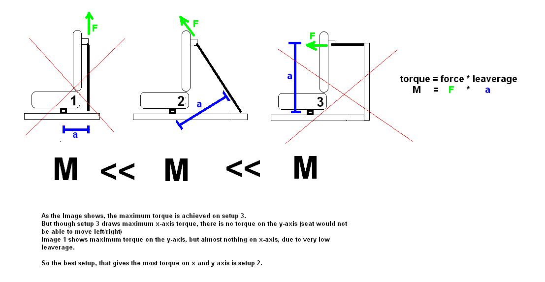

    For those of you considering deviating from the actuator angle of the original Frex design, I contacted Mirai about thiis issue. I asked the question is several different ways, and the answer is, that it is OK to deveiate from the original Frex actuator angle, and that it may in fact be better to place the actuators in a more upright position.
    They are not aware of anyone that has done any testing on this, so our conversation was about theory, not proven scenarios. I will be doing some testing this evening and logging the maximum amp draw at various angles.
    Also, there is no need to put fuses on the actuators in order to protect them. I was told by Mirai that if an actuator was overloaded and attempted to draw more than two amps, that it would safely shut itself off.
    They expressed that the greatest concern about actuator life is ensuring that the actuator does not get ran at high speeds beyond its end point because this would cause catastrophic internal failure of a pin that is not designed to be servicable.

    It is OK for sure, as it does not harm the actuator.
    But it wont be efficient to decrease the angle. Have a look on this image:
    Regards
    Christian

    Thanks for the detailed explanation! What you are saying makes good sense. I was unable to do any conclusive testing tonight because I am waiting on a friend to lend me an amp / current data-logger so that I can see the true peaks.
    Based on your diagram, there is no question about which would be more efficient from an overall push / pull perspective. Now I need to find out how the difference impacts the motors and try to come up with the most efficient angle that minimizes radial load and factor that in as well.

    The angled SCN5s should be angled backward of the chair and outward (left to right) of the chair as well. That would give you the best chair movement per SCN5 travel, negating a 150mm where a 100mm travel would work quite well.

    Of course, thats right.
    I think Bernad is struggling with the limited space within the roll cage.
    But the way he has placed them currently is suboptimal for sure.
    An 80-70° angle in both directions would be a good compromise in efficiency and space consumption, I guess.

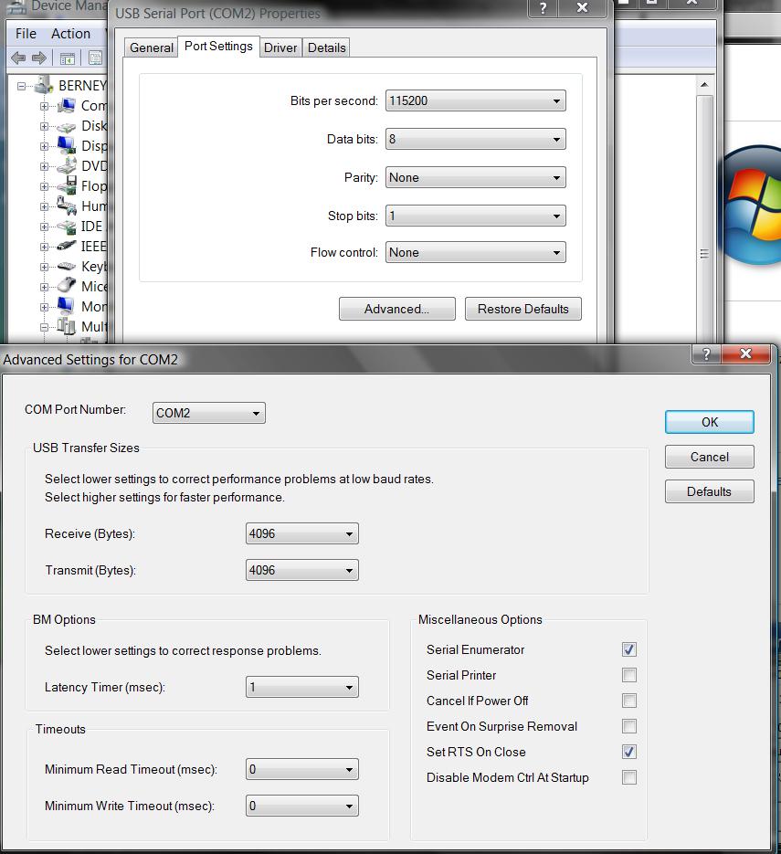

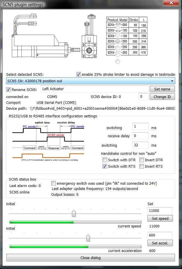

    Just a quick update n the Devantech USB<-->RS485 adapters. Through optimization of the driver settings for the FTDI chip, I am now able to get 154 actuator updates per second. Here are the screenshots for the settings. If you try these settings and your actuators are not detected at Profiler startup then they are probably a little too aggressive for your PC.
    Can anyone post some comparison numbers of other adapters. I have no idea if these numbers are good or not. What type of outputs/sec are required for smooth motion?

    If you didn't tried yet, set the serial printer option. It should make it more accurate in terms on timing accuracy...
    Here are instruction how to: post9707.html#p9707
    Regards, Thanos
