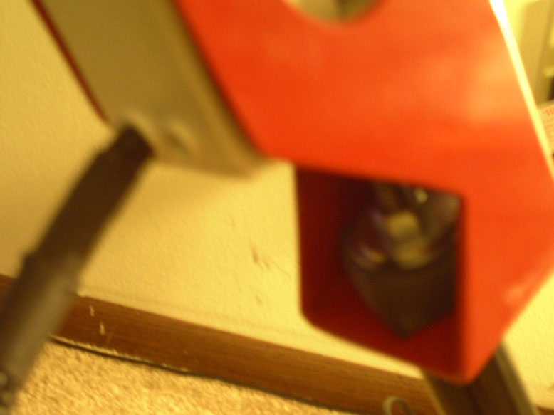

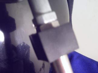

    One of the greatest risks for damage to SCN5 actuators is that you retract one too quickly and damage the pin inside the actuator which I am told is not a servicable component. There are several ways that you can make this mistake:
    -Miscalculate your actuator angles.
    -Use too high of a speed with too small of a decelleration ramp in your settings
    -Overload it (maybe an overweight friend for example)
    Here is a way that you can help to guard against this. I made up some actuator bump stops out of a fairly soft rubber. I haven't had an instance yet where they got put to use, but I feel better knowing that they are there. If you decide to make your own, make sure that they just begin to touch at 100% travel with your 25% limiter disabled so that your simulator calibrates correctly!
  17. dre99gsx
    dre99gsx New Member
    Nov 14, 2008
    39
    0Coins
    Good idea. If you retract from full extend at full speed, it is possible with your weight and increased momentum that the SCN5 might not have enough braking power to stop before the limiter, causing you to hit the hard stop. Definitely having some sort of rubber stop is a plus.

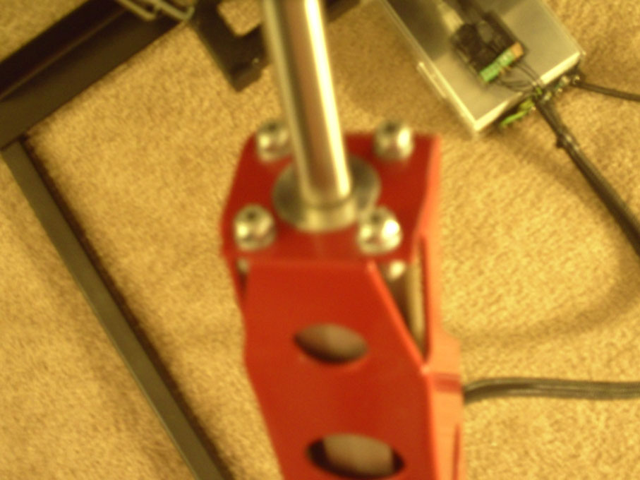

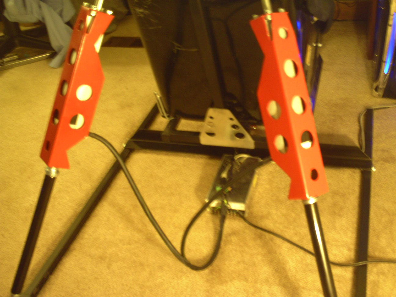

    Here are some pictures of my prototype actuator covers with the space built in for a variety of dampening mechanisms. I am still testing various dampening materials and do not yet know which will be the best. One of my favorite features is that the length is hand-adjustable so it's easy to level the seat when I experiement with various actuator angles, which are also fully adjustable.
  19. RaceRay
    Nov 8, 2006
    4,657
    Hamburg, Germany
    23,877Coins
    +2,076 / 13 / -0
    Hi Bernard,
    really nice looking concept. I assume the covers are made of metal? How did you work them out?
    Also a great idea to save some weight of the sim at all. Is the construction stable enough?
    I ´am afraid that the adapter covers could bend when there is too much force on them.
    regards, René
  20. bvillersjr
    bvillersjr Active Member
    Oct 11, 2008
    1,174
    Ohio, USA
    438Coins
    +23 / 1 / -0
    Everyting is made of steel, so it's fairly ridgid. I think I could stand on the actuator covers vertically.
