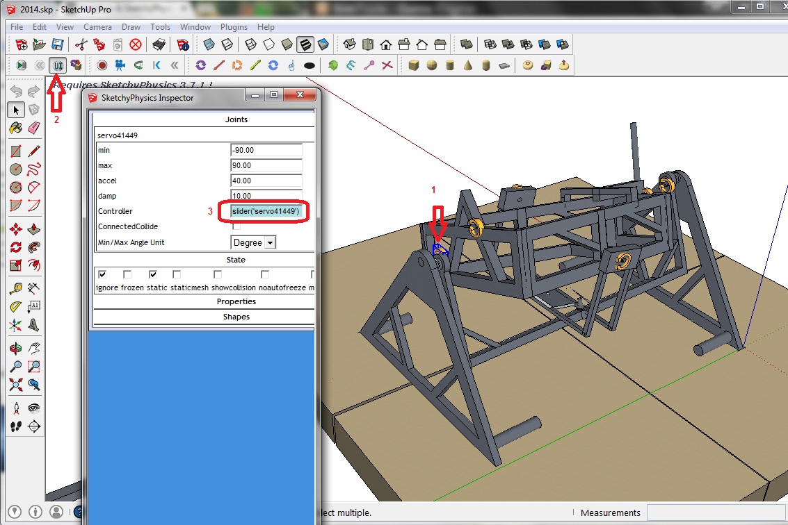

    Select a joint and bring up the sketchyphysics UI - make sure there's no "slider(hinge12345)" in there or whatever it defaults to - make sure it has $axis1, etc listed in there

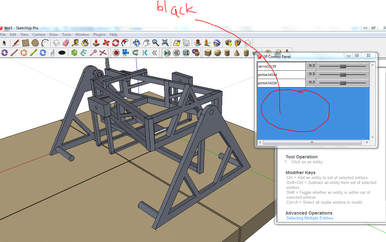

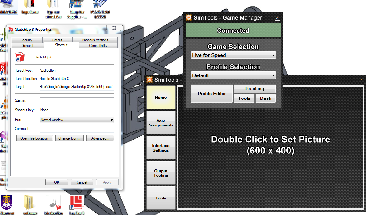

    how can i got the black like you? now i used google sketchup 8 and sketchyphysics 3.2.. so still cannot connect to the game..how?hmm..sorry if dirsturbing

    @Malik10 ... please read this post carefully ... please understand and do every step exactly ...

    @speedy i was follow that step but black screen wasn't find in my laptop..

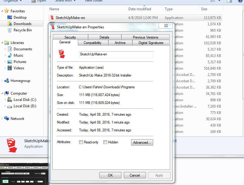

    Can I just confirm that you are using the 32 bit version of Sketchup, is that correct?
  8. Malik10
    Malik10 Member
    Mar 3, 2016
    68
    MALAYSIA
    657Coins
    3DOF, Arduino, SimforceGT, Motion platform
    yes..i am sure it is 32 bit..i was install google sketchup 8 and unistall sketchup 2016..

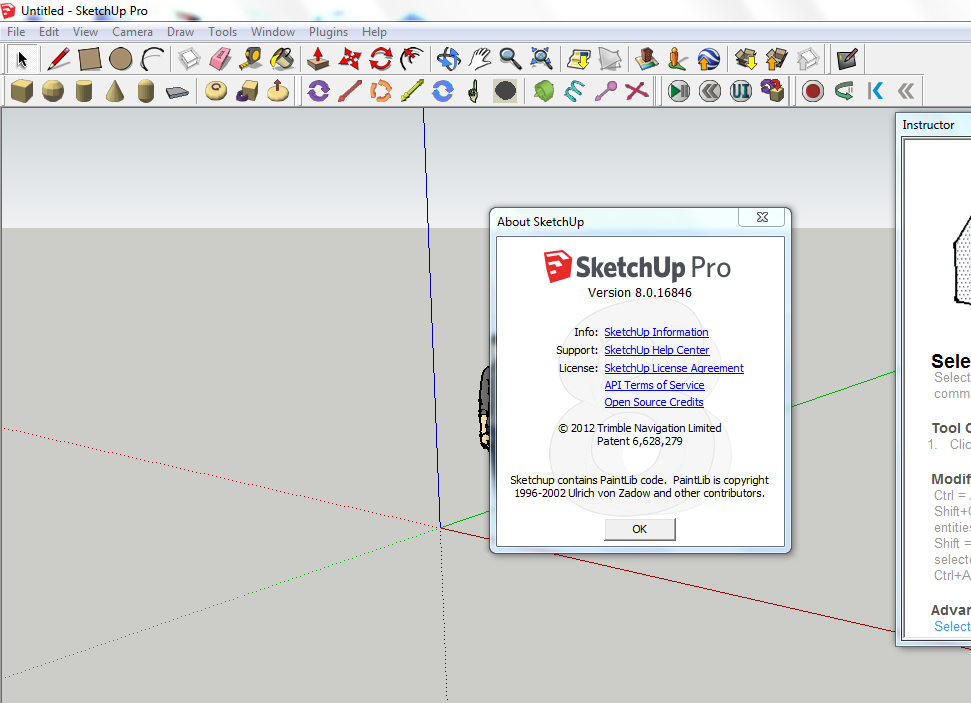

    Sorry to be a pain but I want to be certain, can you go to Help in the Sketchup menu and the About Sketchup, as that is where is shows if it is a 32 or 64 bit version, not the program shortcut.
  10. Malik10
    Malik10 Member
    Mar 3, 2016
    68
    MALAYSIA
    657Coins
    it shows like that..no shows that 32bit or 64 bit..but my laptop 32 bit..

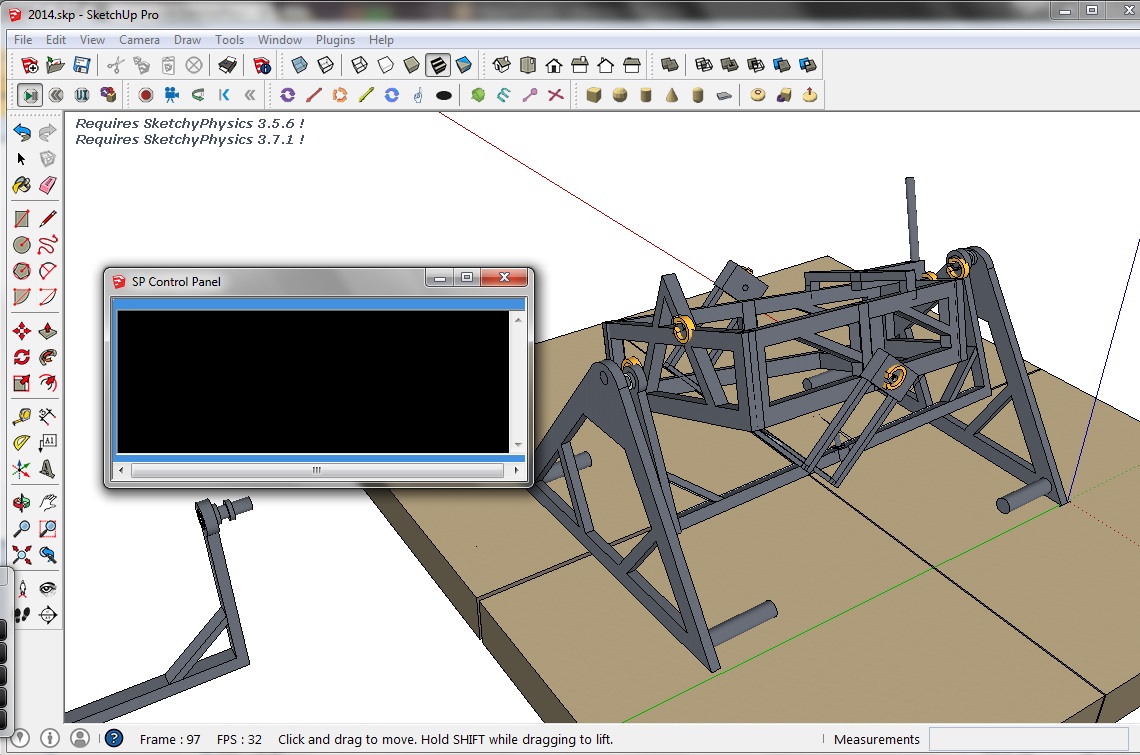

    @speedy ...or i miss anything file? like socket.rb , ruby.rb? you use original without add anything file in your sketchup?i cannot find the black screen on my laptop just can motion with manually...when i rename it, it is not run by game n simtool.

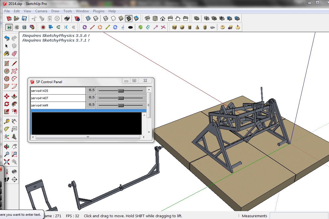

    @Malik10 ... Put photos for all the steps you should do ... the sketchyphysics plugin files location ... the model servo UI properties ... the simtools interface settings ... the axis settings ... everything you have ... there should be a simple something missing that we can pin out easily .

    Are you naming the servos properly, you can check the basic one I got running for you to make sure you get it right, as otherwise it won't work.
