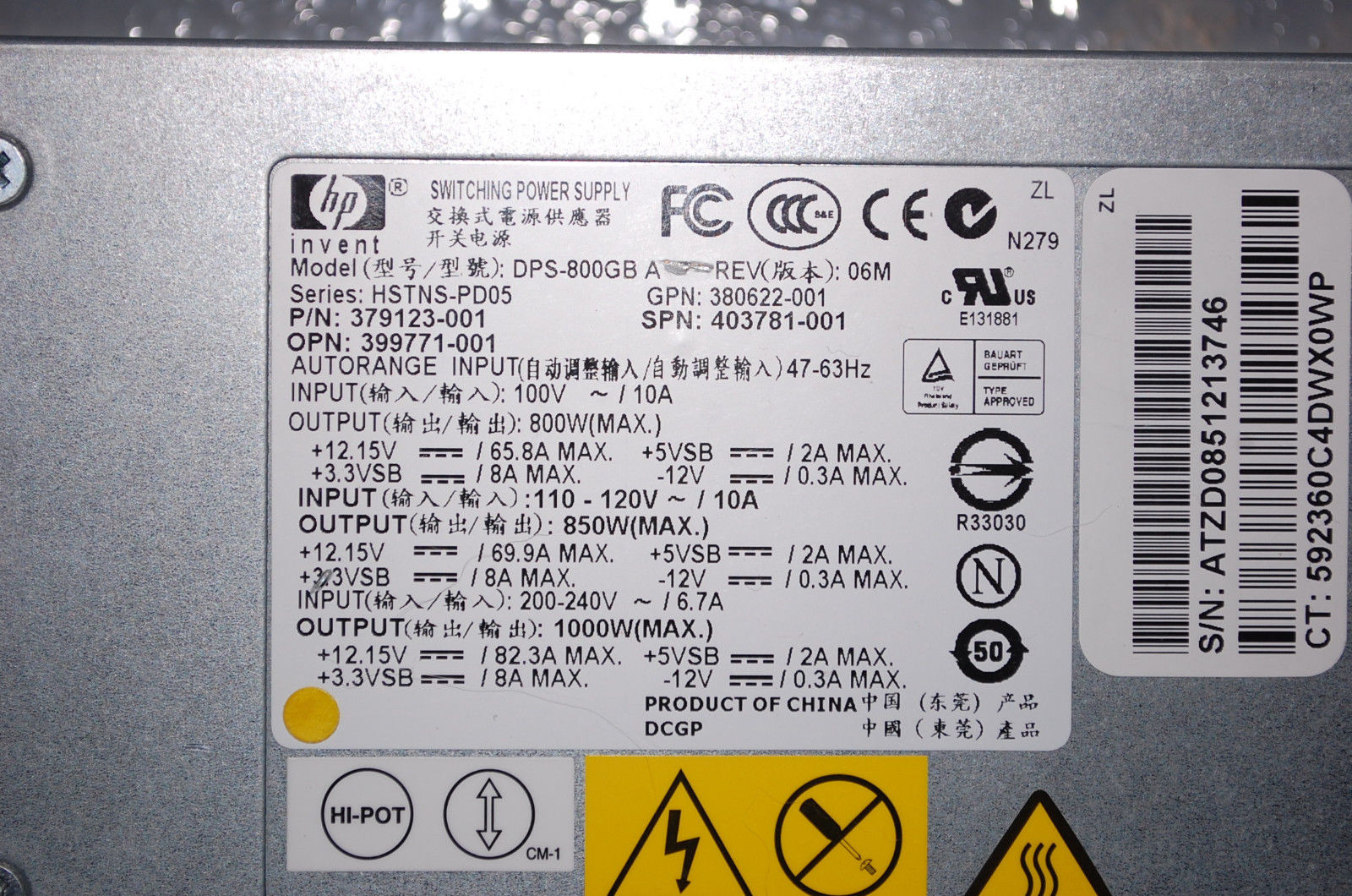

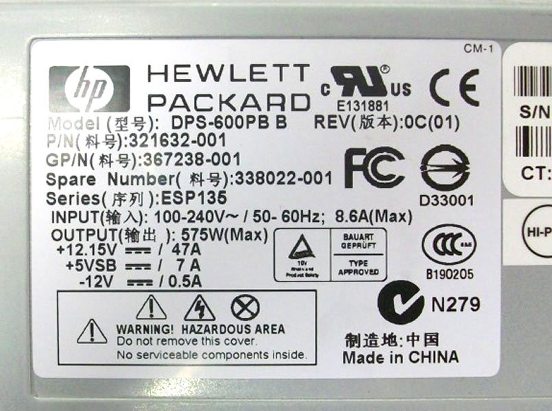

    One of my HP DPS-600 power supplies isn't really excited about life, I've been trying to figure out a cheap way to replace it but wasn't overly keen to grab another DPS-600. But I have a few uses other than the motion sim that could use a good 12v supply, so I figured I'd roll the dice again and grab some more server PSU's but go the next step up.
    So I've gone with some DPS-800's, comparing against the 600's the specs look like this
    DPS-600
    DPS-800
    Overkill ? ...no such thing.

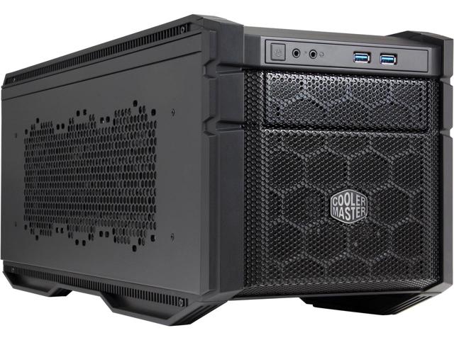

    Also found a cheap case that I can install both PSU's and the JRK's , it's heaps bigger than what I was looking, but for $39 I was going to buy it regardless. Will end up being a HTPC if it doesn't work well as an enclosure for the sim hardware.

    Do you have a link for the case, I am looking for a housing case that my portable VR computer can sit on.
    Edit - found it: https://www.pccasegear.com/products/26828/coolermaster-haf-stacker-915f-mini-itx-modular-case

    I was thinking of using a "2 Port USB 3.0 A Male to 20 Pin Male Header Adapter" so I can use the front USB ports for plugging the JRK's to my computer with the help of a USB Adaptor Type-A Female to Mini-B 5-Pin Male.
    The case also comes with a blank IO shield which is great, either can use that to panel mount some feedback/output power sockets or use the PCI slot covers.

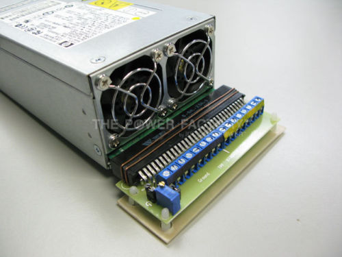

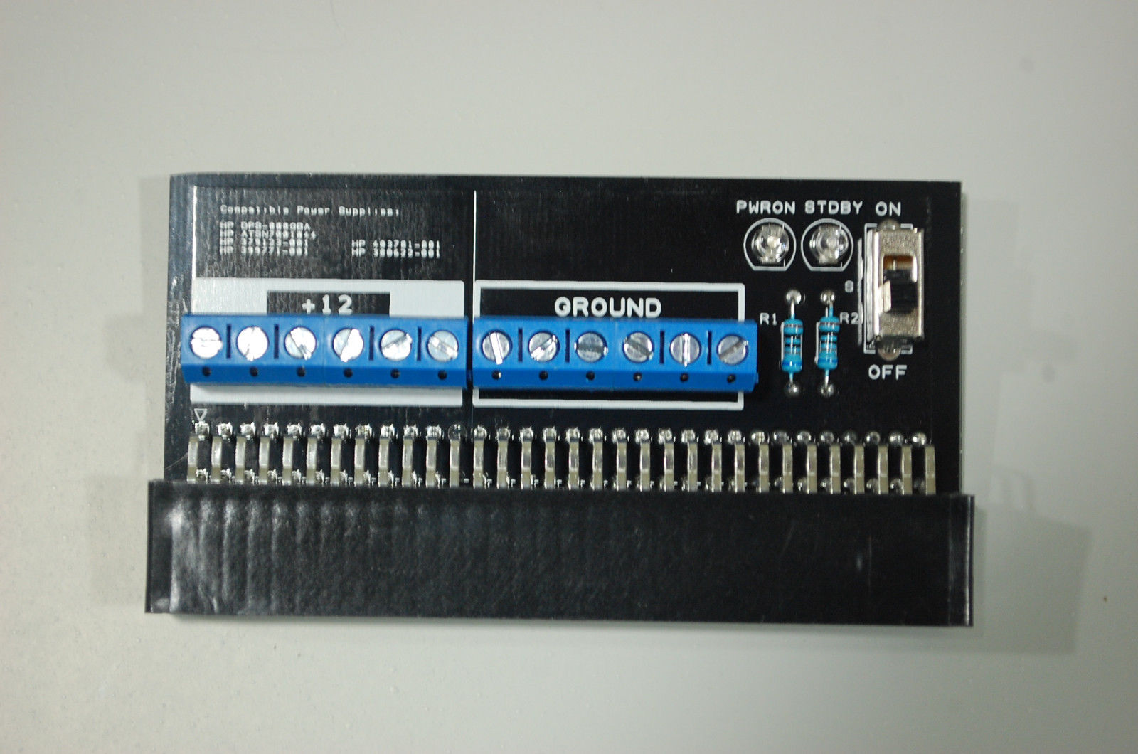

    For anyone interested in the DPS-800 or DPS-1200 server PSU's may want to also hunt down some of these interface boards. Although I just soldered my wiring to the DPS-600's and it has done the job fine, these interface boards just do a much nicer job of it.

    Did the power supply fail? If it didn't fail completely, how did you know it was having problems? I'm wondering if I should have a spare power supply or two laying around.
  12. Nick Moxley
    17,057Coins
    +2,506 / 30 / -2
    For what they are worth $$ wise, it wouldn't hurt to have a spare kicking around. My 600opb's have lost a .1 of a volt on the seat motor's over the past 2 years or so, the Left motor PSU only rarely dips down to 12.5 but overall the Right motor PSU is consistently down to 12.5 now, while the Traction loss PSU has remained at 12.6 since installed.
  13. cgodwin
    cgodwin Active Member
    Sep 18, 2015
    225
    Engineer
    Eugene, Oregon
    2,478Coins
    +278 / 2 / -0
    @Nick Moxley There is a voltage adjustment pin on the 600PB's (pin 9) which is used to dial in the voltage you want and correct for drift. I'm not using it myself, but often people put a 1K pot between +5V and the voltage adjustment pin. I think with pin 9 floating the output goes to maximum voltage around 12.5V, but I'm not sure about that. I wouldn't think a voltage a few tenths lower than it used to be would indicate a problem.
  14. Goatboy
    Goatboy Member
    Jul 4, 2014
    82
    New South Wales, Australia
    386Coins
    +43 / 2 / -0
    The PSU was always suspect in my mind, when I modded them I wrote on one "Will it go bang ?" , mostly cause it's was sitting around 11.98volts when I benched tested it and I'd say it's had a longer duty cycle. The one I wrote one is the PSU that is more sensitive to shut downs under load and it's easy to notice now my motion sim is dialed in better. The PSU that's more stable sits on 12.5volts.

    Please, where did you find it?
    Here is a Compatibe HP ProLiant Power Supply but expensive 26$+35$
    http://www.ebay.com/itm/Bitmain-Ant...ply-Interface-Adapter-PCB-Board-/181832163213
    •DPS-800GB
    •DPS-800GBA
    •380622-001
    •379123-001
    •403781-001
    •379123-001
    •399771-001
