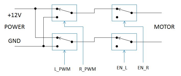

    If it helps here is a basic drawing of how these H-Bridges work.
    The L_PWM and R_PWM determine whether +12V or GND will be connected to each of the motor pins. The EN_L and EN_R inputs determine if the motor pin is connected through or left open circuit. So there are various ways to drive the bridge, typically you put a PWM signal on one of the PWM pins and switch the other to ground and then to reverse the motor you swap the signals to these pins. In this case you can just leave the EN pins switched on.
    Because of the way I setup the SMC3 code it wasn’t easy to just swap the PWM signal to another pin so I leave it on one but switch the other between +12V or GND depending on the direction I want. But in doing this you also have to invert the PWM signal as well – which is the same as swapping the duty cycle: INV_PWM% = 100% - PWM%. (MODE2 does this inverting of PWM) Again in this mode you can leave the EN pins always on.
    Another way of driving it is to use the PWM inputs as the direction pins and just switch them to +12V and GND depending on the direction you want. And then you put the PWM signal on the EN pins which effectively switches the power on and off rapidly to the motors. This is normally referred to as drive/coast mode as it doesn’t apply any braking to the motor. If you use the connections you have given above with MODE1 you will be running the H-Bridge like this. The only disadvantage of using this mode with this particular H-Bridge is that the EN pins are also used to reset the protection circuitry so by applying the PWM to these pins effectively resets the protection at the PWM frequency making it ineffective.
