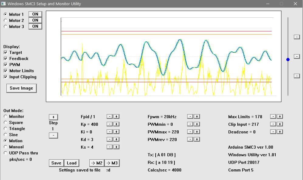

    Any suggestion about smc3 settings?

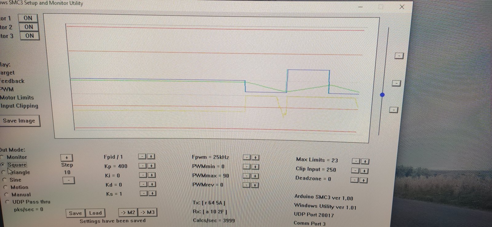

    Hi @all
    I Changed my whole setup:
    Motiondynsmics Motors 25:1 Gears ibt2 Boards.
    Today i gave it a try.
    Same strange results:
    Motor 1 goes one direction. Green Line goes up and up until 255. Suddenly Motor 2 gets full speed like a turn over. Then both stopp.
    Any suggestions?
    Thanks Martin

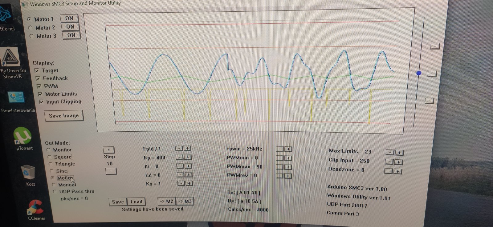

  10. Martin.Berger
    Martin.Berger Member
    May 6, 2014
    73
    216Coins
    Hi.
    I make some Fotos today.
    Yes, it is in mode2.
    Code says: #Mode2
    Is this correct?
    Do i have to change anything else?
    Thanks Martin

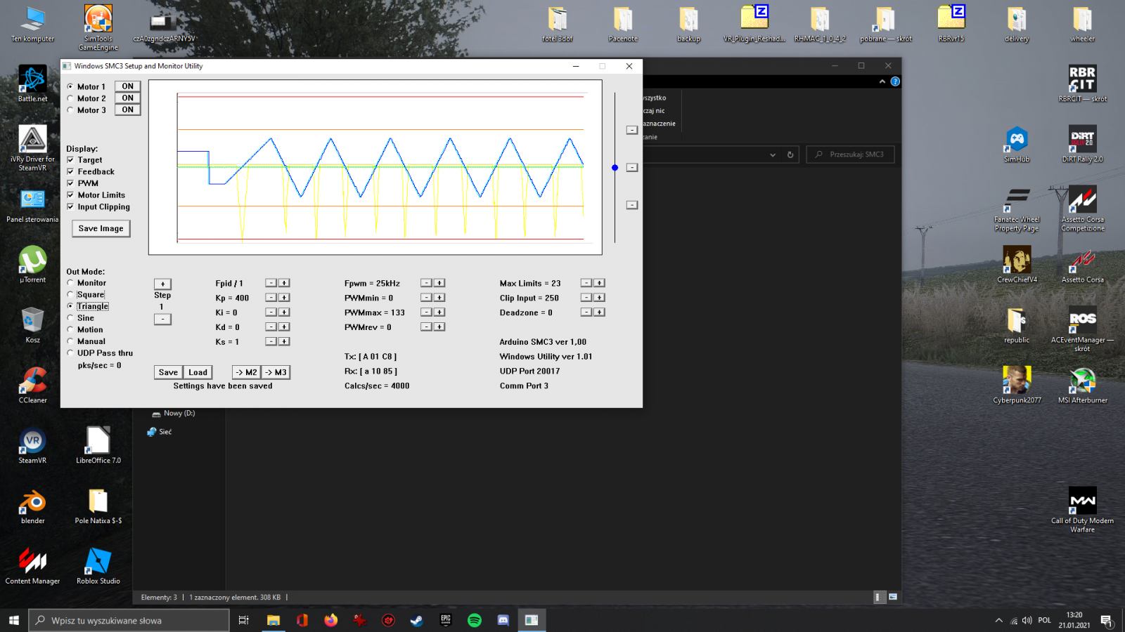

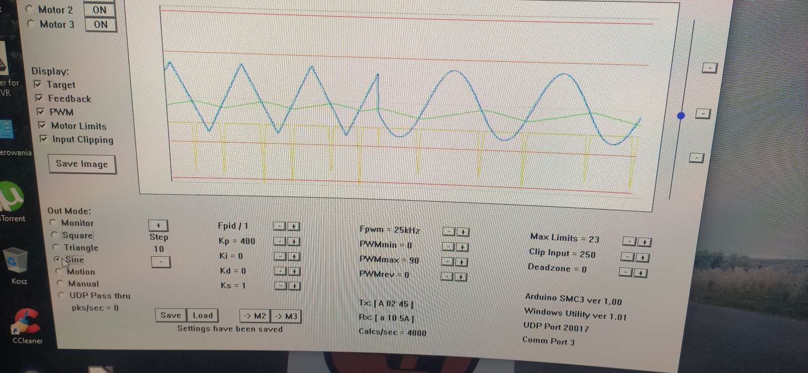

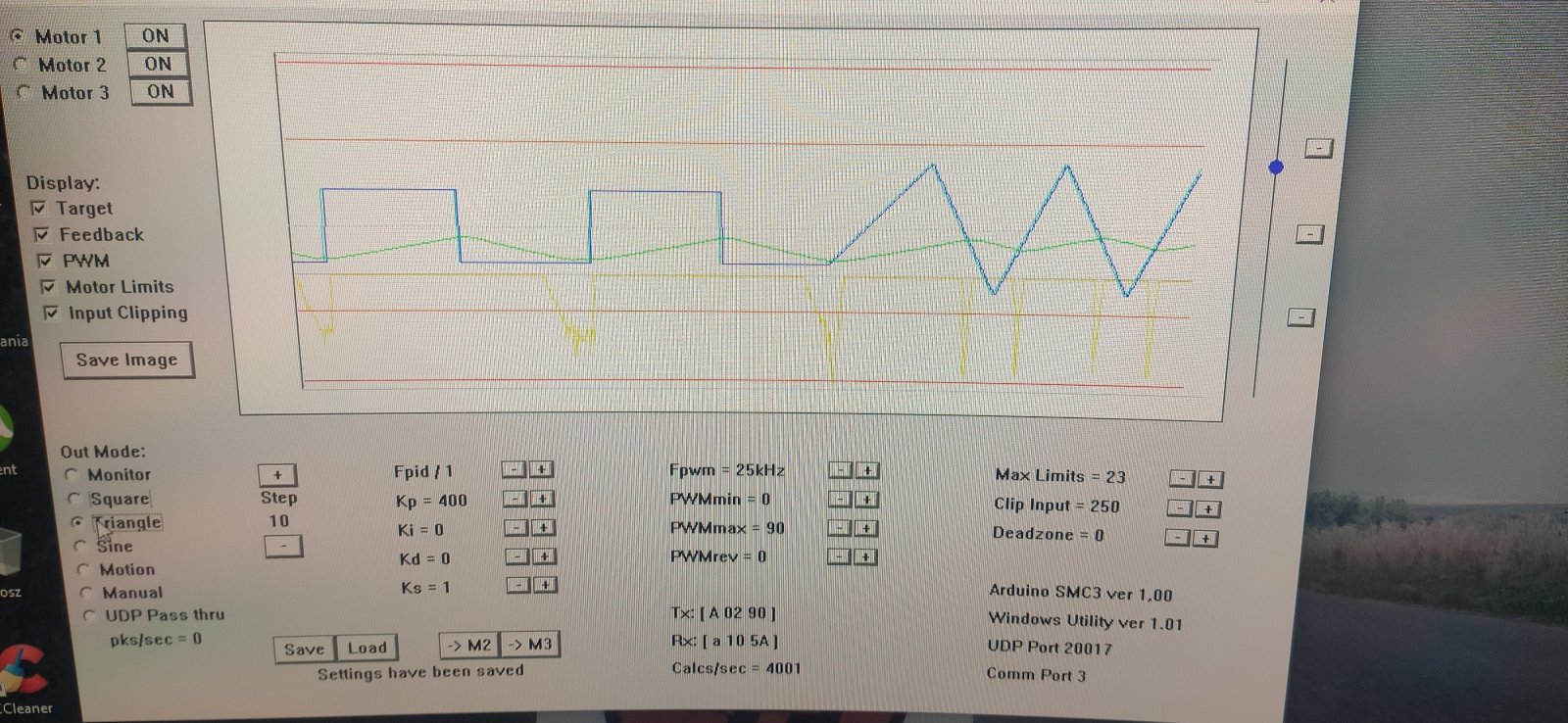

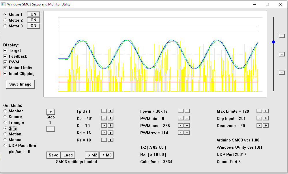

    hi all,
    just bench testing one motor and got the below:
    Does that look fine to you guys?
  14. Krzysztof Dej
    Krzysztof Dej Active Member
    Jun 3, 2020
    315
    Poland
    1,100Coins
    +74 / 0 / -0
    For me everything it's ok

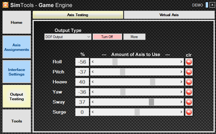

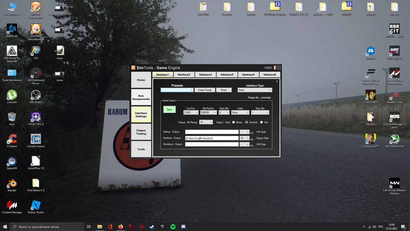

    Hi All,
    I run SimTools and SMC3Utility at same machine. It is not working.
    When I run Output Testing. Nothing happen to my motor, and SMC3 Utility blue line no change.
    Is this project still need to use 2 computer?
    I have done below.
    At the same computer i run Game Engine with below setup
  16. noorbeast
    22,048
    153,884Coins
    +11,154 / 57 / -2
    No you do not need to use 2 computers.
    Make sure you are not running SMC3 and SimTools at the same time, as that will create a port conflict.
    In SimTools you need to have the Default profile configured for Output Testing to work.
    Also make sure that your computer is set to use English Local: https://www.xsimulator.net/community/faq/simtools-language-setting-bug-change-to-english-local.233/

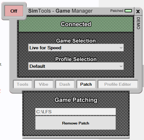

  17. mhchong
    mhchong EK99
    Feb 28, 2021
    17
    freelancer
    malaysia
    - 120Coins

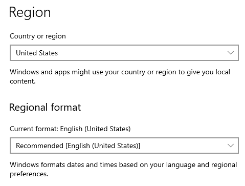

    @noorbeast Thanks for your Fast reply
    What you mean by Default Profile?? You mean this?
    My region Settings
    I run Game Engine individually, the motor still no running.

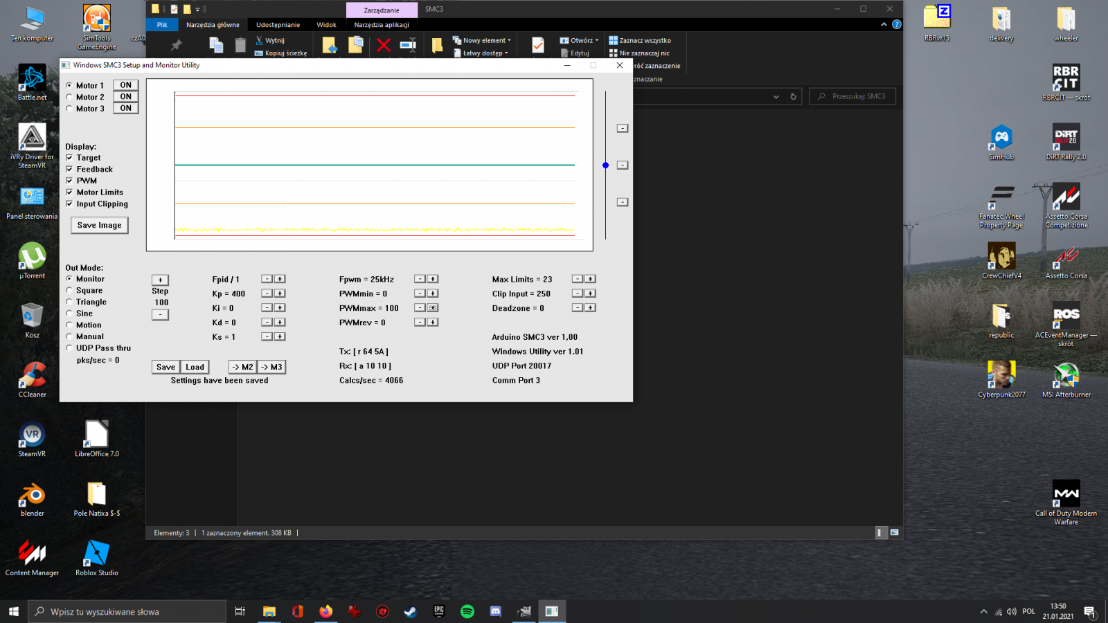

  18. mhchong
    mhchong EK99
    Feb 28, 2021
    17
    freelancer
    malaysia
    - 120Coins
    When started Game Engine, the Arduino Tx Rx light are off.

    In Axis Assignment the Default profile needs to be configured.

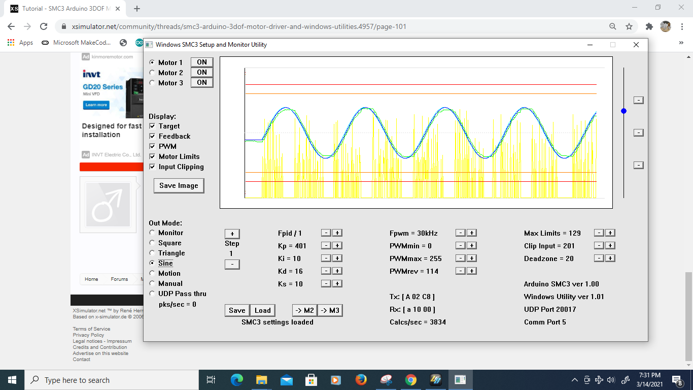

    Im able to do test in SimTools 1.3, after change the interface setting and arduino file to match with SimTools1.3.
    When using SimTools2.5.1 demo version, with latest interface settings and arduino file. Im not able to connect to arduino, When click 'Turn On' button in game engine output testing, arduino Rx Tx light is still remain OFF.
    SimTools 1.3 would prompt error if port incorrect, but SimTools2.5.1 demo no.
