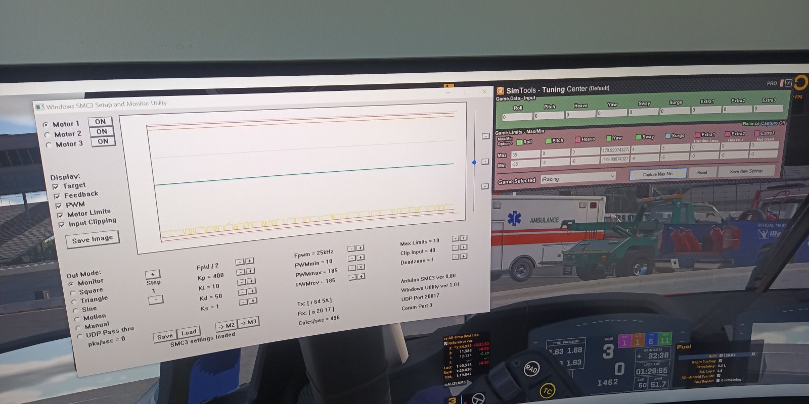

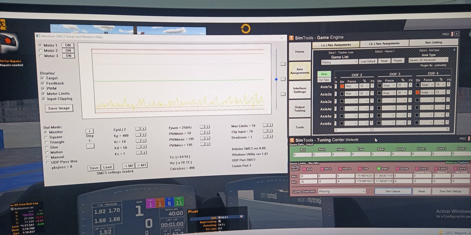

    Hi to all!
    I finish my 2 dof some weeks ago. I am using SMC3 with Sabertooth 2x60 and I have problems. I go with the sim 5 laps without problem but sometimes the motors want to be crazy. They start to tremble or directly they off. I need restart SCM3 and I touch parameters but I don't To get A movement without problems. If I down parameters un tunning center, I dont have the problem, but I dont have movemets. I need help. I dont understound why is the problem. I would like have help of the profesionals of here :D

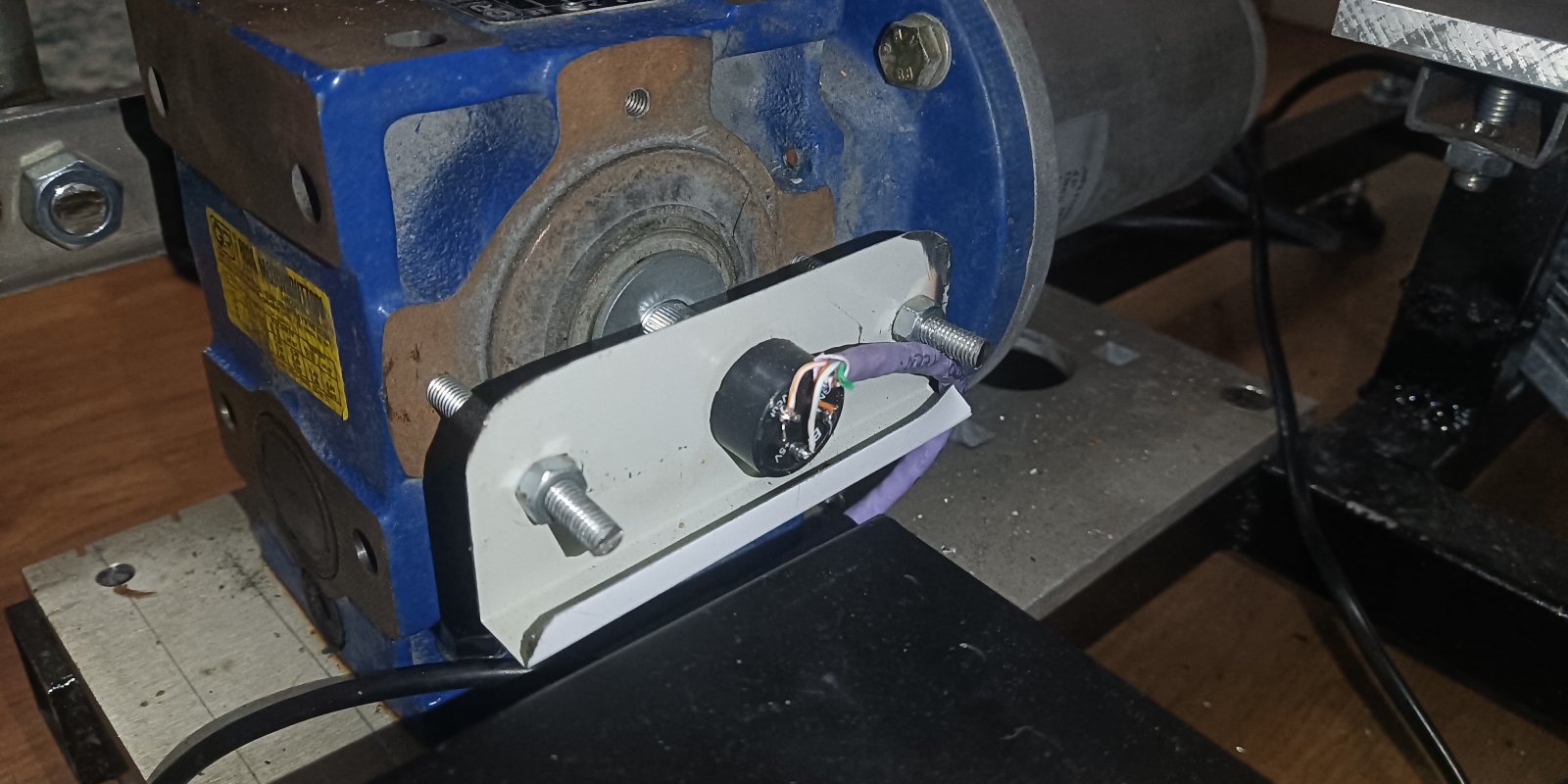

    2DOF, DC motor, SimforceGT
    Hello friend, I am speaking to you from Argentina .... note that surely you must have problems with the potentiometers you have to check if the potentiometers are well coupled with the layered motors that are knitted ... note that in the SMC3 they ballan the most together possible the green and blue lines of each potentiometer.

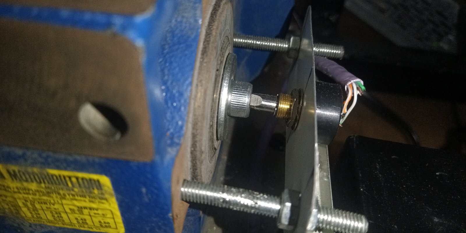

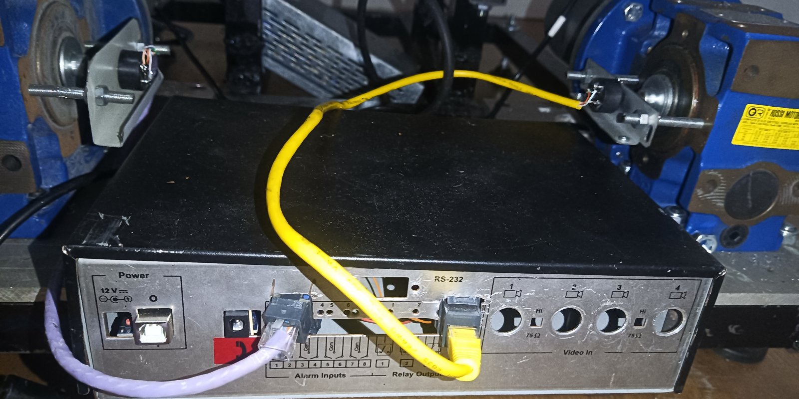

    no have ground cable. is a sensor hall. Interferences?? mmm yes.... sometimes when the motors are stopped i fell a little movement. The sensor hall is conected with utp cable with rj45. Is posible it was the problem??

    Esta es la sala de sensores con cable utp y rj45

    I have sabertooth 2x32
    You have to ground port 8 on the ardunio to get them into 115 000 baud rate or they will go crazy on you. It happens on a rare occasion in 115 to. The cannot handle any more.
    Smc tool does not work in 115 so I have added a switch on mine
    Might need to set the calculation rate fsid something to 3 too

    @Manes
    I would recomend a calculation rate of 3 too.
    Your KP Value is really big to. Do your geaboxes have 60:1 ?
    Did you try to set PWNmin a little lower? 15 ?

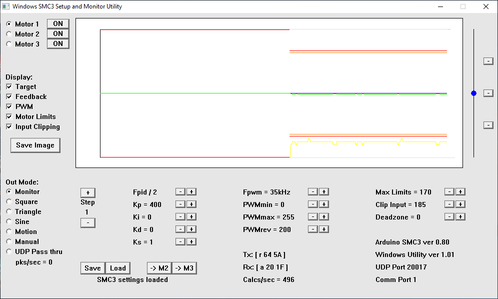

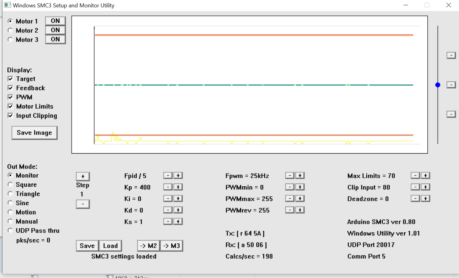

    Your SMC3 value seems off. This is what SilentShill gave me a long time ago:
    This is the last time I checked mine.
    Don't be afraid to put your Fpid higher. Also, put the Max Limit and the Clip Input just before the maximum position where the motor will go wrong. One tries to reverse the motor before it`s too late, and the other stop it.
    I hope this helps.

    Hello. I'm afraid you should use a stereo shielded cable such as a microphone or stereo headphone. and connect the braid to the negative.
    the cable you use is probably not suitable or not able to shield the RF emitted by the motors.
    that constant reversals emit a lot of dirt. let me know hello Marco

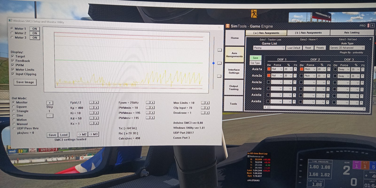

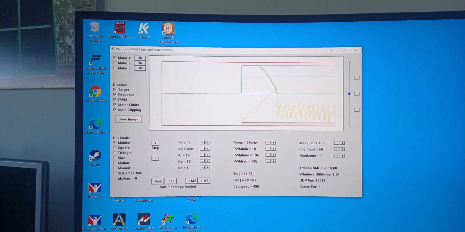

    After to do all yours ideas and configurations, I have the same problem.
    Change cables whith gnd , adjust potenciometers, and put SMC3 whith the parameters same than Pierre and modding this parameters, and parameters of all tipes, and I have the same problem. When i put pin8 or 9 Whith gnd in Arduino, i can't start SMC3 ... It is imposible. .....
