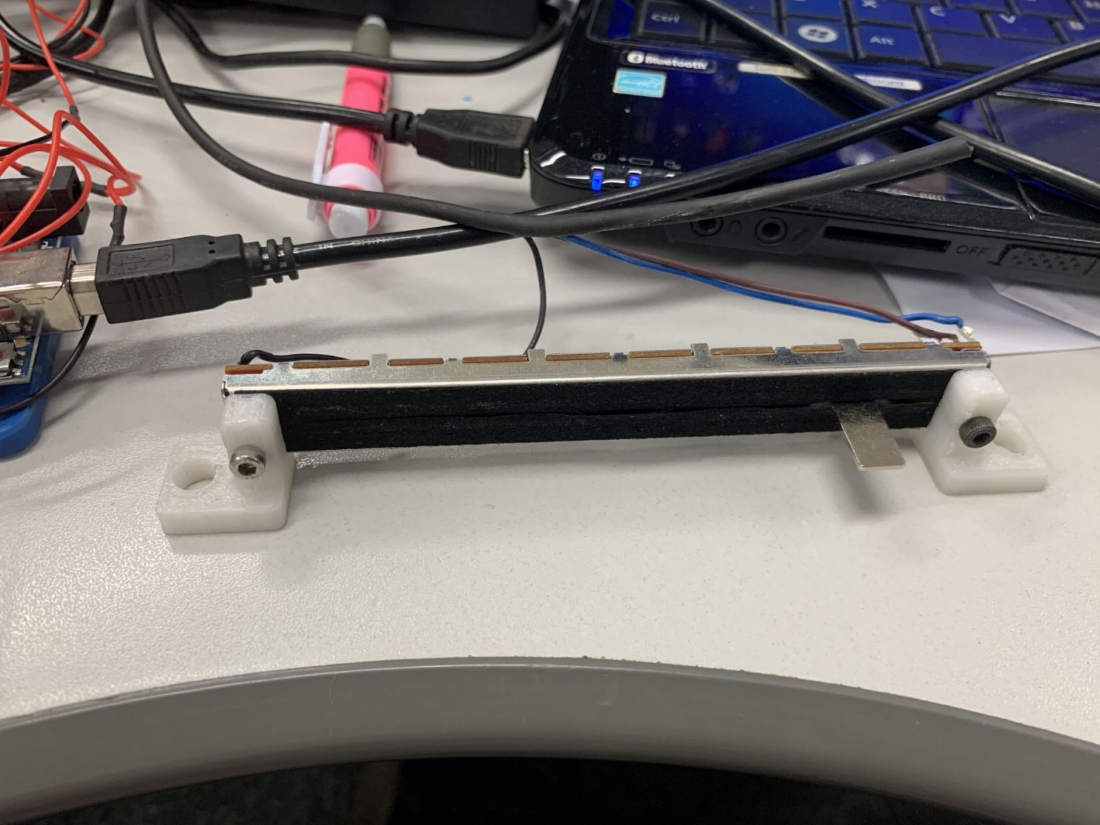

    I'm building my first motion rig. I put everything together (no power to motors yet) and I replaced pots with AH3503 Hall Sensors and magnets attached to motors. Good news is that it works, and I'm getting data. But the range is too narrow. This screenshot capture the entire range of the Hall Sensor output (that is only half of motor axis rotation of course, then it repeats for the second half, but that should be OK, as I don't need the other half anyway)
    Somehow I need to "stretch" it to fill my entire range, and center it too, so bottom and top ranges are similar. Input Scaling seems to do something else - increase output, not input, correct? So what do I do? Any INO code to modify to translate the range to the one of a typical pot?

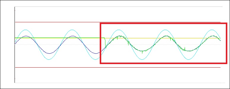

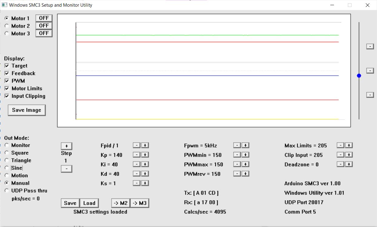

    Thanks for prompt reply @noorbeast. Yes that pot wiring, and settings, can be confusing to me.

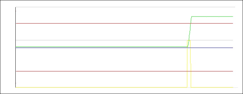

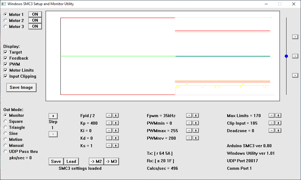

    With pot wiring reversed, the target and feedback seem (?) to operate opposite to each other, and the feedback quickly goes out of bounds shutting the motor off.
    I have just reversed the pot wiring. This time I used "Manual" mode, and started with Target and Feedback close together. The result is shown in the screen shot below. This happens as soon as I apply power to the motor (24v to the driver in fact), allowing it to turn. Have I understood what this shows correctly?

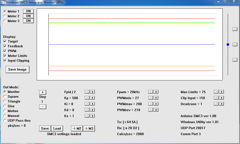

    Below is a screenshot showing settings. Anything obviously wrong?
    Also, it's a linear 10k pot. Any issues with value of that?
    Thank you!

    Are you sure the pot is centered in SMC3 prior to being attached and power applied?
    With respect to your settings it would help to know how you came to have the settings you do, as some look to need some refinement: https://www.xsimulator.net/communit...driver-and-windows-utilities.4957/#post-48121
    Such as:
    Clip Input Used to create a band at either limit of the target range beyond which any values sent to the SMC3 are clipped. In addition to this clipping, if the motor feedback does move beyond this range (typically through inertia), the SMC3 will attempt to brake the motors hard by driving them in reverse until they are back out of this limit zone. The value can be anything from 0-255 (however can’t be less than the current limit setting). Reverse braking is applied in the band between the Clip Input and the Max Limit settings. Reverse braking can be disabled - refer to PWMrev.
    Max Limits Used to create a band at either limit of the feedback range beyond which if the motors move (typically through inertia) the SMC3 will automatically shutdown the drivers and keep them disabled until reset. This is essentially a safety mechanism if something goes wrong. The value can be between 0-255 (however can’t be greater than the current clip setting).

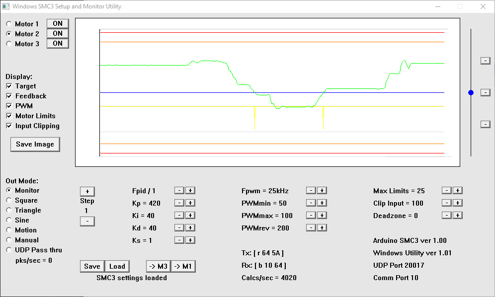

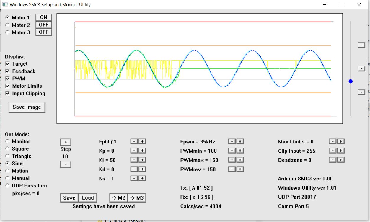

    Is there a way to centre it in SMC3? Or do you mean do I start with the green feedback line in the centre of the display in SMC3 and with the pot at roughly the centre of it rotation (this is what I have been doing)?
    I came to those settings through too much tinkering around. I have just had another go, firstly on my Wiper motor proof-of-concept. Below seems to give the best results for the different waveforms: SMC3 settings on Wiper.JPG
    Now compare that to the BLDC running the same settings (left half of image below). The result is much better with the BLDC :-(
    BUT as you've seen in my video, it is not usable like this due to the motor stuttering badly:
    I couldn't find any SMC3 adjustments/settings that really helped with this issue.

    Max limits = 0. Does that mean that SMC3 does not take it into account? If not, it mean that when ever it goes over that limit, it shut down the motor. Put 250 there.

    Thank you your considering my issue and for your reply @Pierre Lalancette. Yes the motor switches off when it goes outside that limit. It immediately does that if I have the wiring on the pot reversed. I tried it with a setting of 10 and also 250 with pot reversed and it switched off no matter what Max Limits is set to.
    When pot wiring is not reversed (I believe) it stays within the limits and follows the target quite well, but as shown in the video I cannot use it like that.
    I had hoped that I could run my BLDC Driver in a similar way as an H-Bridge driver, by sending a PWM and a direction signal to it from the Arduino, but unfortunately it seems to be more difficult than that. I will now look at other options, such as that shown by pmvcda (aka FlyPT), who has used similar motors but in a different way. It's just going to take me a while to read and understand it enough.

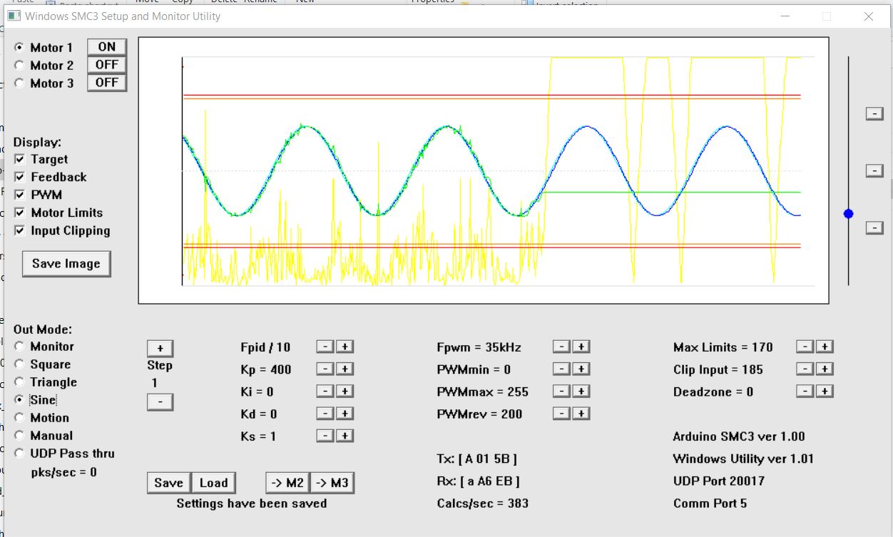

    It doesn't make sense that your use the value of 0 there (unless the value of 0 disable it).
    Here is Silentchill values. KP is at 400. I think it is for reducing the number of time it tries to adjust the motor so it does not shake that much. I use a Fpid of 4 to smooth things out too.

    I have reproduced these values exactly, and also tries putting the FPID up to 10. Unfortunately there is no real difference in the way the motor acts. It is still VERY jerky.

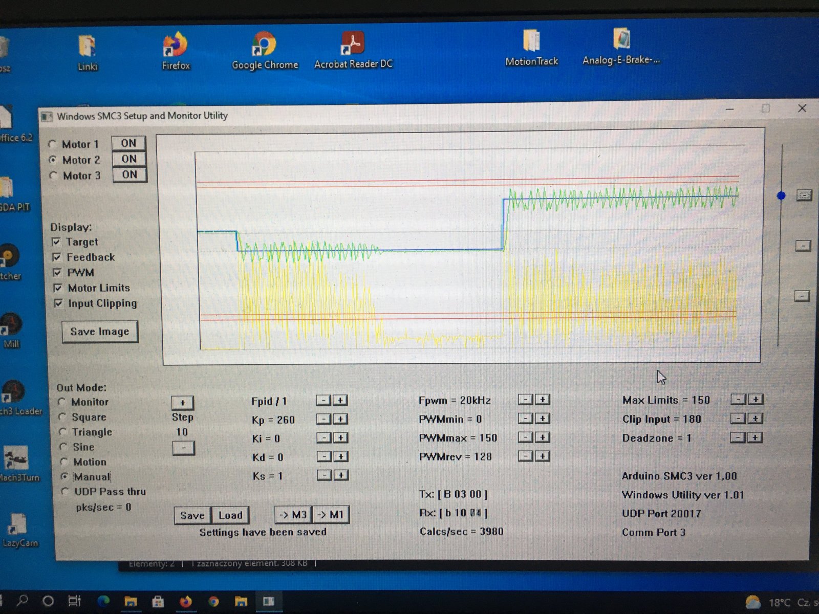

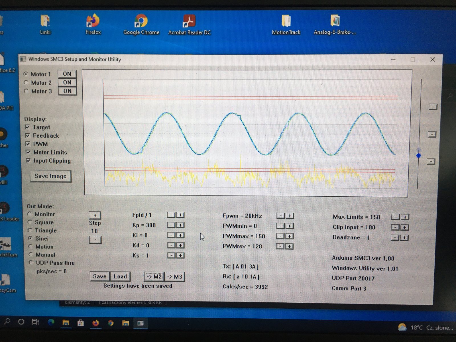

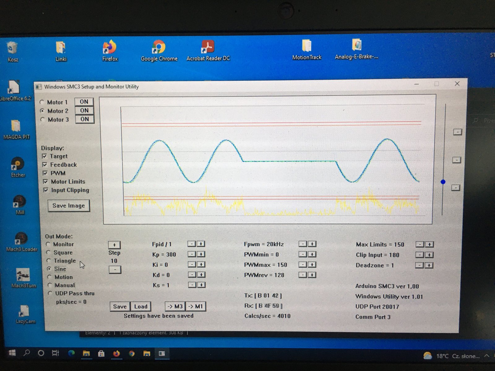

    I have a problem with my configuration. :( 24v 350W motors pololu 1455 drivers. 3x 24V 600W power supplies. I set everything in smcutils and it looks ok. During the test the motors start to slow down. Increasing KP causes oscillations on the arms. Increasing RPM max results in either stopping the motors completely or oscillations again. Platform generally it is balanced When I run simtools and check the axes in outup test, e.g. I can lift the platform up, lower it and it will not come back up the engines are blocked only a complete reset of the drivers helps Any suggestions?
    96FA4E44-A528-4629-9359-B8DAD949FE4A.jpeg 3117F4E5-ED3B-4F37-98D6-6F69EBC77BB0.jpeg BADFCF5D-FD45-421A-9FD9-A3795BF33F05.jpeg 22BF53B8-BFAB-4A63-9F74-AB6D789AE031.jpeg

    Fpid should be higher (mine was at 4). It helps smoothing. It may not solve your issue but that is were I would start. My Fpwm was at 35khz.

    I had to use Fpid set to 4 when I was using SMC3

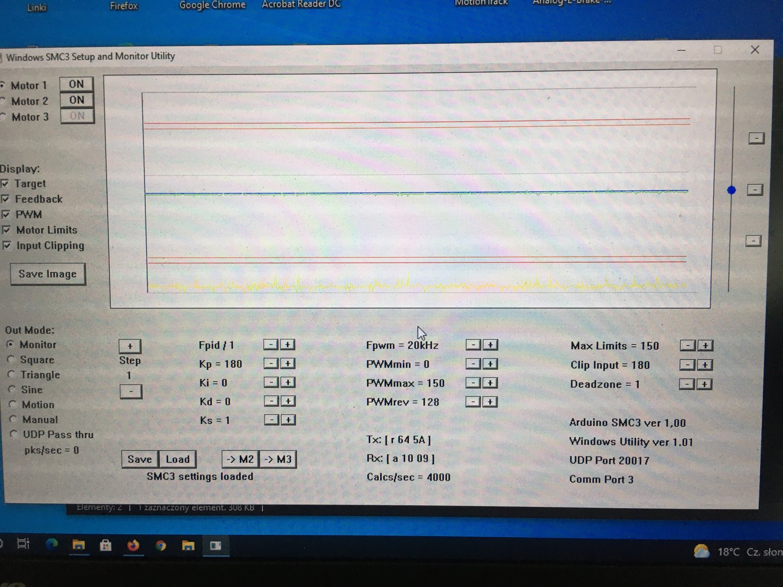

    generally working, but there is a problem with one of the engines. As if I would not set it off after a while. I am not able to set the correct pids on it. It walks for a while and turns off. Cold engine, same as driver.
