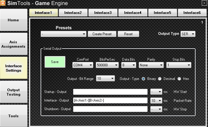

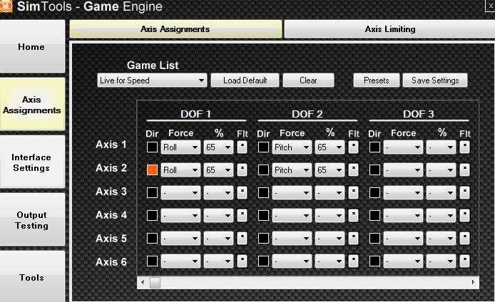

    Can you post screen captures of your "axis assignment", "interface Settings" screens? It should not matter what the axis are assigned to, if they are assigned to Roll and pitch then when you move the roll or pitch slider in Output testing they should move. Test by Axis instead and make sure each axis moves when you slide the slider (rather than by DoF).
    By the way; Output Testing only uses the default profile so make sure that is the profile that you are changing.

    Hi there Historiker,
    I solved the problem of the Roll & Pitch, my default profile was set to Sway & Surge (silly me :rolleyes:)

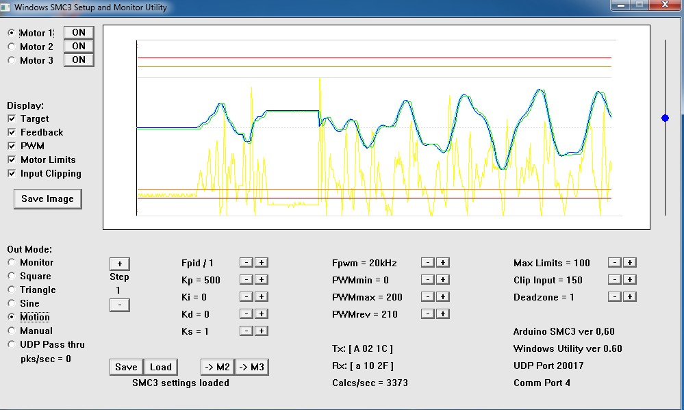

    The reason why i didn't saw it was because the motors only move when the sliders pass 25% (some kind of deadzone? and it seems like there reacting a bit slow)
    anyway here are my screenshots, i also made a screenshot of SMC3Utils
    Thanks in advance :thumbs

    Good to hear you have it working...
    You could try increasing the Kp or adding a Ki parameter a bit to see if that helps with the deadzone issue. It may be that the current settings aren't providing enough power to get them moving until the error increases a bit.
    I note also you are not using the latest version 0.63 - I would recommend upgrading when you have everything sorted there was a timer bug that caused 0.6 to stop working after an hour or so.
