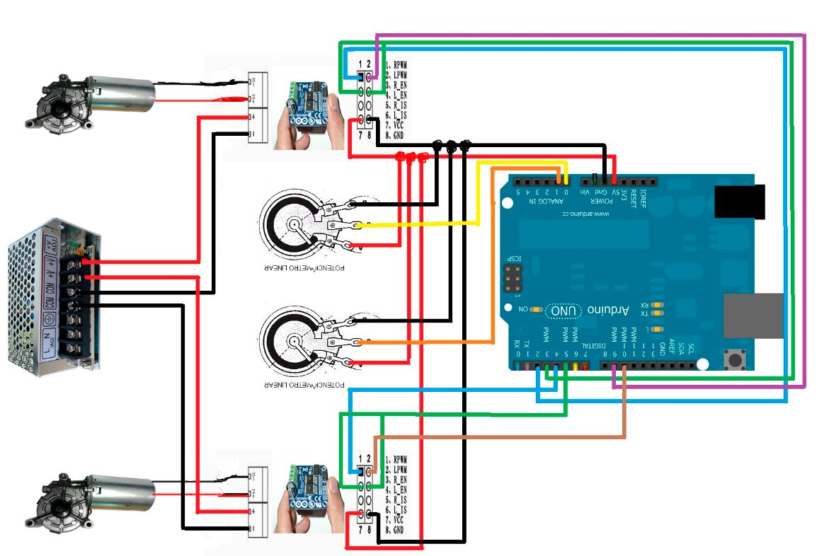

    Are you sure that wiring diagram is right because you look at the code that's not the way it's written pwm is on number two in the diagram but the code is supposed to be on 9 enA and enB it's supposed to be two and three I don't understand how cuz my motors don't work for s*** it's going to keep spinning and spinning and spinning

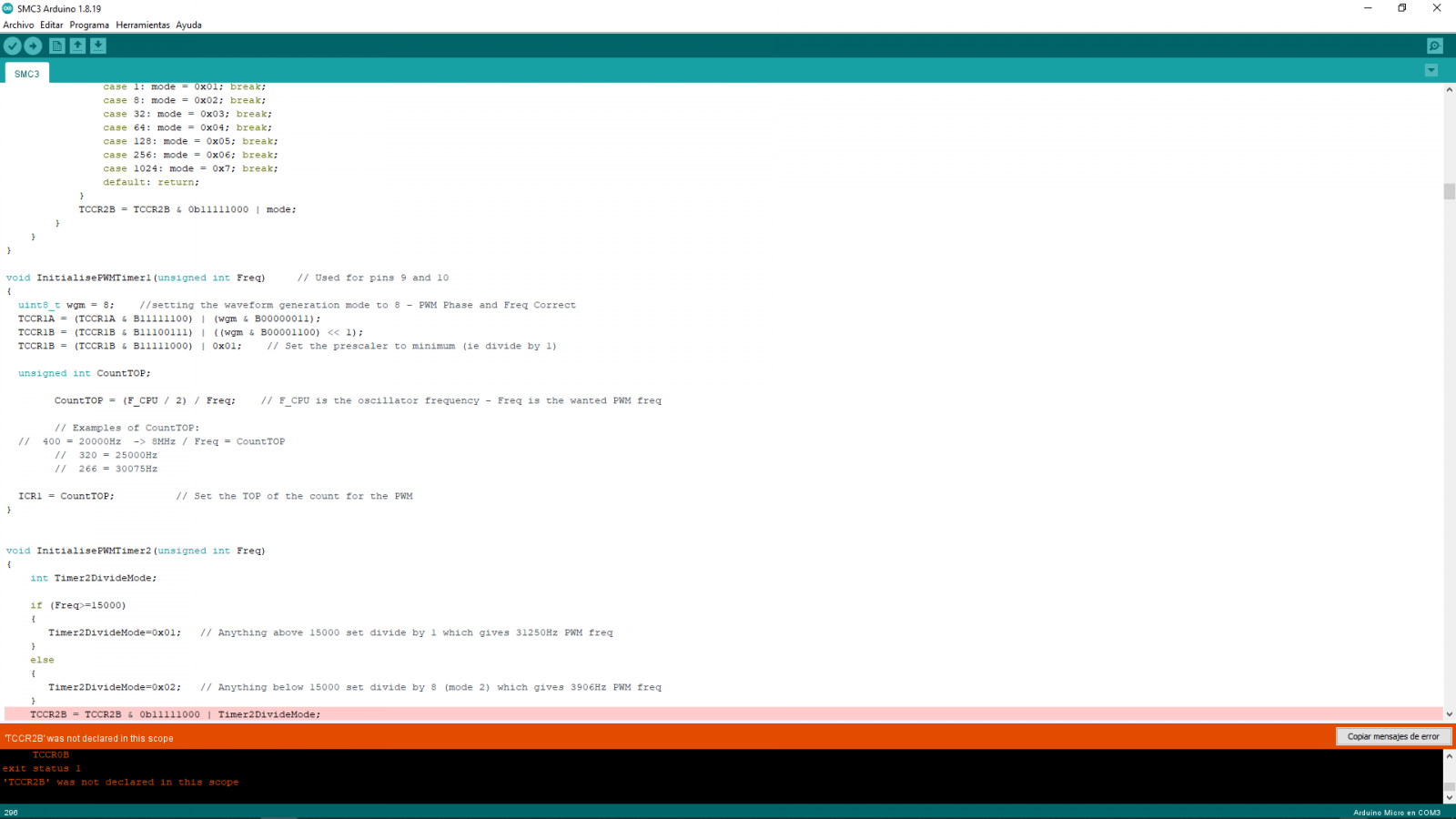

  4. Larux
    Larux New Member
    Oct 12, 2015
    17
    Argentina
    - 1,235Coins
    Hello. I have this problem in the compilation. How can I fix that?
    22,048
    153,884Coins
    +11,154 / 57 / -2
    Where is the code from, what version is it and has the code been modified in any way?
  6. Larux
    Larux New Member
    Oct 12, 2015
    17
    Argentina
    - 1,235Coins
    It is version v1.0.ino. Is there a more recent version?
    Nothing in the code has been changed
  7. Larux
    Larux New Member
    Oct 12, 2015
    17
    Argentina
    - 1,235Coins
  8. Larux
    Larux New Member
    Oct 12, 2015
    17
    Argentina
    - 1,235Coins
    Problem solved, I had the arduino micro board selected instead of arduino uno. That's why it didn't compile. Thank you very much too

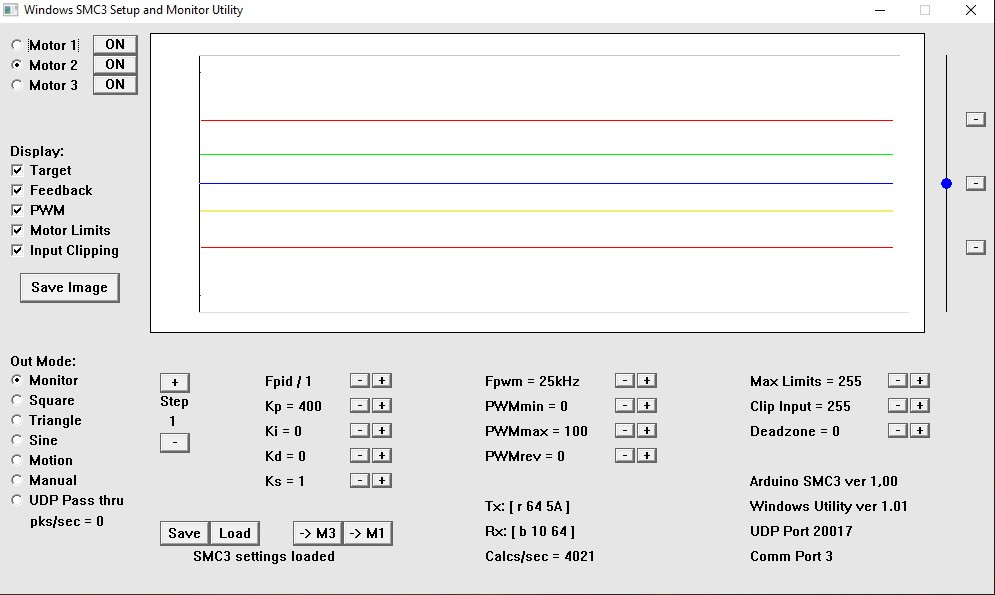

    When running a motion test like sin, within a few cycles the green feedback line and the yellow motor PWM line stop updating in SMC3util. The motor continues to move as expected. Is this a common problem or is it just me?
    if I exit SMC3utils and renter it generally starts working again.

    Hi everyone, I'm stuck with the "SMCutils" tool. I don't understand if this tools is essential to use.
    I have difficulty setting only the limits CLIP, MIN, MAX ...
    In Simtools there are also the "Axis Limiting" settings, are these not enough?
    I have already tried to read many times in the following post:
    but i am very confused with the values of CLIP INPUT, MAX LIMITS.
    Can you explain me how to set these two parameters?
    I have 2 types of stations: one with gearmotors and one with electric actuators, both with 10K potentiometers (infinite rotations).
    Please give me some help, thank you

    The SMC3 utility is used to properly setup and configure PID and other settings for your specific hardware, and this should be done properly and before messing with SimTools.
    The SMC3 tuning parameter explanations are all in the second SMC3 thread post: https://www.xsimulator.net/communit...driver-and-windows-utilities.4957/#post-48121
    But likely what may help is some simple foundational understanding of PID, as in the end that may help put the specific SMC3 settings into some context. While written with a different controller in mind here is a gentle introduction to PID, which also has links to more accurate and in depth descriptions, depending on how far down the rabbit hole you want to go: https://www.xsimulator.net/community/faq/a-laymans-analogy-guide-to-pids-pid-tuning.219/

    The feedback analog input goes from 0-1024. So you need to be sure to adjust the pot to be close to 512 in the middle of your motion range. This is the green line on the plot which should be in the center when the rig is level.
    The values of the limit parameters are a bit confusing. The lower limit is set to the limit. The upper limit is set to 1024-limit. So as you lower the limit, the range of motion is increased. A value of 255 is the smallest range of motion.
    The clip limit is the highest value the system will accept as a target. So if you command the system to go to position 850 and the clip limit is 800 (1024 - 224) the target position is set to 800 by the Arduino.
    If the feedback value is ever outside of the limit the motor will be disabled. The system will not enable the motor while the feedback is outside the limits. This can only happen if something is wrong like a broken wire since the motor cannot be commanded outside the clip limit.

    OK thanks guys for your answers.
    As for the PID values, I have no problem, I have already set the following values (correct for the type of engine I use)
    P = 350
    I = 0
    D = 0
    PWMmin = 100
    PWMmax = 200
    I have correctly set the center of the potentiometers to 512, green line in the center of the visual spectrum, the motors move very well.
    My only doubt is this, I hope to explain myself well: let's suppose that in SMC3utils I set the limit CLIP = 100 and close SMC3utils. Then I open Simtools Game Engine, Axis assignments, Axis Limiting.
    The 100% value of Amount of Axis to Use will correspond to the range of values of the CLIP limit, therefore the motor arms will have a rotation range based on the parameter of SMC3utils and will not exceed the limit of
    CLIP100?
    Are the two parameters (CLIP of SMC3utils) and (Amount of Axis to Use of Simtools) independent or do they interact together?

    Think of the SMC3 settings as a hardware configuration/optimisation and safety limit, so if exceeded everything shuts down.
    In SimTools Axis Limiting is not really needed except as a cushion for some vulnerable hardware, such SCN actuators, which can be very fragile at their limits. For things like DC motors Axis Limiting is not needed.
    Axis Assignments, Tuning Center and Game Manager setting are all about how a possible range of motion (defined in SMC3) is allocate to various axis for a particular game (Axis Assignments), how those responds to game inputs (Tuning Center) and how a base motion profile can subsequently be tailored/varied to say dial in different types of cars for a particular track, or one type of car for different tracks (Game Manager profiles).
    What SimTools does is very different from SMC3, but each needs to be calibrated properly to do its independent but related job.

    I ask you for information and a configuration advice: for the operation of the platform with gear motors (motor shafts in rotation), there are no problems if the mechanical handle exceeds 90 ° or -90 °.
    Instead, I have to configure my 4 linear actuators in the 4 corners (like the D-Box system) with a stroke of 100 mm and I have to be careful not to knock the mechanical parts in the maximum range (over 0 mm and over 100 mm).
    My actuators have no mechanical limit switches and no motor lock, so when the system is not powered the 4 actuators will go down due to the force of gravity. When I turn on Simtools the motors must not be blocked due to the "Max Limits" set in SMC3utils.
    I know that SMC3utils is able to emulate the limit switches through the values of "Clip Input"
    So I need to know what parameters I need to set to prevent the actuators from going beyond 0mm and 100mm and how I can prevent the motors from locking when the actuators are all down (no power due to gravity).

    All the parameters that you set in SMC3Utils are saved to EEPROM (permanent storage) on the Arduino. So those are used in SimTools. As far as SimTools is concerned the Arduino is a black box that you send positions to.
    You should try setting the “filter length” KS. This parameter smooths the acceleration and deceleration to minimize jerk. So if you are having a rough ride this could help. This will increase the following error but a value of 4 is 1ms. I doubt you could feel 10-20 ms of following error.

    SMC emulates limit switches with Max Limits. You would need to set max limits beyond the gravity state. You might want to use a mechanical bumper for when the rig settles at power off.
    Clip input will avoid commanding a position outside of your range.

    By the sound of it your actuators can be back driven, that is they are are unable to support load when unpowered,
    If that is the case a software solution is not able to prevent exceeding set limits.
    If so a mechanic stop, at the limit of the bottom range, may be needed.

    Will this parameter prevent abrupt reversals of the motors?
    I thought that the emulation of the limit switches were the Clip Inputs, which reversed the movement when the value was exceeded.
    The problem is that with the system off, the 4 linear actuators all go down due to the payload and then go to the 0mm position.
    In this case it is necessary for me that when switching on the system and starting Simtools, the motors do not get stuck due to the "Max Limits" which reads the 0mm position.
    Is there any way to trick the system or disable the "Max Limits" parameter?
    If I set the value of "Max limits" to 0 (zero) in SMC3utils, do I fix the problem?
    Or let's imagine for example the operation of the 10K potentiometer: 5 volts (1023) corresponds to the maximum excursion ie 100 mm, to 0 volts (0) corresponds the minimum excursion ie 0 mm. If I calibrate the potentiometers so that at the minimum excursion (0 mm) I don't have 0 Volts in VOUT (A0 of Arduino), but about 0.5 volts, I can fool the system by letting it read that the motors have not exceeded the "Max Limits "and therefore do not go to block?
    Exactly, the ball screws used are the 1605, so the screw pitch is 5mm.
    Is it not possible to disable the "Max Limits"?
    Unfortunately the engines are not equipped with an engine block or predisposition.
