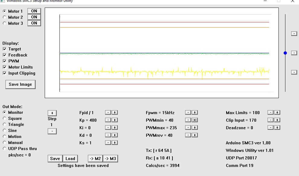

    Hi guys, thanks for the help.
    I tried again to change the parameters in SMC3utils but I don't know if I entered the correct values. That is, now I will better explain the steps I did in SMC3utils. Introduction, today I did the tests with my prototype with 12V micromotors and Arduino and BTS7960. I have selected the following parameters shown in the figure, obtaining the graph you see.
    So I maximized the Clip Input value, but the graph hasn't changed, so the rotational motion of the motor arm has the same angular rotation.
    The effects of the PID values are seen in real time instantly as the motor moves.
    Are the effects of changing Clip Input values also displayed in real time in SMC3utils?

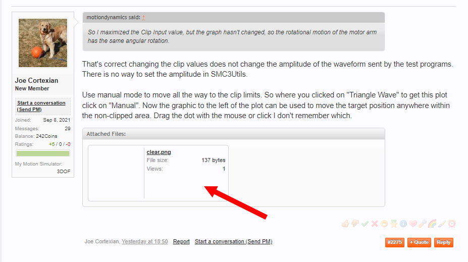

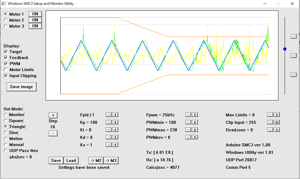

    That's correct changing the clip values does not change the amplitude of the waveform sent by the test programs. There is no way to set the amplitude in SMC3Utils.
    Use manual mode to move all the way to the clip limits. So where you clicked on "Triangle Wave" to get this plot click on "Manual". Now the graphic to the left of the plot can be used to move the target position anywhere within the non-clipped area. Drag the dot with the mouse or click I don't remember which.

    Hi guys and thanks for your help.
    Message to Joe: The PNG file is all black with a pixel in the center.
    So I took a step forward with SMC3utils, namely:
    on the left of the window I selected "Manual", I set the value of 255 in Clip Input, I moved the blue cursor manually within the range and the motor rotated perfectly until it reached a maximum angle of about 60 °. Then I exceeded the Clip limit and the engine did not rotate beyond the limit, I went back inside the limit and it started working again, perfect.
    Then I set the value of 200 in Clip, I moved the blue cursor manually within the range and the motor rotated until it reached a maximum angle of about 80 °. Then I exceeded the Clip limit and the motor did not rotate beyond the limit , I went back inside the limit and it started working again, perfect.
    So I guess I'll leave the value of 200 in Clip Input, this is already a big step for me, having set a value chosen wisely.
    I know that SMC3utils is absolutely necessary to set the values of PID, PWM and safety limits. Also I noticed that the value of 200 that I set in Clip Input is strictly related to the value of "Amount of Axis to Use" (Output Testing) of Simtools, that is, if I set a Clip Input value of 255, the angular rotation goes from 60 ° to -60 ° when I move the slider of "Amount of Axis to Use", if I set a Clip Input value of 200, the angular rotation goes from 80 ° to -80 ° when I move the slider of "Amount of Axis to Use ".
    But I have a question: suppose that due to a software configuration error or a hardware problem, the motor exceeds the range of the Max Limits set in SMC3utils and blocks for safety reasons. How do i unlock the engine? Do I have to act mechanically or simply as a computer?

    First of all I didn’t post a PNG so far as I know.
    Yeah once you are outside the limit SMC3 software will not move the motor ever. So you either have to manually move it or move the pot. The logic in the Arduino is if target exceeds limit disable motor. That means drop the motor enable I/O bit.
    It is possible to write a different program for the Arduino that would move the motor. However, mechanically moving it is likely easier.

    I have attached the screenshot of your attached file, I don't know how that is possible.

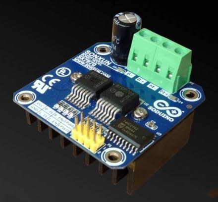

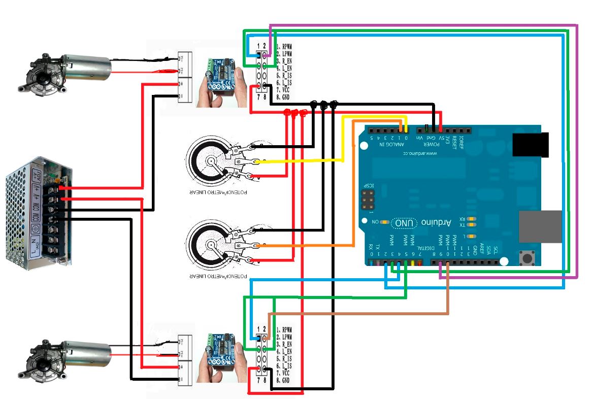

    Hi I use ibt motor driver and wiper motor. Trying to do belt tensioner and have a problem. Before wiper motor Smc3Utils go only down like on picture, I change arduino and ibt and still the same, then I changed motor to wiper motor and when run Smc3Utils. Program start and I see pot sygnal and then when I switch power on Smc3Utils crashes. When I start Smc3Utils with power on its crashes instantly. What is the problem. Wiper is ground protected. Psu is:
    Power: 150W
    Voltage : 12V
    Amperage : 12,5A
