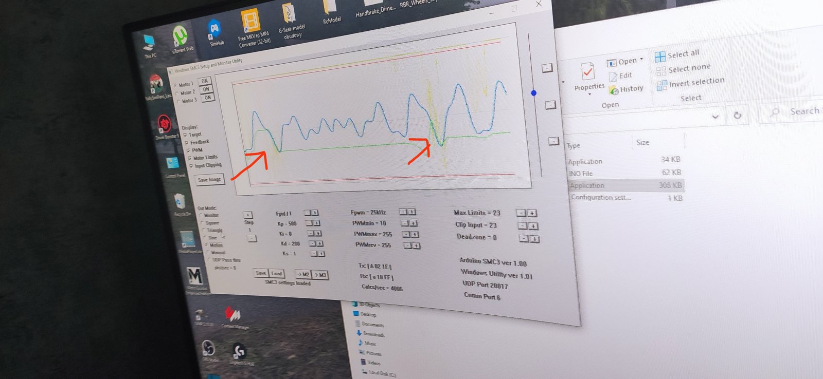

    After the crash....is the 12V Voltage still present?
  2. elnino
    elnino Active Member
    Apr 1, 2010
    246
    Computer Geek
    Adelaide, Australia
    1,557Coins
    +139 / 1 / -0
    So when there is no 12v, and you manually move the arm, does the green line move as expected?
    Have you have you connected the ground between 12v ground and arduino ground?
    Show/explain wiring or it is hard to help.

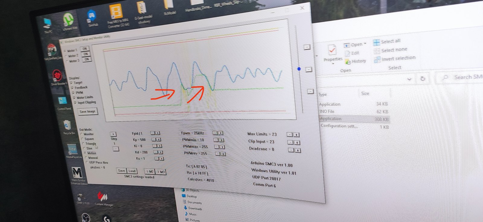

    It's motor problem. Becouse when I turn power on without motor Smc3Utils works but when I connect wiper motor then crash. I will post pic

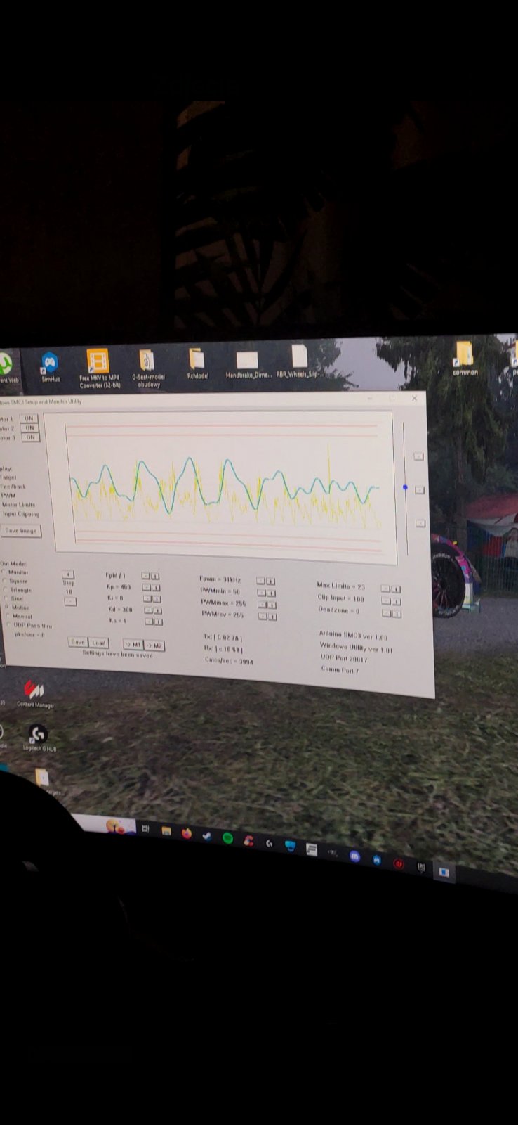

    I connect other motor and it's working but motor fallow pot sygnal only in one direction. Why?

    that doesn't mean anything. I asked specific questions and you give vague answer.
    cant help if you don't answer questions accurately

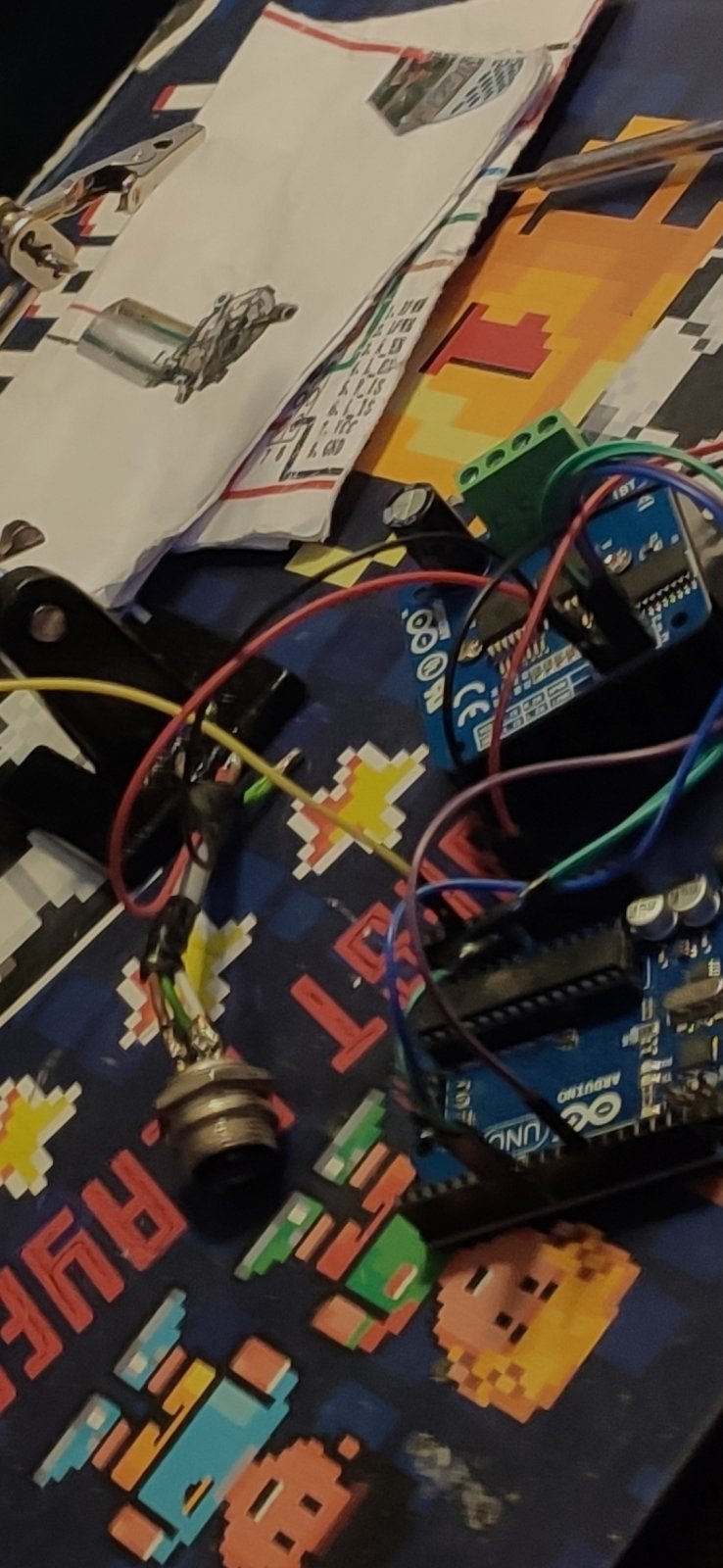

    OK I made a video but if not see well I write it also
    So :
    On motr controller
    1 blue to 2 arduino
    2 purple to 9 arduino
    3,4 green to 3 arduino
    7 red to 5v pot and then to red 5v arduino
    8 black to gnd pot then to black gnd arduino
    Green Vout from pot to yellow a0

    I checked the circuit. Because that's what I can do. And I saw that when I check gnd to gnd there is a circuit. But when I check the voltage output there is a circuit but when I give a circuit to the gnd and voltage I get a reading of 400. So it's like something is connecting. Is it good or not the red wire and black wire from pic. All my photos and The description of my problem is a few posts above

    Ok I find what is the problem. I do not know what and how, but when I connect the tensioner to the metal frame of the seat. You can see something happening AND the motor shuts down. Now I am at the stage of waiting for a printed isolator

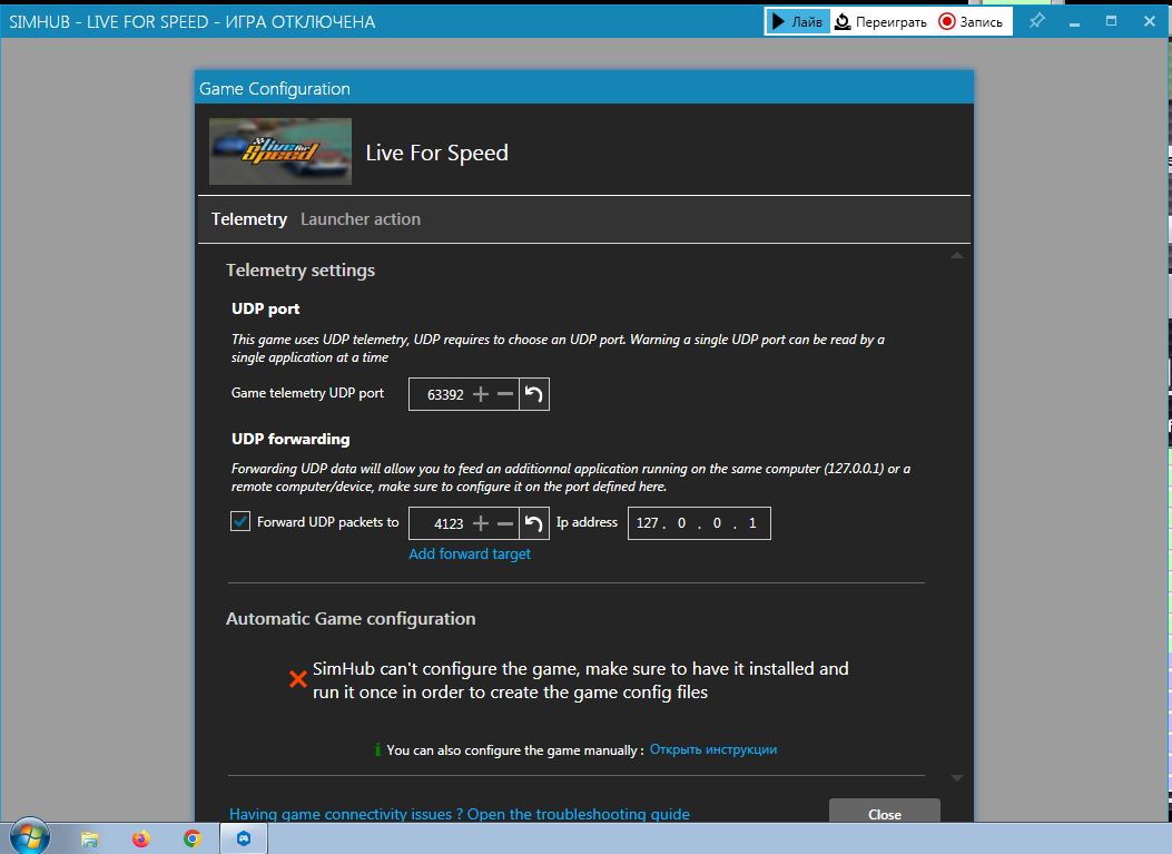

    Hello friends. I can't figure out the udp ports sim hub and simtools in the LFS game. I try to get telemetry on the sale of applications, but nothing works neither simhab nor simtuls. In the Simhub app, I chose port 63392 in the running game and also redirected udp to port 4123. My computer uses one, I chose an IP address: 127.0.0.1 While playing simhub works correctly, but simtools sends data incorrectly. (playground twitches, shakes). What's my mistake? What am I doing wrong?
  18. yura999
    yura999 New Member
    Aug 6, 2017
    27
    327Coins
    Friends, please tell me so what am I doing wrong? Or is everything working properly for everyone?! After all, maybe someone will have the same situation as me, but there will already be a solution to such a problem.
