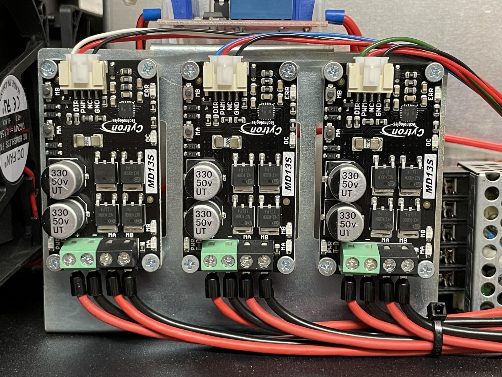

    With my DOFReality P6 with SFU gears I have the following problem: sometimes, when the motor moves down and then up again, it makes a short "dip" at the point where it reverses direction. It's like it loses power for a moment and then has to catch up again. For testing I'm using the SMC3 utility, moving motor R3 in "Motion" mode. The attached image "smc3.png" shows the parameters:
    The problem happens with all 6 motors, but most prominently with the #3 motors in both control boxes. And it only happens when I sit in the seat, so there is more load on the motors. With an empty seat it does not happen.
    Here's a video that shows this: http://www.tvdr.de/flightsim/power-01.mp4.

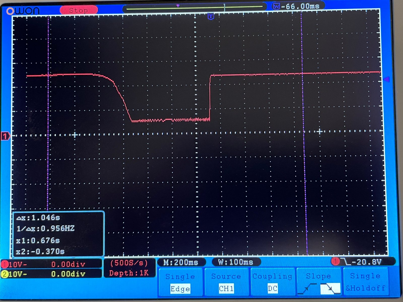

    The oscilloscope displays the voltage between the two motor wires. Note how in the beginning the arm moves smoothly and the voltage switches between +/-24V and does PWM. At about 17 seconds the first "dip" occurs, which also can be heard (the motor sounds differently for a moment and the whole platform makes a bang). At this point the voltage shows an odd behavior (play the video in slow motion to see it):
    It only reaches +8/-6 Volts, and this doesn't seem to be the proper PWM.

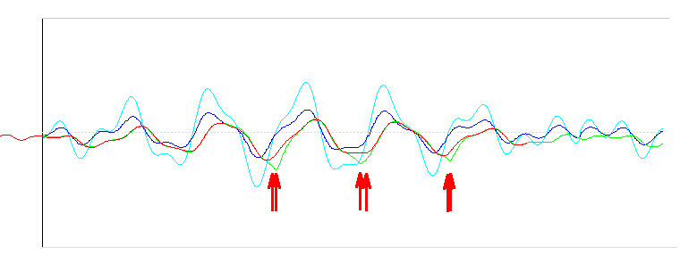

    I have superimposed the SMC3 diagrams of the "Motion" with (green) and without (red) me sitting in the seat:
    At the points indicated by the red arrows you can see where the two curves drift apart. The green one shows the "dip" the motor makes.
    I have contacted support@dofreality.com about this, but so far they haven't been able to help me. So I'm hoping that somebody here knows what's causing this, and maybe how to fix it.

    Could it be your power supplies that can't satisfy the demand in current of all the motors changing direction. For me, it is the most likely problem. Possible solution, having a battery paralleled to the power supplies that would give the missing Amps for the motors.

    Looks like you're right. Here's the voltage measured at the connectors of the power supply at the moment of the dip:
    There are three power supplies in each DOFReality P6 control box, one for each motor:
    https://www.mouser.de/ProductDetail/MEAN-WELL/LRS-350-24?qs=ah3jBNVE1PT%2BkwLcackrGA==
    Putting batteries in parallel to all six power supplies is obviously not an option, so I guess I need to find power supplies that provide more power (at least 400W) with the same form factor (215mm x 115mm x 30mm).

    The problem was not a lack of power, but rather too much power - in the wrong direction!
    When I read the data sheet of the MD13S motor controller that is used in the DOFReality control boxes, I stumbled upon the "Regenerative Braking" feature. This means that, if the motor is driven by external force, it works as a generator and delivers power back to the power supply. To verify this I inserted a Schottky diode (30A 50V) into the plus line of the power supply and guess what - the problem was gone! Attached the oscilloscope to the diode and it showed
    At the moment when the motor is at its lower turning point, there are counter voltages of up to 30V at the diode. Apparently the power supply doesn't like this and turns off for a moment. If I bypass the diode, the problem immediately returns. So the bottom line is: I don't need a stronger power supply, just a Schottky diode to prevent counter voltages from entering it.
    You can find a complete description of the fix at http://www.tvdr.de/flightsim/power.htm.

    I did use a diode for that on my rig.

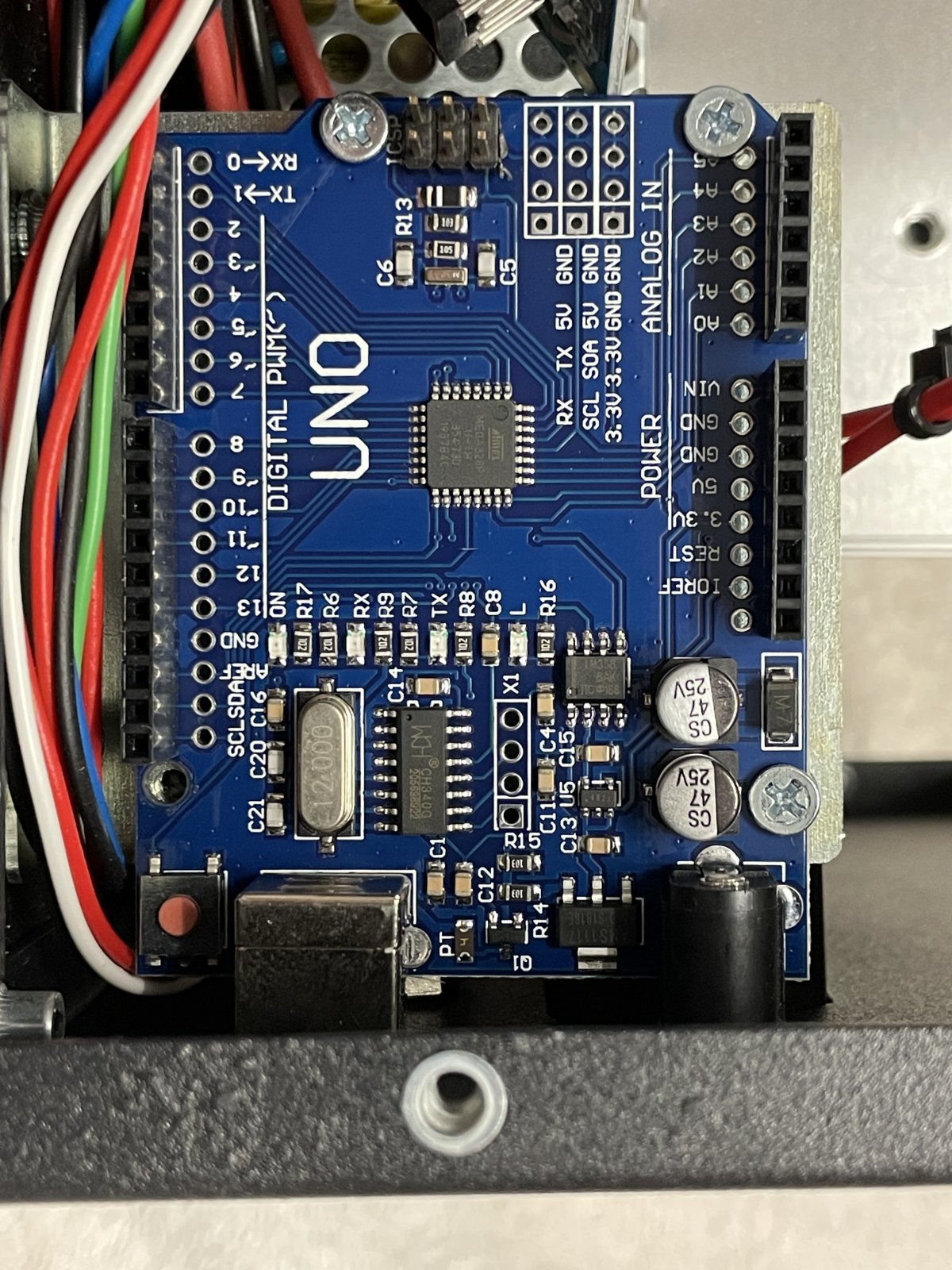

    The Arduino board is

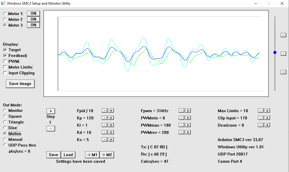

    Hi all,

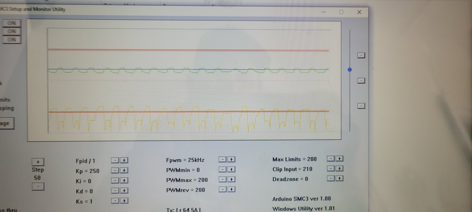

    I only have basic understanding of arduino code and I'm hoping someone could answer my question regarding the smc3 code in relation to a problem I'm having around the center area on my motors
    I'm using the cytron mdc30s r2 motor drivers and 200w 25:1 motion dynamics motors
    The issue I'm having is best described as a soft centre area, meaning the motors won't hold properly whilst powered on and the sim if nudged will start to oscillate as it bounces from side to side
    Is there a way in the code to up the power around the center area?
    I've attached a photo of the smc3 graph whilst sitting idle showing the bouncing and a video of the issue also, please note no matter what settings I have tried the problem persists on all motors
    https://youtube.com/shorts/koNaWRITtfk?feature=share
    Thanks everyone
    21,723
    152,051Coins
    +11,063 / 56 / -2
    In the video is SMC3 or SimTools running, can you move it like that if they are?
    In terms of oscillations have you tried setting DeadZone at 1?
  15. Rav3n87
    Rav3n87 Active Member
    Sep 9, 2020
    131
    723Coins
    +45 / 0 / -0
    That's Just with smc3 utils open, acts the same with sim tools open or none open, I have tried a little deadzone to see if it helps but no luck

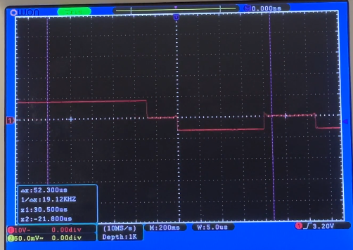

    Gosh I hope I'm not committing a forum sin here, but I'm working on my own rig, starting with 2DOF (one day will be 3DOF, but starting here), BTS7960s, Arduino Uno. SMC3Tool allows me to move motor 1 in one direction, not the other (by moving my manual slider up). Moving the slider beneath the feedback level does nothing and I am able to manually move the motor, so its position is not being held.
    So I hooked up my oscilloscope to see if my cheap BTS7960 boards were the issue. What I've found is that the PWMPin1(Arduino D9) is outputting (to my BTS7960 L_PWM pin) a PWM signal that gets flipped once the motor needs driven in the reverse direction. The ENA1 Pin (Arduino D2) is going from 5V to Ground when it crosses that threshold. The ENA1 Pin goes to the R_PWM pin on the BTS7960.
    All of my wiring appears to be exactly how it is supposed to be as per the initial post on this thread. My 2nd axis has some other issues as well, where the motor output in SMC3Tools will automatically turn off when increasing my PWMMax from 0 to 50 (at 40 the motor stays on), while doing the basic setup from initial post as well. This could be related which is why I'm including it but presuming that it is not.
    My real concern is that everything I've read on the internet about the BTS7960 is that to go in one direction, a PWM duty cycle is applied to the R_PWM pin, and to go in the other direction, R_PWM is ceased and a duty cycle is instead sent to L_PWM, and so I dont understand how the code for Mode2 is geared towards facilitating that.

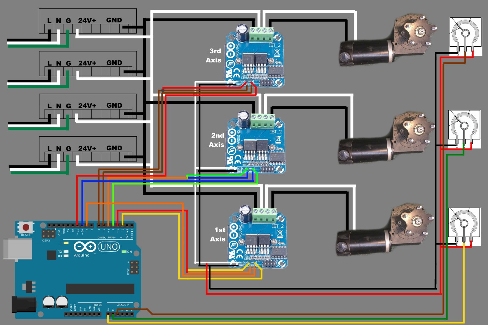

    Attaching my wiring diagram just in case anyone is curious.

    Looking at your diagram, it seems you are putting the 24v into your potentiometer and not the 5v from the arduino.

    The schematic is flawed in this regard, pots and bts7960 circuits are poered via Arduino 5v and ground. Its subtle but I grayed out the area where my Bts7960 power wires cross over the motor supply wires, just never drew where they actually got power from
