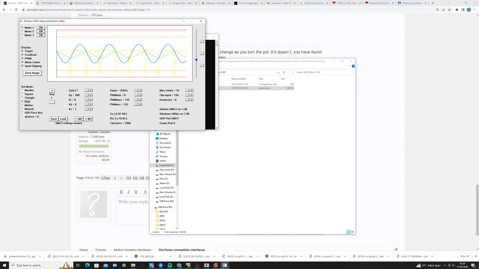

  3. Thomase123
    Thomase123 New Member
    Dec 17, 2022
    7
    - 41Coins
    So, its alive, kinda
    Why does it look like this?
    The pots are attached and turning with the shaft now

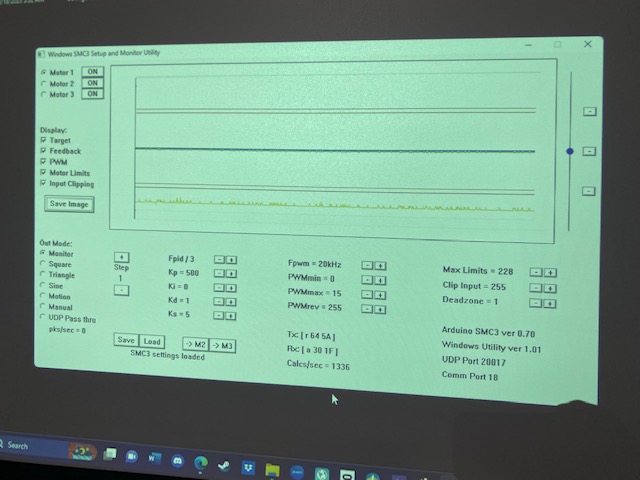

    I have a question regarding my platform. When running smc utils i set the pwmmax to 255 and the motors are strong and lift easily. but when in game they shut off under load. How do i set the pwmmax to 255 for in-game? Do i have to change it in the arduino code?
  17. Pierre Lalancette
    Dec 11, 2016
    1,006
    Tech Artist
    Quebec, Canada
    8,043Coins
    +944 / 6 / -0
    3DOF, DC motor, Arduino, 6DOF
    There should not be a difference between the two.
  18. Don Weatherby
    Don Weatherby New Member Gold Contributor
    Jan 23, 2023
    8
    - 49Coins
    When I am running Sim utils does that set pwmmax ? I am not sure why motors will handle a huge load in simutils and not ingame then.

  20. noorbeast
    21,723
    152,051Coins
    +11,063 / 56 / -2
    The purpose of the SMC3 utility is to tune all parameters specifically for your hardware. I very much doubt pwmmax at 255 is appropriate.
    Can you please post pictures of all of your SMC3 settings.
    And following the SMC3 set up steaps please let us know at what pwmmax value the motor starts to move:
    8. Set Kp to about 400
    10. Do the above for each motor
