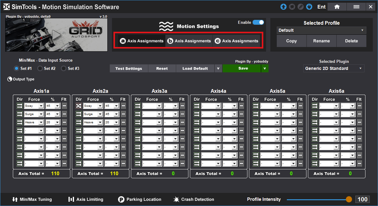

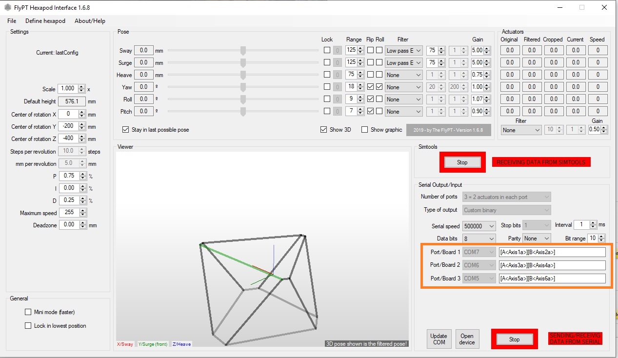

    If I use 2 Arduinos, what is the Output Interface code?
    Should be, [A<Axis1a>][B<Axis2a>][C<Axis1b>][D<Axis2b>]??

    Here were my connections with Mover.
    Pierre.

    The axis assignments you get your values from, axis A, B or C assignments.
    For separate settings per Arduino, you could use.
    Arduino #1) [A<Axis1a>][B<Axis2a>][C<Axis3a>]
    Arduino #2) [A<Axis1b>][B<Axis2b>][C<Axis3b>]
    smc3.ino should be fine, but the ide will probably want to put the file into a folder.
    I have not see it ask me to rename anything personally.
    Hope this helps,
