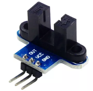

    Hi all, I am pretty new to the world of Sim racing and have been trying to familiarize myself with SimTools and SMC3 for the arduino. I don't have access to a pot but have 3D printed an optical disk that is fixed to the motor shaft. I am using a Photo Interrupt Module (PIM) to effectively count the gaps in the optical disk and this effectively gives me the same outputs as a shaft encoder. I was wondering how I could incorporate this into the SMC3.ino code so that it works the same way as the pots used. I have included a photo of the PIM and my code on the arduino IDE is pasted to the end of this post:

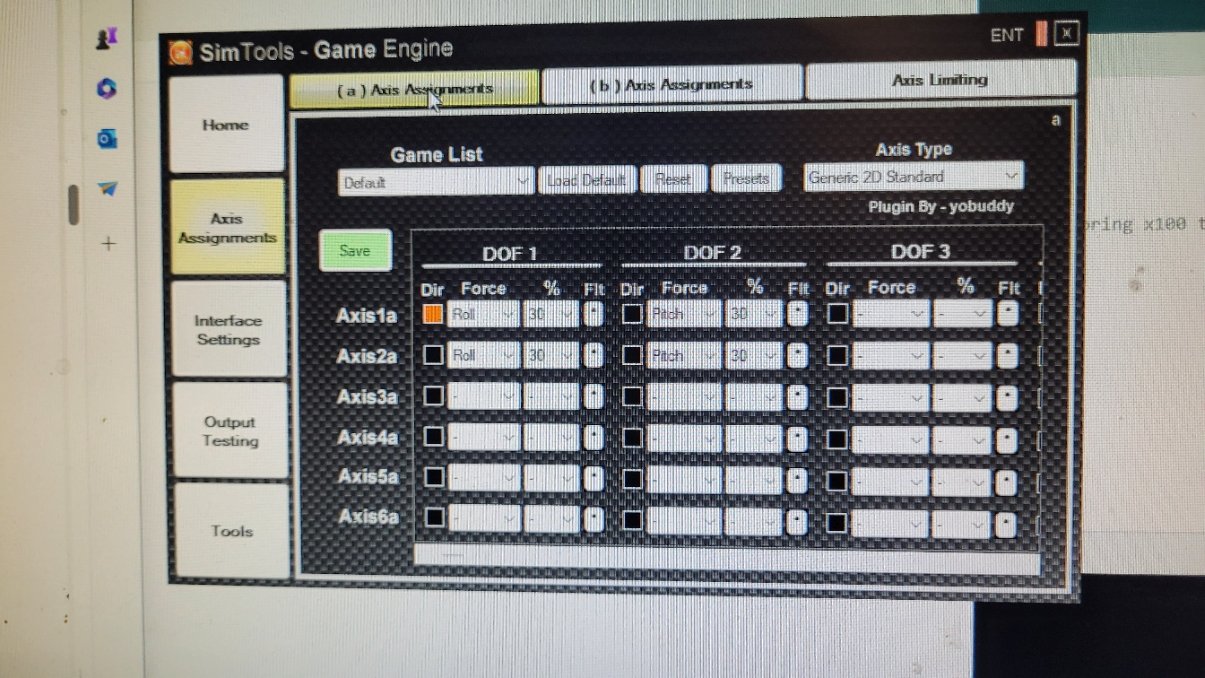

  10. hansvdm
    hansvdm Member
    Sep 21, 2023
    57
    Freelance
    leiden Netherlands
    111Coins
    +11 / 0 / -0

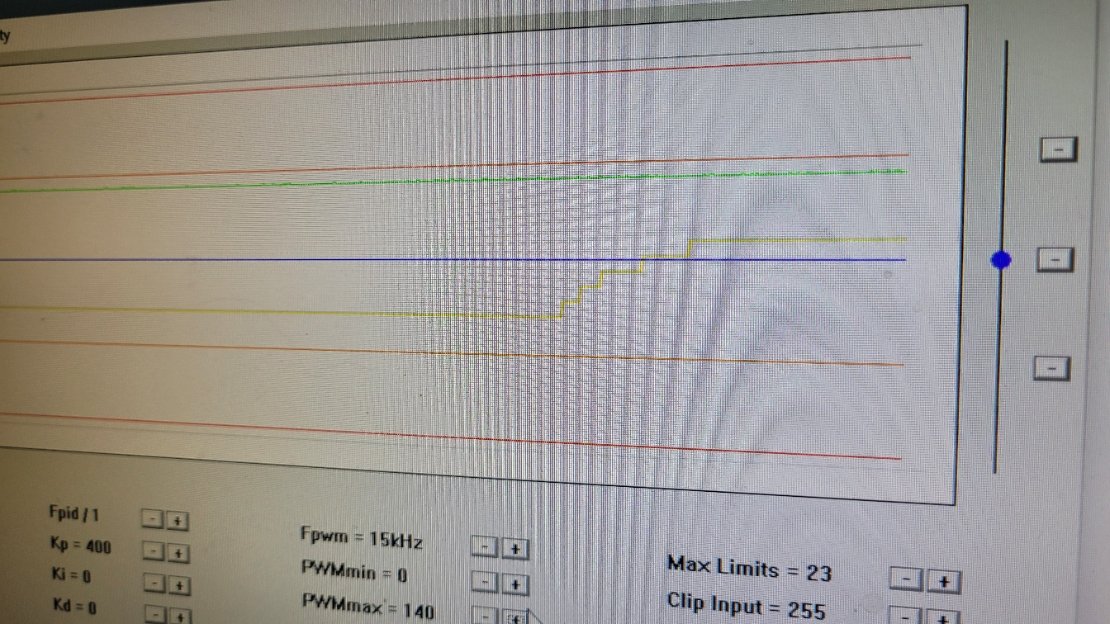

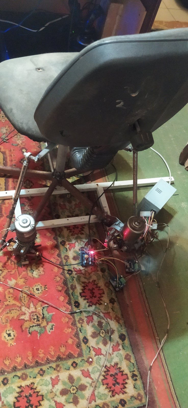

    Hi, all I followed the tutorial but got stuck at the end.
    I got the motors working and used the smc3 tool to test it. The only thing i see is that not my green line is moving but the yellow line is moving when adding pwmmax. Is this an issue? When i use motion to test it also does work.
    But when using the simtool program i cant seem to get it working. I used the settings provide. See screenshots. But when testing with the output the motors wont move. I cant figure it out.

    In SMC3 when tracking it whould look something like this:
  12. hansvdm
    hansvdm Member
    Sep 21, 2023
    57
    Freelance
    leiden Netherlands
    111Coins
    +11 / 0 / -0
    THanks it seems like it works. What i am confused about is using the utility software and the game engine. Am i correct that you configure the motors in the utility and those settings are saved somewhere? And then the game just adjusts the position slider? I first thought the utility was just to test the eniges not to use the to configure the motors. Are there any recommended settings for the utility program?
  13. noorbeast
    21,907
    153,053Coins
    +11,117 / 56 / -2
    The SMC3 Utility configures the Arduino settings for your particular hardware. Once that is done you don't need to do anything else with it. Don't run SMC3 Utility and SimTools at the same time, as it will cause a port conflict.

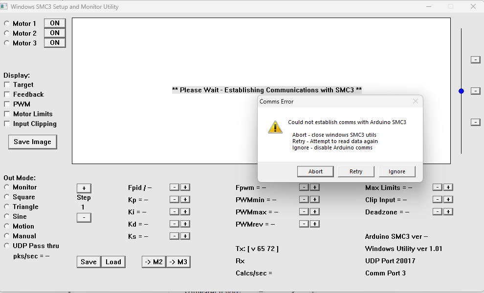

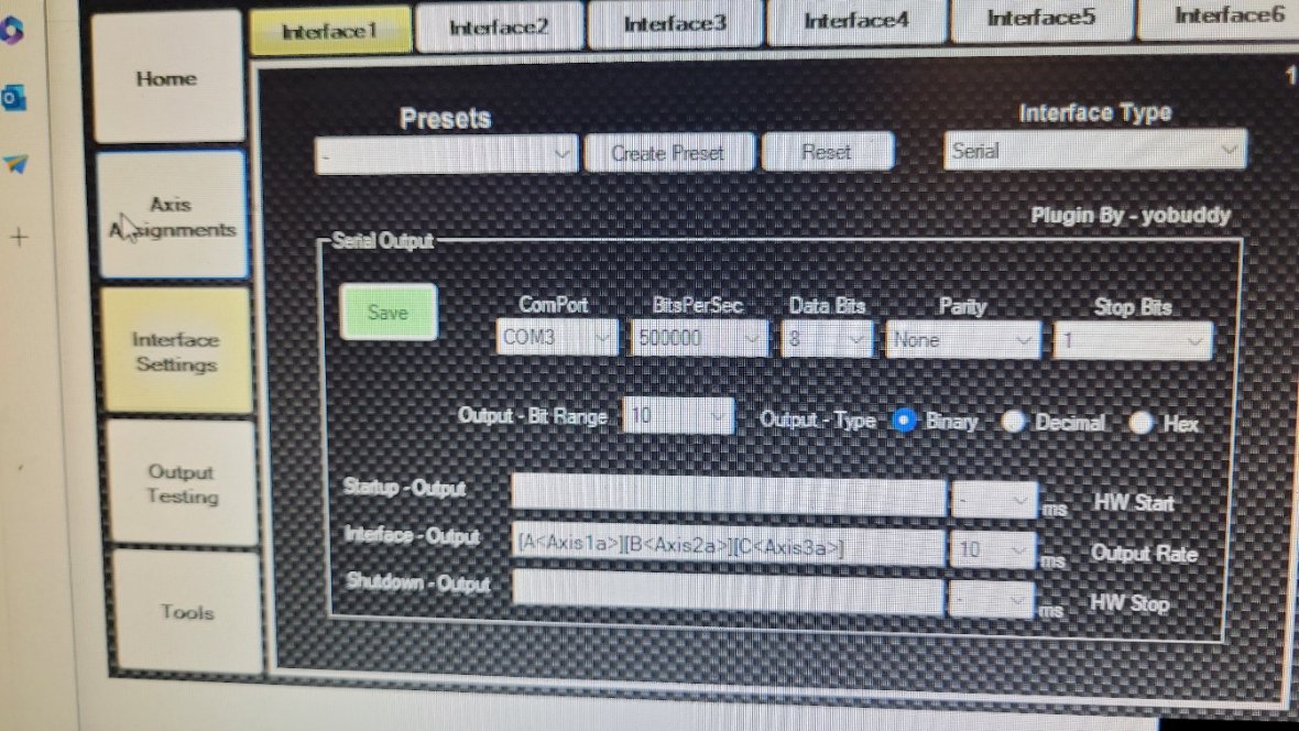

    I am trying to run the SMC3Utils application but keep running into the same error.
    As you can see in the bottom right my commport is set to 3 because that is where my arduino is plugged in.
    I have changed the comm port settings in the SMC3Utils configuration file and saved it. I have successfully compiled and uploaded the SMC3.ino file onto my arduino but when I try open the SMC3Utils app it just never established a connection with my arduino. Has anyone experienced this before? What can I do to fix this issue?
    Just for reference I extracted the utils out of the zip folder (downloaded from the top of this thread) onto my local C disk. Not sure if there is a specific location that it needs to be in.
    Any help would be much appreciated, thanks!.

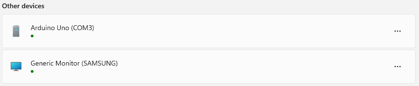

    Can you please post a picture of Device Manager, verifying the port used by the Arduino.
