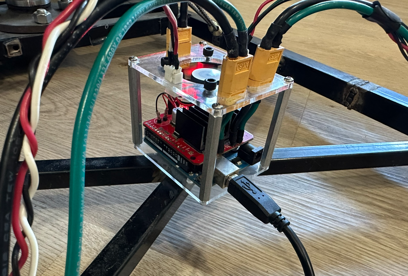

    REASSIGNED PINS FOR STACKED MOTOR MONSTER SHIELD, MOTORS NOT MOVING :(

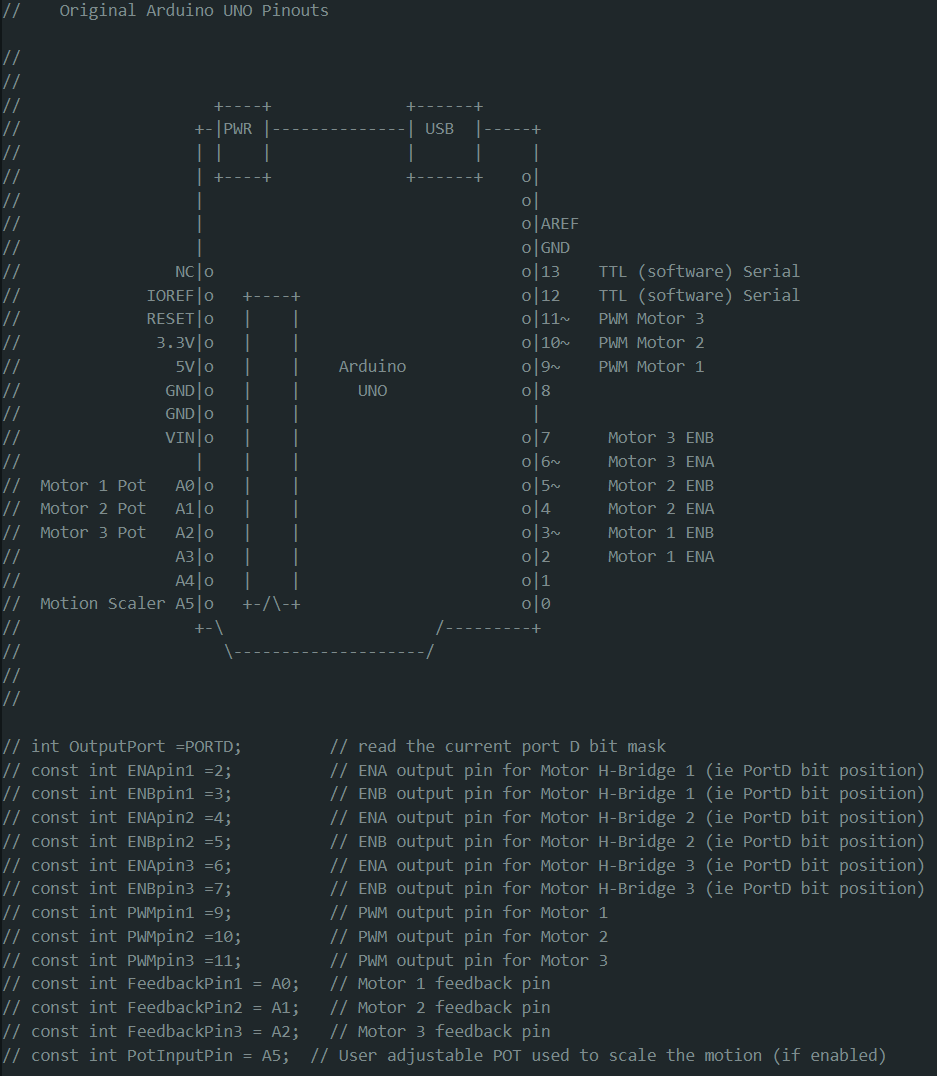

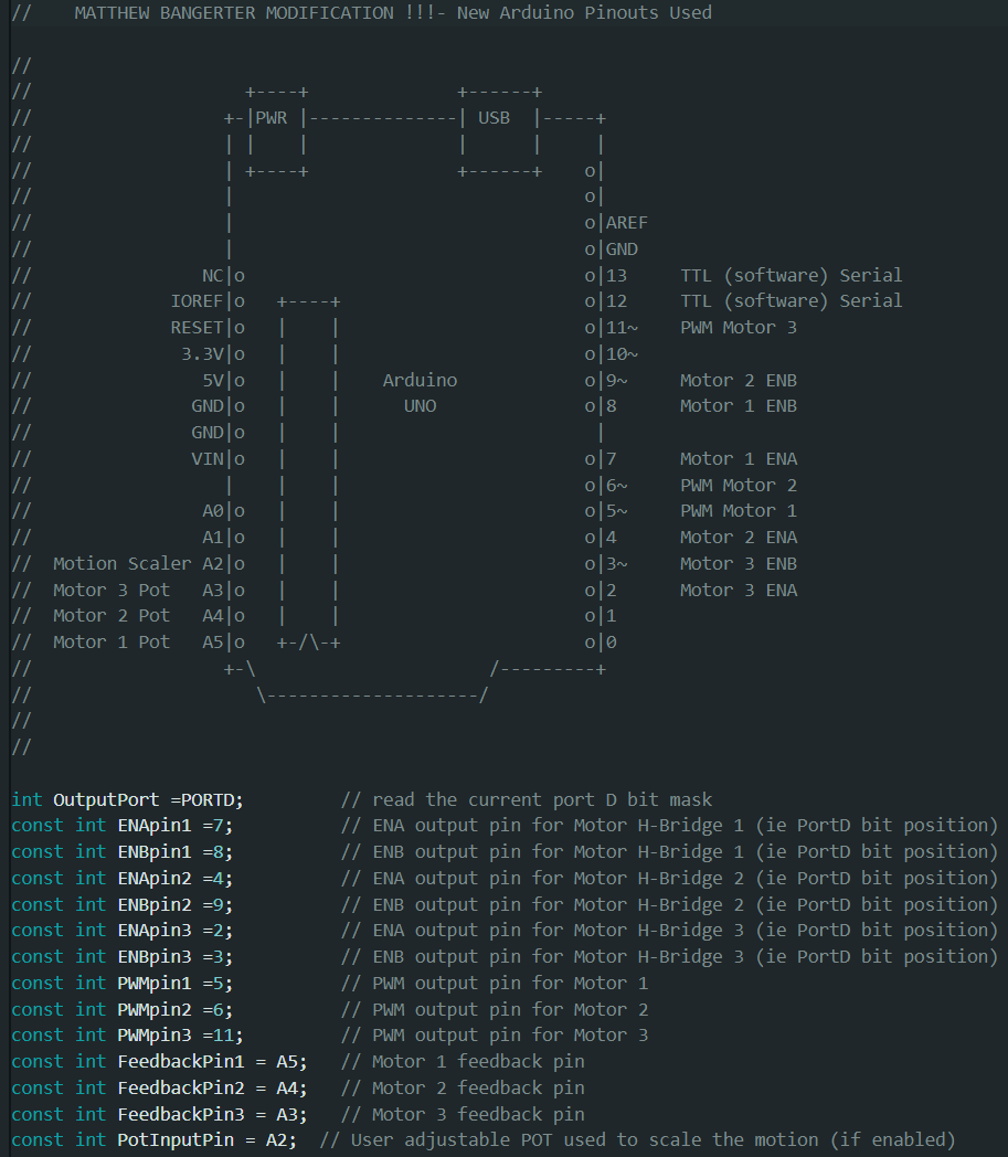

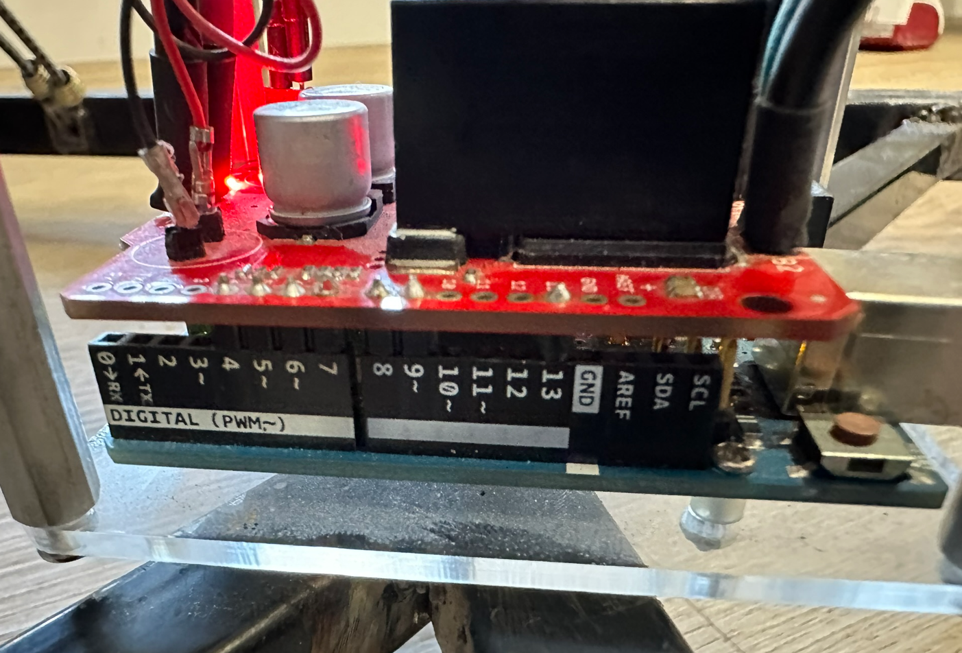

    So I have had my setup running on the racingmat code for years now and wanted to try out the SMC3 code to do some more fine tuning. I built a whole setup around using the MotoMonster shield stacked on the arduino so I really would like to keep the stacked configuration, however the pinouts are different so I attempted to change the pin assignments in the code to match the stacked configuration. I did try wiring everything up per the tutorial first and was able to get it working correctly, however when I re-assigned pins the motors no longer work. Essentially I just followed the wires on the diagram from @eaorobbie took all of the MotoMonster side pin numbers and assigned to those same ones in the Arduino Code since they are the same once stacked, giving me this (I am not using motor 3, so I just reassigned those numbers to un-used pins since the code still looks for those variables.)
    I am able to connect with the SMC3 utility just fine and I am able to see the green line move around when I manually move the encoders (I am using the BI 6127V1A180L.5FS hall effect position sensor), so that input seems to be working just fine, however when I follow the "Initial Setup" Section in the tutorial, the motors don't move at all :(.
    green line below is from manually moving encoder. increasing PWM max does nothing
    Anything obvious that I am doing wrong? Is there anything else in the code that needs to change besides these pin assignments at the top?
    ORIGINAL PIN ASSIGNMENTS
    MODIFIED PIN ASSIGNMENTS

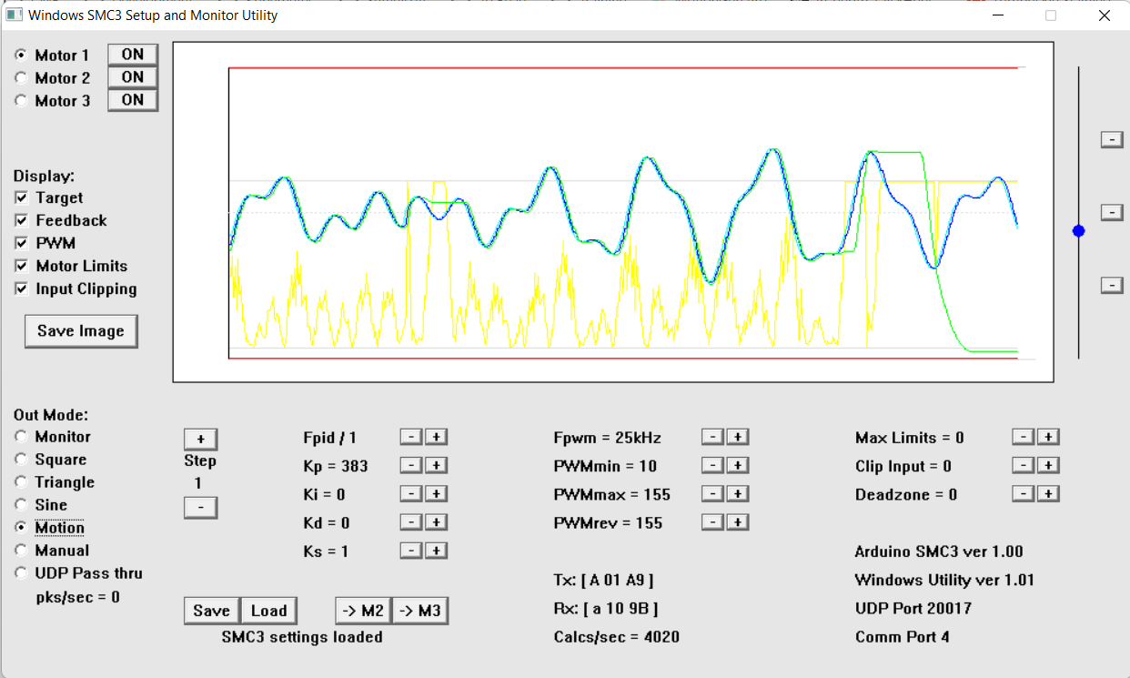

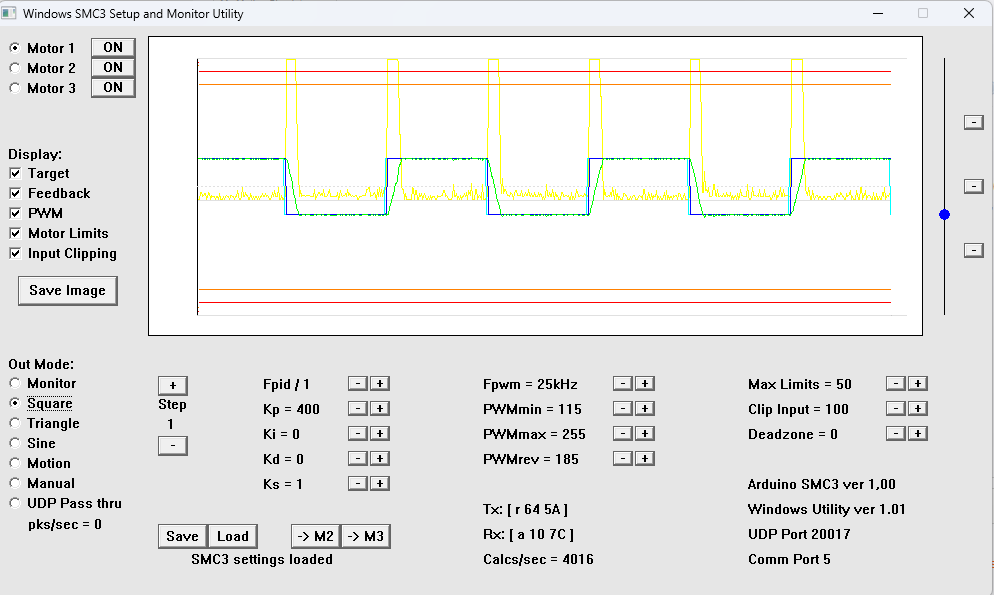

    Have a question, when Square waves running in SM3 app. Does the motor should move exactly squared signal? ie. when signal from below and move to above, it's a vertical signal. Should the motor allign with it or can it be an angle (Green line)? I got my green signal when moves like these at angled about 10deg from vertical (90deg).

    Trying to help from my experienced, it looks like you have a zero PWMmin, have you try to bump up the value?
    Hope it helps.

    Even the PWMmin zeroed it will move the motor? I only tried DC motor for my motion, from my experienced if PWMmin zero value, my rig don't move at all. My motor rated for 24V 40W.
    My rig when running, if only some bump or curb it react great. But when I rallying and a high jump in game, when landing, my rig moves left behind. Attached is when doing Squared and Sine waves.

    Initially PWMmin is set zero value as part of the SMC3 configuration, until raising the value of PWMmax to move the motors is determined. After that all values are refined, including PWMmin, which sets the duty cycle.
    What do you mean by your query "Spring setup in WRC really affecting the motion details", do you mean the spring setup of the vehicle, or something else? If an in-game setting affects the telemetry the game output then it will have an impact on motion setting, but only if the setting affects telemetry output.

    Seems I have different interpretation. I just tried PWMmin at zero, it is move. I don't know why at firstly built my rig not moving at zero before.
    Does DC motor with potensiometer with high PWMmin values will buzz/like they were always adjusting their position?
    Yes, spring setup of the vehicle. I see, I will give another tests with higher slow rebound (extend faster).
    So, what do you think of my graphs? Do my motors not enogh rotation?
    Motor is 2000rpm with 1:3 gearbox, so it reduced into 666rpm with 1605 ballscrew.

    Your tracking is pretty good, but lags a little in fast changes.
    In my view the accuracy of motor movement is way more important than the range of motor movement.
    While written with another control board in mind, the key points of this gentle introduction to PID still apply, in terms of what you see compared to what you may be aiming for: https://www.xsimulator.net/community/faq/a-laymans-analogy-guide-to-pids-pid-tuning.219/

    Yes, I did your suggestion before that I have after the accuracy of the movement. But I feel like for my rig, the range not enough. It has only 2cm up and 2cm down. Then I change my design with range 5cm up and 5cm down, now I can feel the whole rig move a lot better. I still have both the accuracy (low and mid, long travel still need more tuning like you see in graphs) and a lot of range.
    Now I'm trying to mount my motor without gearbox and get way more faster. I can reach the vertical wave lined up. Way too much speed I think, need tuning in SMC3.
    I actually quite familiar with PID but I will try to read the link you mentioned. Might be different in motion rig use.

    Thanks, I tried bumping up the value and does nothing for me. I have the motor working fine with the standard pinouts, I am just trying to see if anyone has successfully changed the pinouts per the below?
    And if nobody has, is there any reason it can't be done?

    BTW, Are you using Simhub? Or other apps that are using UNO port?

    I do have simhub, however everything seems to work fine with the original pinout, so it doesnt seem like that is causing any interference

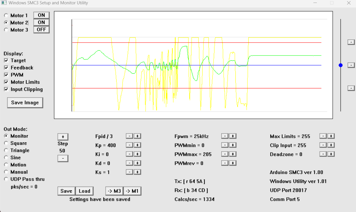

    Hi all, running my final tests before mounting the motors to the rig.
    I'm able to run the sine for minutes without any problem whatsoever.
    And it seems to be a very follow up from the motor.
    But, if I start a motion, in seconds or minutes (depending on the generated wave), it seems that after an abrupt movement (up or down), it stops trying.
    I already tried to set the Kp to 1000 to try to fix this, although it seems to handle the abrupt changes a bit better it eventually stops trying.
    Any clues on what I'm doing wrong? (I have to stop the SMC3 Utils and start it again to get the tracking going again).
    Thanks for all your help

    Looks like you have not yet set Max Limits and Clip Input, you may also need to tweak PWMmax and PWMrev.

    You are right, to be honest, I copied from a user that has the exact same motors and controllers.
    I started from the beginning and although I'm some lag, the motor never stops responding, I will try to fine tune the settings from this clean sheet.

    The benefit of SMC3 is have a graphical interface to tweak your settings to make the most of your specific hardware, all of the settings are explained here: https://www.xsimulator.net/communit...driver-and-windows-utilities.4957/#post-48121
