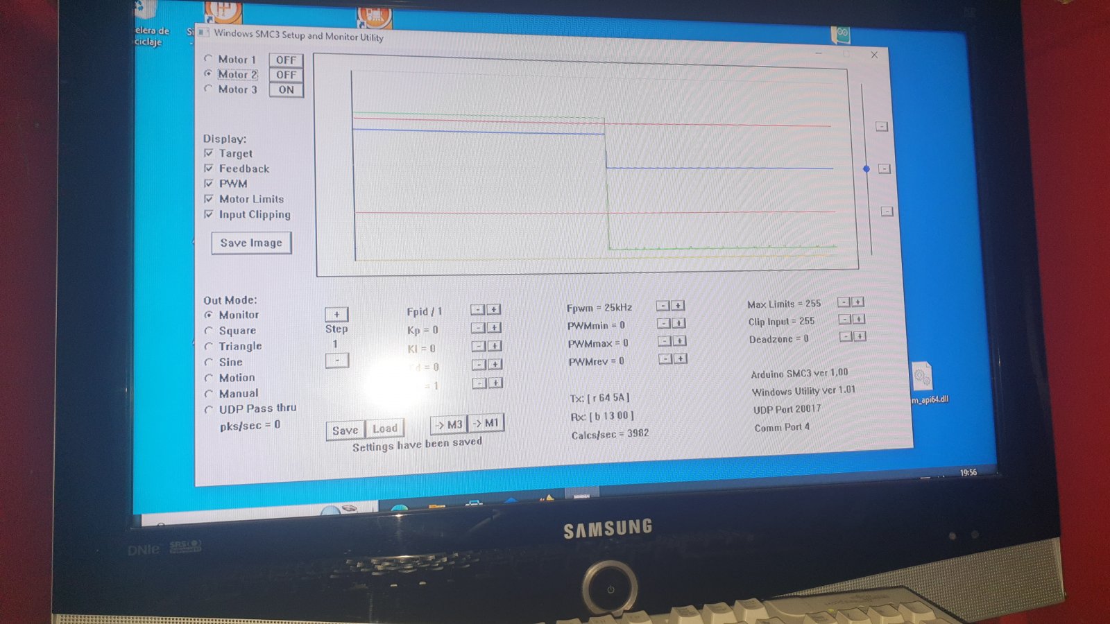

    Hello, I have spent all afternoon finishing installing the potentiometers with the new printed supports, I have had a long fight with Arduino IDE, I had to delete an avr folder, uninstall, delete all traces and with a previous version, I finally won the fight to the ide...damn hehehe.
    I have loaded the smc.ino, edited it to mode 2, edited the port in smc.ini and run the smc.utils utility.
    If I move the potentiometers by hand, I see the wave in both motors. I set everything to 0 and clip input to 255 and then max limit to 255.
    I set kp at 400 and start raising pwmax and get up to 255 and there is no movement.
    I did not have the multimeter, so I have not been able to check if 24 was reaching the input of the ibt-2, the potentiometers are working well by hand if there is movement of the green line.

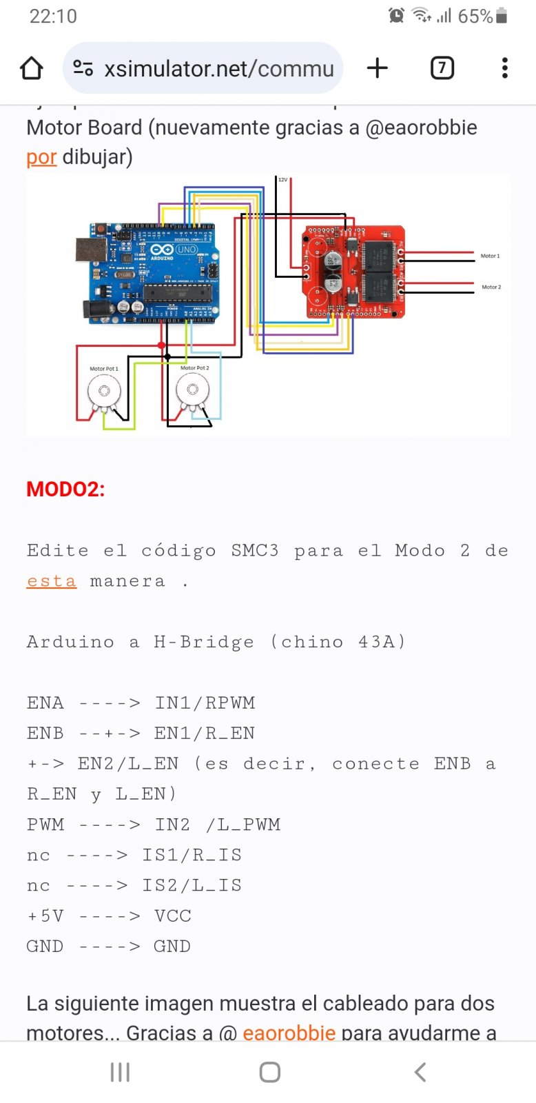

    Now reviewing the tutorial I see that apart from modifying the mode to mode 2, below you have to modify the part that indicates the wiring of the ibt-2 with the arduino
    This also has to be edited, at least that's what I understand with Google translator.....
    If it's just that I stay calm, if not I will change all the cables between the Arduino Uno and the IBT-2. If that was my mistake, can someone tell me in which row the change begins for connections between the IBT and the Arduino in the code? .
    You can't see it there, but I raise pwmax to 255 on both engines. Is it just setting mode 2 or do I also have to modify the connections shown in the first photo?
    Thank you for your help and attention.

    Just to be clear, this is the wiring for the IBTs:
    MODE2:
    Edit the SMC3 code for Mode 2 like this.
    Arduino to H-Bridge (Chinese 43A)
    ENA ----> IN1/RPWM
    ENB --+-> EN1/R_EN
    +-> EN2/L_EN (ie connect ENB to both R_EN and L_EN)
    PWM ----> IN2/L_PWM
    n.c. ----> IS1/R_IS
    n.c. ----> IS2/L_IS
    +5V ----> VCC
    GND ----> GND
    The image below shows wiring for two motors... Thanks to @eaorobbie for getting me started with the image :thumbs

    The motor 1 and 2 are off, that means that before taking this screenshot, the movement (or the reading of the sensor) was higher than the upper limit or lower than the lower limit.
    If you press the OFF button of motor 1 or 2, does it stays on? If it does, can you retry the process of moving the potenciometer and check if the motor responds?

    ok, then you just have to edit mode 1 and put it in mode 2.
    Google translator is not perfect and at home I read everything again and the translation makes me understand that I had to modify the wiring part in the smc.ino.
    It is now clear to me that it is only an indication of how to connect it correctly.
    thanks noorbeast, I will check the wiring and check that there is 24v in the ibt-2

    If I press the motor button 1 or 2 it still says Off as in the screenshot, maybe I'm a little confused, but after 4 hours trying to modify the new supports for the DIY sensors, I'm fighting with the Arduino IDE..... When I started smc.utils my head was no longer working...haha, sometimes it's better to stop and continue at another time with a fresh head.
    I will do the process again moving the potentiometers out of the limits, I think I made that mistake, but I was no longer thinking clearly.
    Thanks again to both of you for responding, I will keep you informed.

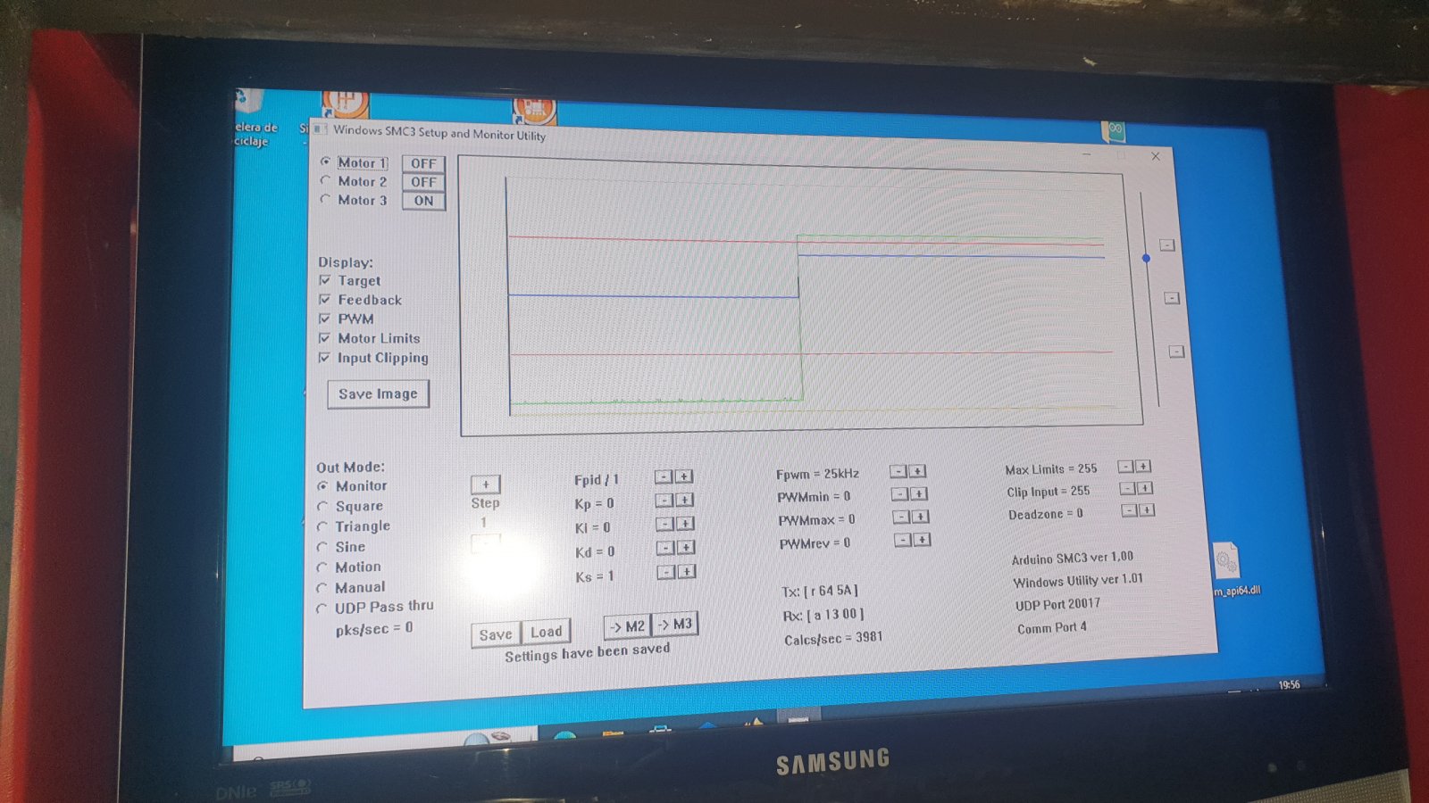

    Well, it turns out that I put the potentiometers outside the limits and yesterday my brain couldn't take it.
    This morning before going I was already imagining what that error was, since this sim already worked before and the adaptation of the potentiometers was fine, since the wave was moved manually hehehe, I was simply very confused.
    Today I centered the potentiometer waveform with the blue line and there is already movement. Only engine 1, 2 will be there at another time, they claim me at home.

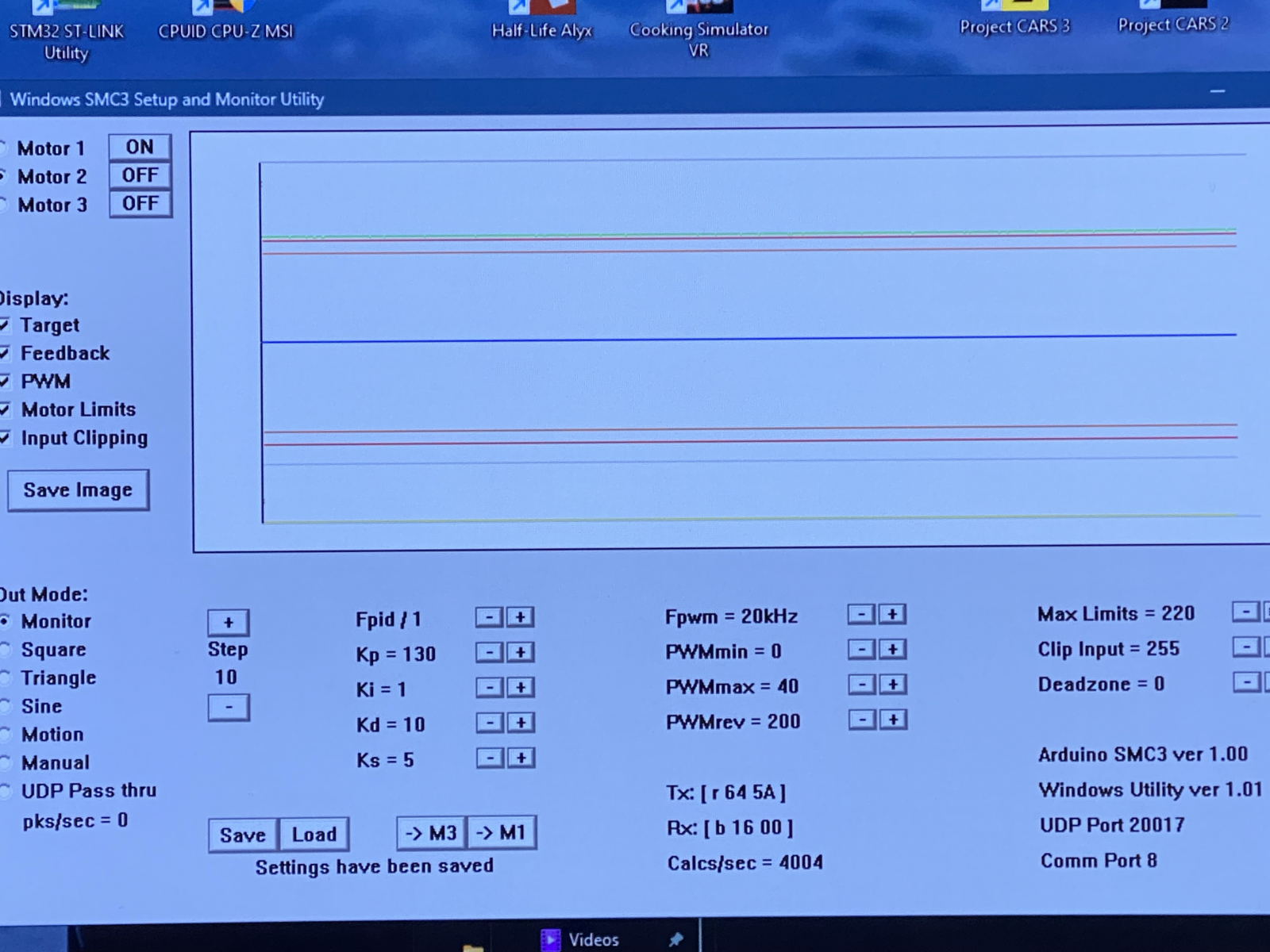

    I have a little problem, im use hall sensor potentiometer , it has 180 degree. in the middle I have 2,5V on one end 4,8 oon second 0 its normal voltage for the usb. Now my question. I must set my limits like this: Max limits on 255 and clip on 220. How to fix it? Make gearbox or so? Or it's not a problem? tempImageRucKmV.png

    The pot should be rotated to the center position on the graph and then connected to the motor where the lever is in its centered rest position.

    its not a problem with centering or so. My problem and question is not how to set the potentiometers and how to centre the feedback. My question is about a small range. It is not about the range in which the rig itself moves, it is about the limits in the smc. I now have to have the limits set to 250 Max and 220 Clip. The movement of the platform is large even very large, but the range of the potentiometers is no longer. I'm wondering if I need a gear for the potentiometers, and if so, I'll have to look for it somewhere.
