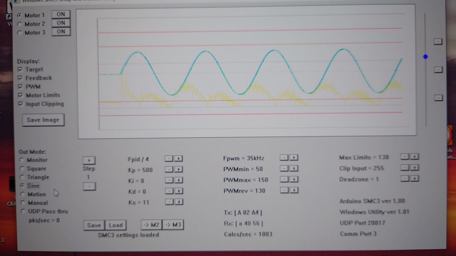

    I have a "problem or feature" in my rig.
    When I have pwmMIN at 40-50 the motor CTC lever can be slightly rotated with hand or by "swinging your body in the seat on the rig"
    If I raise pwmMIN to make the lets say "rubberband deadzone" go away, the motor starts to make whining noise.
    What other settings should I try to play with to get the rig "standing still silently" ?
    Or is it just a feature of the IBT2 and my setup and motor choice..?

    It could be interference, these related threads may be of interest:
    https://www.xsimulator.net/community/threads/smc3-noise-new-computer.15980/
    https://www.xsimulator.net/community/threads/motor-en-smc3-noise-after-switching-psu.17144/

    My noise is quite similar as the link #2 video about changing power supply and getting noise.
    I changed my SMC3 settings to:
    I just played for about 30 minutes and it just Works.
    The sound is not so bad anymore, it only bothers when not gaming. Yes I got my first 30minutes of gaming (setting axes the correct way for about 20min) and then when the rig does what is expected and not too little or much, I drive it hard for about 10minutes without any errors :cheers

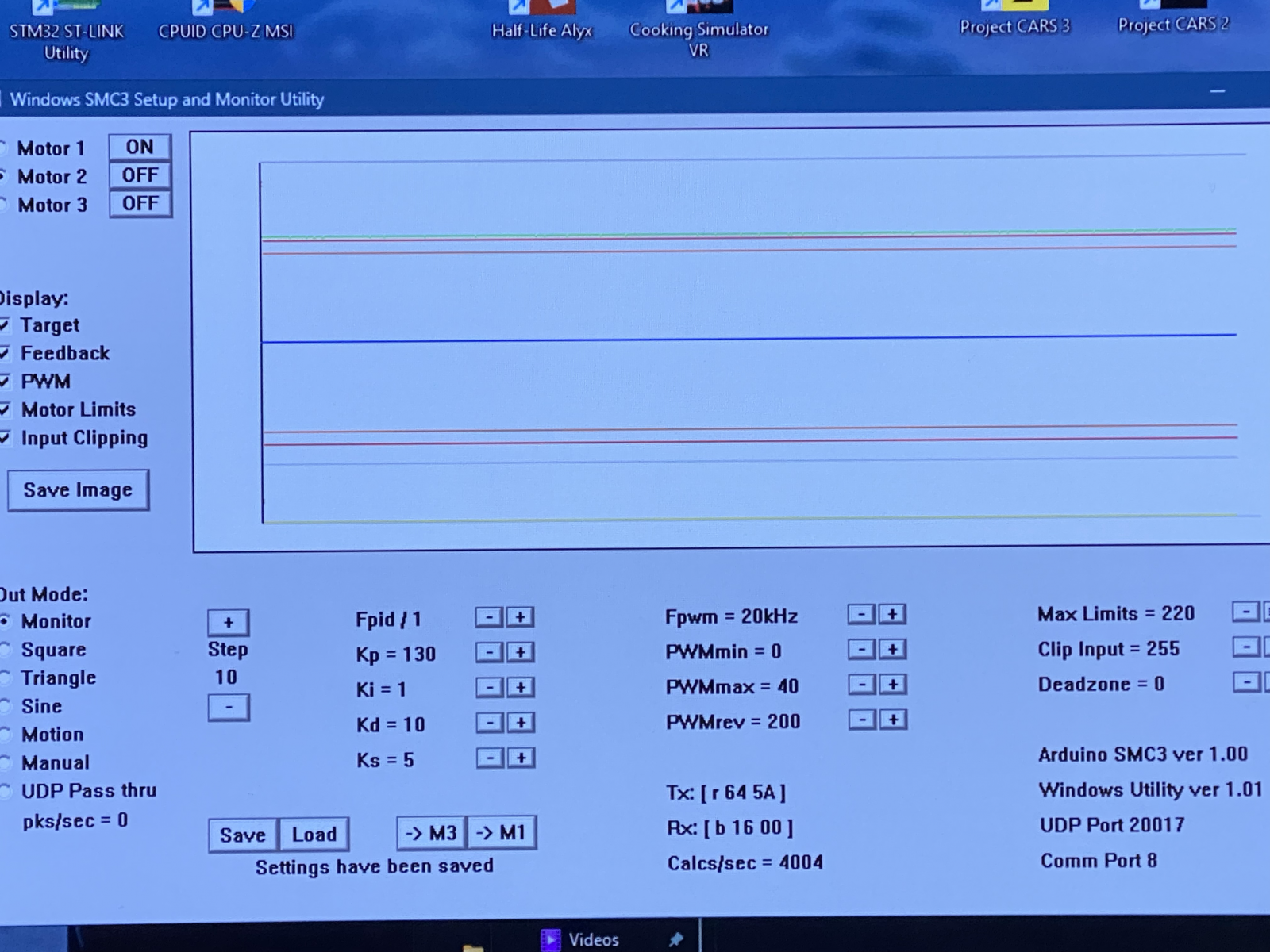

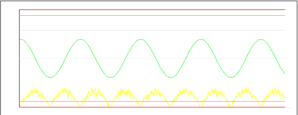

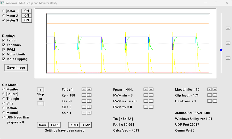

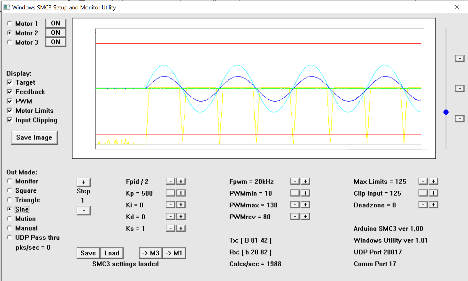

    I am having an issue with SMC3. I recently hooked up all three of my motors to check my wiring polarity and such. One of the motors (Motor3) ran silky smooth while the other two (Motor1, Motor2) were very jerky in their movements. I switched the connections on the Arduino board between Motor1 and Motor3 and the jerky motion moved with it. I verified that I had my settings between all the motors the same except the Fpwm being 5kHz on Motor1&2 and 4kHz on Motor3. Only other changes from the default initial settings were the Kp and PWMmax values. I did not change any wire routing or switch the feedback sensor from motor to motor, I only swapped the wires at the Arduino for the feedback and the motor control. Here is two pictures from the SMC utilities screen, you can see that it is driving the PWM signal differently between the two.
    Smooth Motor3 output.
    Can anyone explain what's up with this. At first, I thought I had a noisy sensor, but since whatever is plugged into motor3 is smooth I have ruled that out.

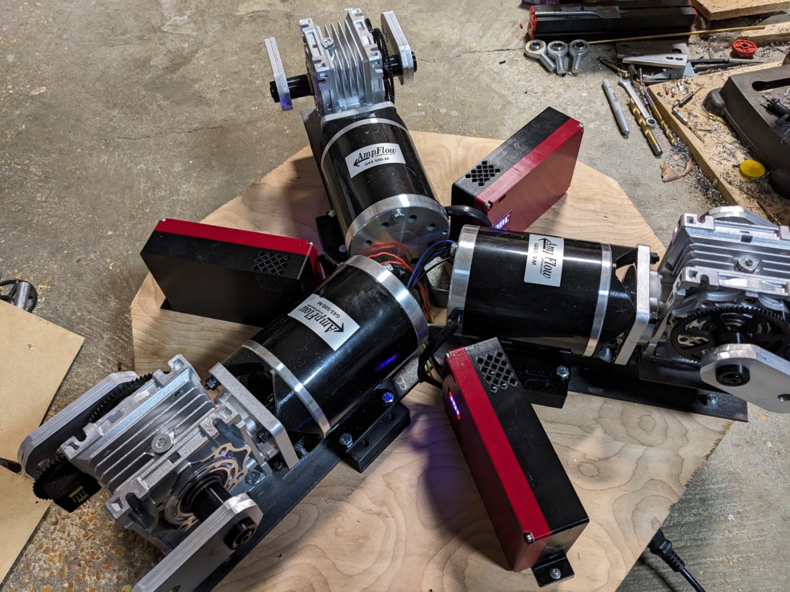

    For reference, this is the base of my platform during a power check before I started wiring the sensors and motor control wires.

    Can you please post a picture that shows all of your SMC3 settings.
    If 2 of the motors are totally powered off, including unplugging power to the PSUs, does the problem continue, as that should reveal if it were interference?

    Certainly.
    Here are screenshots from it running a square wave output.
    The second is on Motor2, but Motor1 looks the same. upload_2024-3-9_20-28-22.png
    These were taken while driving the same motor/gearbox/sensor, I just switched the connection on the Arduino. I did have to turn the Deadzone up if I was using Motor1 or Motor2. The Sensor inputs for whichever two motor outputs I wasn't using were connected, but the motor controls for those were not hooked up. I had repeated this on all three motors, one at a time while I was trying to figure it out. Also, using an oscilloscope and looking at the analog inputs, they didn't appear to have any extra noise on them. Unfortunately, I managed to kill the IBT_2 drivers I was using, so at the moment I only have one 18V25 G2 driver to use.
    While typing this I did have a thought. Motor1 and Motor2 outputs are run from Timer1 in the Arduino while Motor3 is run from Timer2. Are the PWM calculations different since Timer1 is 16bit and Timer2 is 8bit? Could those default settings it started with just be very wrong for those outputs? I was just trying to verify my center positions and wiring and didn't think to try tuning the PID settings when I saw this since the first one I hooked up was motor3 and everything ran smooth.
    I don't think it will help, but I have some short video clips of the motor running in both conditions, what format should they be in? .mp4 doesn't seem to work.

    I did figure out why with the same settings in SMC3 gave different behaviors between Motor1, Motor2 and Motor3. In the Arduino code the Integral and Derivative values are calculated differently for Motor3. I don't know if that was intentional or not. You can see from the comments in the code that they used to match.
    For Motor1 & Motor2
    iTerm_x100 = (Ki1_x100 * (long)CumError); // was >>6
    dTerm_x100 = (Kd1_x100 * (long)DeltaPosition); // was <<5
    For Motor3
    iTerm_x100 = (Ki3_x100 * (long)CumError) >> 6;
    dTerm_x100 = (Kd3_x100 * (long)DeltaPosition)<<5;

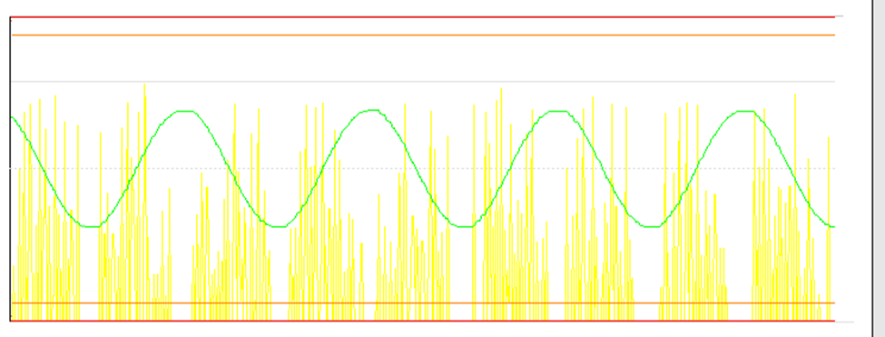

    3DOF, DC motor, AC motor, Arduino, 4DOF
    I'm using a string potentiometer, but the output is pretty fuzzy, any ideas how to clean it up? upload_2024-4-4_15-58-18.png

    Hey, Did you solve your problem?
    I'm building a 3DOF rig too (paused now due the work) and I also have that noisy problem but with all three motors. I tried everything, connecting ferrite cores, using shielded cables, connecting a capacitor between the two motor cables as close to the motor as possible (in fact I opened a motor and installed it inside), connecting two more capacitors between each cable and the motor chasis, connecting a electrolytic capacitor across the hall sensor supply, I tuned all the parameters in SMC to see if the problem gone....it never being solved, the noise is always there and the motors run with a lot of jitter, it is totally unplayable.
    I think the problem are the sensors. The arduino (and also the Sabertooth) amplify the noisy sensors coz I noticed that the yellow line reacts to the little green (feedback) pulses/movements/noise.
    Now I'm waiting for others hall effect sensors apparently better (at least bigge, with cable incorporated and twice the price) than the "cheap" ones I'm using now (around 30€ green sensors).
    We will see, If it does not work probably I'll abandon the project and I'll sell all the components separately.

    Does your feedback from the sensors look as bad as the picture that Silyn posted before you?
