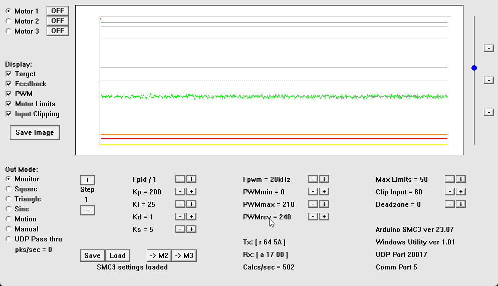

    I'm using a string potentiometer, but the output is pretty fuzzy, any ideas how to clean it up? upload_2024-4-4_15-58-18.png

    Hey, Did you solve your problem?
    I'm building a 3DOF rig too (paused now due the work) and I also have that noisy problem but with all three motors. I tried everything, connecting ferrite cores, using shielded cables, connecting a capacitor between the two motor cables as close to the motor as possible (in fact I opened a motor and installed it inside), connecting two more capacitors between each cable and the motor chasis, connecting a electrolytic capacitor across the hall sensor supply, I tuned all the parameters in SMC to see if the problem gone....it never being solved, the noise is always there and the motors run with a lot of jitter, it is totally unplayable.
    I think the problem are the sensors. The arduino (and also the Sabertooth) amplify the noisy sensors coz I noticed that the yellow line reacts to the little green (feedback) pulses/movements/noise.
    Now I'm waiting for others hall effect sensors apparently better (at least bigge, with cable incorporated and twice the price) than the "cheap" ones I'm using now (around 30€ green sensors).
    We will see, If it does not work probably I'll abandon the project and I'll sell all the components separately.

    I can't say that I 'Solved' the problem, but it's not a problem anymore.
    For me it was that with the same PID settings each motor would act different if they were attached to channel 3 than if they were attached to channels 1 or 2. The 'noise' I was seeing on the was really it just doing the calculations different for the integral and derivative values.
    For position sensors, I'm just using some cheap AS5600 based magnetic encoder boards from Amazon (5 for $17) with a 3d printed housing. All I'm using to hook them up is some cheap three conductor RC servo wiring I had laying around. I've looked at getting some shielded wire, but the feedback that the Arduino is reading has been very clean so far.
    Does your feedback from the sensors look as bad as the picture that Silyn posted before you?

    No, my sensor's feedback aren't as bad as the Silyn sensors but I still think mi problem comes from the feedback. If I reduce the Kp value the noise effect reduces too and the yellow line is less noisy BUT some of little movements aren't noticeable coz the signal is not strong enough to move me upwards and that also makes the motors very hot (because the lack of movements while the motor is receiving energy, it acts as short). If I want plenty "fidelity" in the movements I need to increase the Kp but then the effect of noise is an horror. Aprox in one week I'll receive the new sensors and I'll see if there is an improvement. Other tests I want to do is try to configure Simtools/FlyPT to filter that noise and make the movements smother if it is possible.

    My system is in no way tuned out (I'm still building and adjusting the mechanical parts) but all I have is a Kp value. I set Ki and Kd to zero for the moment because that makes all three channels behave the same.
    Have you tried with Ki and Kd set to zero?

    I tried everything but Kd does not make any effect and Ki more than 1 makes the motor/controller run crazy so that values are set to zero.

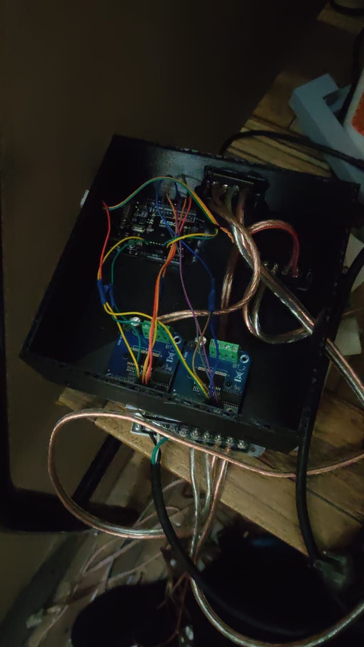

  17. ashboss
    ashboss New Member
    Apr 18, 2024
    - 4Coins
    i finally stated work on my 2 dof rig. look at my control box:thumbs
