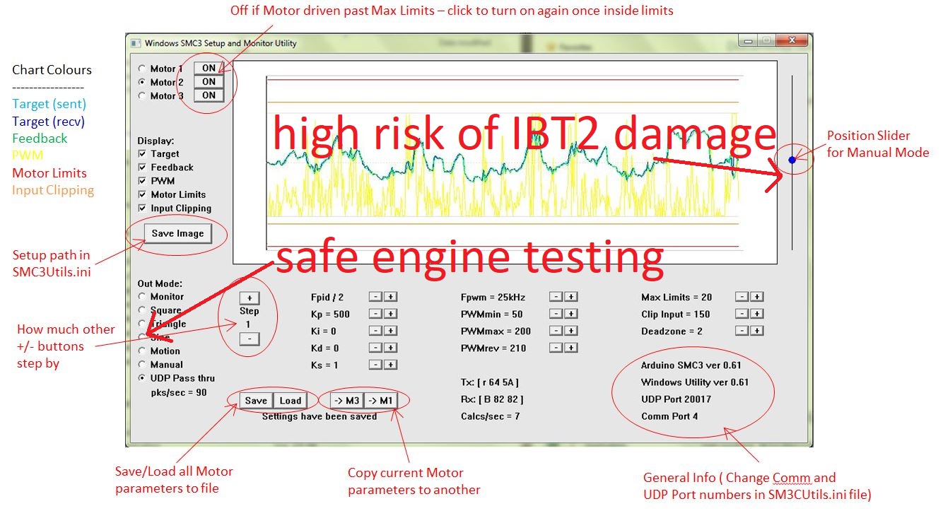

    In my experience with the IBT2 at 24V, manual control of motor movements often ends up blocking the IBT2 due to too high currents or even its irreparable damage, it is safer to test by selecting “Sine” where the signal builds up gradually. SMC3Utils Explained.JPG
