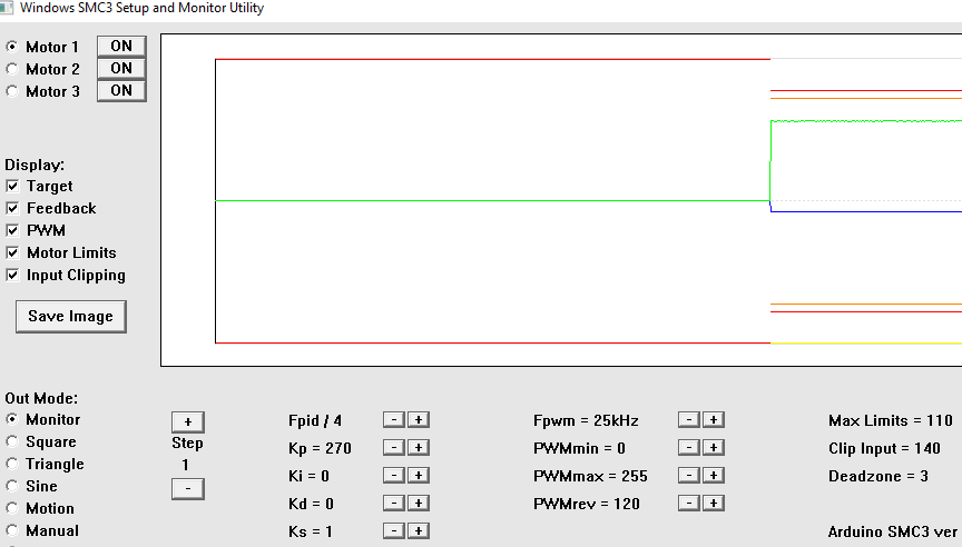

    My motors are overheating, and I can feel them "buzzing" constantly even when the rig is sitting idle. They are quiet though, but still "buzzing".
    Any advice on how to calm the motors down when they are sitting at the proper position? Is my Kp too large? Or should I lower the PWMmax? I'm trying to use all the power I can get from the motors. I could also increase the deadzone, but it's already at 3, so maybe that's not a good idea...
    All advice welcome!
    My settings are like this:
    The motors are Yalu wheelchair motors 24V 250W 75RPM, 6 of them are running from 2 x 750W PSUs, 3 Arduinos, 6 x Cytron 13A DC Motor Drivers.

    Reducing CTC will reduce the load on the motors, but the load is not a problem. The motors are heating up from the micro-"buzzing", even when the rig is empty and not moving. It's the constant tiny movements that are not even visible or audible that heat them up. Logically, when the motor should not be moving but just maintaining the position, a steady voltage should be applied (in the form of PWM obviously), instead of the constant micro-movements. So this is the source of the problem. Of course increasing the load exacerbates the problem and the motors heat up more, but if the "static" heat-up is reduced, the load won't be a problem. First thing I'm thinking of doing is reducing Fpwm from 25kHz to 20kHz, which is more common. I just say 25kHz on a similar rig, but most use 20, so maybe that would mean less pulses I guess (still more than enough for precision). Maybe that will help together with some other adjustments that I'm trying to figure out. There has to be a way - maybe reduce PWMmax and increase Kp instead, or something. I'm sure people did that already and know the relationship between the settings and the "buzzing". I wish I wouldn't have to guess.
    I should get the basic settings right, then if it's not enough, I could reduce the CTC distance too.

    Fellow builders... question how you get this 'chattering' gone or at least reduce as much. I assume this isn't good.
    The motion feels very solid already. It's just this chattering; I assume this is the positioning hunting.
    I am using this 100A High Power H-bridge dual channel DC Motor Drive.
    I am using this sensor AS5600 Magnetic Encoder 12bit for position feedback.
    Here is the video with sounds, hear the 'rrrr....rrrr....rrr...' and see the LED direction indicator keep jumping between Left and Right.
    https://www.youtube.com/shorts/WNmPN5LT3xU
    This is my SMC3Utils setting:
    Just FYI, I have 50% scaller (set the scale pot to 120'clk position) if you see the plot 'Target' line (green color).

    I suppose you mean Kp? I tried reduce down to 400, start to see a slightly less responsive. But the chatter remain the same. The only setting value that really effect is a combination of Kp = 500 and Deadzone = 10.
    But I heard Deadzone more than 2 is bad, is this true?
    Btw, the AS5600 I use is a half effect.

    This is a result of a noisy signal and/or smc reading the pot signal to precisely
    Adruino ide has an example sketch that allows you to print the pot data to monitor which shows how accurately the adruino is reading your pots signal. Load this sketch and watch the values fluctuate when the pot is in a stationary Poland you will see the signal will fluctuate between 1-4 binary numbers reporting the pot location. The noise you hear is the motor changing directions rapidly in very small increments from this fluctuations
    Adding a small capacitor (I used a 10uf) connected to the pots signal line and ground will filter out the noise. But this does not completely remove all fluctuations and will still see the pot print sketch show the signal report positions that will vary from e.x 512.5 to 513 not staying on a steady number indication the system is rapidly adjusting the sensor location.
    To fix this a software potentiometer filter is needed to be implemented into the code.
    Example can be used from this website to explain
    https://www.electroniclinic.com/arduino-analog-signal-filter-analog-sensor-value-fluctuates-a-lot/
    I used the more simple of the 2 codes since it was more simple and produced better results.
    After adding the capacitor and filter code my motors no longer sound like bacon sizzling with small jitters
    Honestly the code should be updated properly with this code implemented by someone who knows what they are doing.
