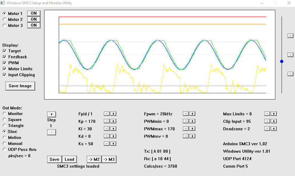

    I wouldn't have predicted that a working I component allows you to use higher Kp values. I had to tune PID regulators in a professional context a couple of times. There, a increasing one parameter (like Ki) usually meant that another parameter (like Kp) needed a reduction in order to avoid instability. But like you said, YMMV.
    I am running a 3DOF with heave, with rotary motors.
    With my revised PID code I'm currently running Kp=170, Ki=30 and Kd=0. You can find the results for the motion, sine and square waveforms attached to this post.
    At first I had Kp=150, Ki=50 and Kd=0. This looked good while the "motion" waveform was running, but the sine wave hat some artifacts where the rig would be highest up. With Kp=170, Ki=30 and Kd=0 those issues went away while "motion" still looked good.
    I also tried some different Kd values. However, I couldn't get smooth movement with the sine or "motion" wave with Kd values different than 0. As soon as I use Kd values like 10 or 20, motion that should be smooth (input-wise) gets translated to rough seat movement. The yellow PWM line in SMC3util also gets rough.
    You really get smooth motion with non-zero Kd values? What Ks value for filtering are you using? Could you post a SMC3util screenshot showing how the "motion", sine and square waveform looks with your rig running?
