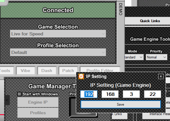

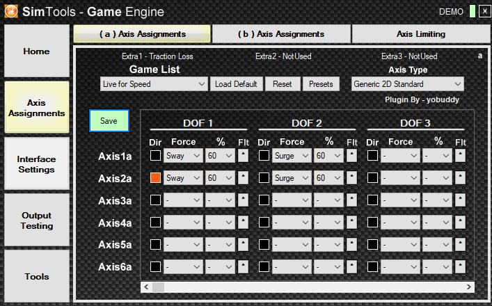

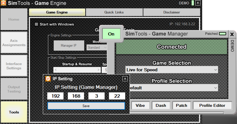

    I’ve built a 2DOF setup. In SimTools GameEngine the motors work fine in Output Testing — they react to the sliders.
    But when I start GameManager, it shows “Connected”. I set up the IP, patched the game, and GameManager shows the game is running.
    The problem is: the motors don’t move at all in the game.
    Has anyone faced this issue? Any advice would be appreciated.

    It should look like this. Also, you should probably use SimtTools 3 because thats where the latest games are supported plus it has additional features.
  17. noorbeast
    21,839
    152,659Coins
    +11,103 / 56 / -2
    You should not need to mess with the IP @Mistake.
    Live For Speed does need to run in first person mode before patching, so unpatch it run it as in the FAQs then repatch LFS: https://www.xsimulator.net/communit...run-in-first-person-mode-before-patching.365/
    @Joe Cortexian is right, if you are just starting out use SimTools v3 instead: https://www.xsimulator.net/community/faq/simtools-v3.401/
    In addition to the v3 Manual and Quick Start guide also see the motion profile tuning tips: https://www.xsimulator.net/community/faq/steps-to-create-a-motion-profile.228/
