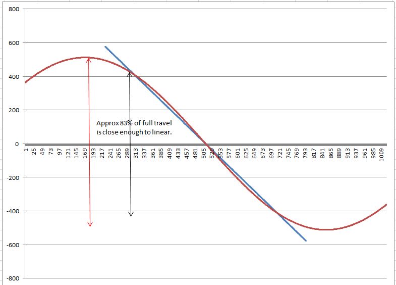

    hi @RufusDufus , i have a question ! :D
    I work on a new g-seat and i hooked up my hall effect potmeter directely on the motor's shaft, that's mean i get an angular measure but i wish having a linear measure, then i add a formula into the loop process of your code to convert angular-to-linear and it works but i wonder if i have to change the data type of the "Feedback1" because i use cosine in radian ? :sos
    if (PIDProcessCounter >= PIDProcessDivider)
    PIDProcessCounter=0;
    // Check and Update Motor 1 drive
    Feedback1 = analogRead(FeedbackPin1);
    Feedback1 = 512-(512*cos(Feedback1/325.9495)); <---------------------------------------------o_O
    if ((Feedback1 > CutoffLimitMax1) || (Feedback1 < CutoffLimitMin1)) { DisableMotor1(); }
    PWMout1=CalcMotor1PID(Target1,Feedback1);
    if (Disable1==0)
    SetOutputsMotor1();
    else
    PWMout1=0;
    and i wonder too , if i add a formula like this , if I can disrupt something , synchro, timing ....?

    Hi Eric,
    The main issue in doing this is that you will need to use floating point arithmetic for the calculation and that together with the fact Cosine calulations take alot of processor cycles it will most likely have a significant effect on the maximum number of PID calculations that can be performed per second. I expect it will overrun the period timer and just calculate PID updates whenever the loop gets finished rather than on regular timed periods.
    That being said, that would be the right place to do the calculation. I take it you are trying to compensate for the angular motion of the lever arm so the seat moves a linear distance for a given movement in linear target. Not sure the formula is correct - I think it should be sin?
    That aside, I don't really think you will get a noticeable benefit from doing this... Look at the chart below that shows a comparison of the movement resulting from the angular motion compared to an equivalant linear motion. You can see that the majority of the levers end point motion is "close" to linear anyway. Its only the last 17% of travel at each end that starts to deviate significantly. When you in these areas of the travel you would typically be simulating fairly large vehicle motion anyway and in my opinion you won't "perceive" a great difference anyway.
    In fact in my latest version of SMC3 (which reminds me I need to release it) I actually have implemented a POT input that the user can use for adjusting/scaling motion. The scaling approach I have adopted in a non linear approach which compresses the largest travel but keeps the smaller travels largely unchanged. So at the end of the day I guess as always it comes down to what individuals feel right.
    You may have noticed in my MRAP simulator I use rope and pulleys that result in linear motion... This was done more so to allow greater travel distances with minimum load on the motors - not really to compensate for the non-linear travel (even though it does that also). The result is a 250mm travel with a 40mm pulley (equiv to a 20mm level from a motor load point of view). That is one of the main reasons I get away with one single cheap power supply to power the whole sim.
    Hope that helps.

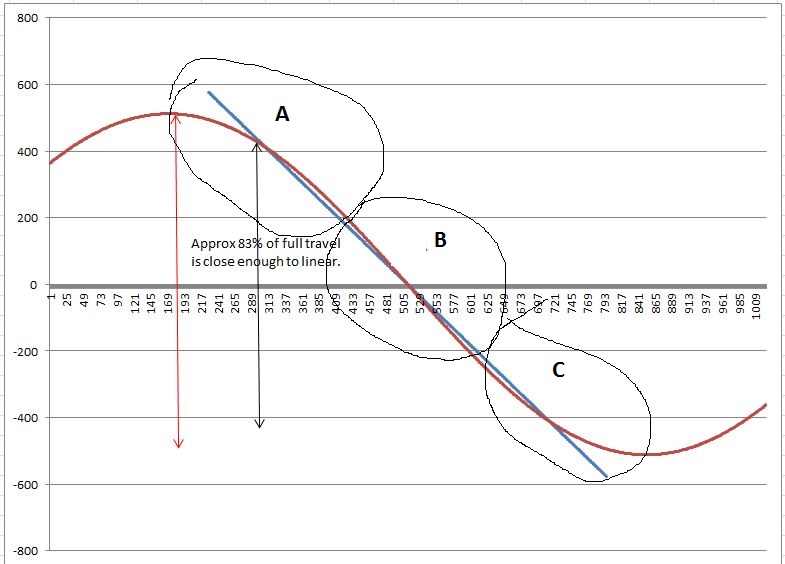

    Hi RufusDufus ,
    ***The main issue in doing this is that you will need to use floating point arithmetic for the calculation and that together with the fact Cosine calulations take alot of processor cycles it will most likely have a significant effect on the maximum number of PID calculations that can be performed per second. I expect it will overrun the period timer and just calculate PID updates whenever the loop gets finished rather than on regular timed periods.***
    This is the kind of problem that I was afraid to create.:eek:
    The problem I see is when I have 2 -3 or more combined force. The first force is reproduced in the "B"section most often and sometimes it can be found in the "A"section (heave+sway) or (sway+heave). Depending on which comes first. I found it a little contraingnant .
    Rope / pulley is a good solution for eliminating this little problem...:thumbs
    Anyway, yesterday i tested my motor alone (not in a combined manner) and i have been impressed and satisfied of the result. In my new build i will have need the angular measurement :think
    Sorry for the inconvenience
    thank you for your fast reply and clean explication. :thumbs

    Hi Eric, if you do want to proceed with this try to work out a way of doing the angular conversion with integer math rather than float (sine/cosine) formula - integer math is much more efficient in these type of micros. You could maybe use a pre-calculated lookup table if there is enough code space, or perhaps break the calculation into regions and use a linear approximation for each region.
