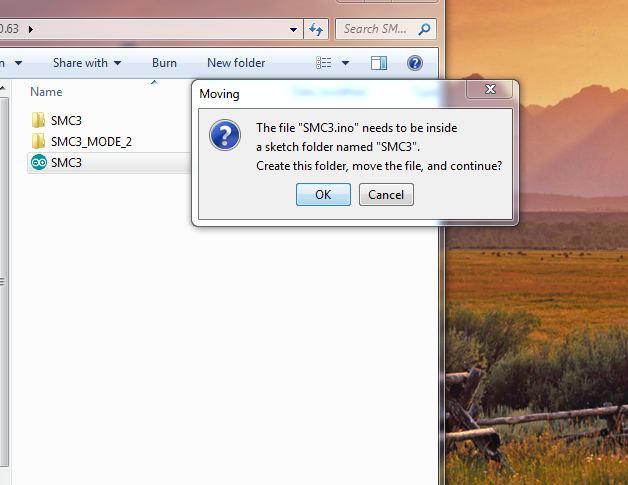

    I had a brain fart, How does one go about installing the SMC3.ino folder into the Arduino IDE? I did it before and now I can't remember what the hell I did.
    Thanks.
    terry

    wrong folder , but it is going to create it . it will be correct after.

    OK, however "Where do you put this folder"? drag and drop or is it installed in program files /Arduino?

    i installed Arduino on E:/ and SMC3.ino should be in a folder named SMC3 then...
    xx:/arduino/eample/SMC3/smc3.ino
    but you can too create a folder elsewhere like me : /documents/Arduino/SMC3/smc3.ino
    no matter where you are installed SMC3.ino, double click on it and Arduino IDE will open it !
    :D

    OK, so here lies the problem. I have the SMC3 into a separate folder like the message tells me to do. When I open the folder and click on the SMC3 arduino, it opens and I can Verify the program but when I try to upload it I get an error message (RED) saying that it is "not in sync" and the lights do not blink like they should. I need to get the SMC3 folder into my (FILE/SKETCHBOOK) in the Arduino IDE.
    How is this done?

    put your SMC3.ino into a folder called SMC3 for example then copy it to this destination C:\Users\YOUR USER\Documents\Arduino its the default folder for scetches when arduino ide is installed.
    then open arduino ide and you will find SMC3 under file-sketchbook.

    Thank You insanegr, That is exactly what I wanted to know. It worked very well, like I said in the start, "I had a brain fart". Thanks again
