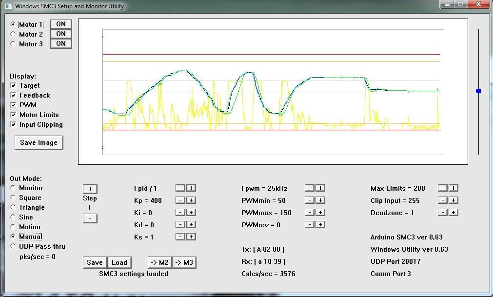

  17. Jymä
    Jymä Member Gold Contributor
    Nov 24, 2011
    61
    Finland
    184Coins
    +43 / 0 / -0
    Hi
    I am having same issue as @ericRacer and @spartan300 on pages 4-8. What was the fix for this? I am using SMC3Utils v0.63 and SimTools_v1.2. On SMC3 Utils small movements work fine. On SimTools Output testing (and games) nothing happens until 40% DOF Output or 26% Axis Output and then it shoots to the limits.
    EDIT: I added pictures for more information. SMC3utils settings are pretty off but you can see that little movements work fine when I moved motor target manually. On SimTools it doesn't work at all. First nothing happens and then the target shoots to the limits. Simtools Axis management should be ok. It is almost default SimForce GT on default (which worked with previous arduino code). And I don't have SMC3Utils and Simtools running at the same time.
  18. Pit
    3,007
    30,500Coins
    +3,098 / 31 / -0
    @Jymä: your curve is very jagged. Please check your potentiometers if they are really working properly.
