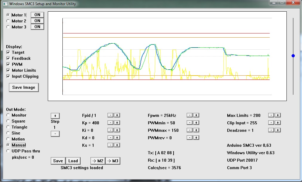

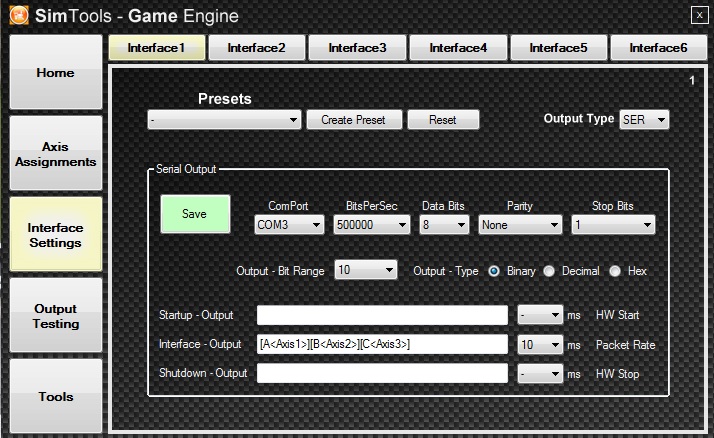

    Hi Jymä, As far as I know they all got their sims running... I believe they needed to install the latest version of Simtools and also:
    1. Ensure in the simtools interface setup you have created "and saved" a Default profile
    2. Make sure that there is a "Output Testing" profile in the Tuning Center
    I notice also you have all three axis in the output string in your interface setup... If you aren't using all three axis then only include the ones you need: for example [A<Axis1>][B<Axis2>]

    I think this may be more to do with the low KP and PWMmax values. With the low values it takes a while for the PID to ramp up the output when the target changes so the motor doesn't have enough current to move it straight away then it eventually builds up and moves the motor to target and drops the current again.
    Increase these values but make sure your H-Bridge drivers are well heatsinked/cooled first.

    For motion sims the Kp is definately the most useful parameter of the PID loop. Kd and Ks should have an effect though. Note they all interact with each other. I work mostly with Kp - from memory it is set at 600. I don't worry too much about the others.
    Not quite sure what you mean by Kp=100 in Simtools? Kp is a tuning parameter in SMC3 only.
    Yes, Ks will create instability in a PID control loop if set too high. Again you should be able to get good results focussing on just Kp and PWMmin and PWMmax.

    @RufusDufus Got it working!!! Apparently it is a little bug or incompability in SimTools (or with SMC3 communication). I had the same thing with one other program. Though SimTools worked well with another Arduino code.
    If I have Finnish date and time format in windows (the bottom right clock shows now 9:41 18.10.2014) that problem occurs. If I change it to English (9:41 18/10/2014) it starts working! It can be tested by going to Control Panel->Clock, Language, and Region->Change the date, time or number format and put it to Finnish. And then launching SimTools again. Thank you for this motor driver!

    @Jymä, thanks again for the feedback... I have changed the date time to Finnish on my setup and can confirm the data output from Simtools is no longer valid.
    @yobuddy, I connected a second computer to the serial port output of my Simtools computer to monitor the data being sent by Simtools.
    When working correctly the packet data changes smoothly as expected with the center position sending out a binary value of 511 as expected and then increasing and decreasing as the slider is moved.... here is the serial data (5 byte packets, Hex followed by Ascii)

    When I switch to Finnish date/time mode the Simtools output is not correct. The second byte of the binary number is always zero and only the first byte changes - that is the most significant bits of the 10bit binary number are changing, hence the step change in motor position... here is the serial data (5 byte packets, Hex followed by Ascii)

    There is some major problem at my rig, Win XP, nano clone, mode2,
    I have set date to english, and did all the above, and it remains the same, it works OK in simtools output testing if I set Kp not higher than 100 in SMC3util.
    Higher than ~100, and in simtools output testing, slowly moving the slider, the motor goes crazy, it follows the slider in general, but jumping around crazy, in SMC3util the same slidermoving generates a silky smooth motor motion.
    Seems like instead the data 1,2,3,4,5 etc as i move the slider, somehow it gets 1,2,3, -50, [big jump] ,5 etc.
    so no deadzone, but an erratic working.

    What a relief, it is OK under win8. But my Q6600 is the bottleneck in AC, I wanted to use the XP machine to take away the job as much as it can.

    Well just to be clear, the motors are moving one at a time (not both) :)
    The problem is, the motors are working fine in SMS3Utils (values are PWMmax=200 and KP=500), smooth movement when i use the slider. But in Simtools (gameEngine) i got the strange behavior when i move one of the sliders Axis or Dof.
    I thought of one of the feedback pots isn't working correct, but after measuring there working both fine (they are 10K)

    Another test, simtools output testing thru UDP to SMC3util, it goes total berserk. The blue line [target] breaking up, then coming again, and the motor jumps wildly.
    Stopped every process and service under XP, no change.
